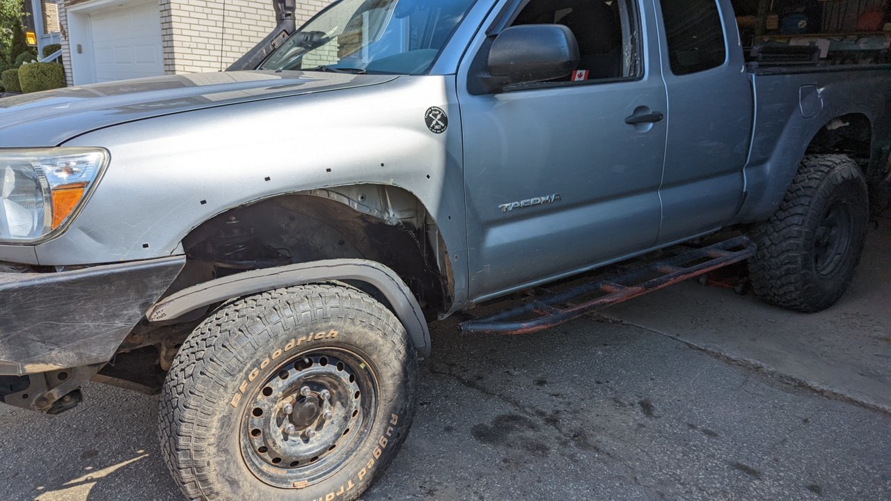

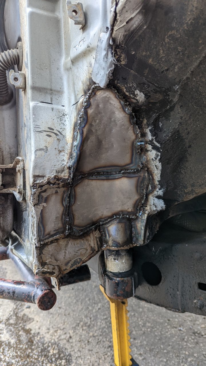

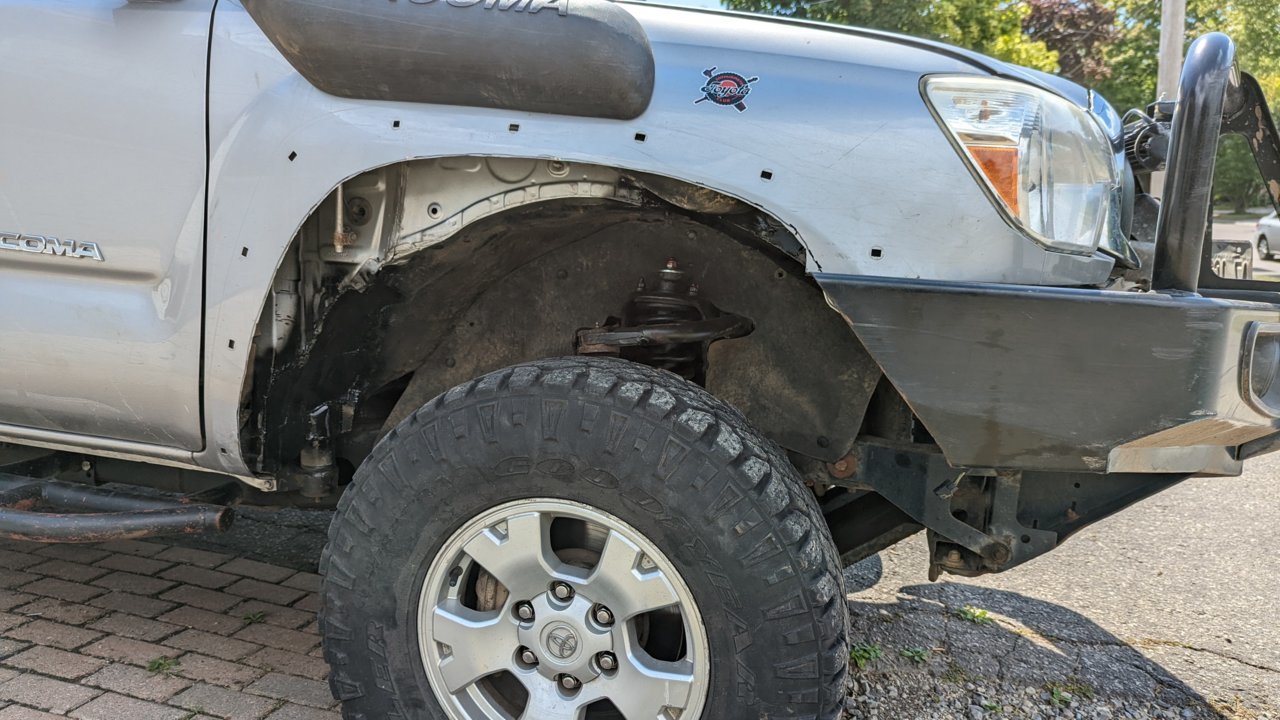

    I used 16 ga for the bottom pieces and 22 for the top. one side done today

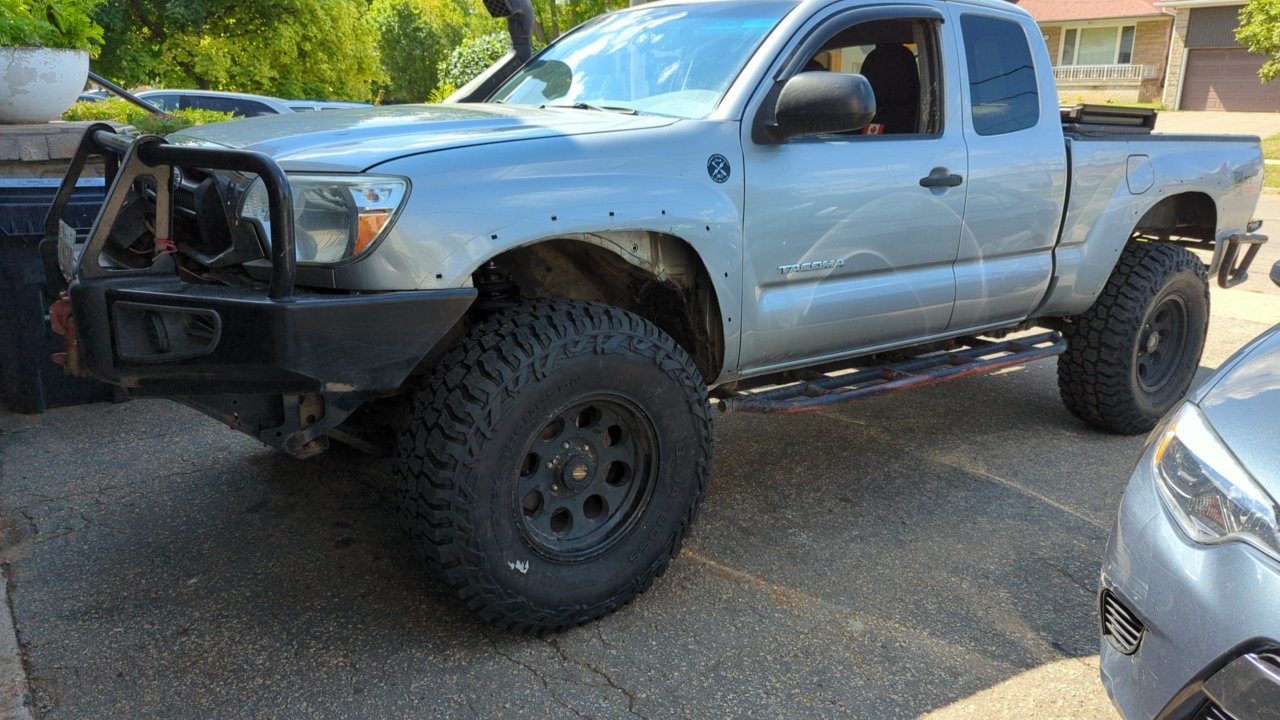

    I got to this point today

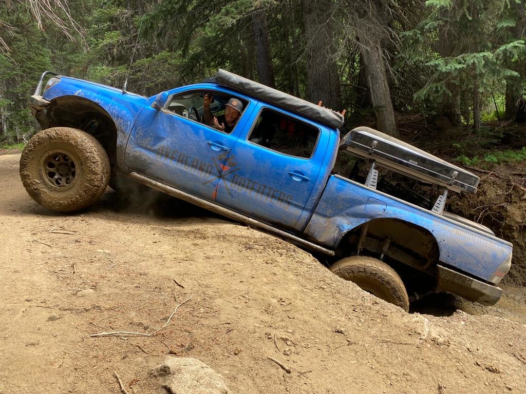

    Thanks! Definitely how hard you drive it is a big factor. This was yesterday... Smashed a third tail light in the bank haha had to winch up from there.

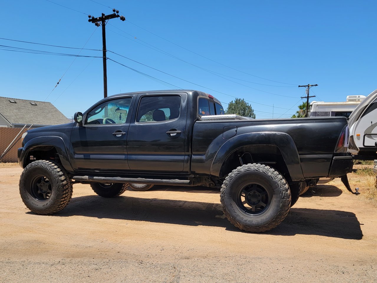

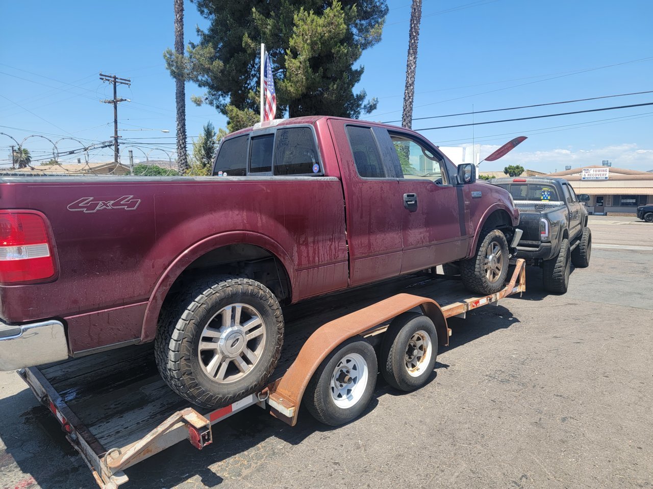

    Mine gets abused but in a completely different way.
    BTW, that was the first and last time I towed something that heavy. Lol

    Yes... On the control arm. I'll be taking it slow around corners till I can figure it out. Haven't flexed it out to check other rubbing but will at the trail will walk with hammer :)
