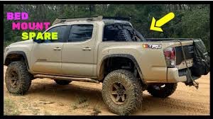

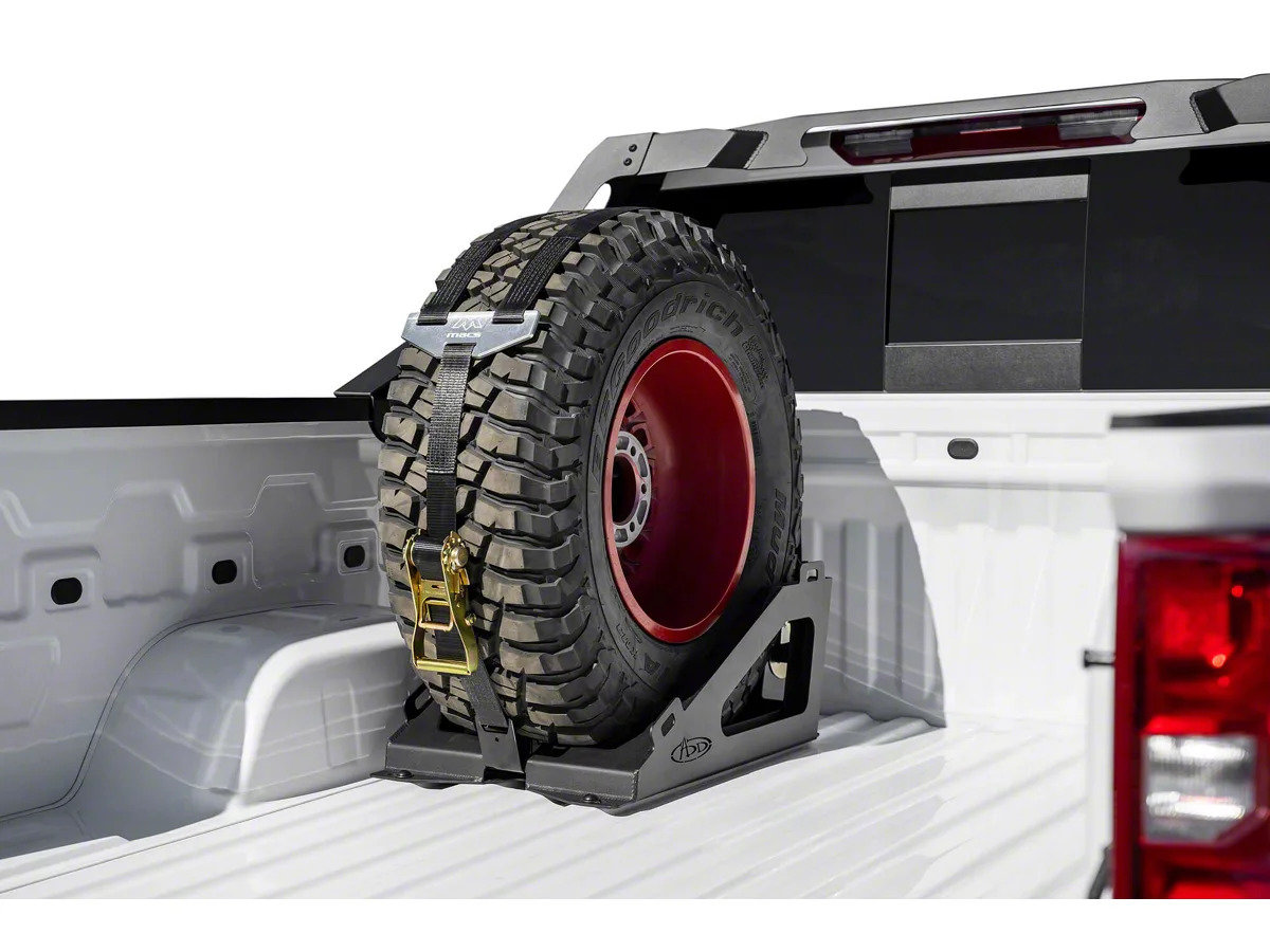

    So I have been running on 37's for a couple of weeks, not regeared yet, I'm living with it for now. One very big thing I never thought about was where to put the spare. The spare takes up more than 1/2 the bed if its laying down which mine is because i have a tonneau cover. Has anyone come up with an idea to get your bed space back. I don't want to make a hitch or bumper mounted spare. just don't like it

    Lying flat, it is what it is, if you’re determined to save space then you’ll have to sacrifice the tonneau cover to install something like this.385C6CD9-6232-4EE9-BE62-209E8923721C.jpgE0D51227-78E0-4AFA-A18D-B87B2C8D2B75.jpg
