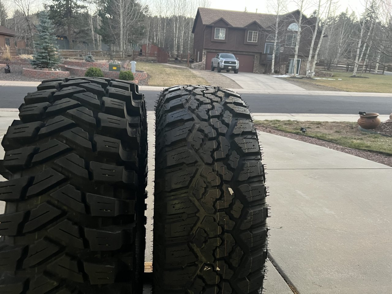

    Just swapped over to my winter setup. Kanati 37x12.50R17 Trail Hogs. 3-Peak rated

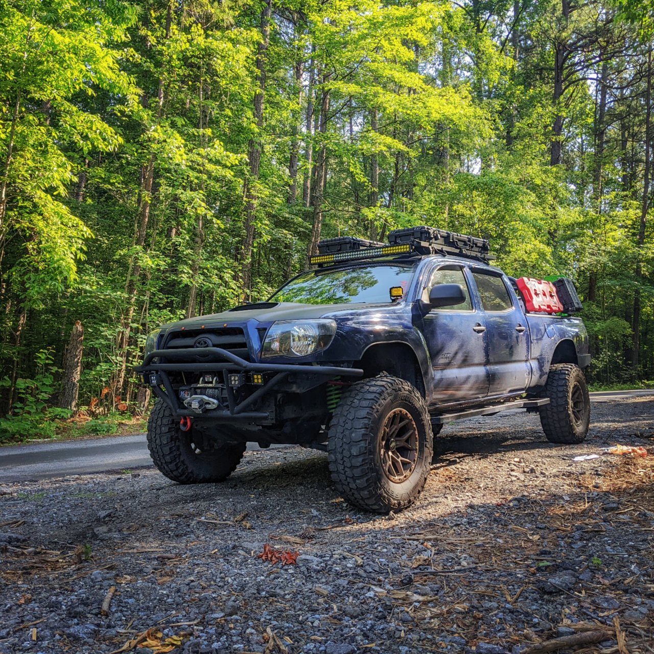

  20. Nov 20, 2022 at 6:37 AM
    #1360
    Robertocritser
    Robertocritser Well-Known Member
    Jul 21, 2010
    #40524
    7,216
    Levi
    KY
    08 sport
    ATM6969420 series

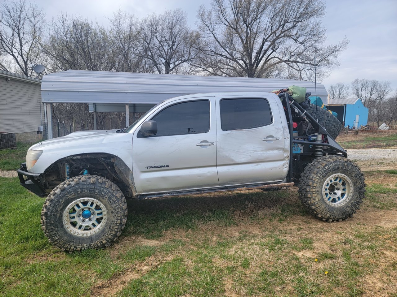

    4.56 and 37s. With no head wind I get an average of 16mpg on the interstate. V6 & auto.
    Not saying it's right but it has worked well for me.
