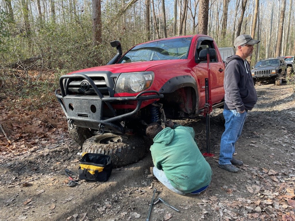

    Turns out 37's will shuck a CV in a heartbeat

    Did it break the inner joint or outer?

    On the inner, it pulled out. I can't see any breakage which is what baffles me.

    In my experience, breaking an inner joint is usually related to binding. Check to make sure your not overextending anything and that you dont have CV bind at full droop. You might have to limit travel a bit and get some limit straps.
    Breaking an outer joint is usually related to wheel speed/torque or repeated abuse.

    I do have Rokmen race series Heim Joint UCA's. They may have contributed to over extending it perhaps?

    Yes it contributed, most aftermarket UCAs allow for the additional travel, but if they didnt, you would go through upper ball joints more often. Usually the shocks are the limiting factor, and if you over extend them you will bind the inner cv joint. Limit straps are the best solution for keeping the cvs within their operational limits.

    I'll have to look into that. Still need to do some CSI on the cv axle. Maybe something I missed as I was more worried on getting it movable again.

    Even with 934 axles you will need limit straps, youll just start breaking other stuff if you dont.
    For example, my spindle hits my coilover without limit straps and it bent my shock shaft and damaged the lower shock mount.
