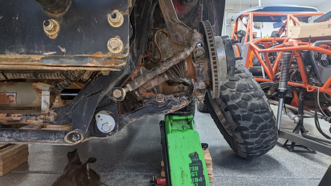

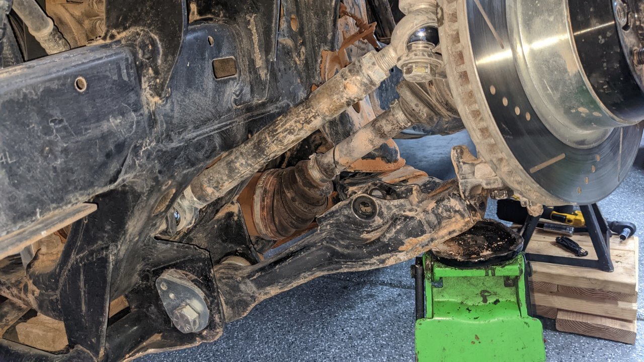

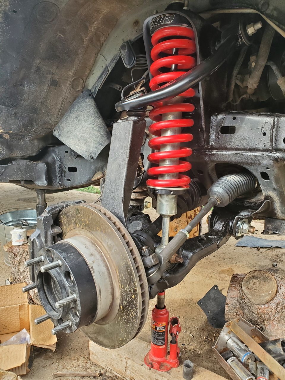

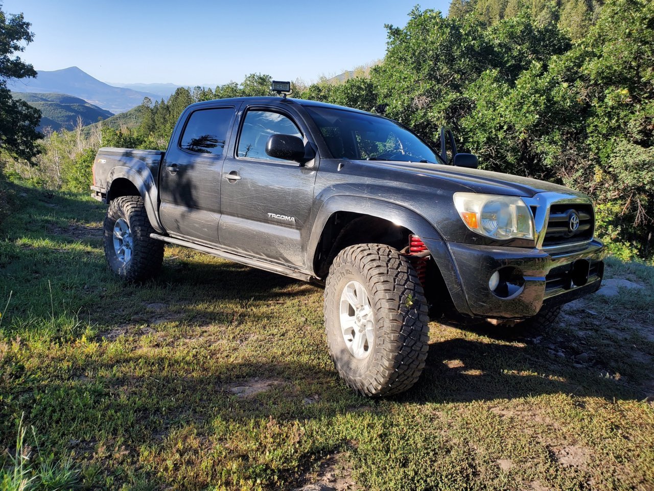

    This thread took me down the rabbit hole from 35s a year ago. The truck is far from finished but it's on 37s for now. The KM3s are definitely undersized but they've been a good tire. Currently on stock 4 Runner wheels and 1.5" spacers. Beadlocks are coming this spring.
    Fitting included: Cutting the cab mount back to the nut, tubbing the firewall back about 3/4", hammering the wheel well up 1/2" or so, trimming fenders and bumper. Also removed the wheel well liners (will be replaced with rubber) and relocated the air intake. I cut and shifted a new set of stock LCA forward 1/2". That seemed to be as far as I could go safely without pushing the coilover too far forward or pushing the CV into the coilover. Added some reinforcement plates when I welded them back together. Along with maxing out the caster with Taco tabs, I gained 3/4" or so from what it was prior. Did an front end refresh (tie rods, wheel bearings, UCA, etc) and added JD Fab spindle gussets. Stock UCA with a tiny bit of grinding inside allow for the full range of travel without moving the tire backwards toward the firewall. Rear end is on Icon springs and a 14" shock relocation. Steering is up next. The stock rack is ok so far but I'm not wanting to trust it forever.

    @PathFinder1776 when you say you shifted the lower arms forward by 1/2”, do you mean you cut the pivots off and rewelded new ones back on 1/2” forward?
    nice fab work btw! Good to know others out there arnt afraid to make the necessary changes to make 37s fit I like.

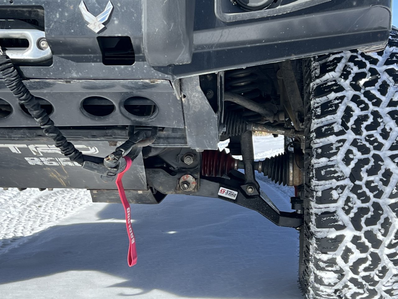

    Got my LCA’s on finally. Did a little snow-wheeling.

    What LCAs are you running? Stock axels?
  18. Feb 23, 2023 at 12:58 PM
    #1438
    Operator8
    Operator8 Well-Known Member
    Sep 14, 2021
    #377040
    795
    Woodland Park, CO
    2005 White Tacoma TRD OR
    SAS INW
    Solo Motorsports, and CVJ axles.

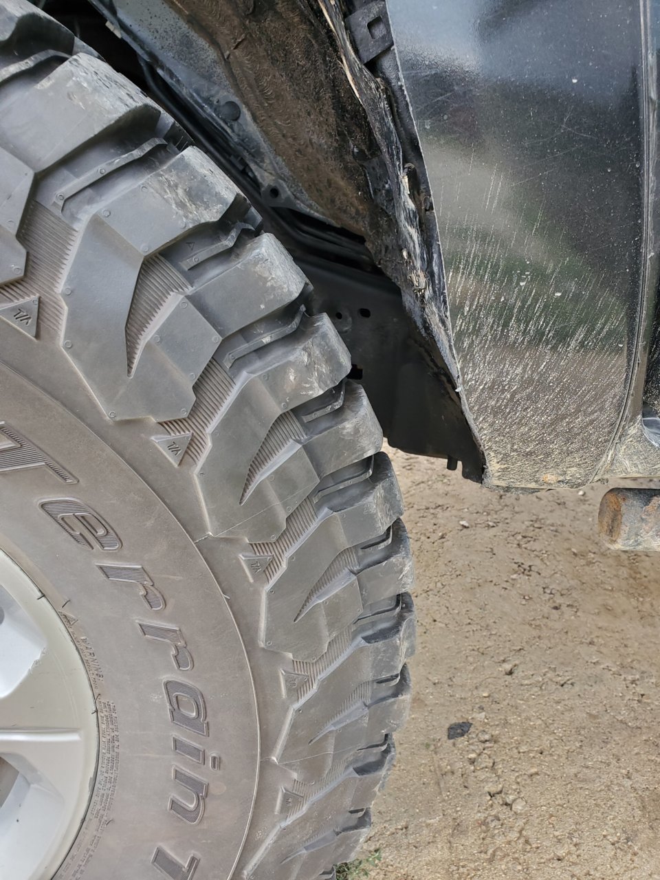

    I removed the bumps and went as high as the tire would go, then cut 3/4" past that and still ended up destroying my fenders with the tires.
    You can see in these clips where the fender was bent from tire contact
