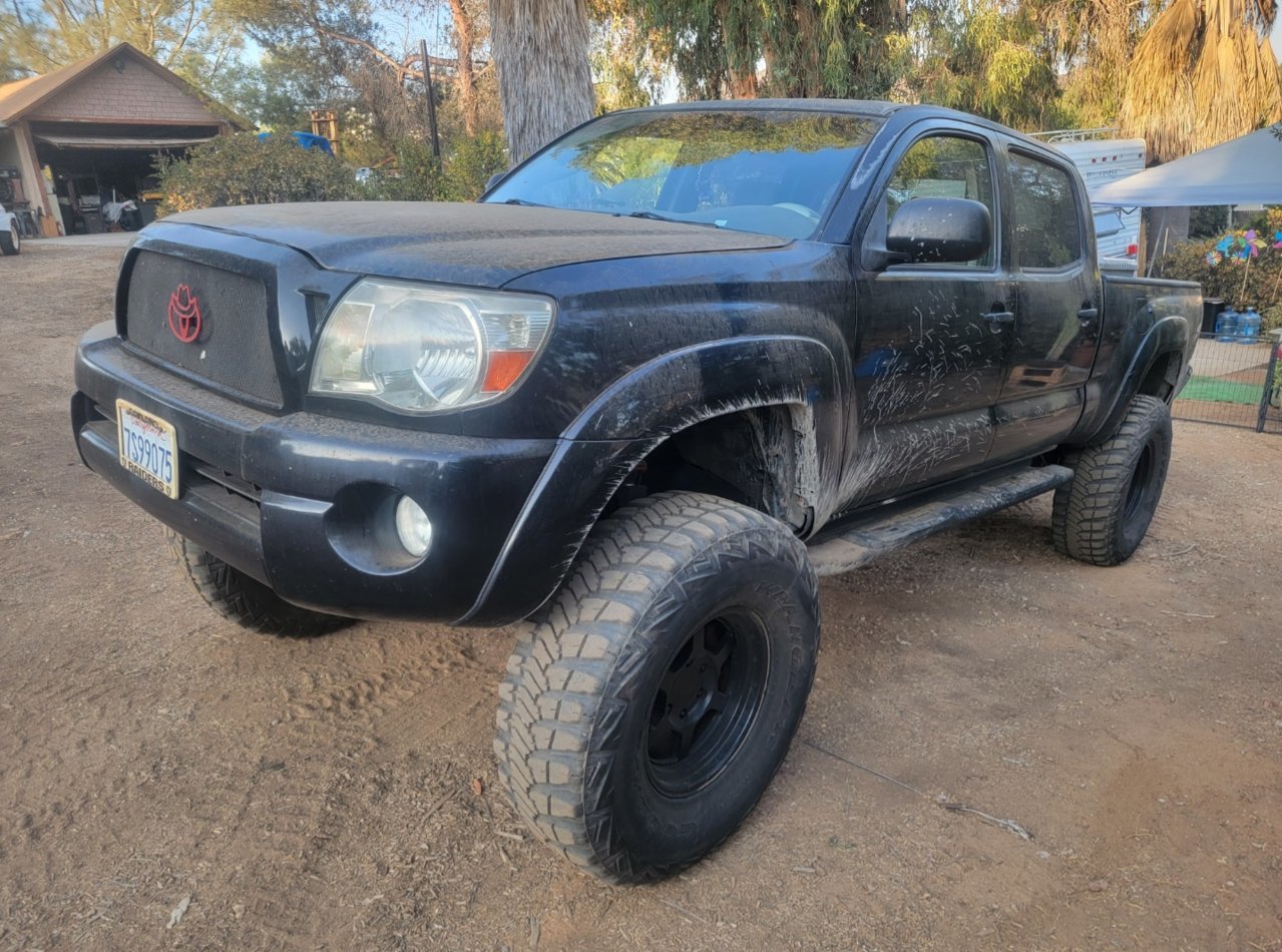

    Cut off a little of the pinch weld and beat the rest of it flat. I cut off some of the flares, fenders, and inner fender wells. Cab mount is in stock location and is missing most of itself. Plus some other stuff. I didn't cut out any of the cab corners. It never rubs anywhere including at the battery mount. 37/12.50R17

    If i remember correctly, your not on a standard 4wd 3 inch lift. Your either lift spindles or drop bracket.

    Nothing is standard bolt on and go on mine which is how I like it.
    It almost sounds like you think my truck has 33's on it. If that's the case, it's not my problem you can't think outside of the box and/or read and figure it out.

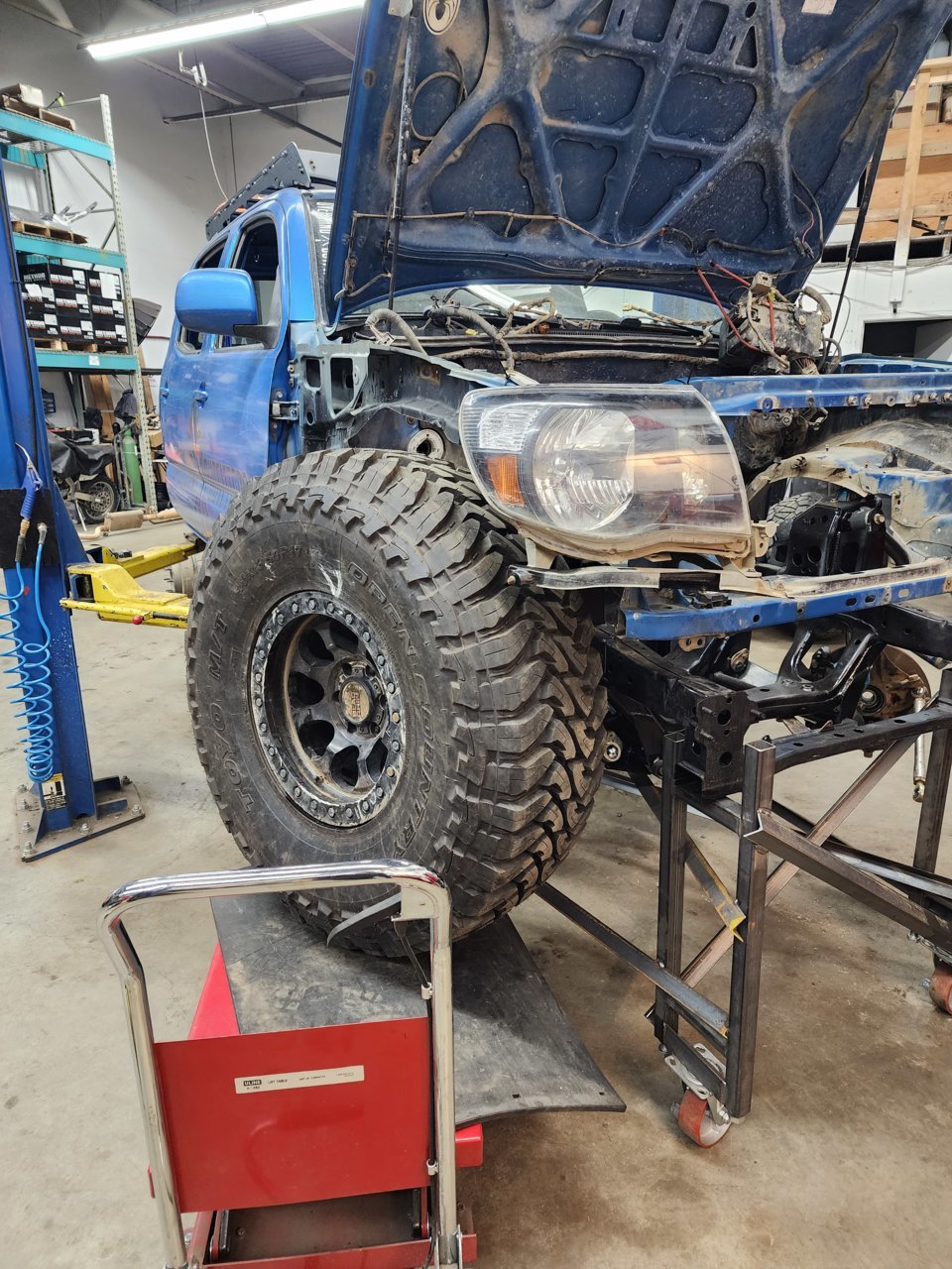

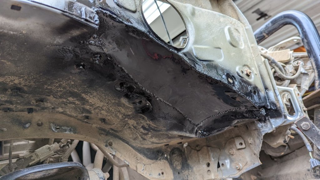

    Here's what I had to do. Most people would need to do similar to be able to wheel their truck without rubbing on 37s.
    Batteries relocated, washer fluid tank moved/modified, all wiring moved, intake relocated, firewall tubbed, fenders cut out quite a lot.
    Here's where I'm currently at now that I'm putting in a new frame, LS swap, and 40s

    I was going to ask how much more firewall you had to cut for the 40’s then I see you are just moving the entire cab instead. :eek:
    If I was cut much more of mine I start running into dash/heater brackets. An entire cab relocate (ECR vs CMR) is out of the range of projects I want to tackle. :rofl:

    I'm just moving the cab to make things easier because I'm swapping the frame anyway, there are a couple people running 40s without moving the cab. You do need to tub back to the door hinge though. Currently I could probably just sneak 42s, and if I tubbed the firewall to the door hinge, could go a bit bigger than that even. But that's all ridiculous, and I think 40s are a stupid idea on stock spindles/wheel bearings. Not gunna stop me though.

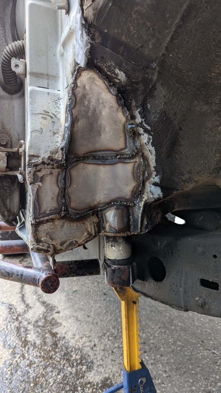

    Everyone on hear has a ton more experience than I ever will. But I do clear 37's. Except for one thing. My tires touch the upper control arm at full lock going backwards.
    This was how I did it.
    I'm not trying to convince anyone just a fyi thing.
    Tires are micky Thompson's Baja at. So realistically there clearing a 36.5. or 36. I don't know. Anyway not disputing anyone on heat just telling what I did.
    2 " body lift and see pics below.
