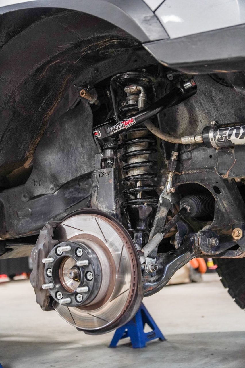

    No drop bracket here...fox 2.5 coilovers with rokmen race series uca. Stock lowers. Fenders have been trimmed a couple of inches, and bobbed/high clearance of course.
