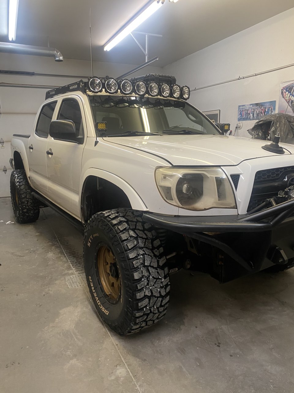

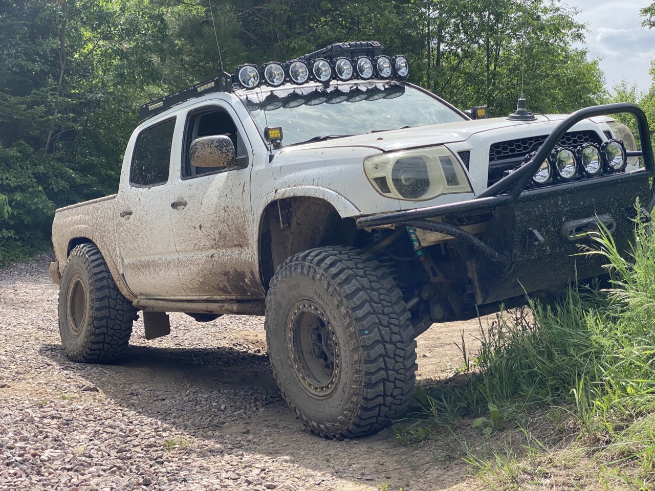

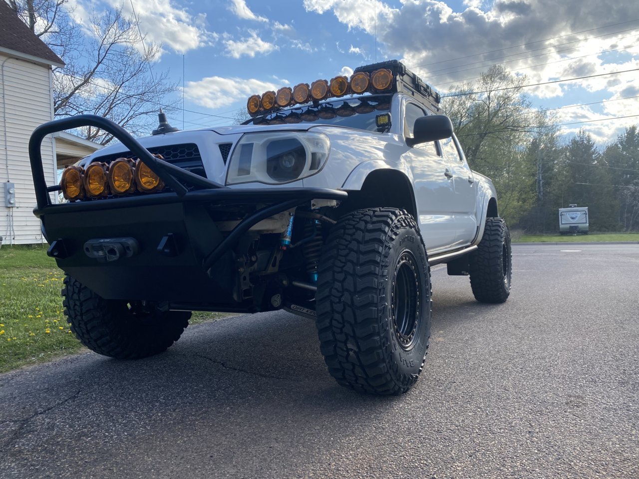

    Here are some pictures on the last setup.

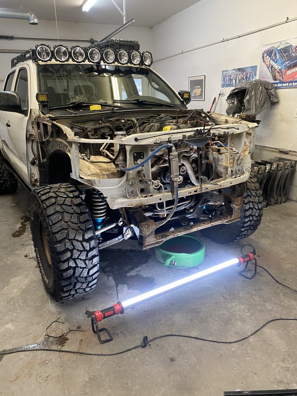

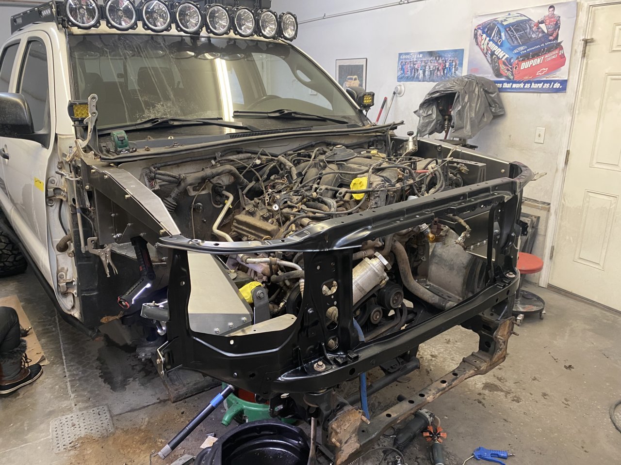

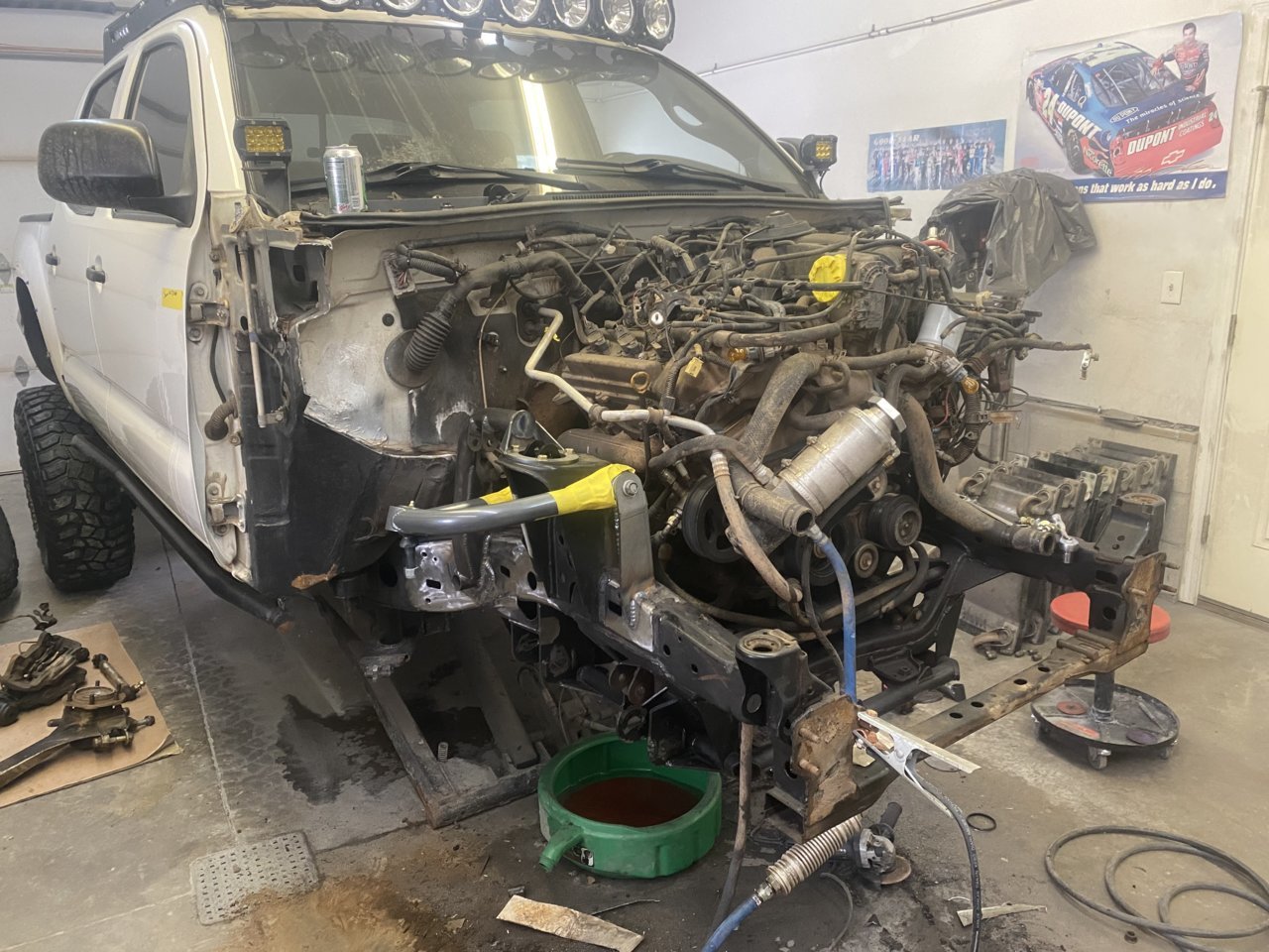

    On day 1 of pulling it in, the front tear down and prep for the JD inner fenders began.

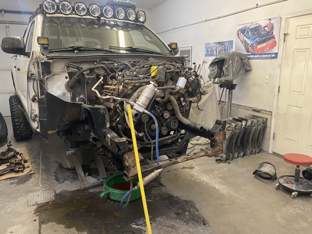

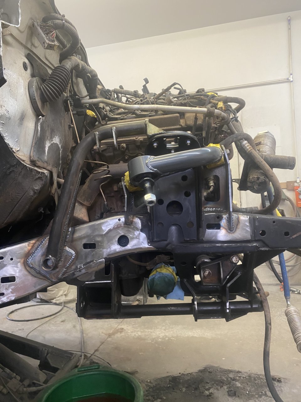

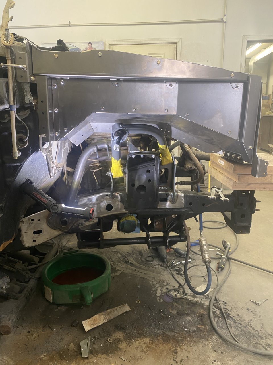

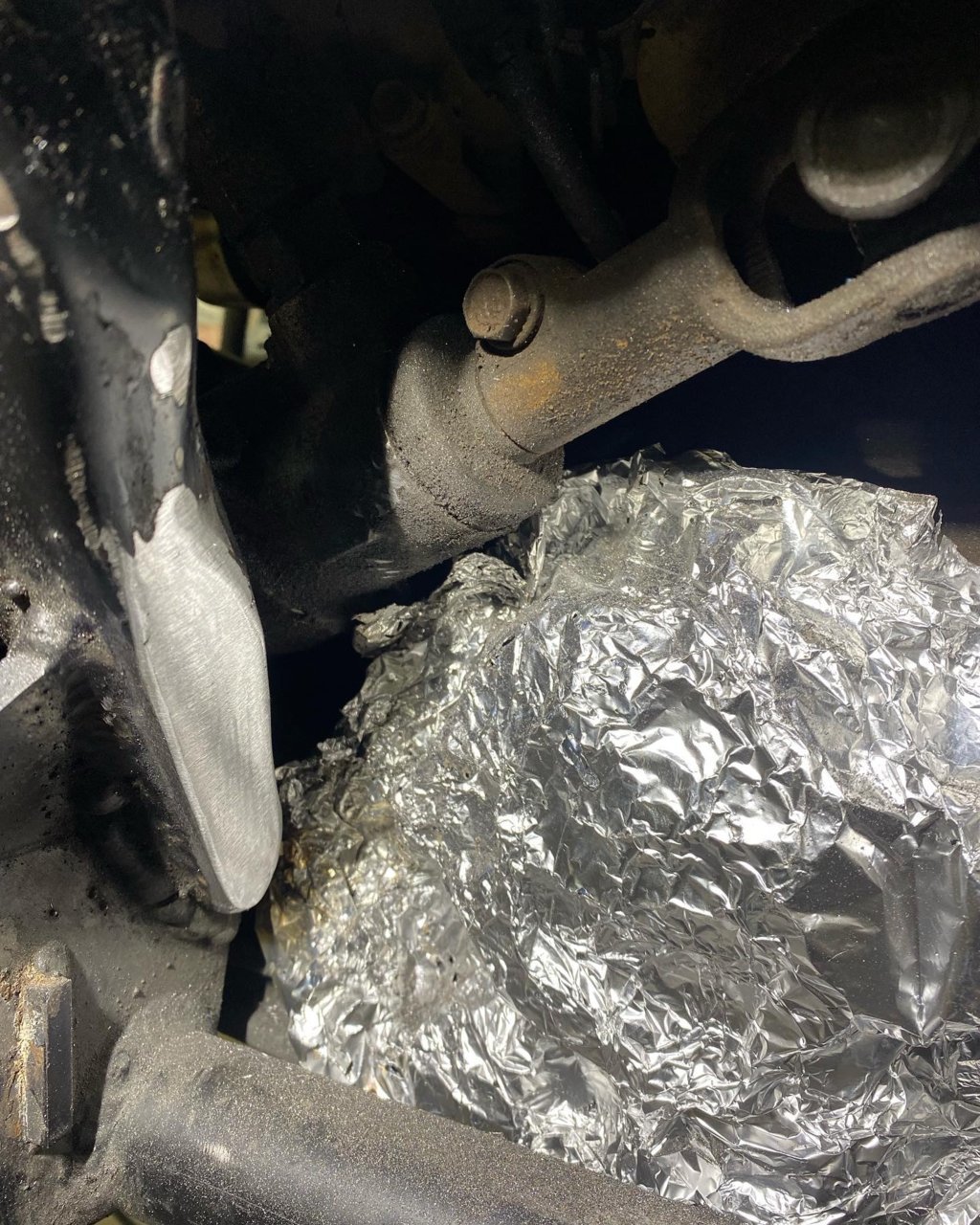

    With the inner fenders out of the picture, this seemed like the best time to weld the bypass mounts and UCA gussets in. Then it was time to start fitting the inner fenders. This took a crazy amount of time to get them in the correct position.
    The inner fender positioning directly impacts how your body panels fit back together when it’s done, so Taking your time is a requirement. It was an even bigger challenge for me as I was converting body styles at the same time.

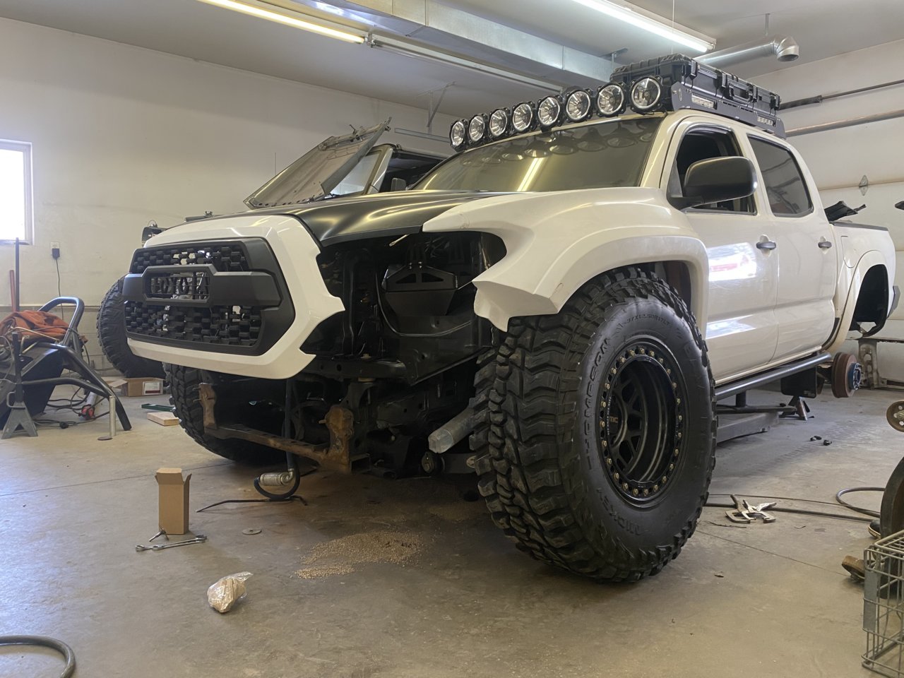

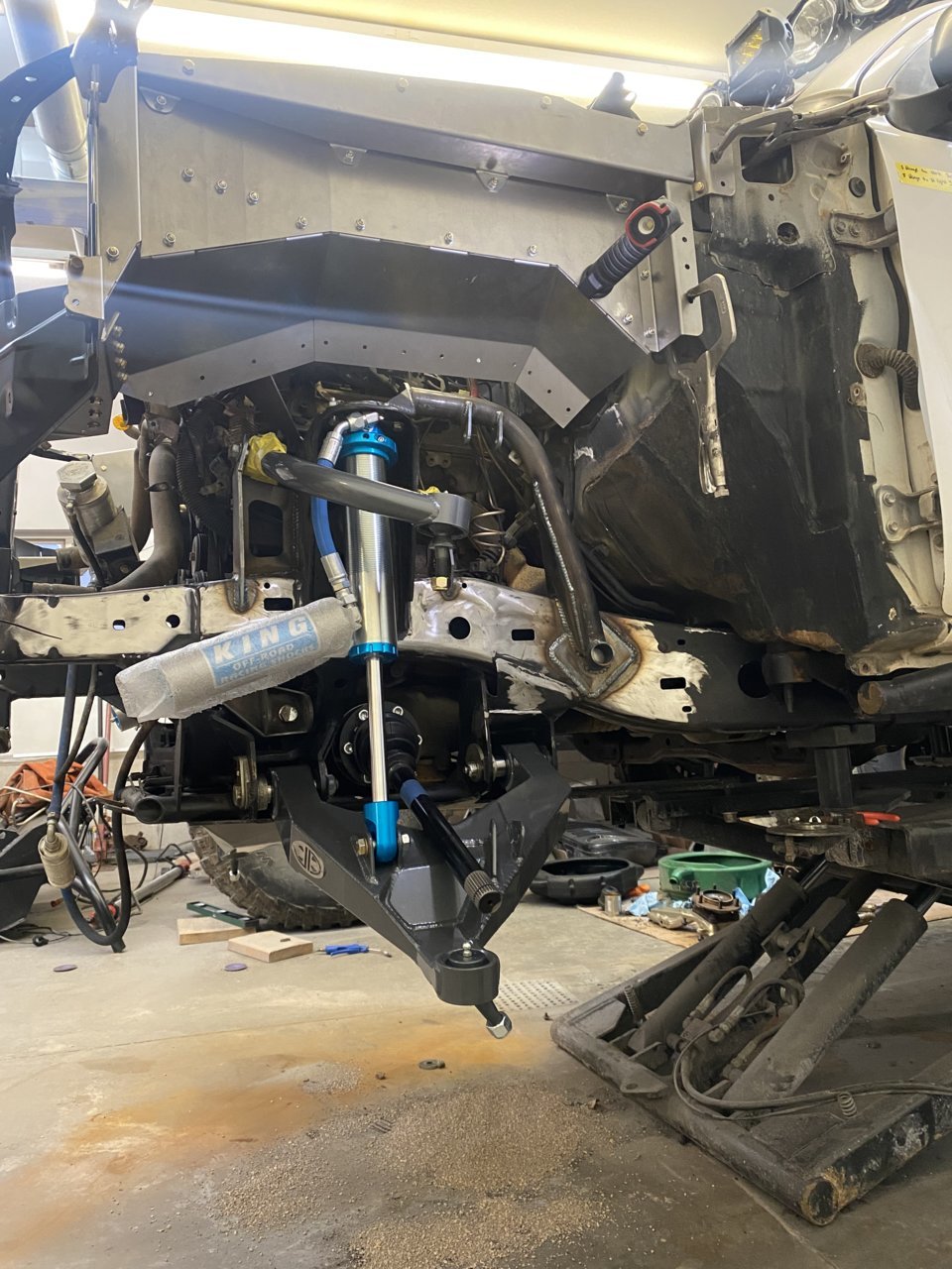

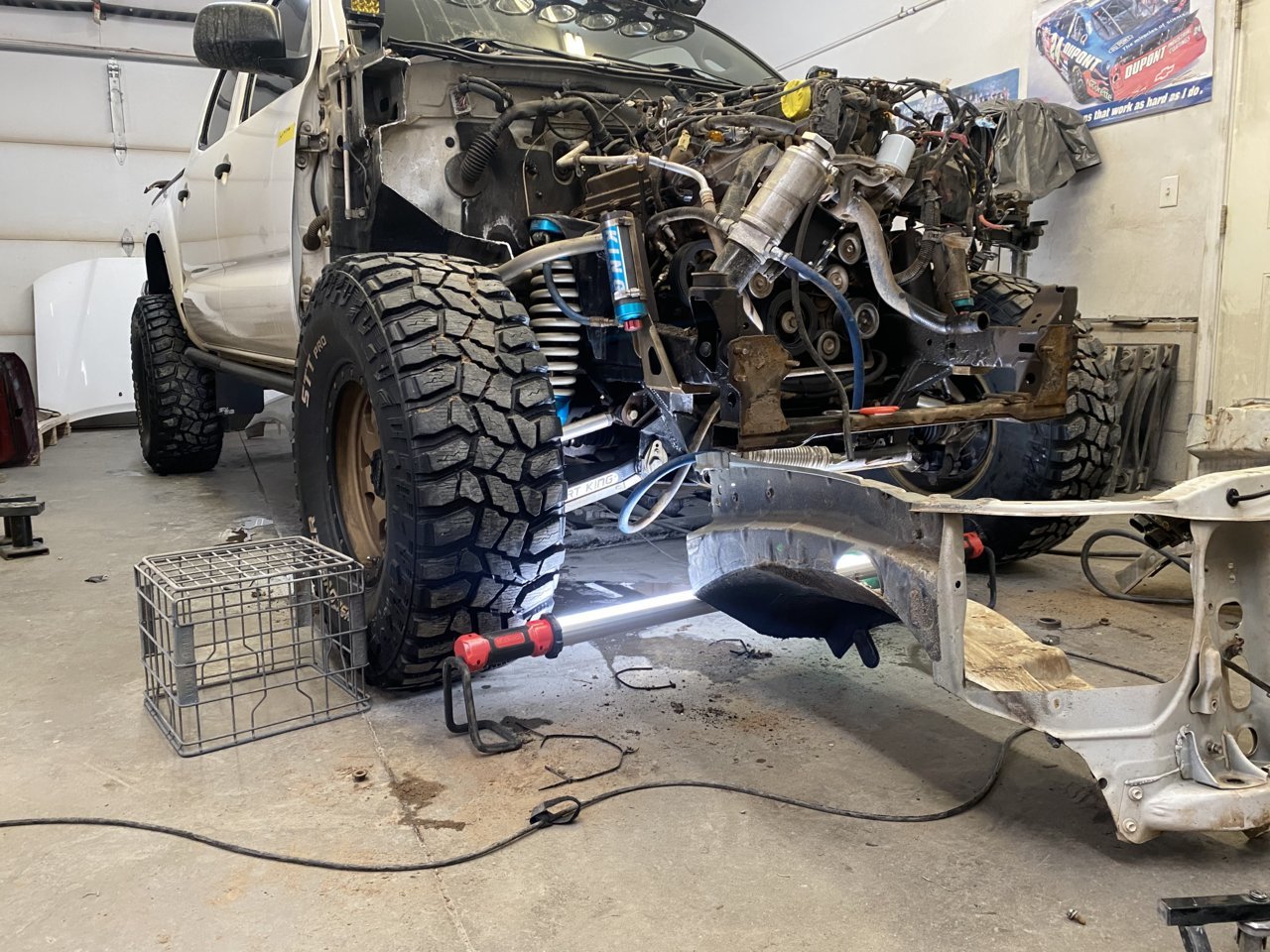

    The next step was installing the front suspension to cycle things and find the best position on the lower pivots. I also did the 934 frame notch at this time.

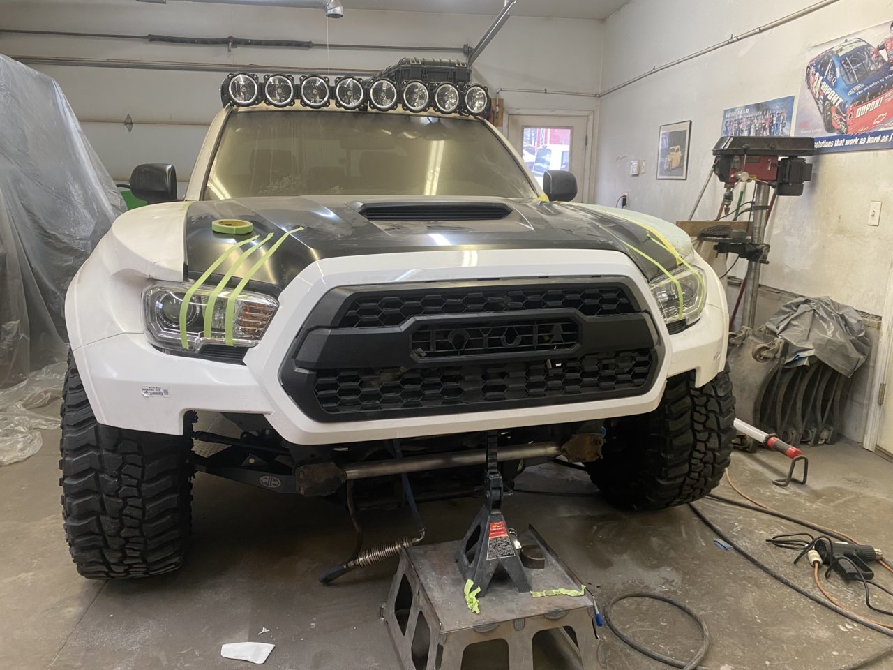

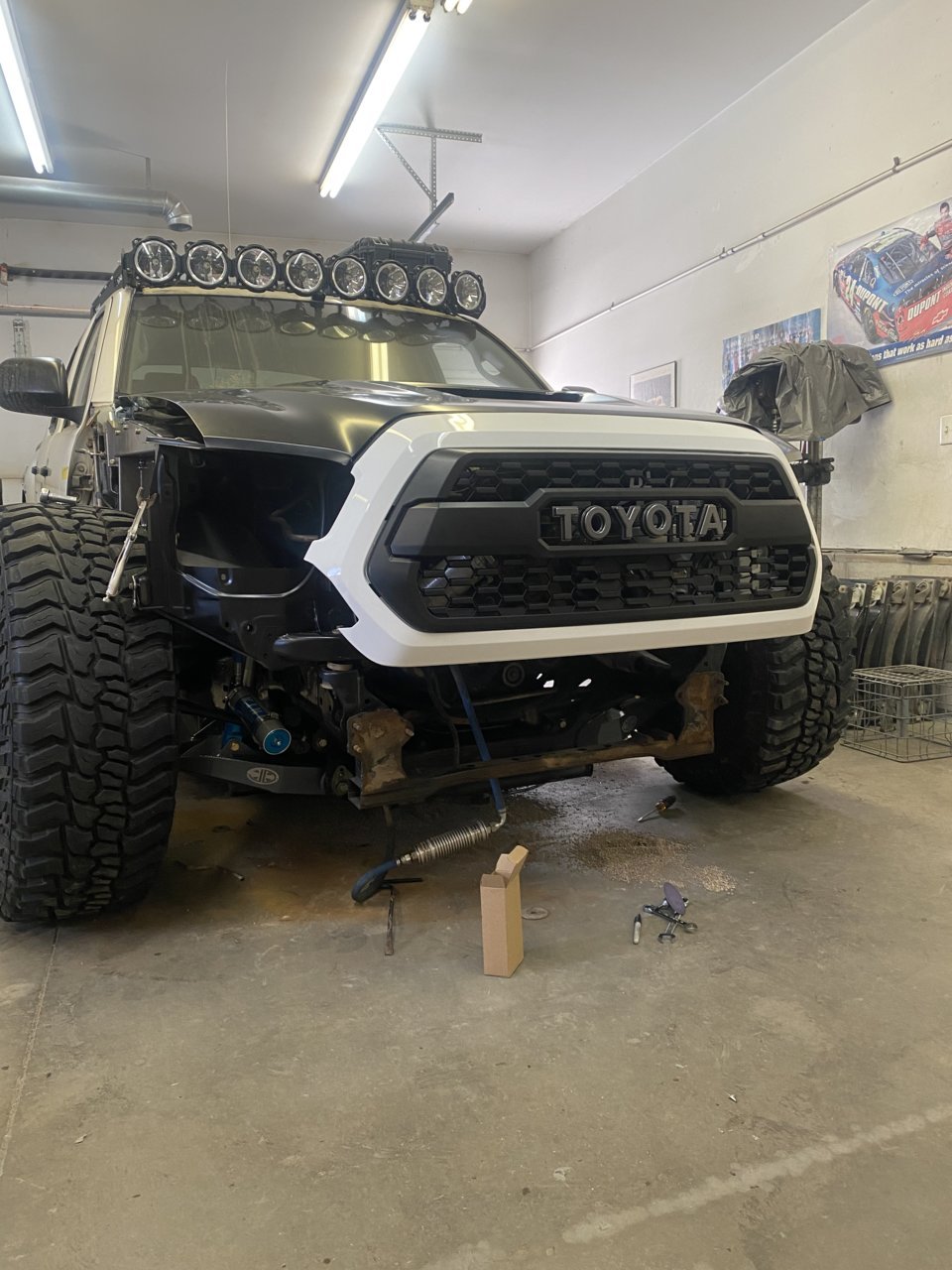

    Once the front suspension was cycled and the bump stops were setup, I then began fitting panels. The conversion is decently straight forward, but does require a decent bit of fab work when you get up to the grill and headlights. I will cover this later on.

    This is not a conversion kit. These are actually panels meant to be put on a 17+. McNeil offers a conversion but the glass was not wide enough for my needs. So I ended up going the hard route.
