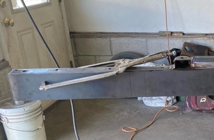

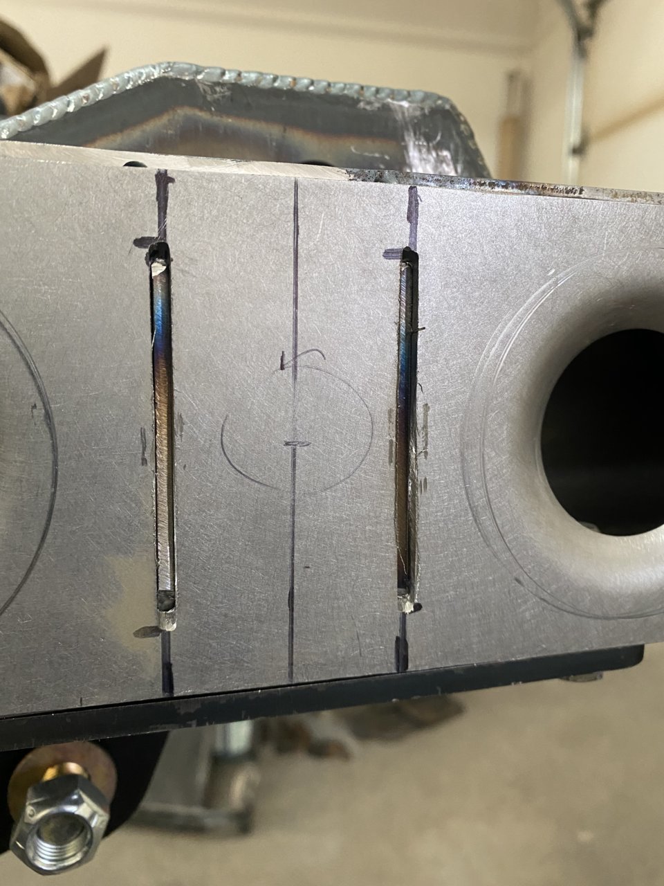

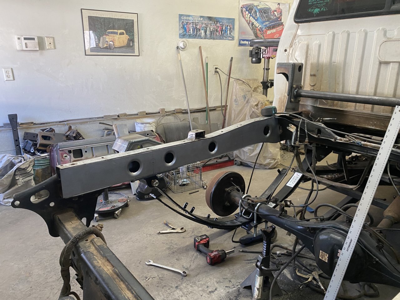

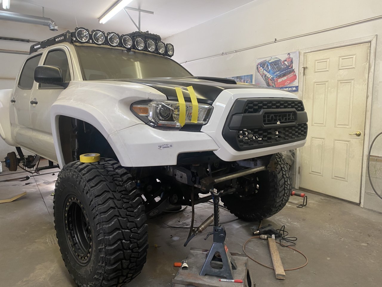

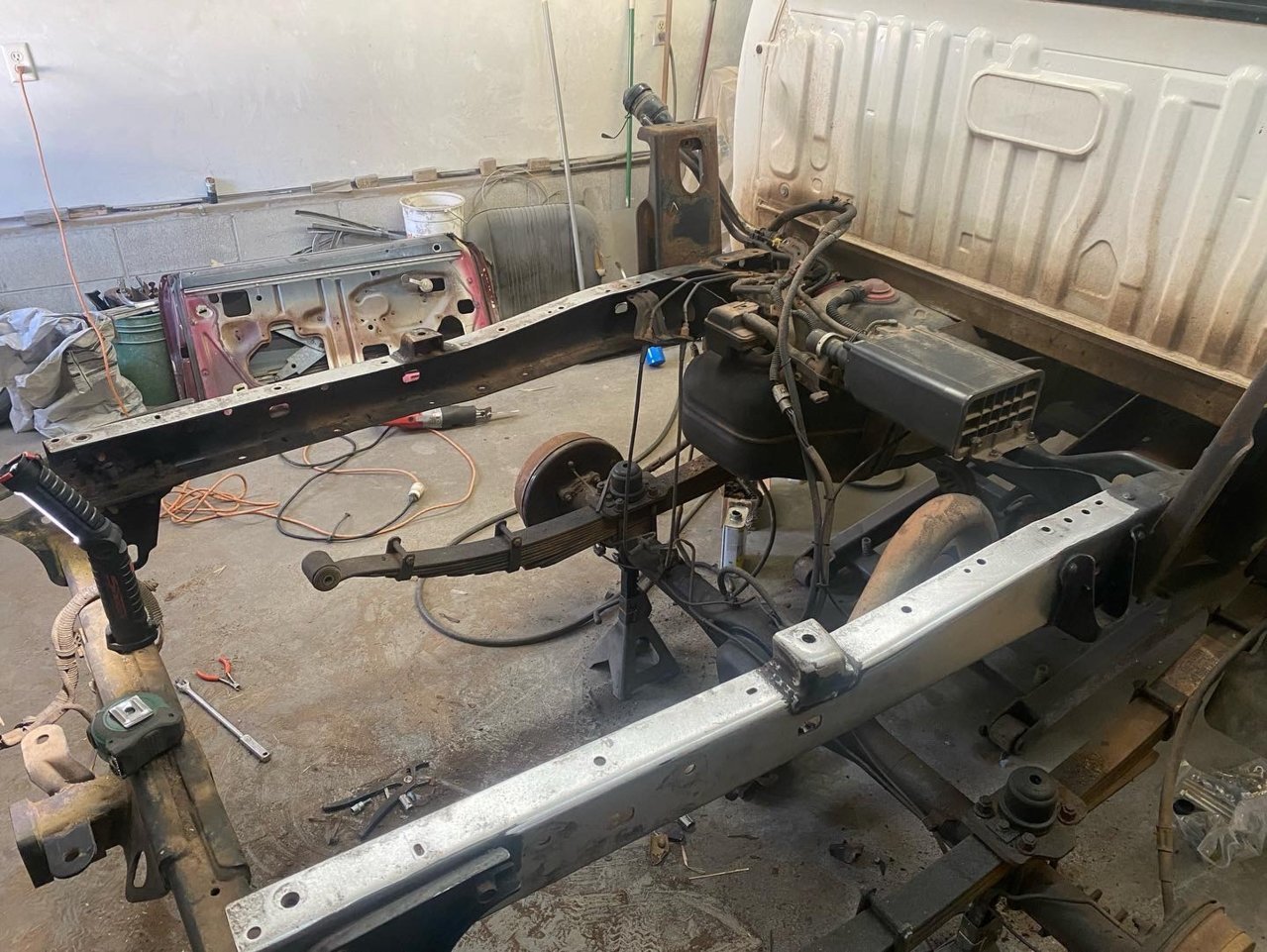

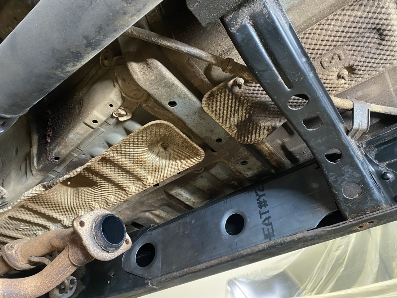

    After having the front fenders and hood set up I decided to move to the rear so I could have some time to think about how I would tackle the front grill and headlight mounts.
    A large part of this build is bracing and strengthening the chassis as much as possible. The amount these frames flex from the factory is pretty crazy. The entire goal on a build like this is to let the suspension do the work.
    The plates are made from 1/8” with internal gusseting at what will be the tube landings.
  3. Apr 15, 2022 at 5:12 AM
    #23
    EatSleepTacos
    Mar 24, 2015
    #151688
    59,836
    Randy
    West Valley, AZ
    2017 4Runner
    Now that's a fucking clamp!

    The long ones are so nice for a lot of things! It’s a literal life saver at times.

  5. Apr 15, 2022 at 9:24 AM
    #25
    WormSquirts
    WormSquirts Armageddon
    Dec 18, 2015
    #172583
    2,896
    Braeden
    BC
    Did you box the down turn to below the cab as well? That's the area where it flexes most imo. That's also where my frame started to crack after reinforcing the frame where you did.

  6. Apr 15, 2022 at 9:34 AM
    #26
    906taco
    906taco [OP] Well-Known Member
    Jun 22, 2021
    #369289
    3,892
    Cory
    08 Taco
    I will be boxing the entire frame.

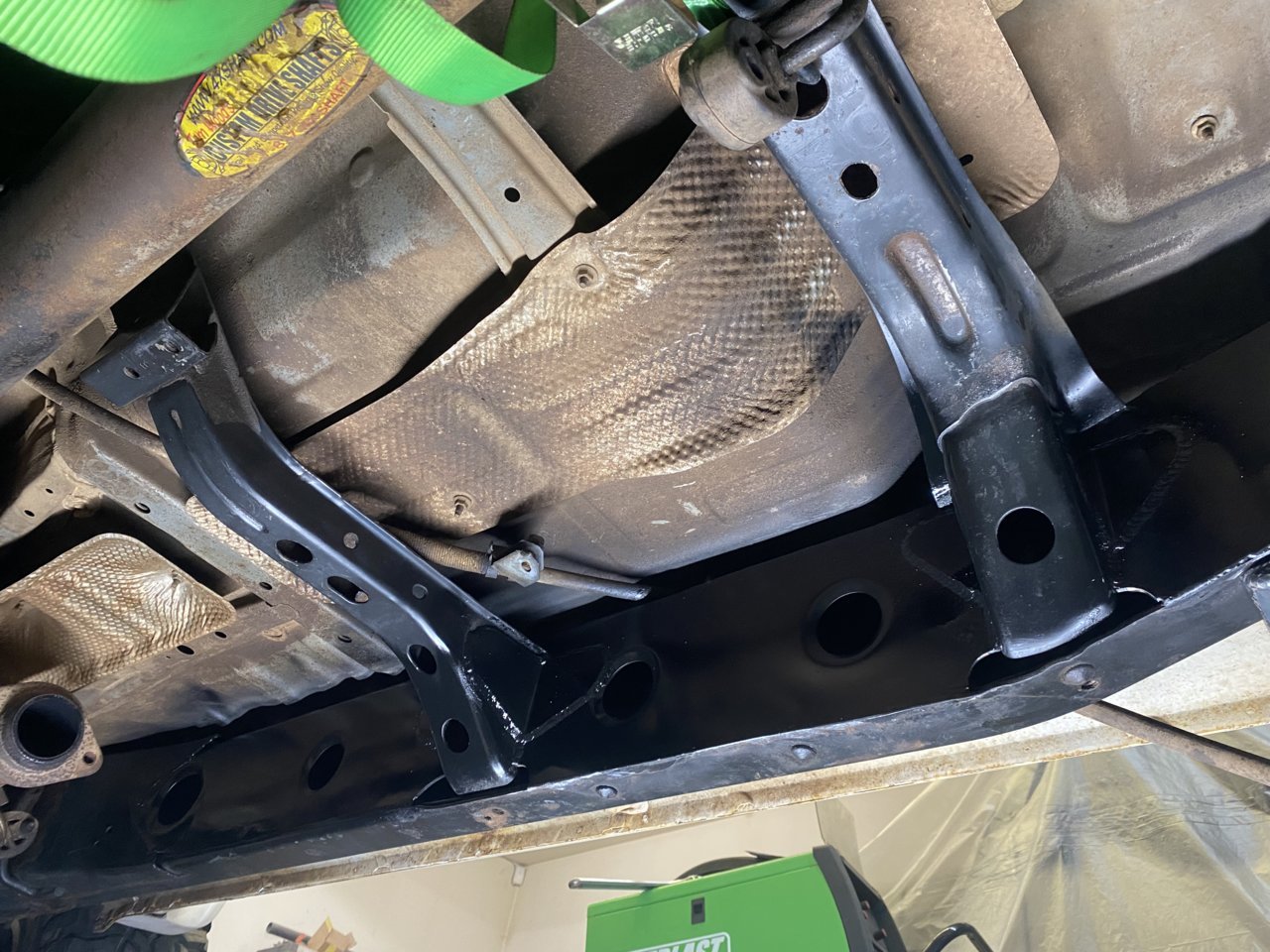

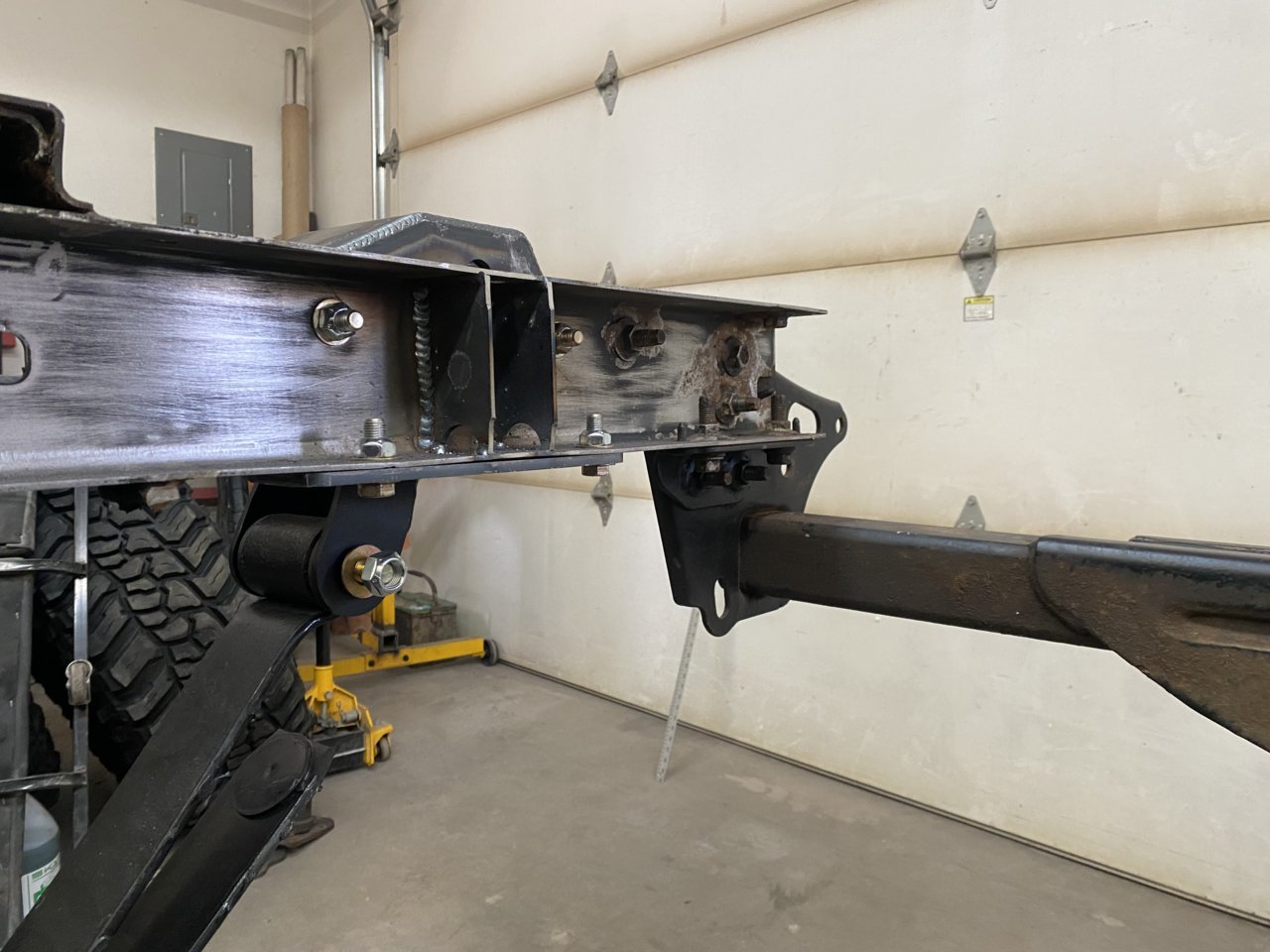

    08 Taco

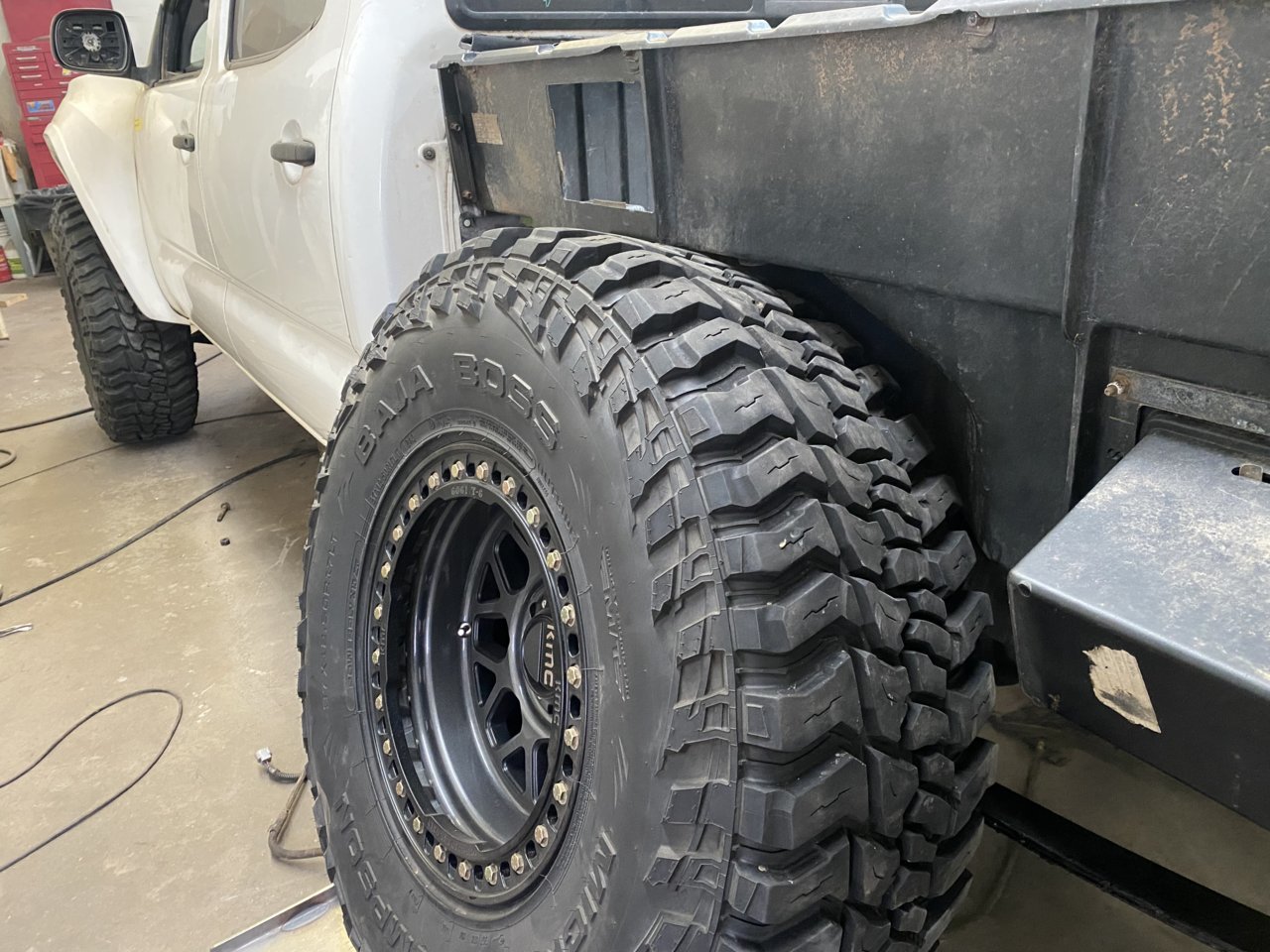

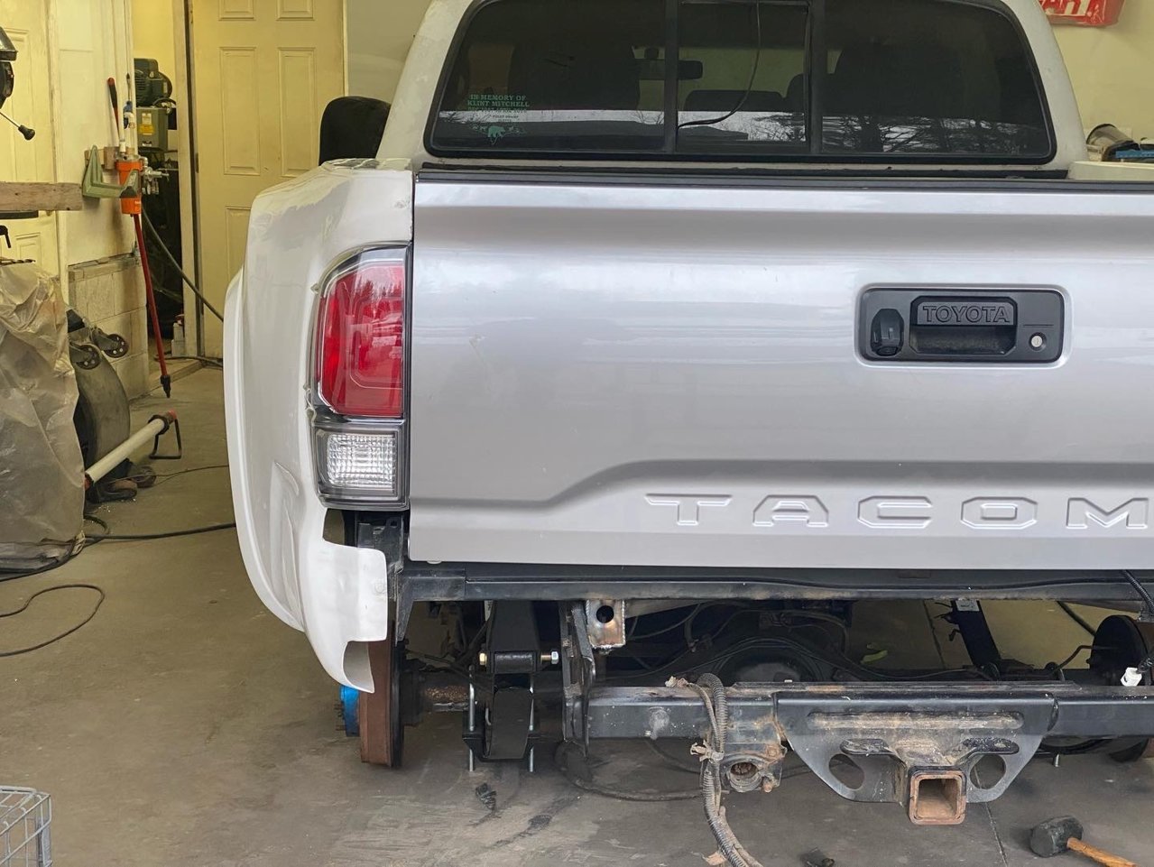

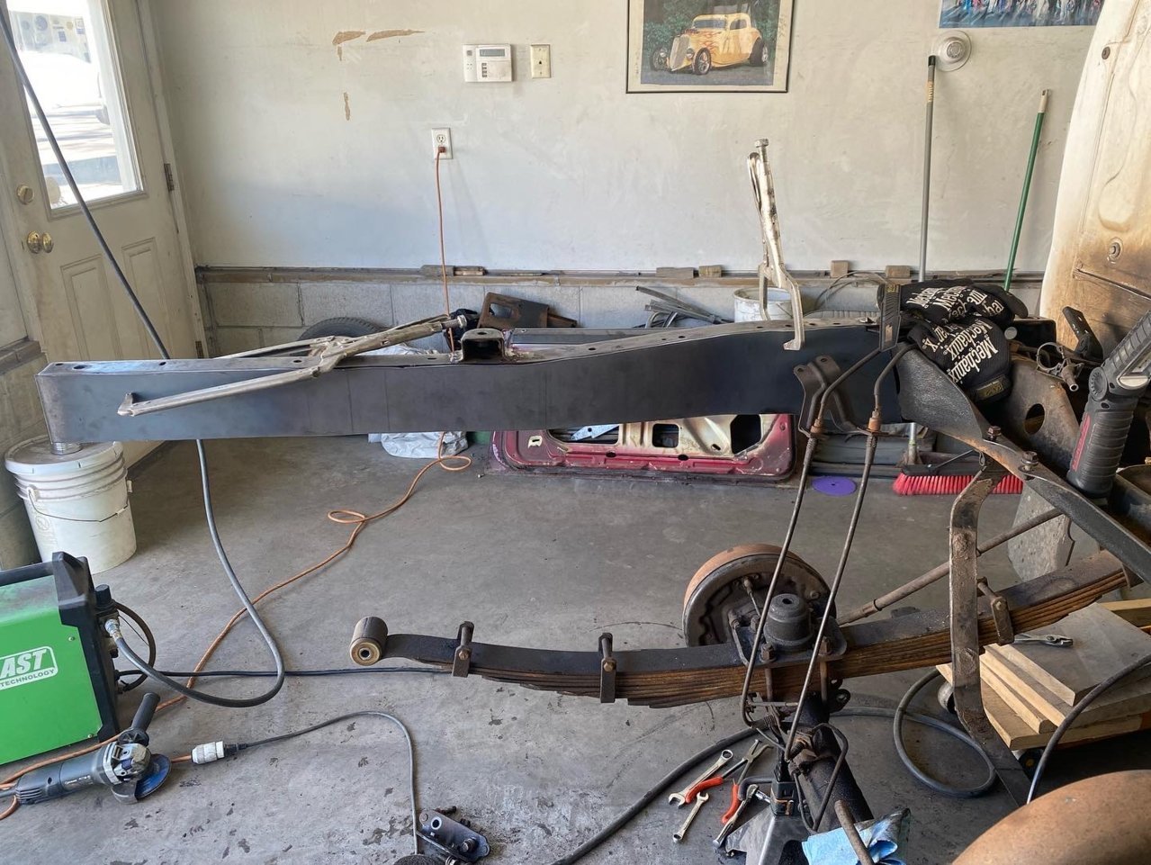

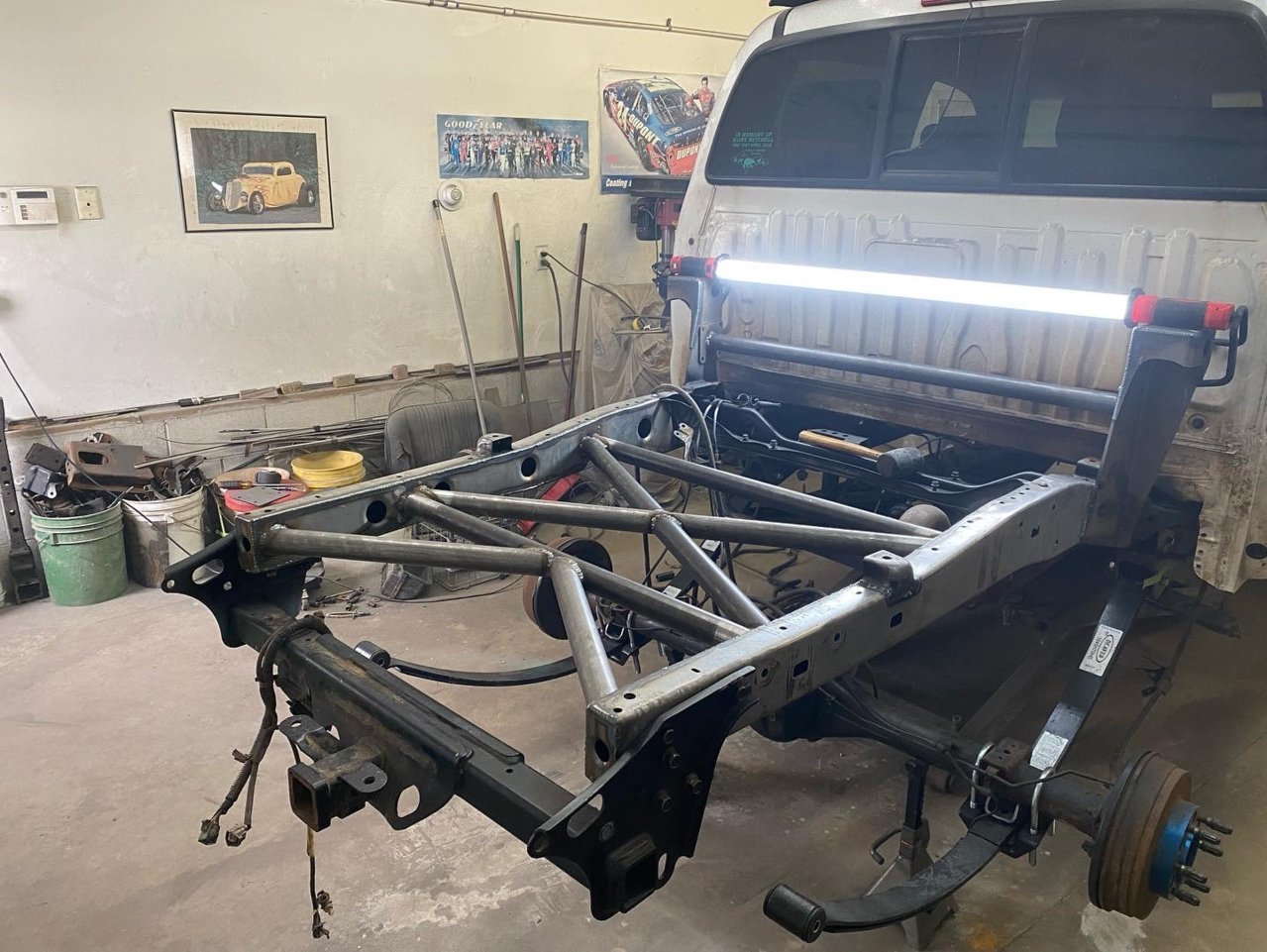

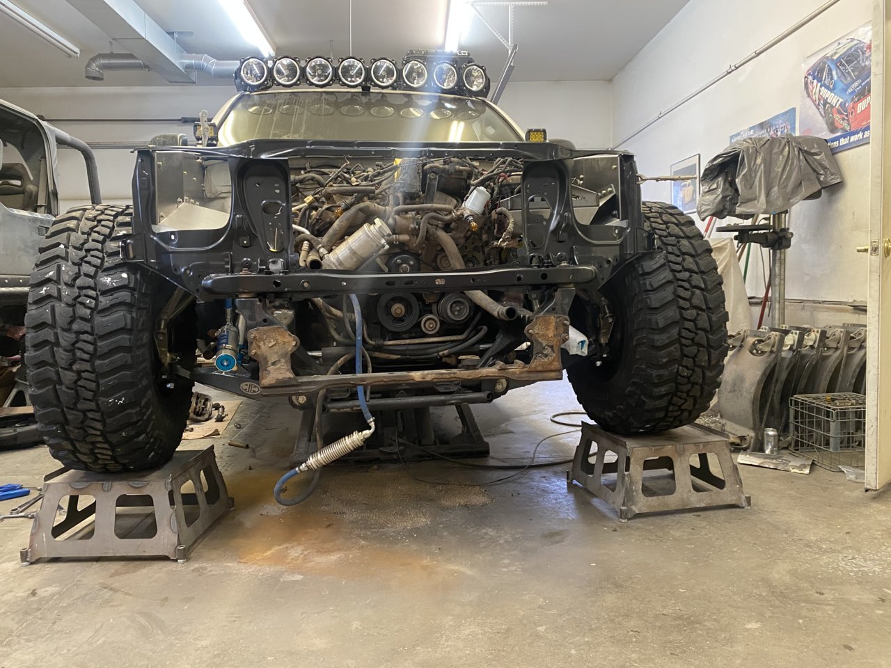

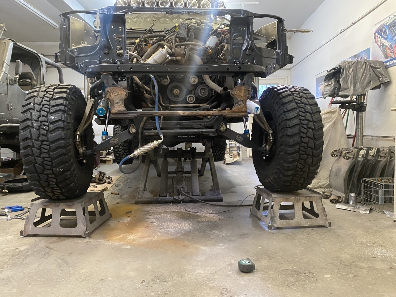

    With the frame plating finished up, I then moved on to cycling the rear end and fitting fiberglass.

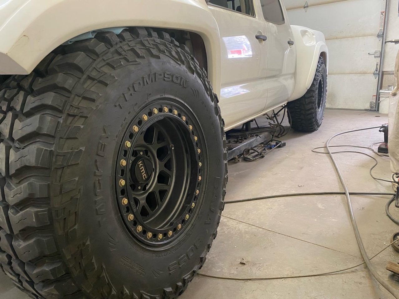

    With 37’s and SUA it puts the tires right into the bed. My plan is to tub this area out and make a sheet metal panel.

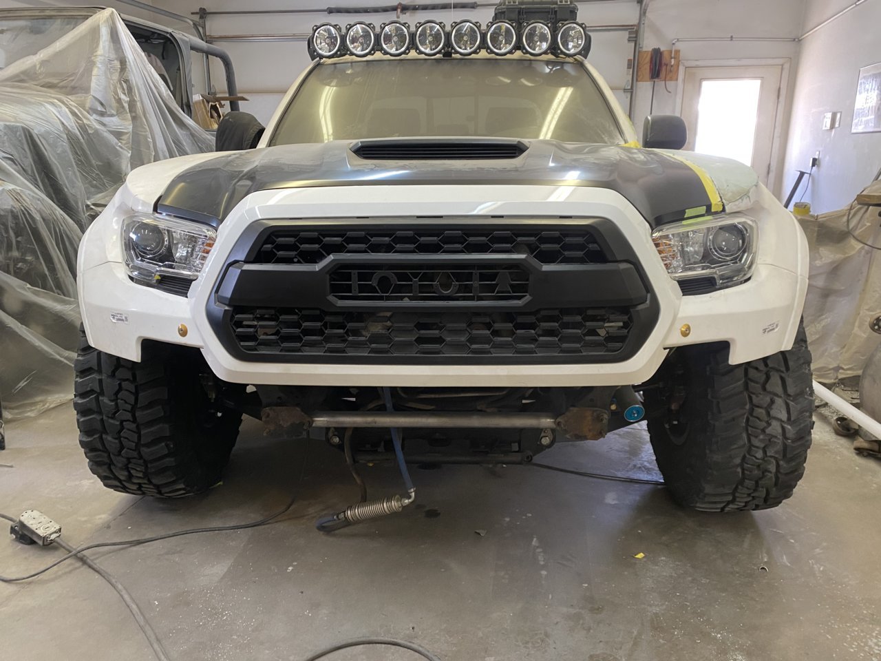

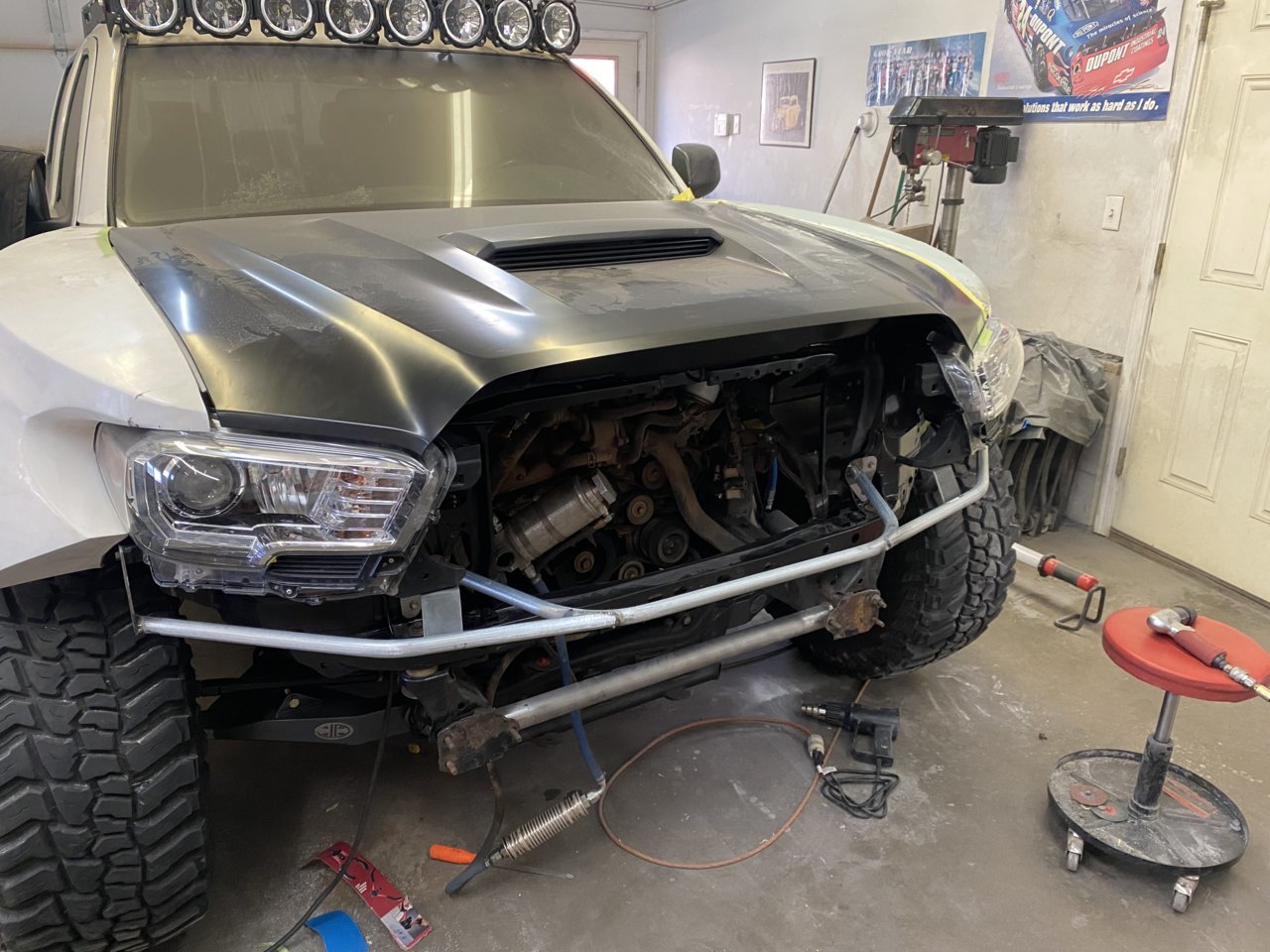

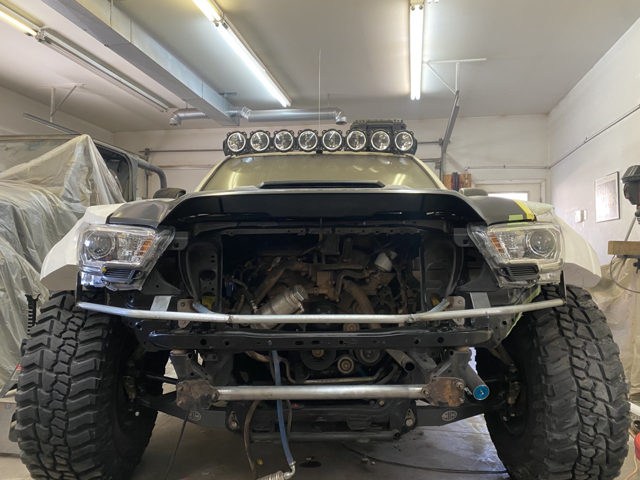

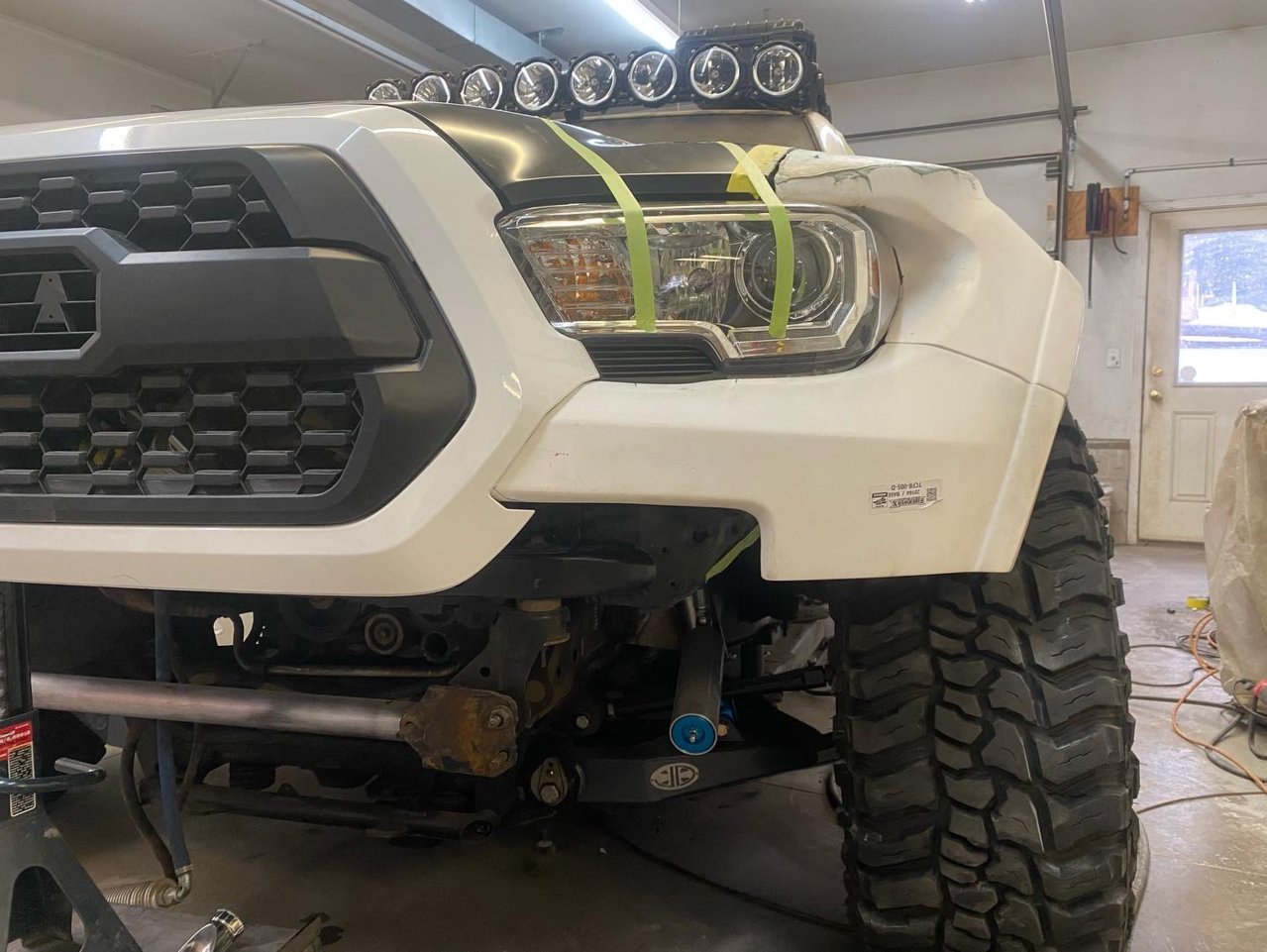

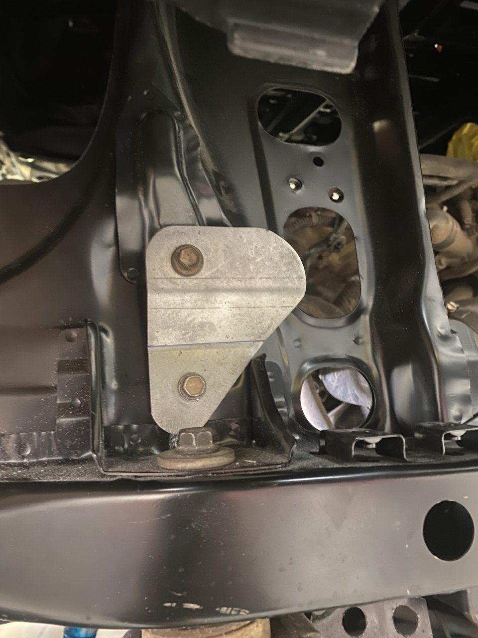

    After wrapping up the majority of the rear, I hopped back on the front clip and started fabricating the mounts for the headlights and grill.
    This was a little challenging to do as only a couple of mounts on the second gen core support worked, so nothing was really supported in any fashion. Tape and patience saved the day. I used 1” 16g tube for this. It is considerably more stout than what the factory trucks have. Hopefully this saves some headlights from breaking.

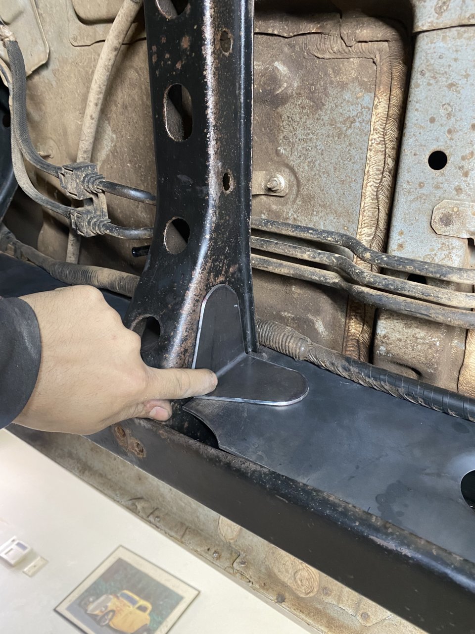

    08 Taco

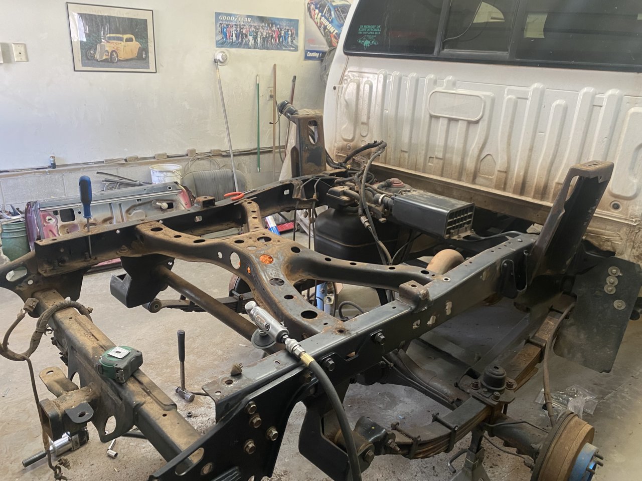

    The thread is essentially up to speed on the build right now. I will probably do weekly updates at this time.
    Over the weekend I started making the rest of the frame plates. I have a little work left on these before I burn them in.
    After these are finished up I will begin transitioning over to body work and bumpers.
    Pending the arrival of my remaining shocks I really hope to have this wrapped up by June.

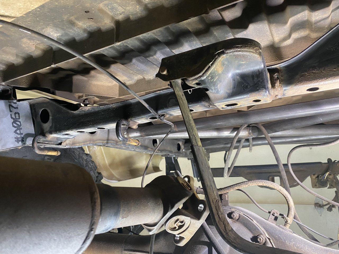

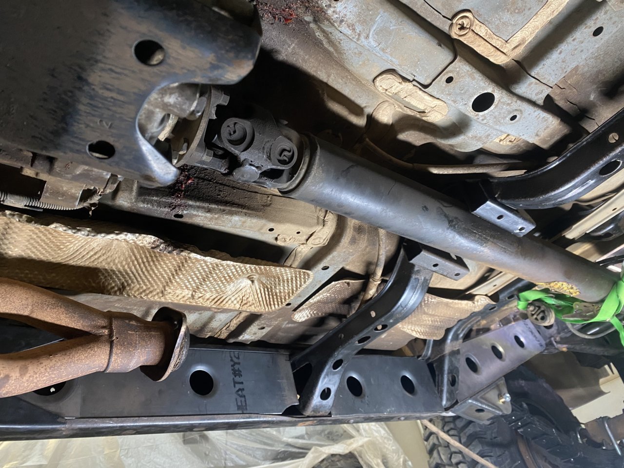

    After a very long, miserable day under the truck the frame plates are finished up!
    I will be moving on to bumpers and small stuff starting tomorrow.

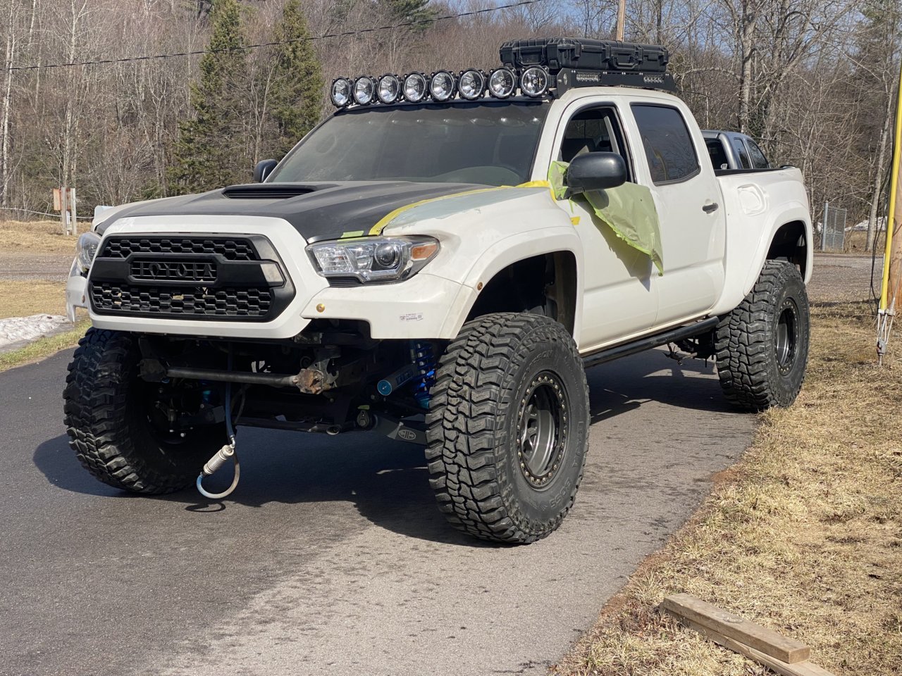

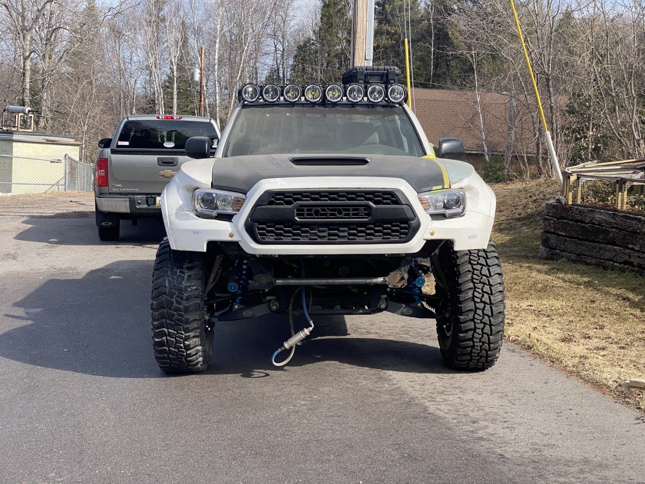

    Outside for the first time in almost 2 months!
