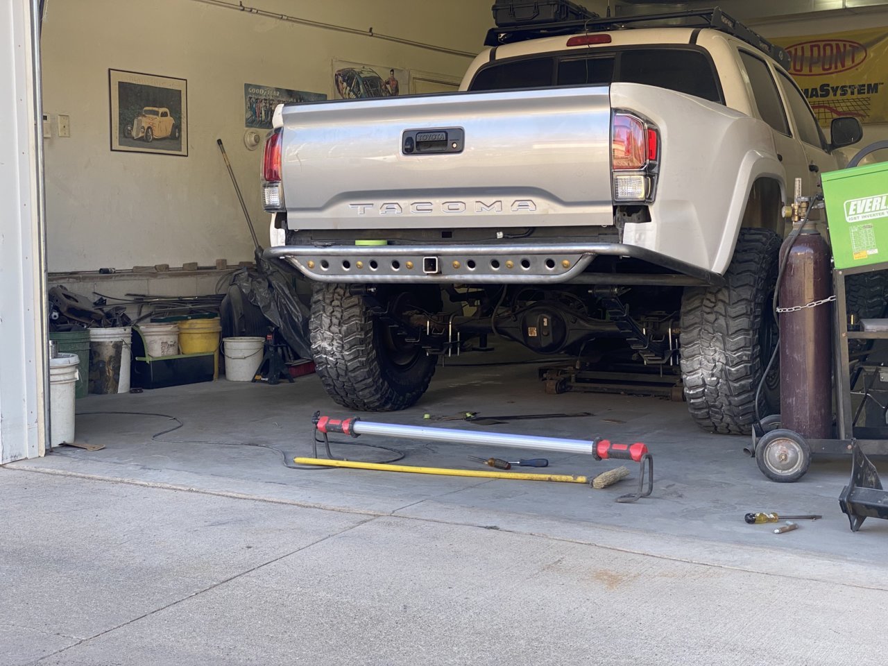

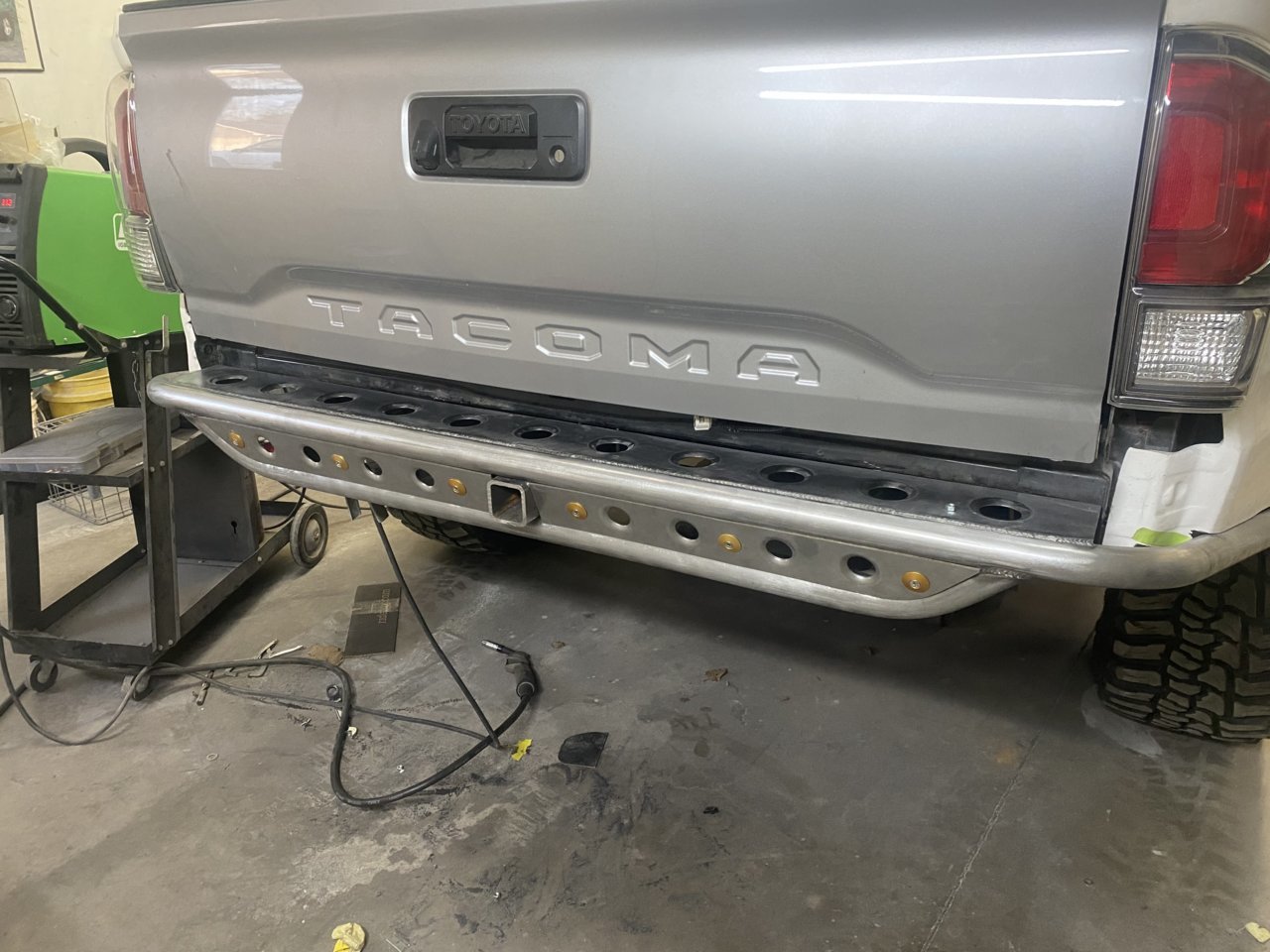

  3. Apr 27, 2022 at 3:30 AM
    #43
    906taco
    906taco [OP] Well-Known Member
    Jun 22, 2021
    #369289
    3,926
    Cory
    08 Taco

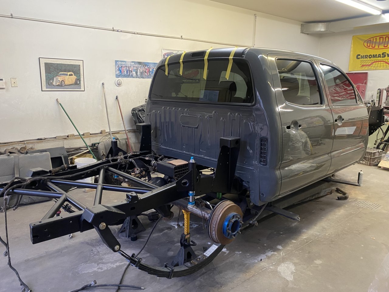

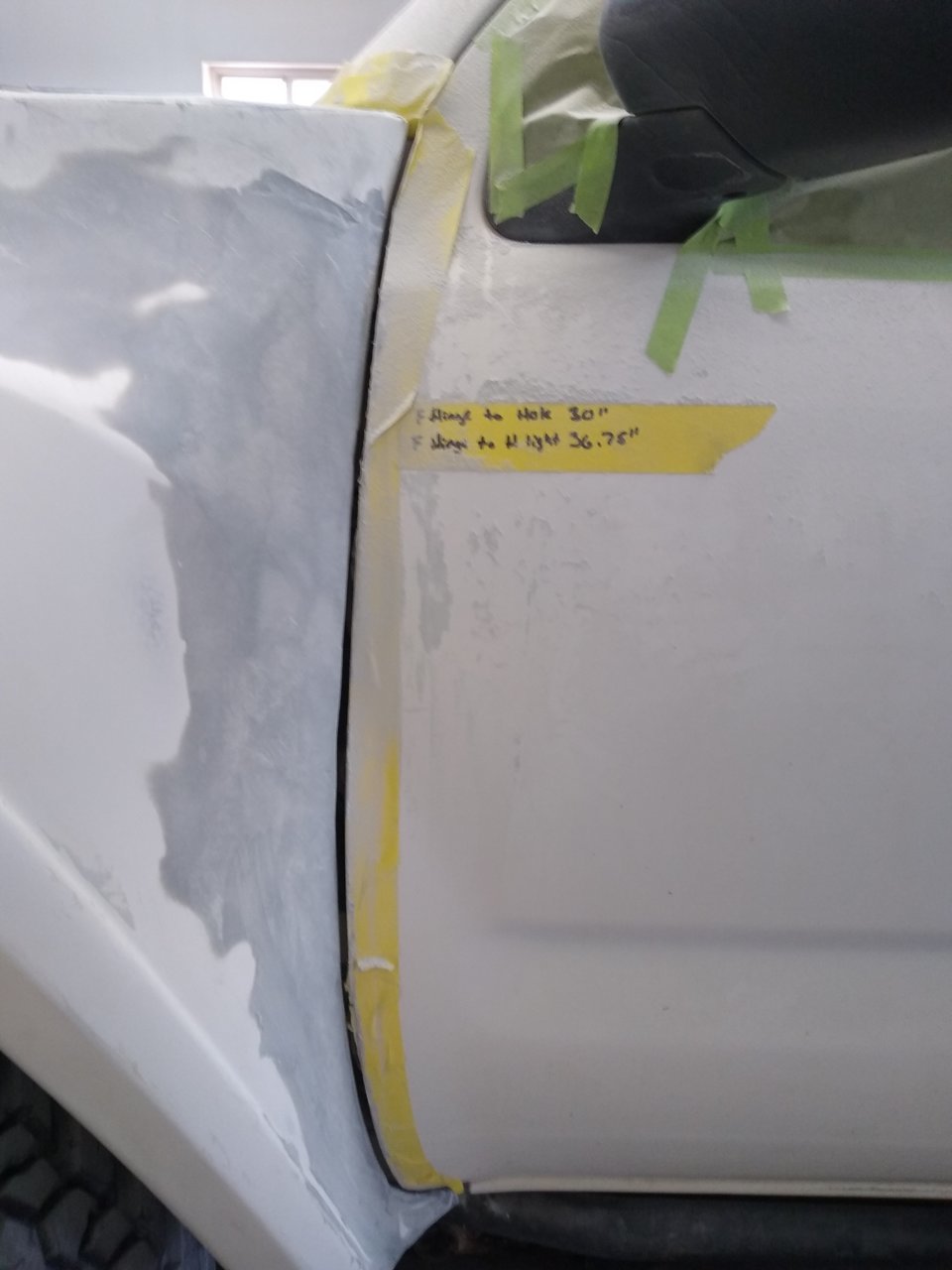

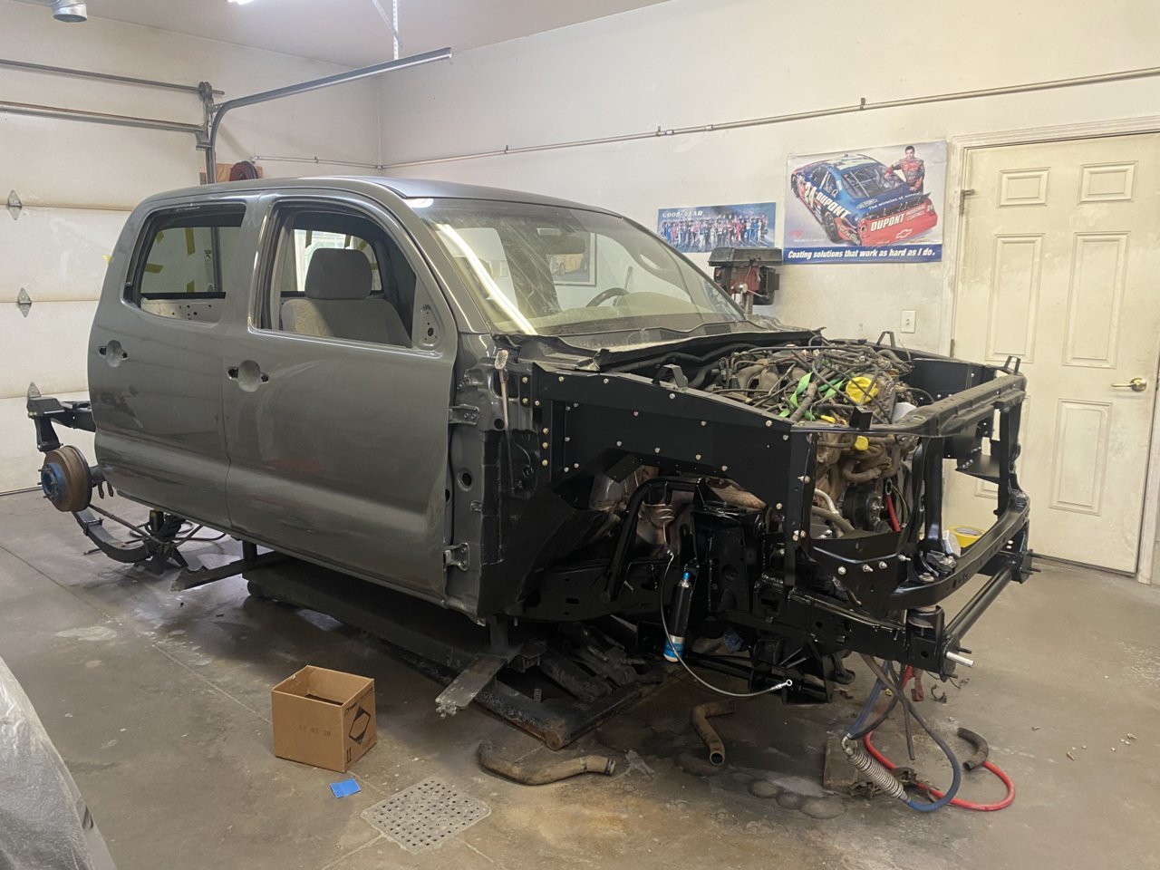

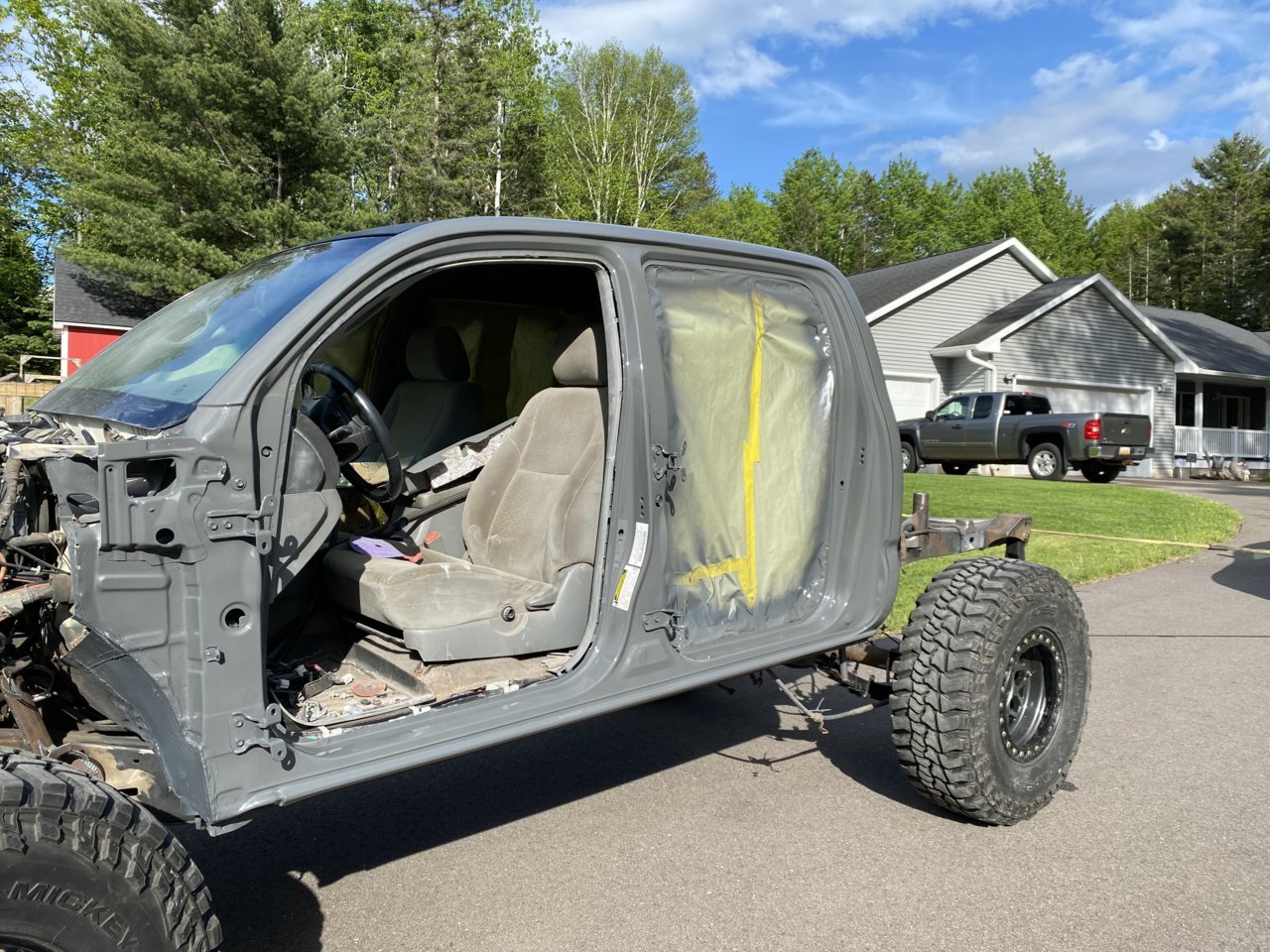

    Well, my Dad jumped into the body for me while I’m at work. Starting with cleaning up the gaps. Still lots to go, but I am very fortunate to have somebody like him with over 40 years in the body world.
    Doing everything start to finish in house is a major blessing.
    Rear bumper is well under way and should be complete by the end of the week. Then I’ll move on to the front.
    Officially at a full 9 month wait for shocks with nothing in hand yet aside from the coilovers. To say I’m nervous on that topic is an understatement.

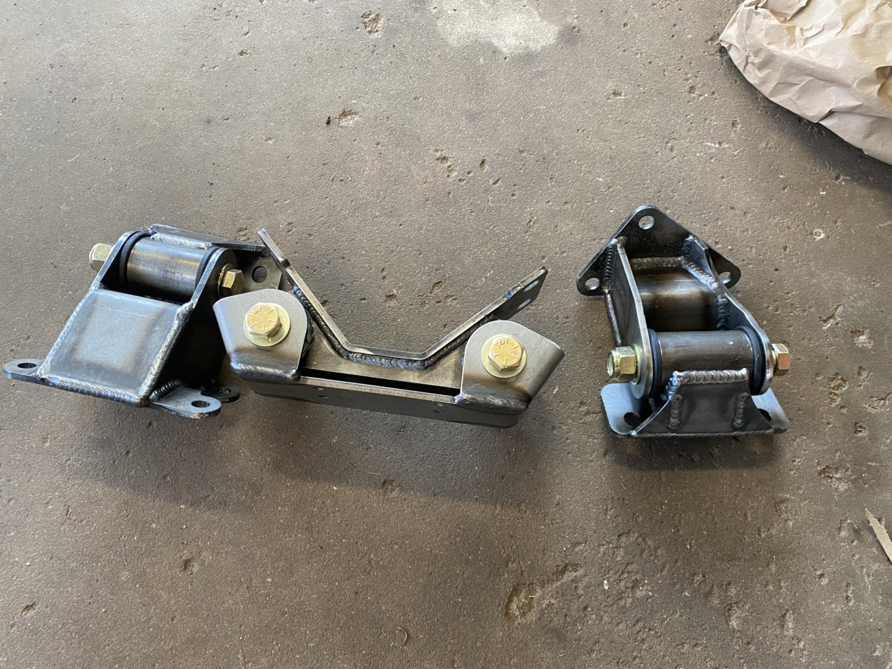

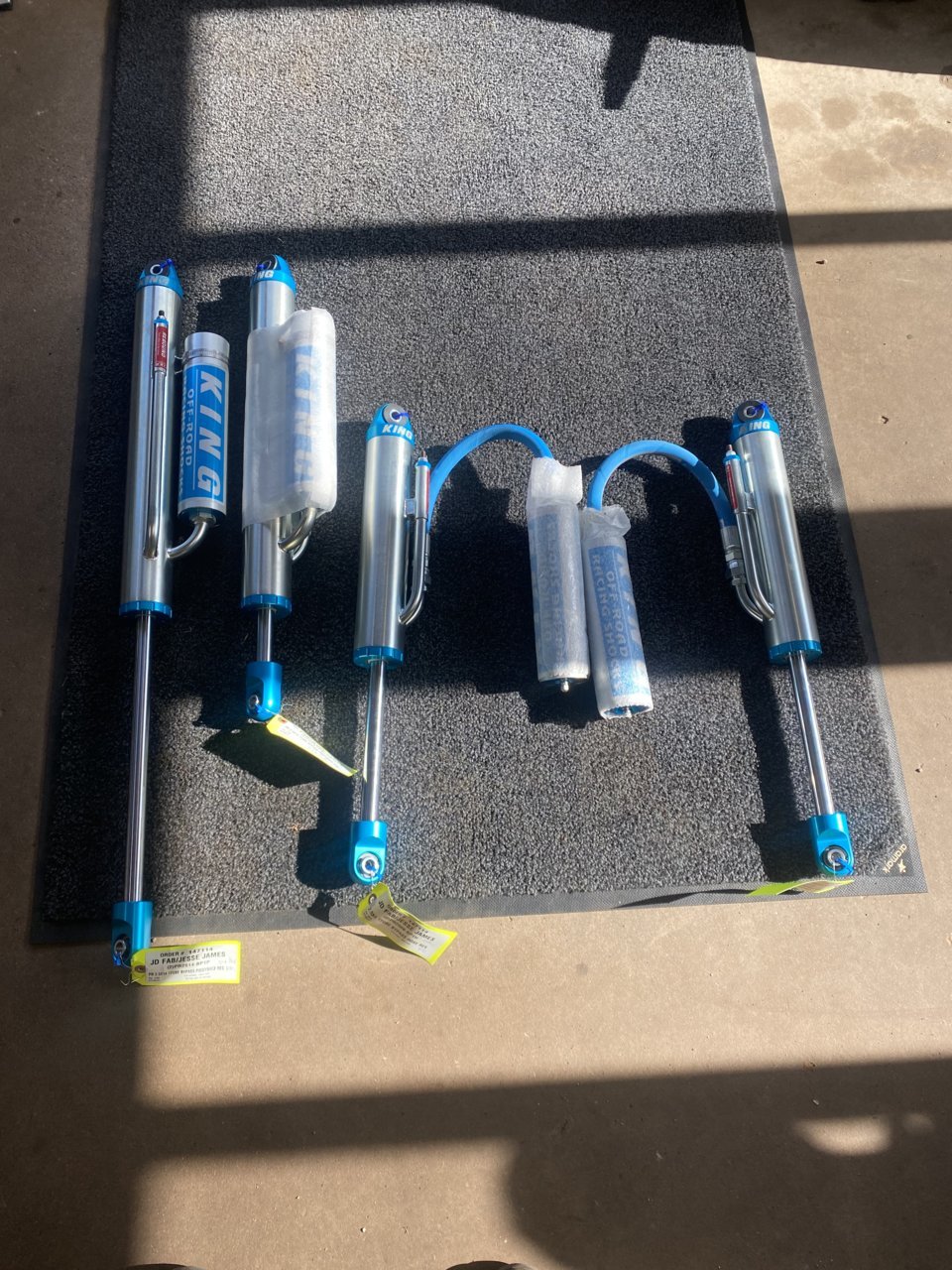

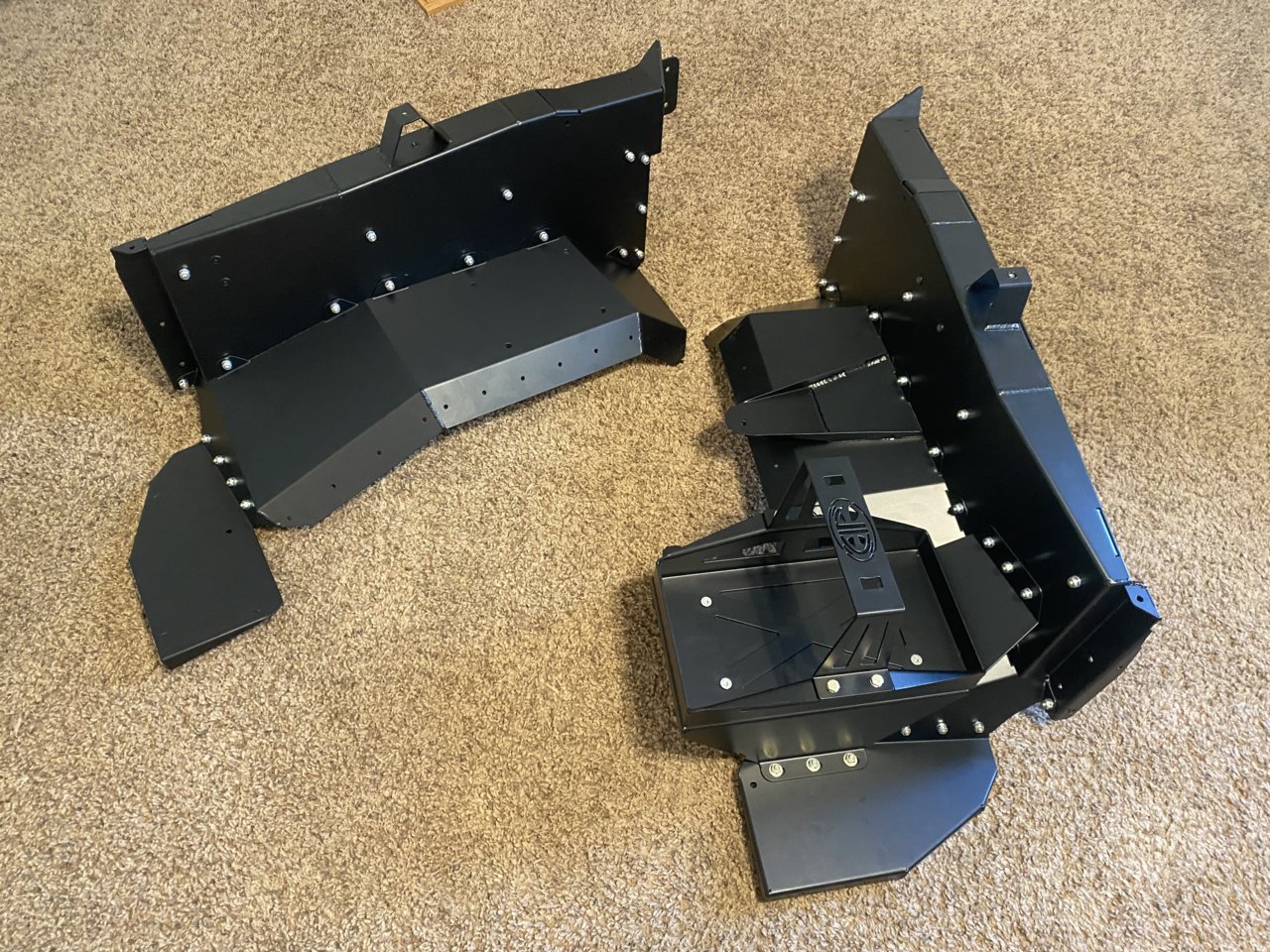

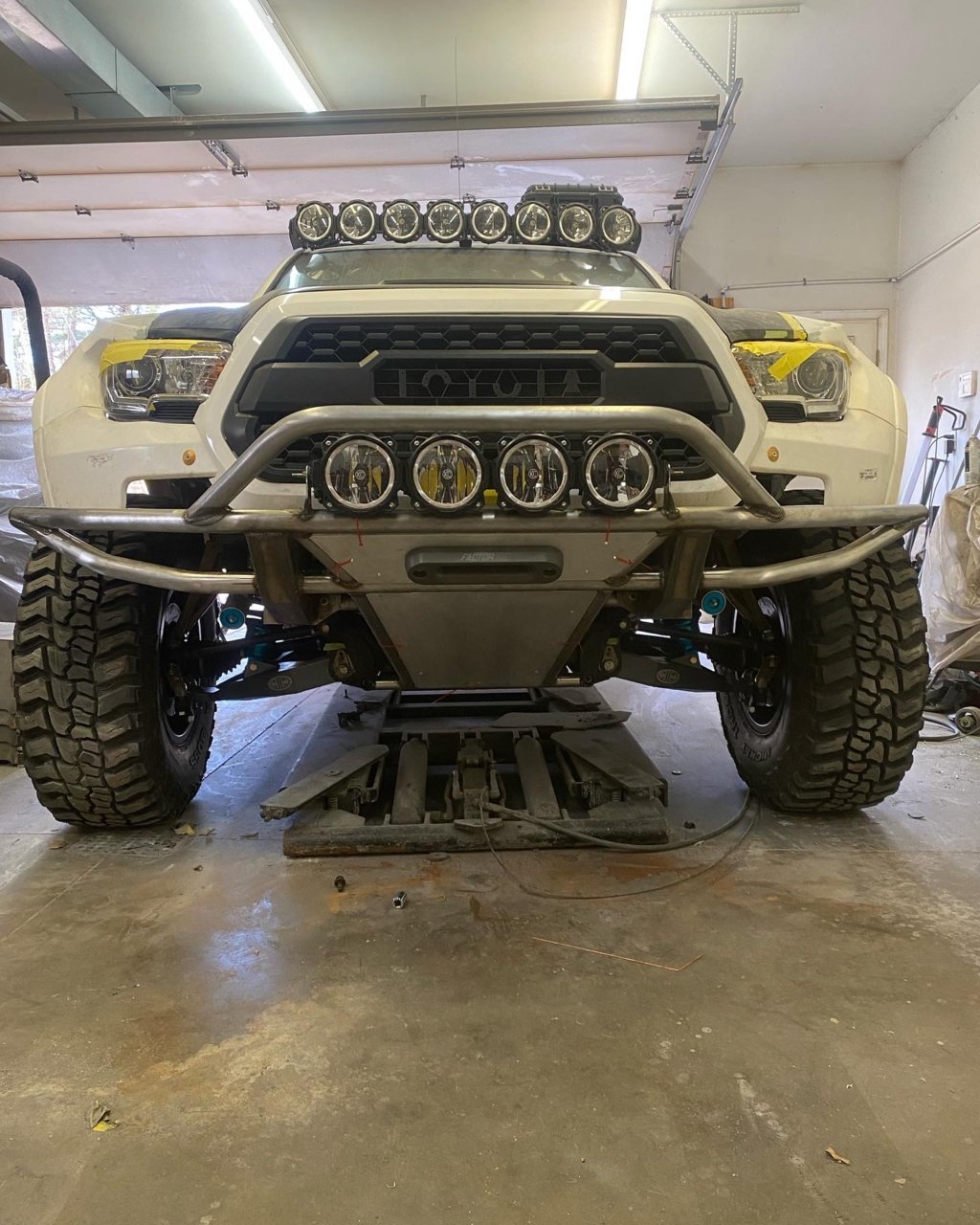

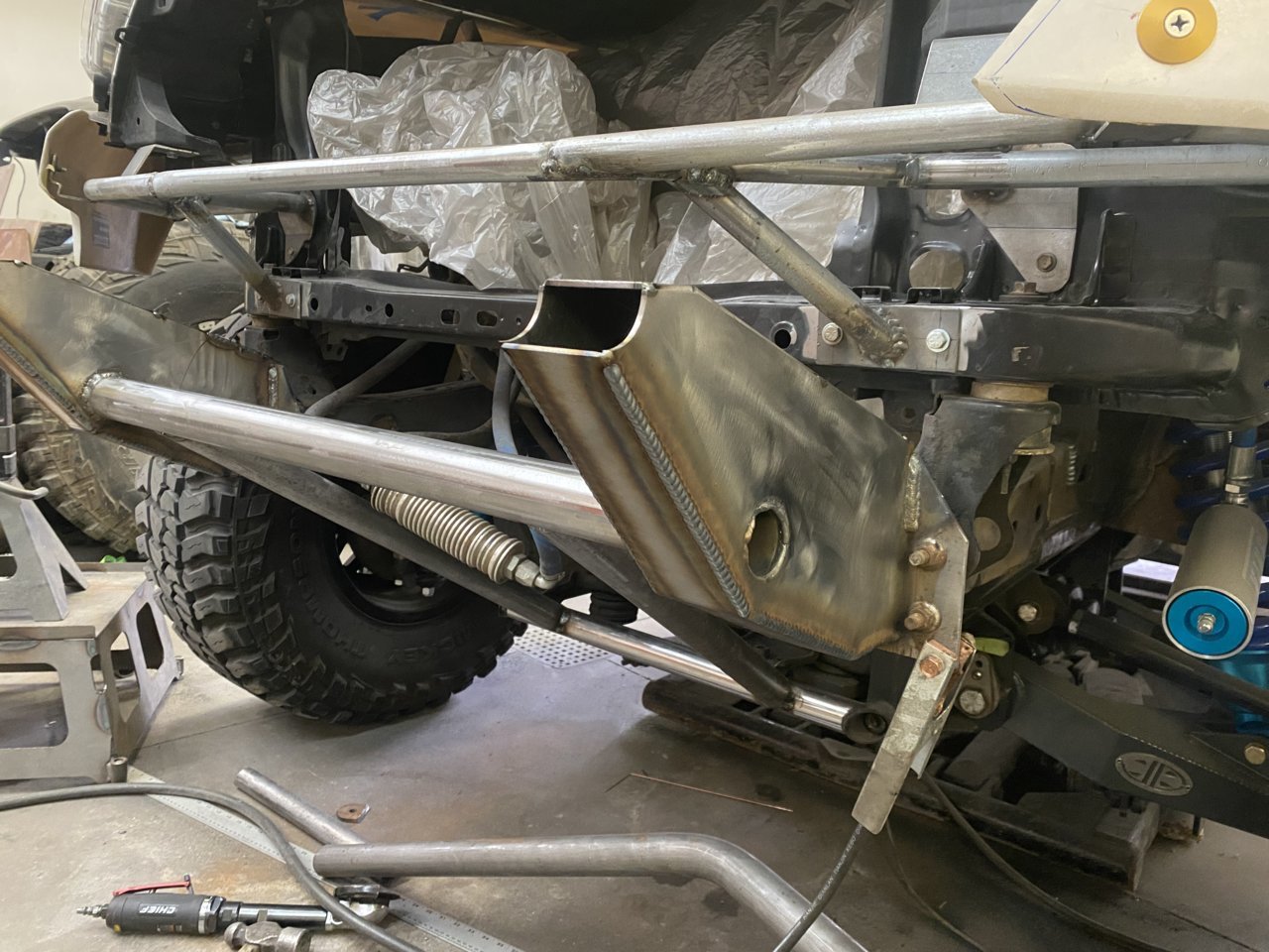

    It’s been a while since the last update. The rest of my shock package finally came in after nearly 10 months. Built both front and rear bumpers and we are pretty deep into the body with the front clip being fully ready for paint. I also decided to add in DMZ engine and trans mounts.

    What did your bumper end up weighing? Looks solid yet simple!
  9. May 25, 2022 at 2:59 PM
    #49
    906taco
    Jun 22, 2021
    #369289
    3,926
    Cory
    08 Taco
    Honestly not sure. 75lbs at most I would say

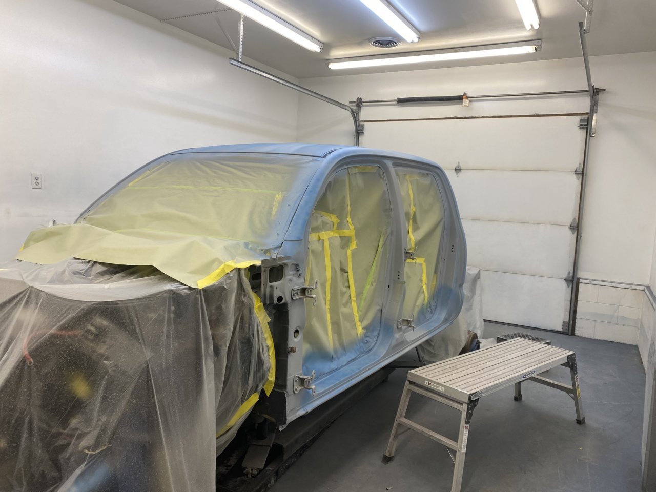

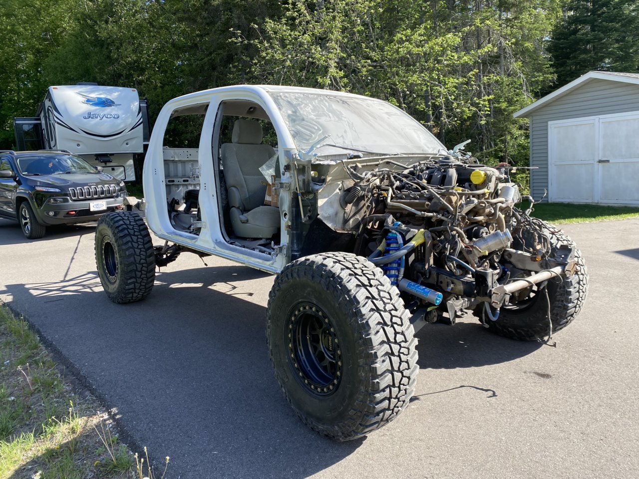

  11. Jul 22, 2022 at 6:23 AM
    #51
    906taco
    Jun 22, 2021
    #369289
    3,926
    Cory
    08 Taco

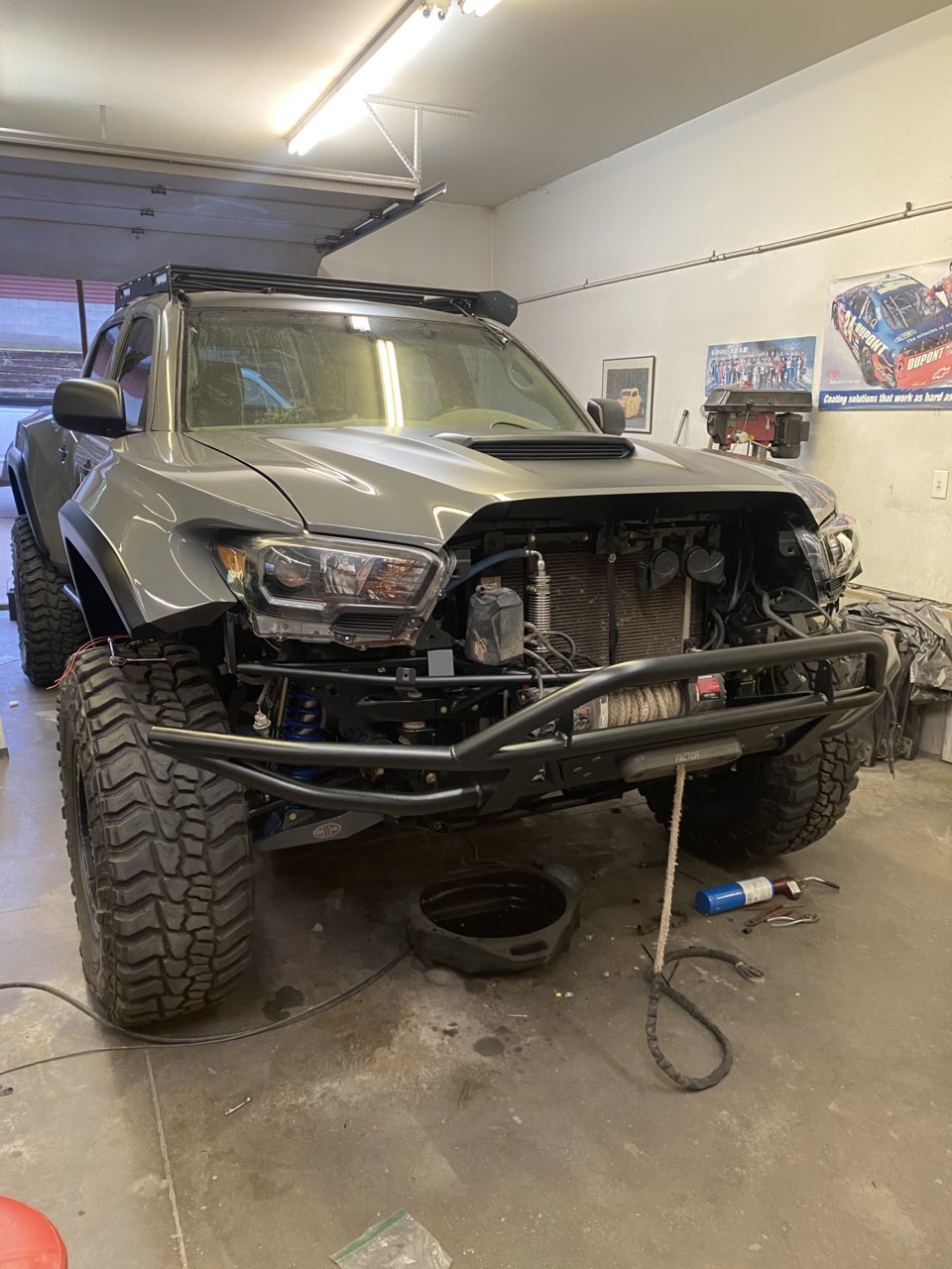

    I am terrible with updating this. Considering I’ve been driving the truck for 3 weeks now we are way behind. Anyways, the truck was stripped completely for paint. While my dad worked in painting I worked on powder coating all of my parts.

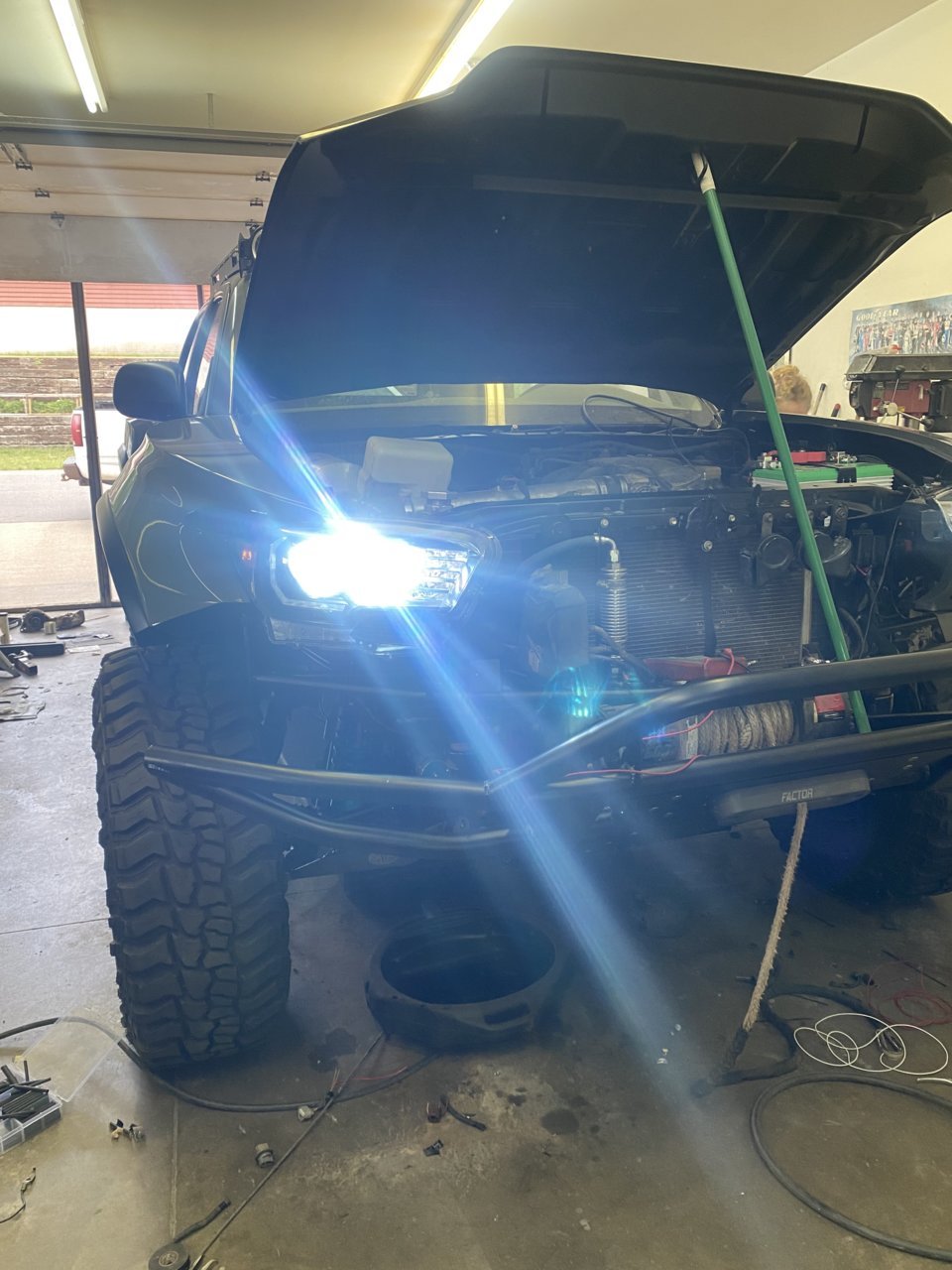

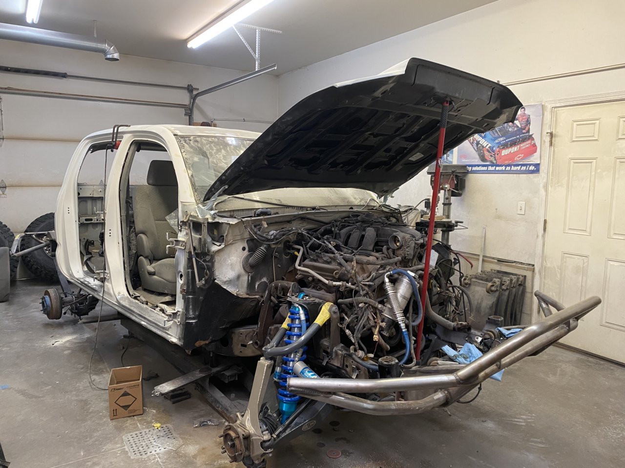

    With the cab in paint, final assembly began with some other upgrades and preventative maintenance. New starter, water pump, and DC Power 270 amp alternator.

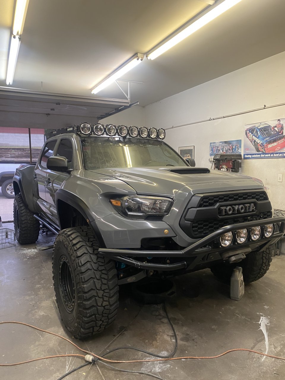

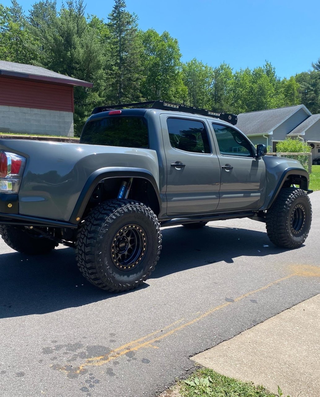

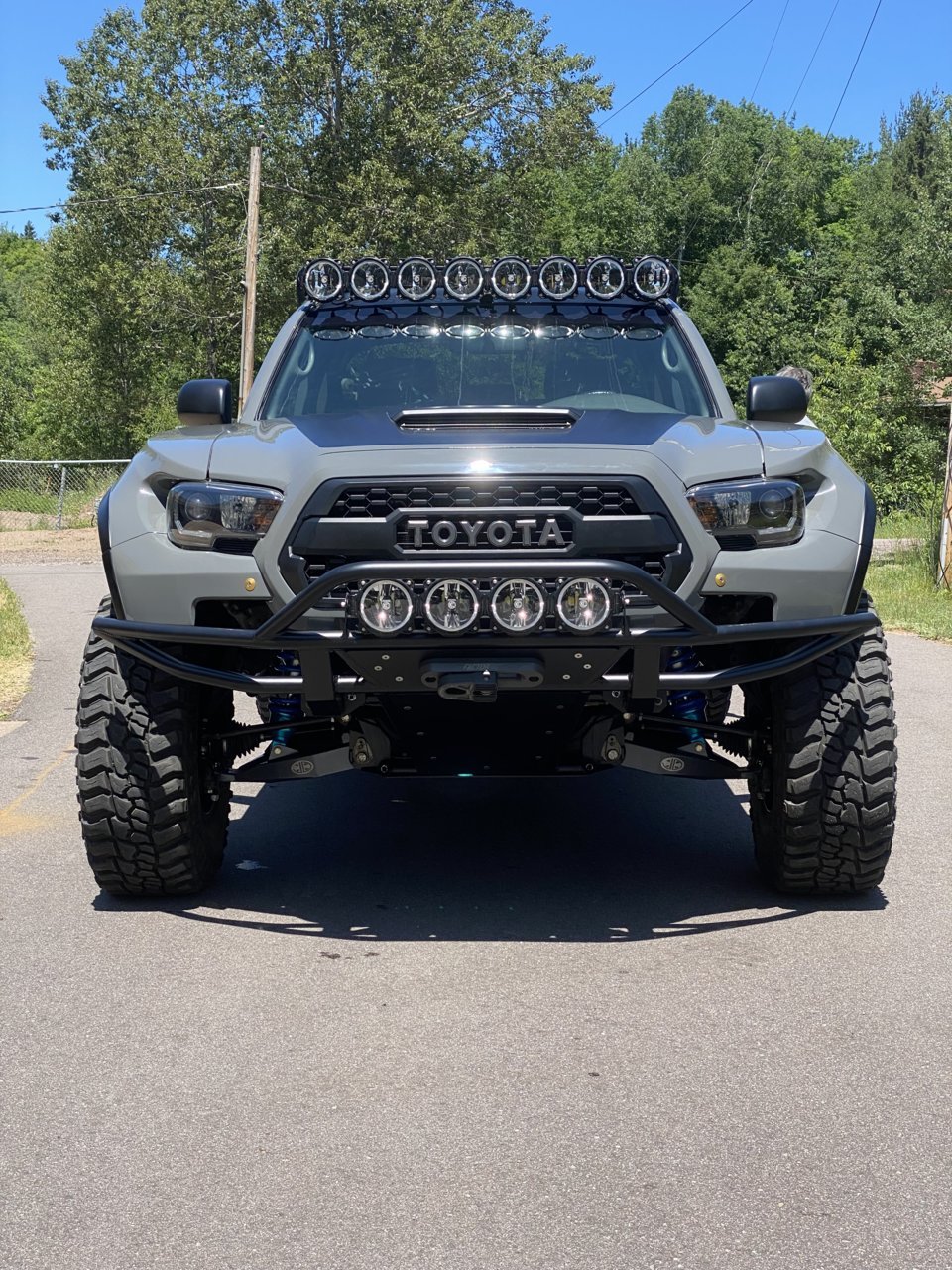

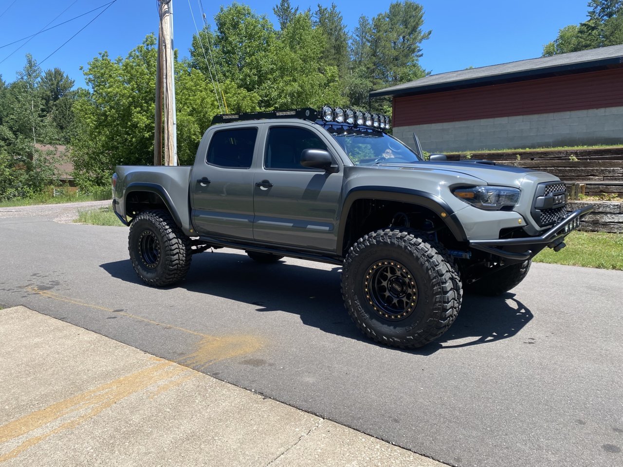

    Here are some shots during the end of final assembly. All in all we estimate somewhere in the neighborhood of 1200 man hours on this build from March 4th when it pulled in for tear down to July 2nd when it backed out of the shop.

    Holy shit man what an absolute masterpiece! Fantastic work, just incredible.
    What side lighting are you using on that roof rack?

    Thanks man, and they are just the side lights that go with the KC M rack

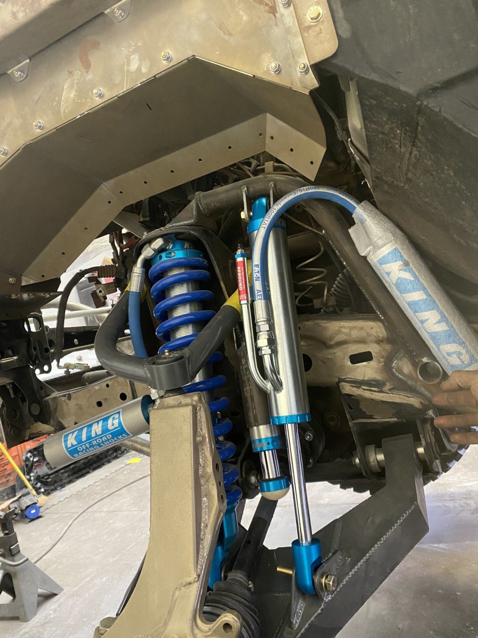

    Gotta be one of the nicest builds on here. Love the work put in. Can you explain the free bleed bypasses? I’m looking to do those on the rear of my truck but can’t find an answer on the differences between free bleeds and regular bypasses. Specifically the ones from JD as well.
