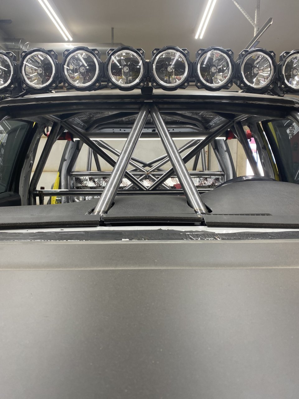

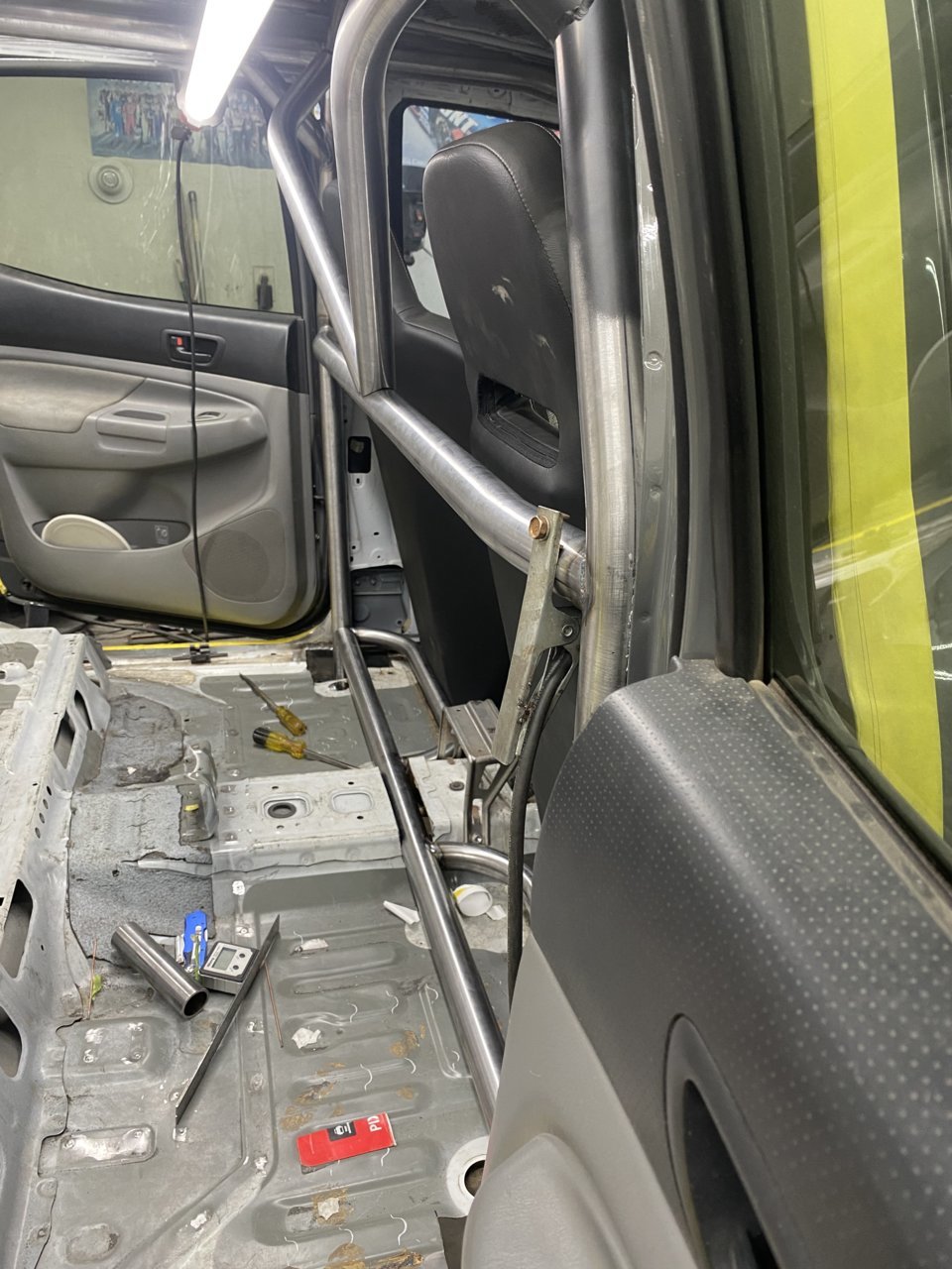

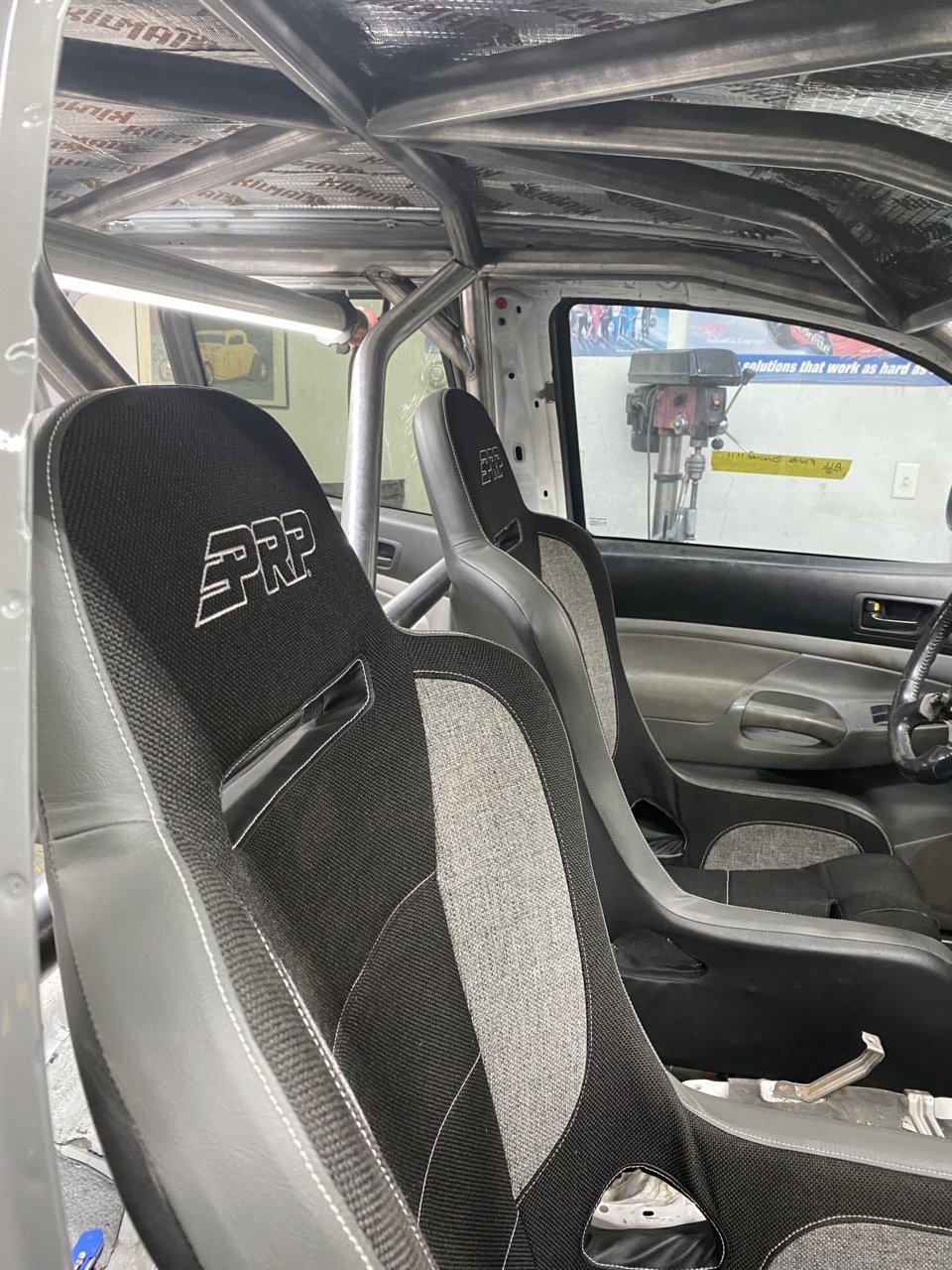

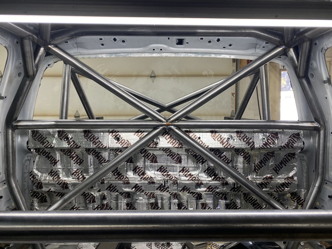

    A little more progress on the cage.
    In my typical fashion, I found myself diving off of the deep end and doing more bracing than initially planned for. I have plans for the truck in the future that would have involved adding more bracing anyways. So as they say, when in Rome….
    6 tubes left to finish up which should be this week, then a ton of first and second pass welds, tabbing in the seats and a full assembly of the truck to add mounts and whatnot where they are needed.
    I’ve done cage work in the past. But nothing on this level. It’s been incredibly humbling.
    As always, thanks for following along!

    What material type and size did you go with? Are you gonna do any painting?
    Also don't be like me, cover your windows if you do any grinding in the vicinity. You'd be surprised what just a bit of hit grit does to tempered glass. My rear windshield is pock marked from cutting off the OEM brackets. Didn't even think about it.

    1.75 and 1.5 DOM of varying thicknesses from .083 to .120

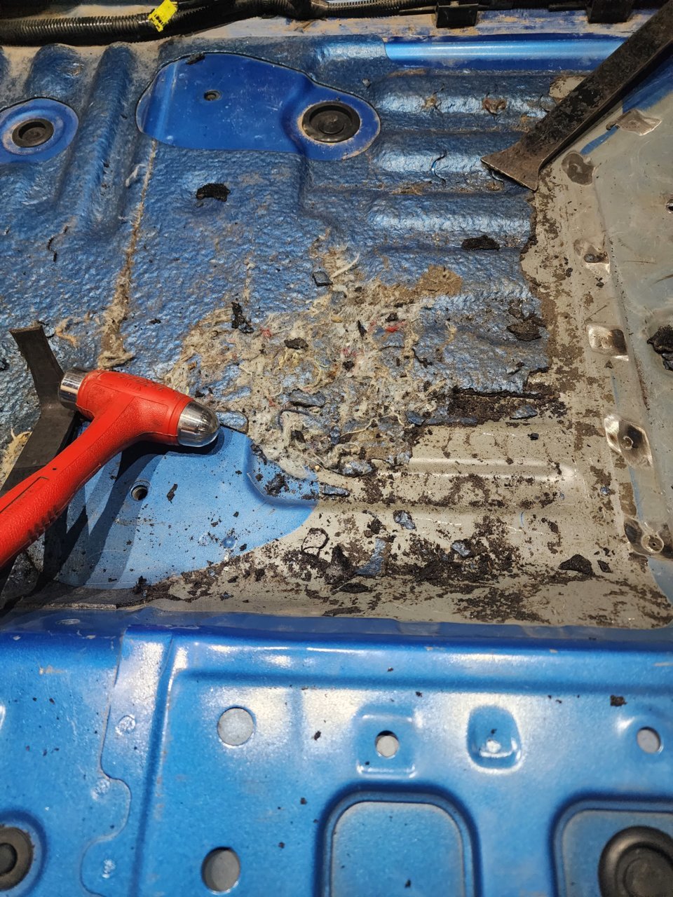

    @906taco what did you do to get rid of all the insulation stuff stuck to the floor of the Tacoma? I've been chipping away but it's leaving a tonne of nasty stuff stuck to the floor.

    Heat gun to soften it up good. Then get any remaining goop good and wet with mineral spirits and after a little soak it comes right up

    I haven’t tried it but I’ve seen that dry ice works really well too. Plenty of videos on YouTube about it.

    I've seen dry ice and alcohol make quick work of it.

    Dry ice does work, but imo takes longer. The wife had my entire cab stripped and spotless in like 3 hours one night with a heat gun and mineral spirits. And I think she was milkin it.

    Sounds good! I got it all chipped up today without heat which I probably should have thought of, but I'll get the remnants off with those suggestions! Thanks!
    I had heard that, but I couldn't be bothered enough to try and find dry ice locally
