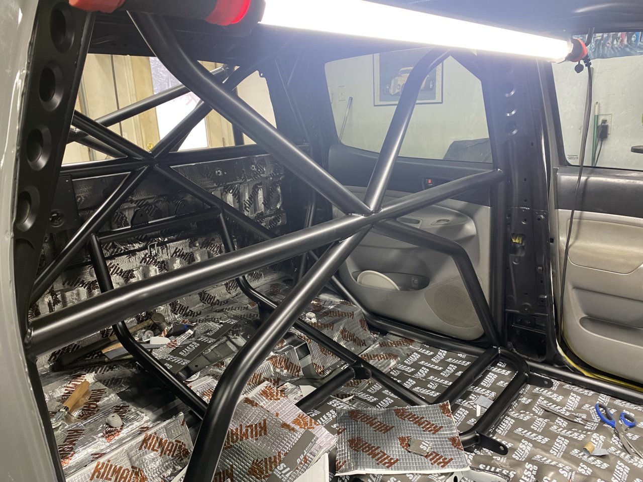

    How much trimming did you do so the tires don’t rub? :cookiemonster:

    2.5" OME lift, Fox 2.5 coil overs, all pro expo leafs, ubolt flip kit w/ upgraded bump stops, 1.25" wheel spacers, 16" Bronze KMC Impact OL wheels, 295/75/r16 Nitto grapplers, beige Softopper, Brute force front bumper w/smittybilt winch, RCI rear bumper, caliraised rock sliders, TRD IFS skid plate custom swingout tailgate w/spare tire mount, TC bed stiffeners, Magnum force CAI, KC spotlights, tacomabeast headlights, rear seat molle panel odds and ends, hi lift, MESO interior lights, and a fuck load of patches… more planned for later.
    This photo tho… :drool:

    I've been wondering. Did you mask and spray or brush it on? Looks difficult with it in place.

    Masked everything and sprayed. I’m not sure there is an easy way of doing it. Definitely sucked lol

    I figured! I'd be half tempted to paint the top before lifting it up into place and welding the bottom solid.

    I did paint the top before lifting it in place. Just didn’t come very far down as there was still lots to be added at the time

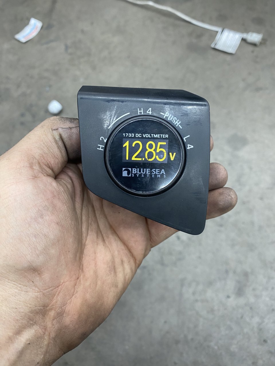

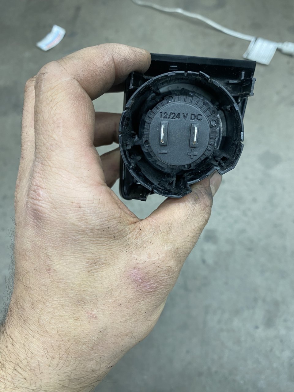

    Kind of a cool little thing I did tonight. Ever since going to a twin stick I’ve been looking at this useless switch telling myself I needed to buy a blank for it.
    But on my hunt for a voltmeter I stumbled on the Blue Sea mini. And you could say it fits pretty much perfect in the gutted switch housing.

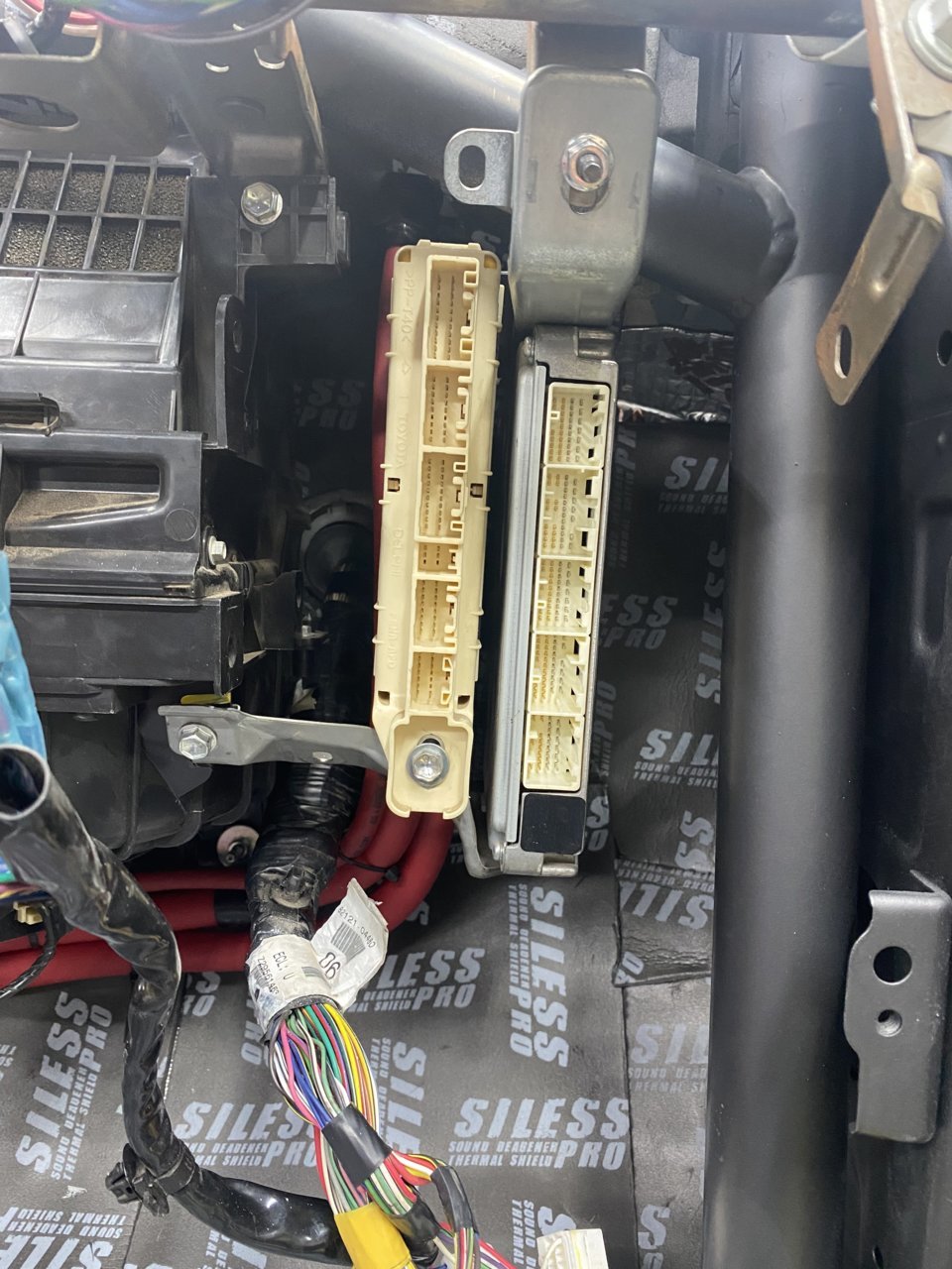

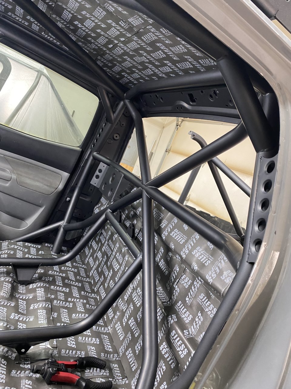

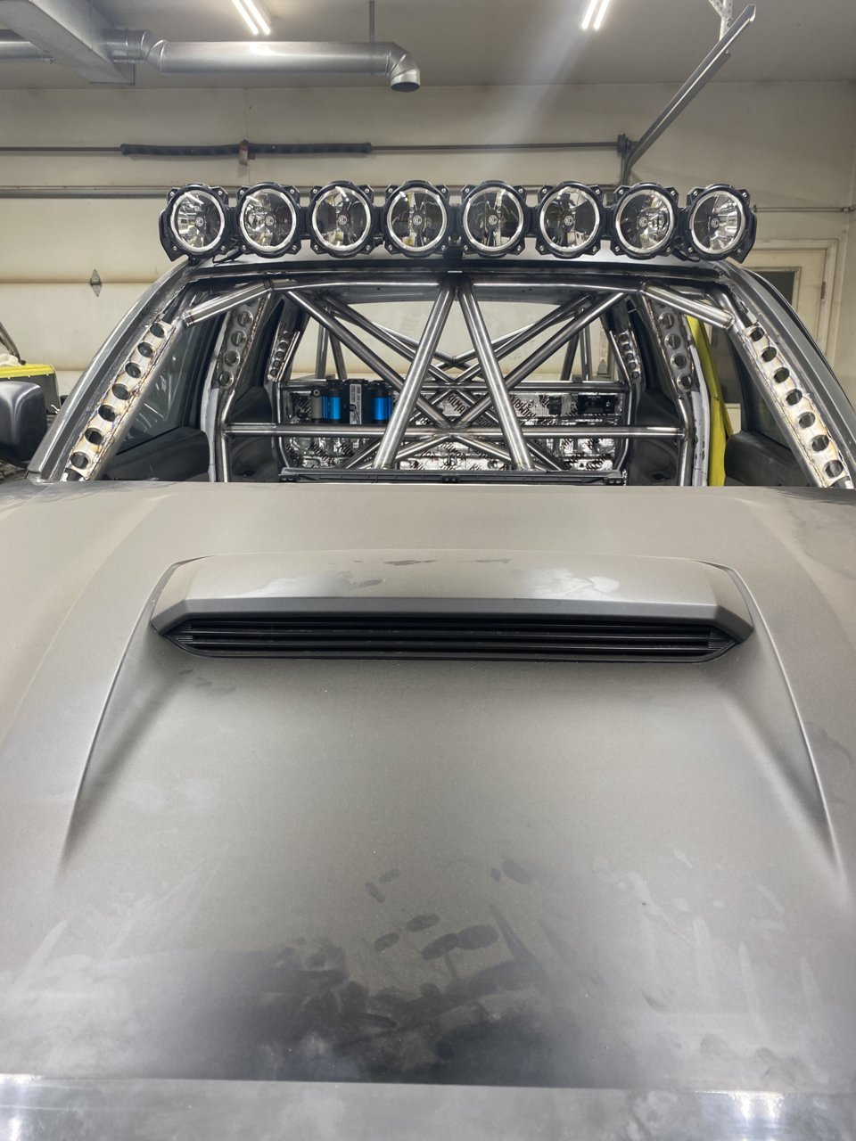

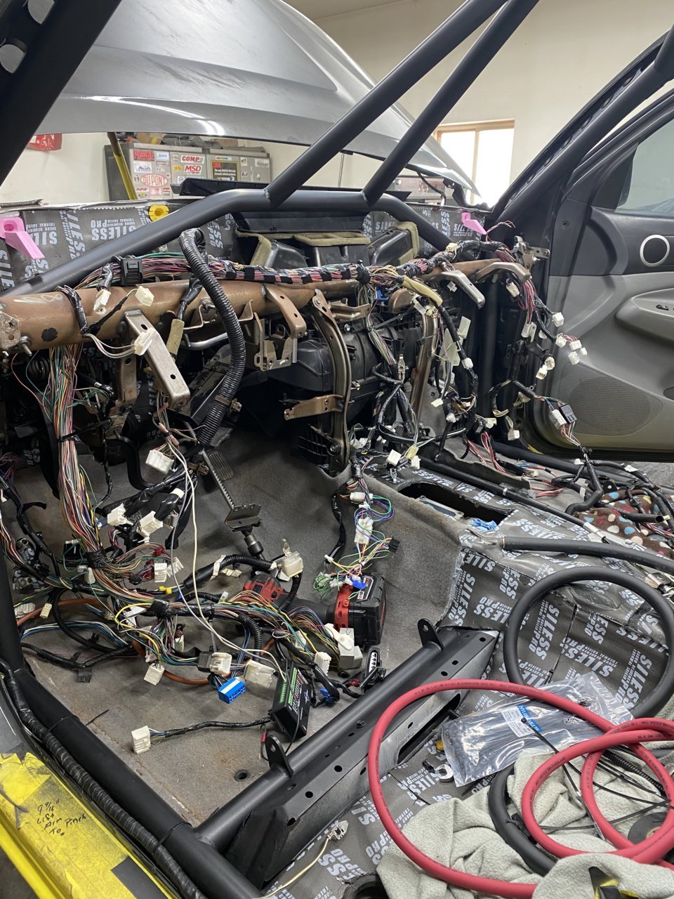

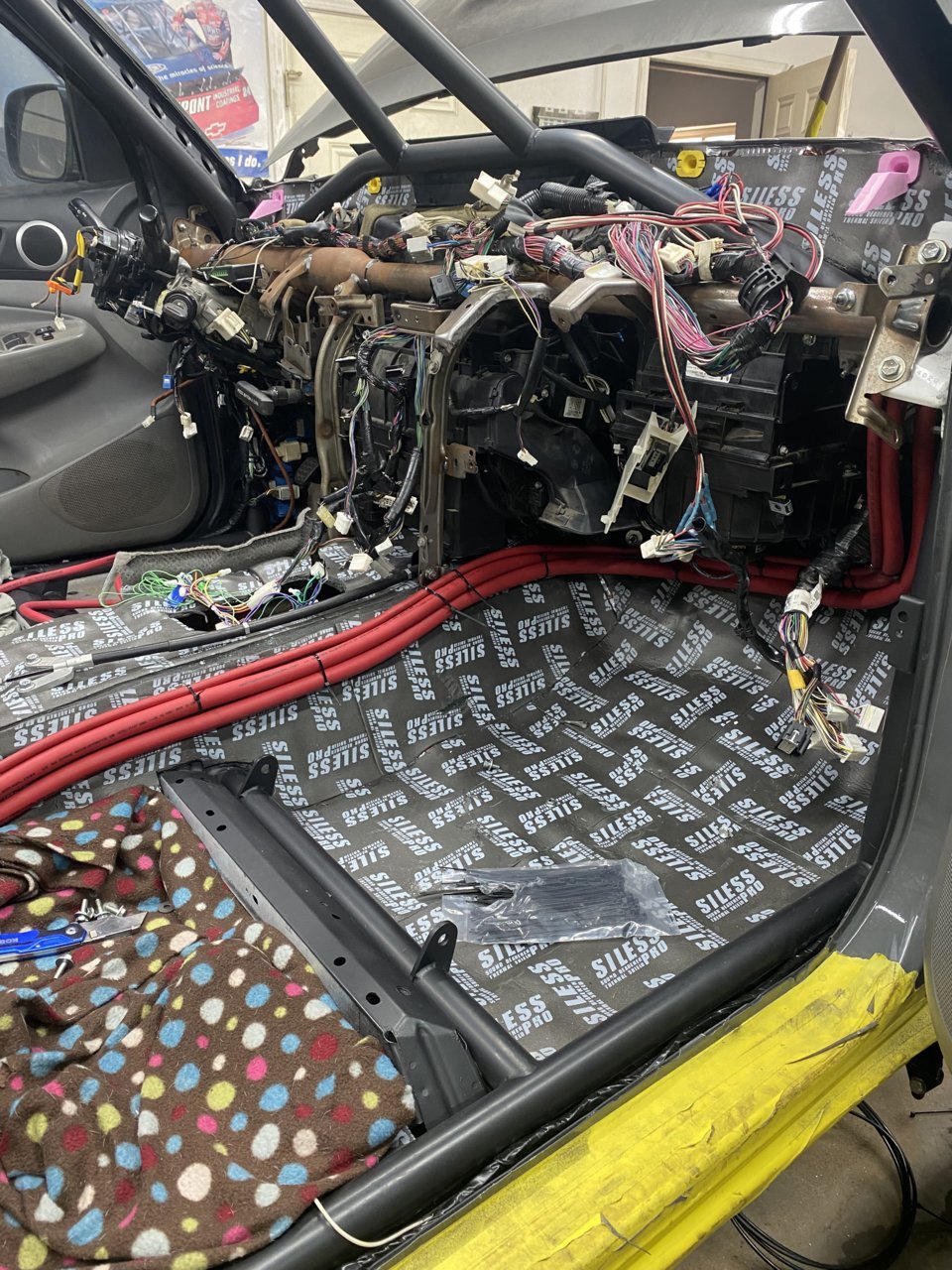

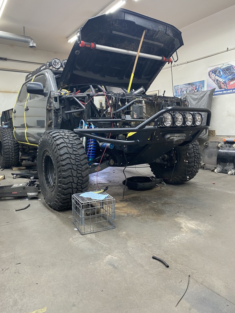

    08 Taco

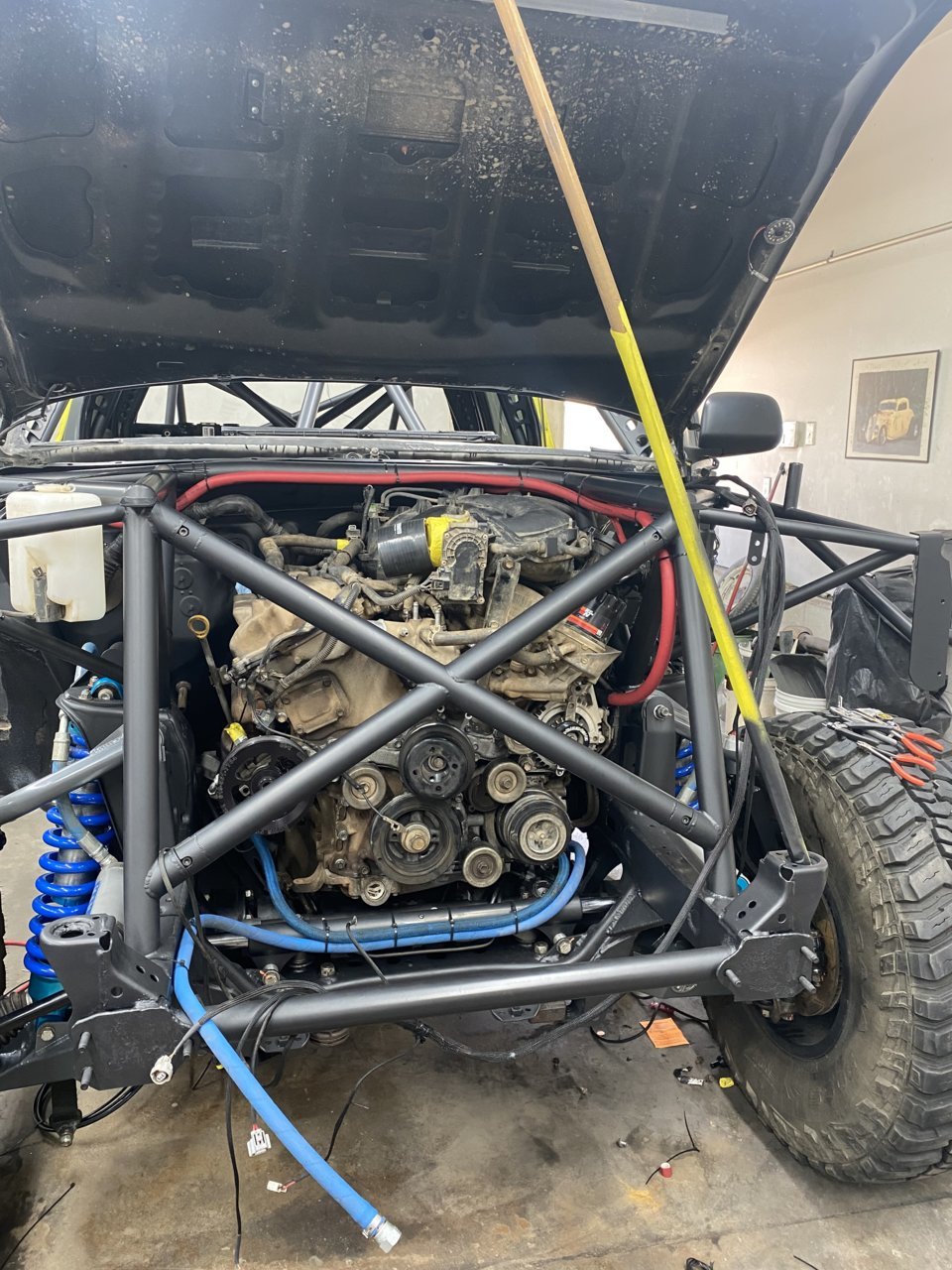

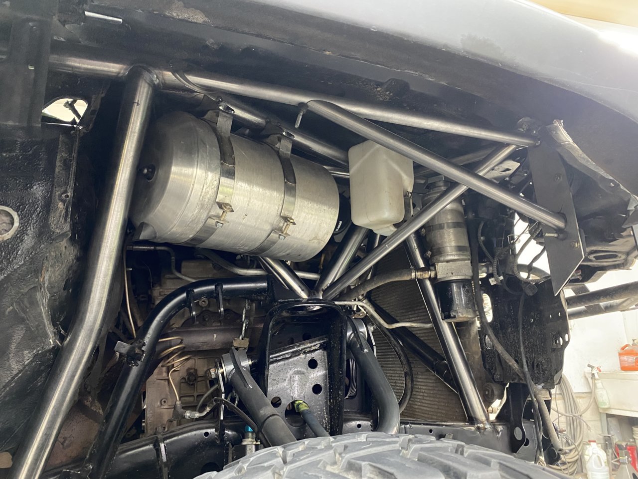

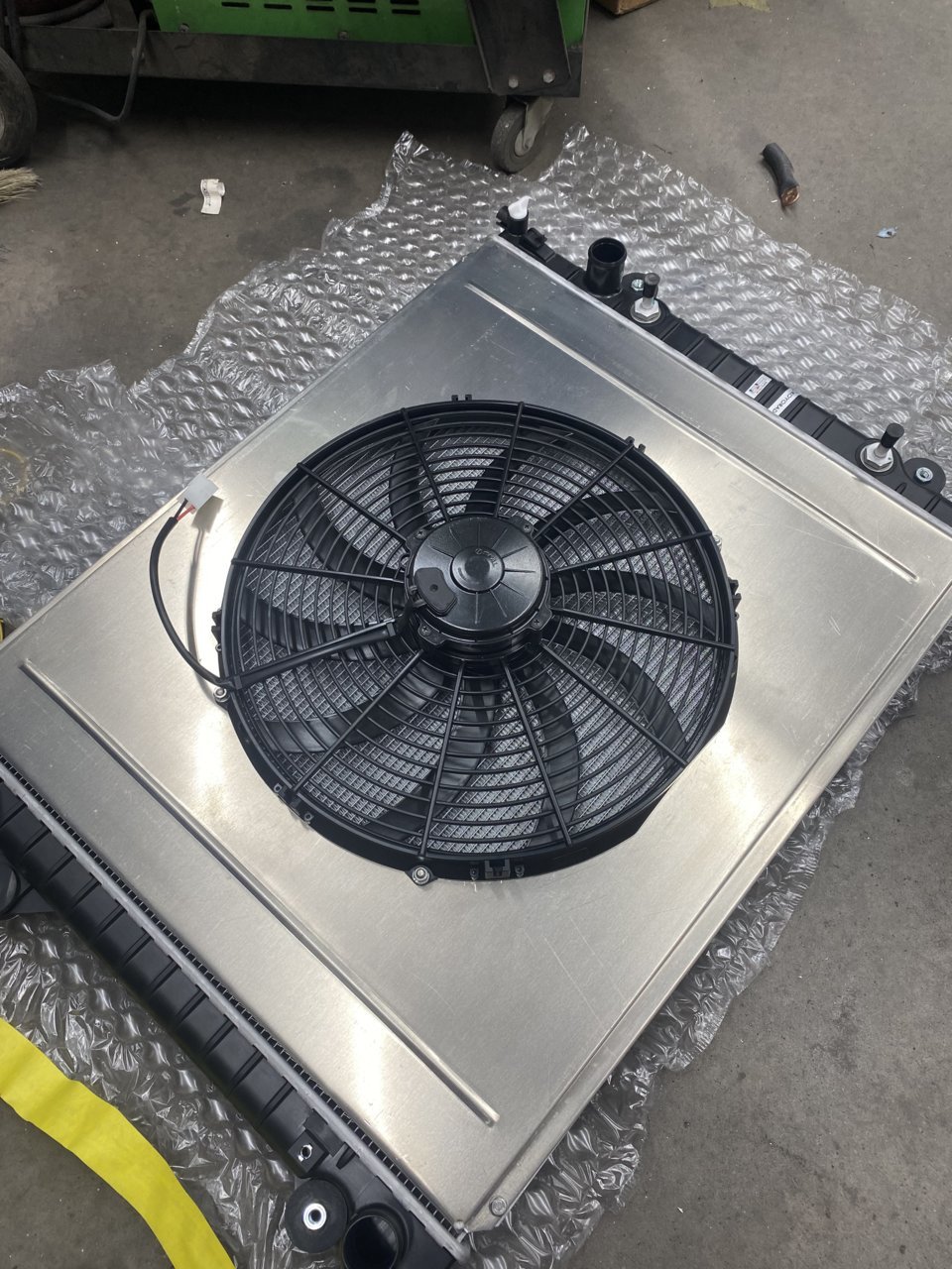

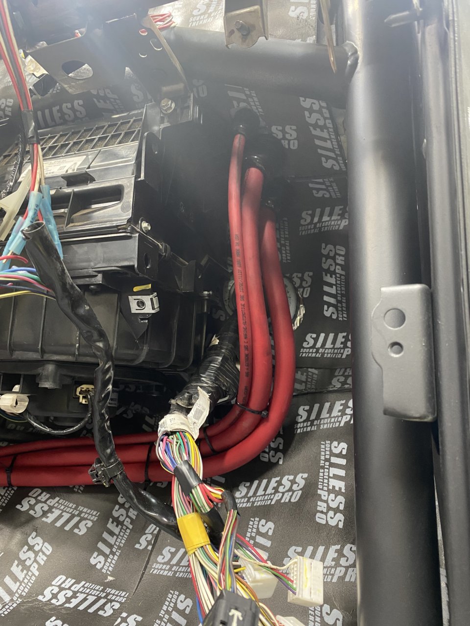

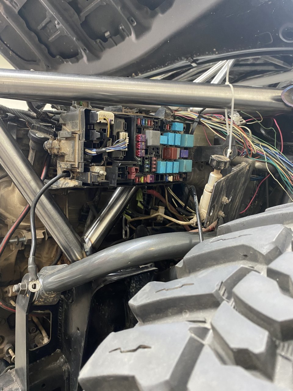

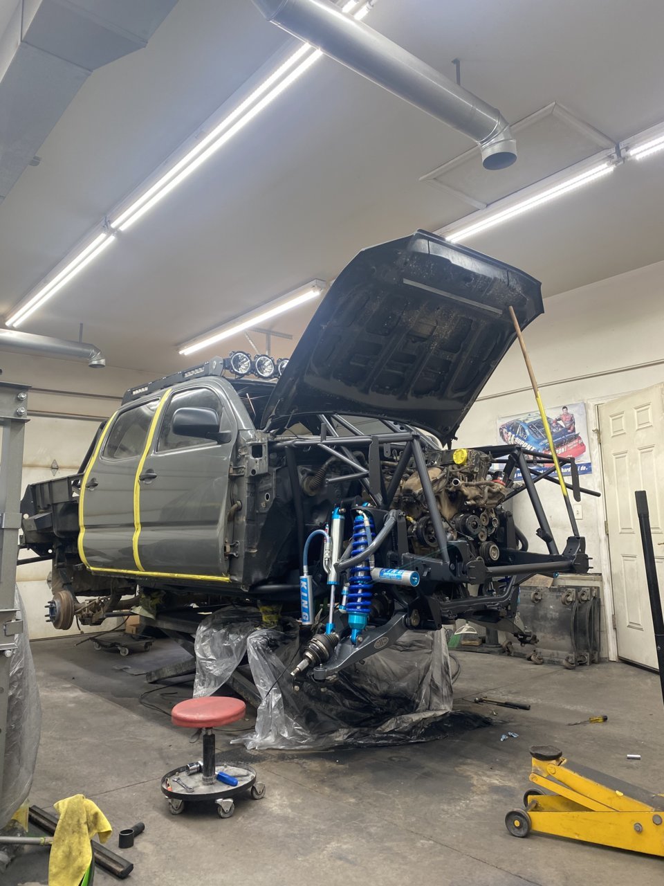

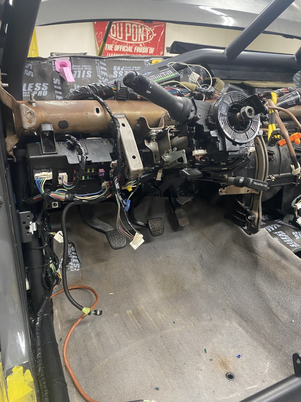

    It’s been a while!
    We have ourselves a roller with full driveline at this point.
    Currently working on electrical, did all of my main power runs today and plan to have all other wiring finished by the end of next week. At that point it should be a running truck!
    For the main power runs it consists of
    4awg from battery to engine bay fuse box
    2awg from battery to starter
    4/0 from battery to alternator
    4/0 from battery to buss bar which will feed my winch and fan.
    4/0 may seem on the crazy side, but a winch pulls a whole lot of amperage so I want things to be proper.
    All wire is from battery cables USA and it is all the “extreme”. Very high quality wire, but it does come at a cost.
    Sound deadening is dual layered. Base being 80mil killmat with 200 mil siless pro which is 50mil butyl and 150mil closed cell foam. I can already tell the cab is going to be on the quiet side!
    Enjoy the pictures!

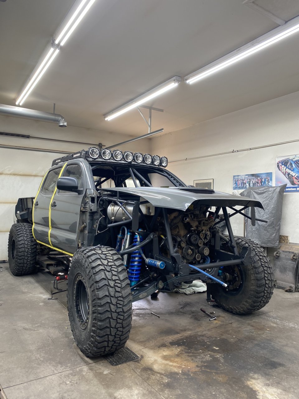

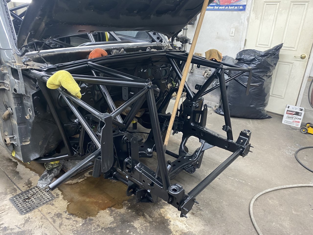

    Man when I caged my old Tacoma front to back, it really simplified things I feel. That sheet metal is good for a stock truck but once you go big, it becomes more work to modify the sheet metal to fit tires than cut it all off and add a bunch of tube. Good shit!
    Slashaar likes this.
  12. Apr 1, 2023 at 6:42 AM
    #152
    906taco
    906taco [OP] Well-Known Member
    Jun 22, 2021
    #369289
    3,875
    Cory
    08 Taco
    It simplifies and complicates at the same time. The engine cage definitely added the most complexity because of how much has to be moved around and relocated to work. But on the plus side, there will be absolutely no rub anywhere.

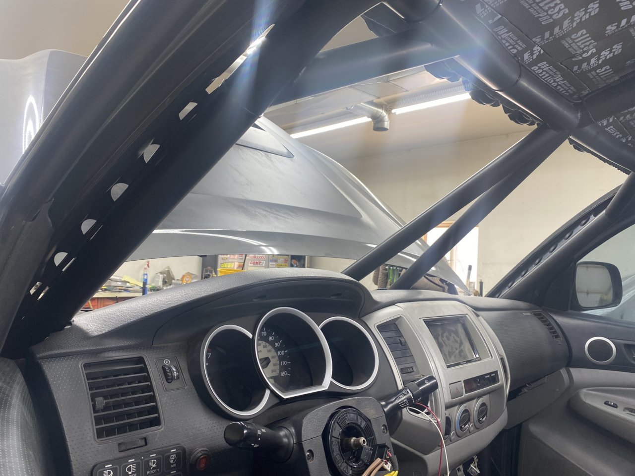

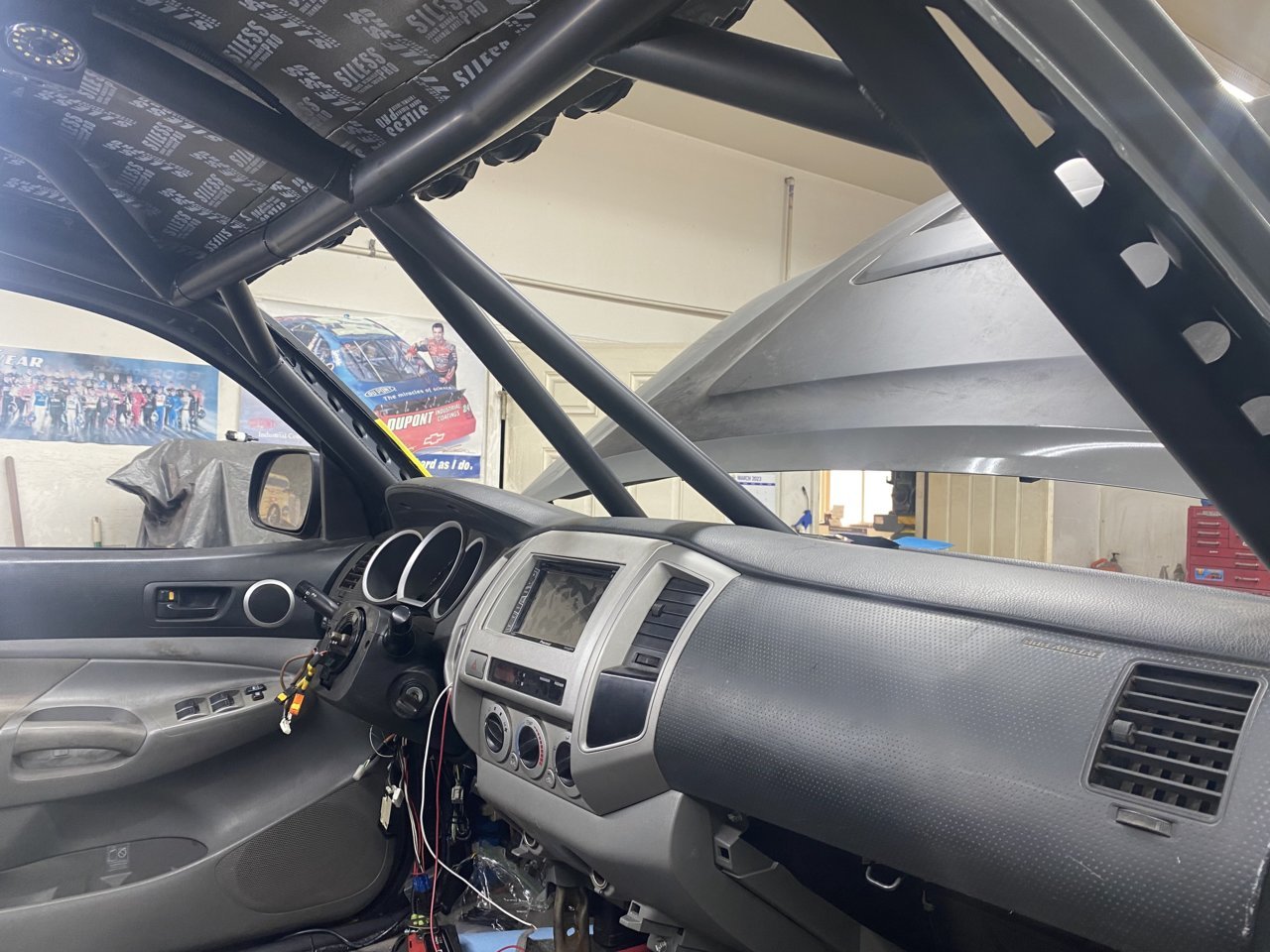

    Not far off from a running, driving truck.
    Yesterday was first start up. Today was dash install.
    I am so stoked on how this thing is coming together!
