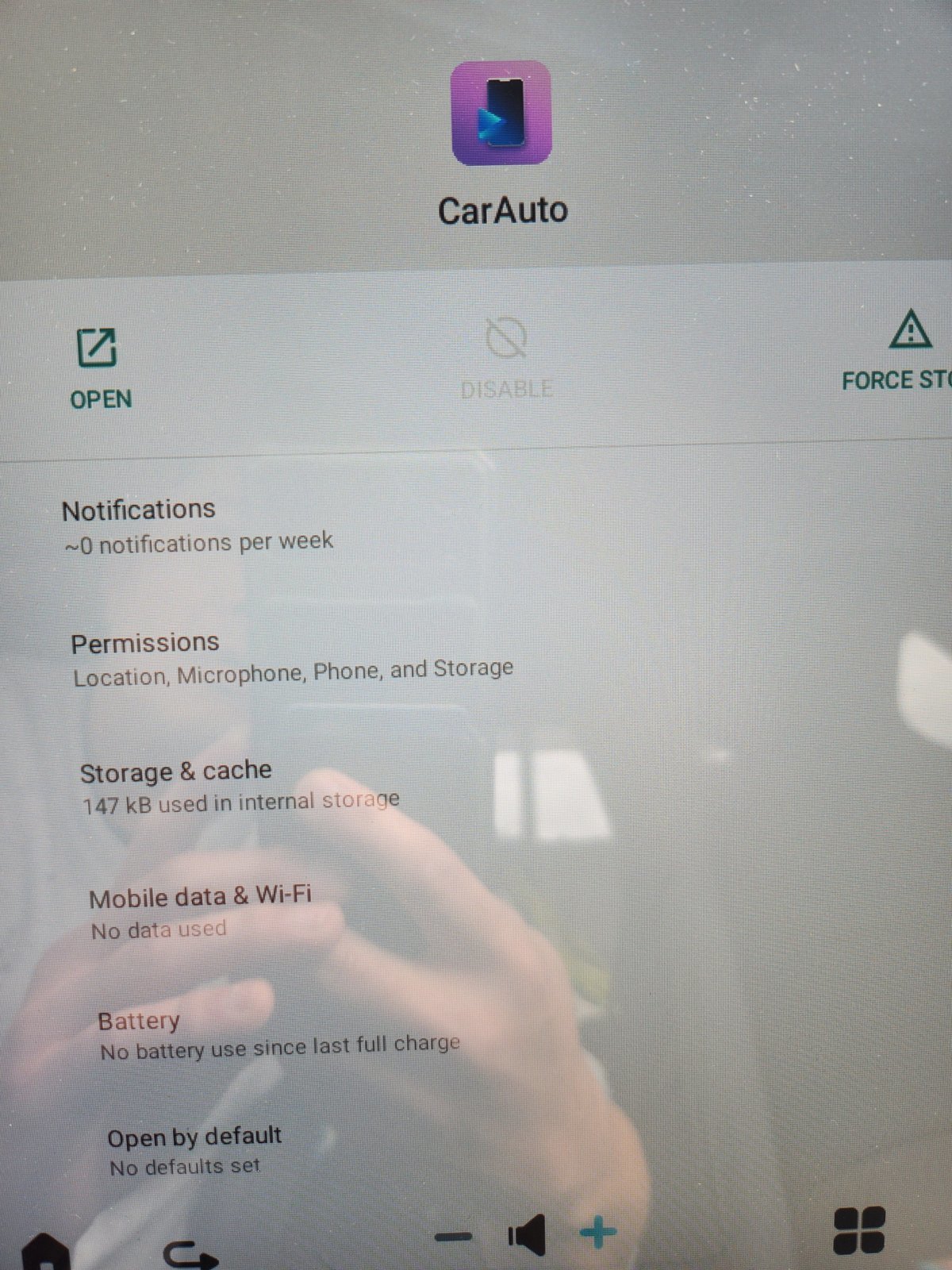

    @TacoTom281
    Check the CarAuto app. I think it's a setting for 'Open By Default".
    To get there, press and long-hold the CarAuto app and select App Info.
