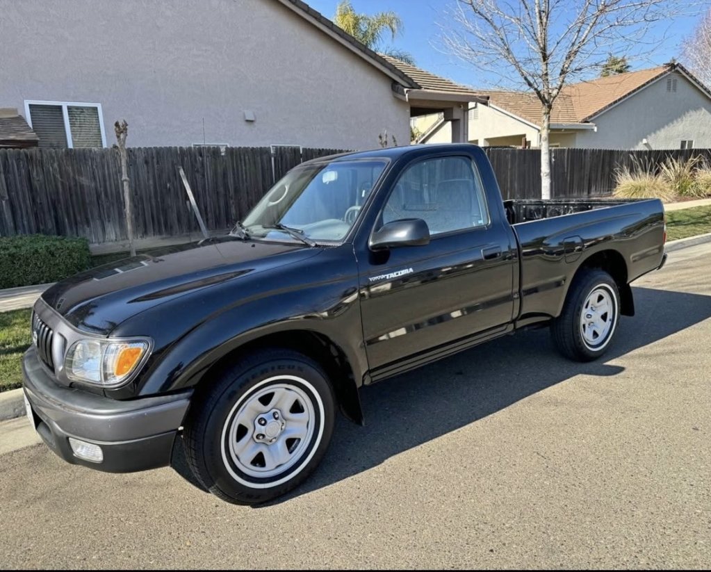

    Hey "2Runner",
    I am Jason and a new member here. I just purchased a 2002 Tacoma w/ 60K miles in great shape.
    just wanted to CONGRATULATE you on a GREAT BUILD thus far and say you inspired me to spiff up mine myself. I am a novice to all this and would love your blessing on trying to duplicate your your rims and stance for truck.
    take care,
