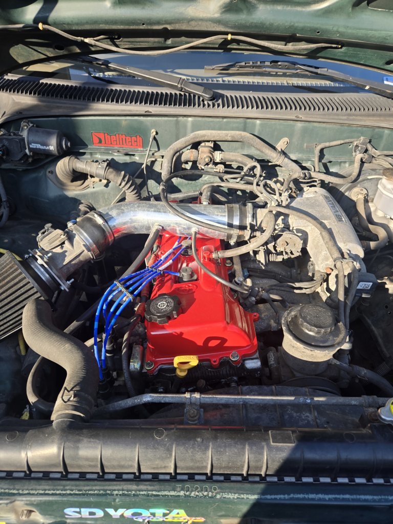

    Ok. I have a 99 5-lug with the 2.4L. 350k miles. Pulling away from a traffic light the engine just stopped running. Tried to recrank and it just turned over. Stuck it in first (I was still rolling) and popped the clutch. It just barked the rear tires. It was running great until it wasn't.
    I've checked all fuses and they're good. I did replace the PCV valve and painted the valve cover. The only thing that that is suspect at this point is the MAF wiring harness fell against the header and melted just enough insulation that 2 wires might have shorted out across the header.
    Can you short out a MAF? Would a fuel pump shit the bed suddenly?

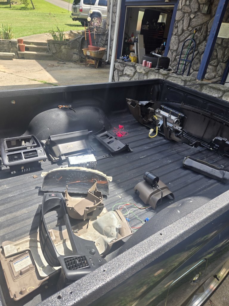

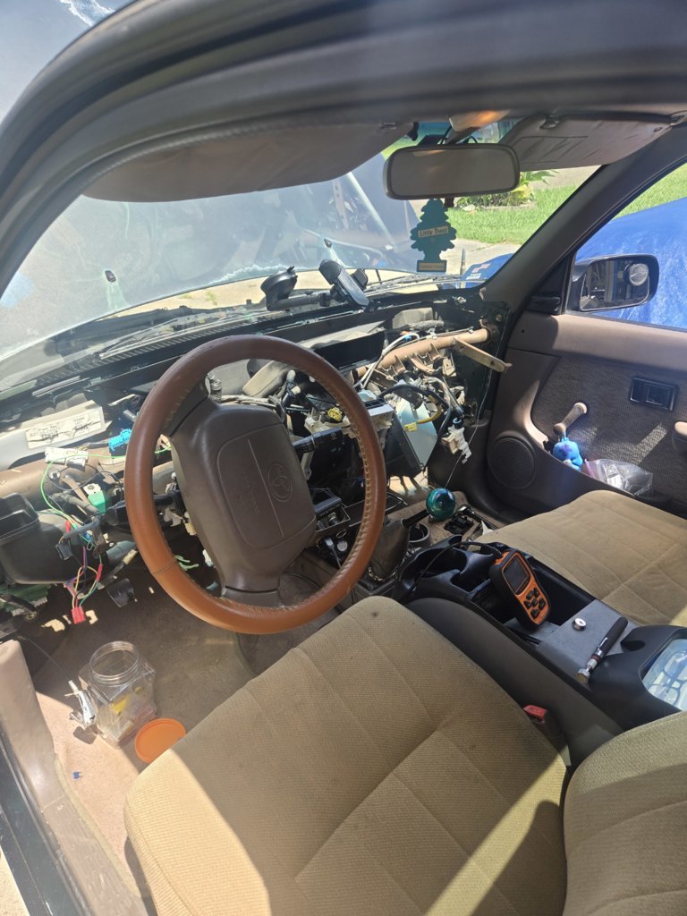

    Pulled out the OBD2 reader and it fails to connect to the ECU. Soooo, I've pulled the whole dash to get to it and it looks fine. No broken pins, no corrosion, opened the case and there are no signs of anything getting shorted, blown, nothing. Looks brand new. Plugged everything back up and still can't get the reader to connect to the ECU.
    Gonna check the crank sensor....but I'm kinda at a loss.
