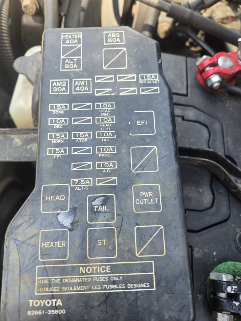

    20A EFI fuse is in the fuse box under the hood.

    I don't have a 20 A fuse. I have e a relay for the EFI. I swapped it with the power outlet relay (same part number and known good) with no change.

    Check the 15A EFI fuse for power like stated above.

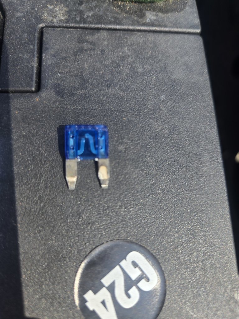

    I don't know how many times I've checked the fuses. Both visually and with a multimeter. It took tearing everything apart and tracing it back to find that the 15A EFI fuse was broke. Replaced it and she roared to life.
    Thank for all the help.

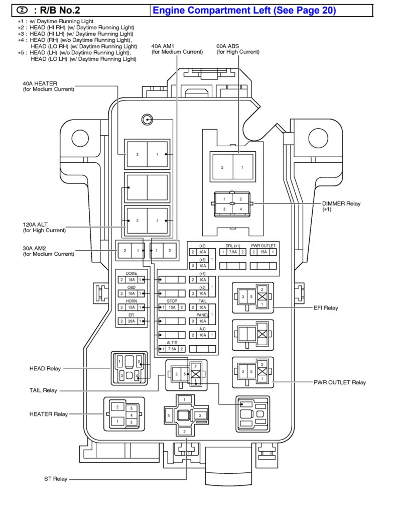

    May not be out of the woods yet........I'd proceed carefully
    something down line may of over taxed that line....
    on a half ass inspection I count the open circuit, fuel pump, multiple vsv valves, and the 2nd O2 sensor all running off that one circuit branch...
    was it a one off.......maybe..........................
    page 74 shows the distribution off the B-Y line

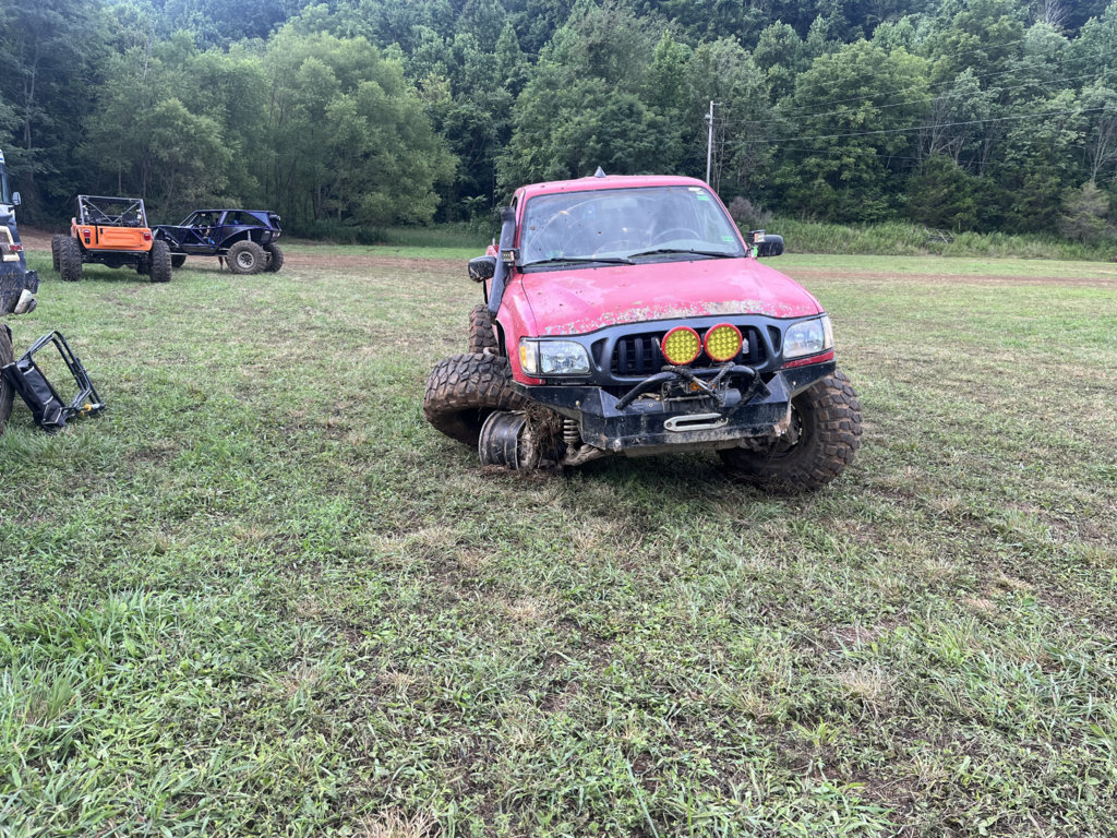

    This was about two years ago. Around 3" lift on 35s.20231202_154928_IMG_4340.HEIC.jpg
    Then I f'ed up last year and the IFS is toast.

    I scanned and had several codes for all those. They have been cleared and I will definitely be keeping a close eye on them.

    It happens. The LBJs were a weak link on the 1st gens.
    That SAS will make a world of difference. Nice truck BTW....
    You going 4.88's?

    Already at 5.29s. It wasn't the ball joints. The steering rack detonated on the top of Golden Mountain Park and I had to be towed out.
