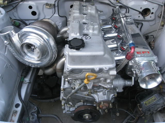

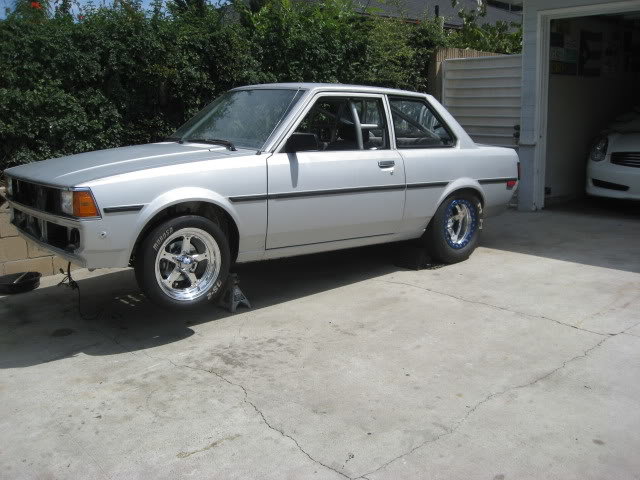

    Well let me first by introducing myself, my name is Santos from good ol SOCAL.
    my father and I have been racing all our lives and him longer then me of course.
    I grew up with all the old school datsun and toyotas. We raced at terminal island back int he days with the 73 corolla with a built 3tc and after over 10 years of running at the track we finally went into the 9's in the 1/4 mile with our 3tc set up.
    we parted the car and sold it after years of dialing in.
    we got a new platform to build on a 1983 Toyota Corolla, stock comes with a 4 link but everything else is plain jane lame. So we took the drive after 20+ years on a motor to try a new motor the Tacoma 2RZ!!!!
    I personally did over 50% of the fabrication on this project and hope to push my dad into the 8 second barrier with a almost complete street chassis car.
    we picked up the car Feb2009 and here is our progress till today
    Specs:
    1983 Toyota Corolla
    4 port 2RZ

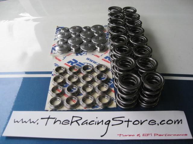

    springs/retainers
    Stainless Steel valves

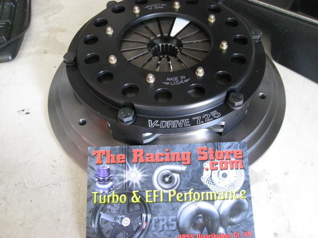

    quarter Master 7.25 twin disc

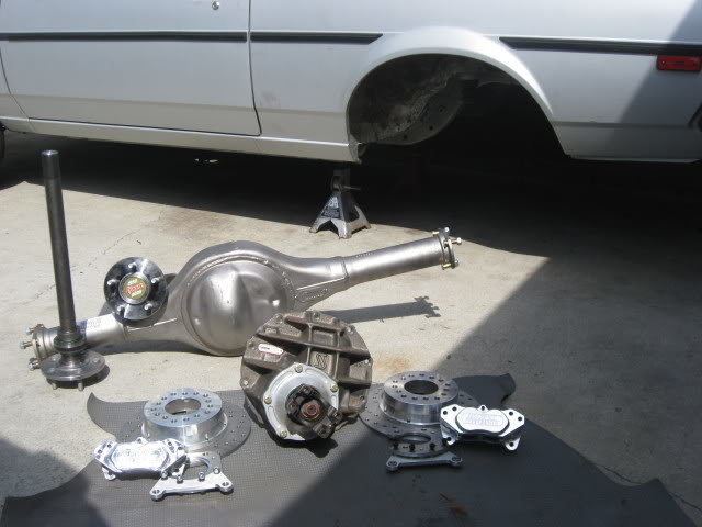

    ford 9" rear end
    strange 4.11 3rd member

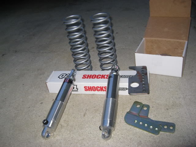

    QA1 rear coil overs

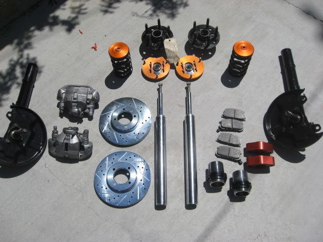

    Ksport front coilovers with AE86 struts

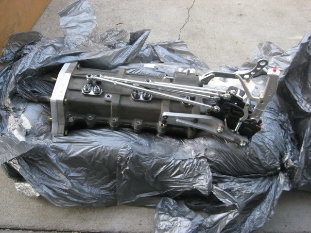

    G-force 2000 sequential 5speed trans

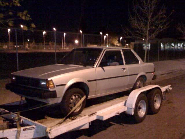

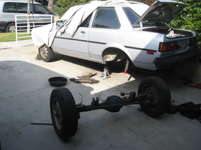

    Day we pick her up

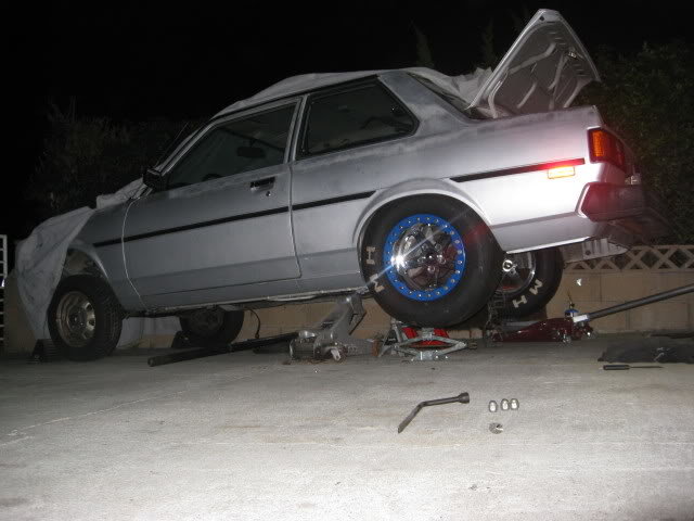

    test fitting wheel set up

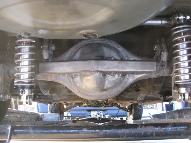

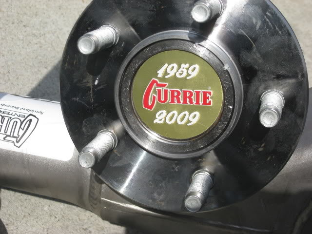

    rear end set up came in for me to start fabbing
    front suspension
    rear suspension

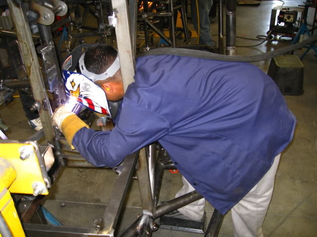

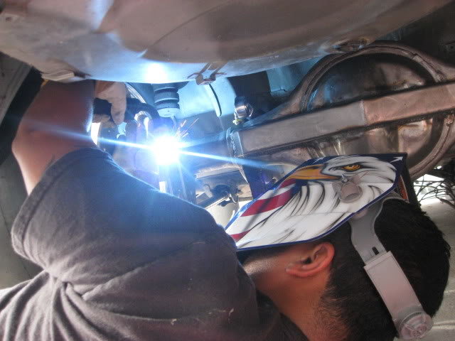

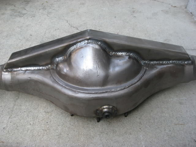

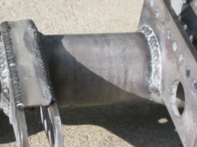

    i welded up the reenforment backing for the 9"
    me on my daily grind job... LOL

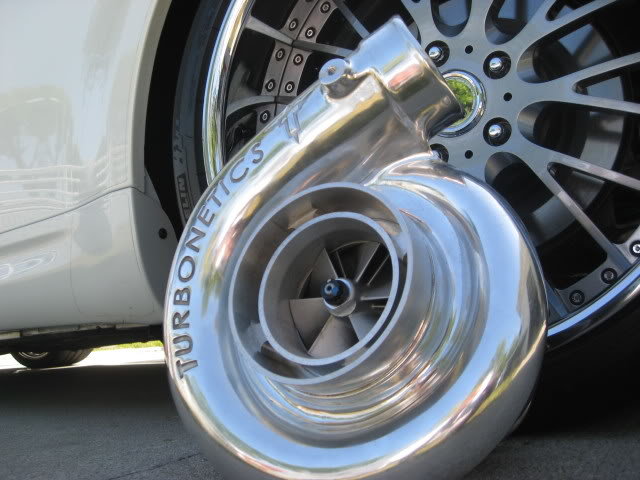

    turbonetics super thumber T76.... thats a 19" rims its in front of... LOL

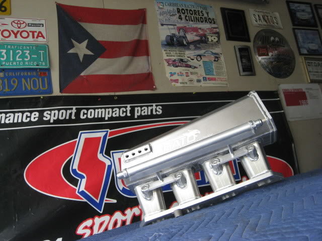

    Gato intake

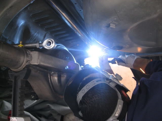

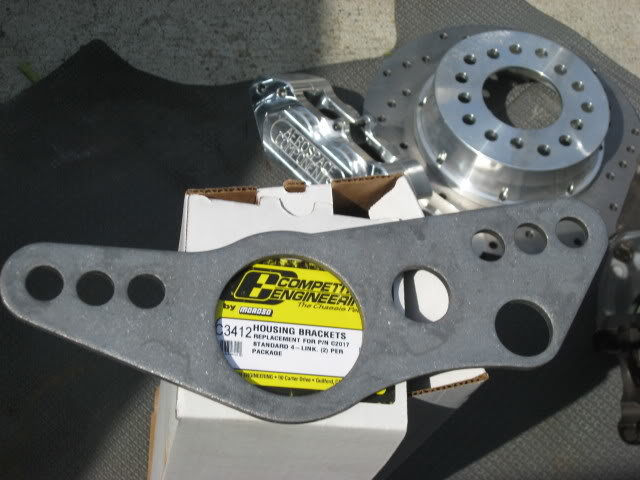

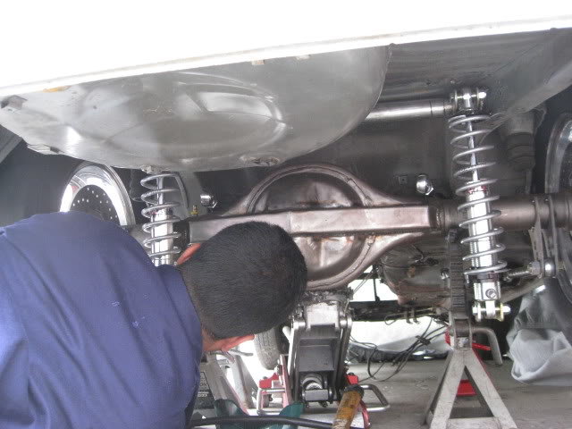

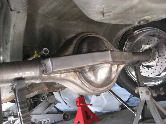

    fitting the 9" and my custom 4 links
    me mocking up the rear
    diff done

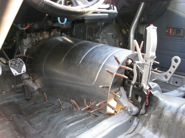

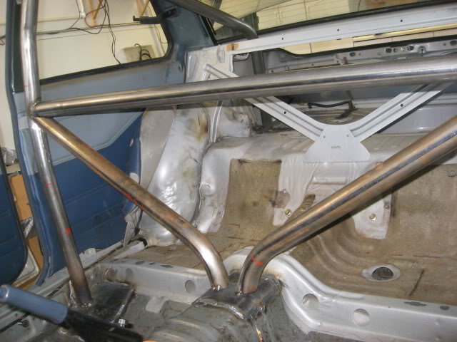

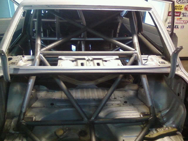

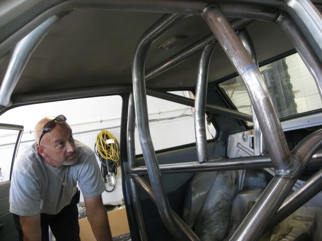

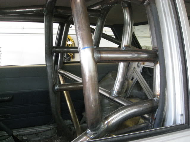

    doing the cage
    quatermaster twin disc

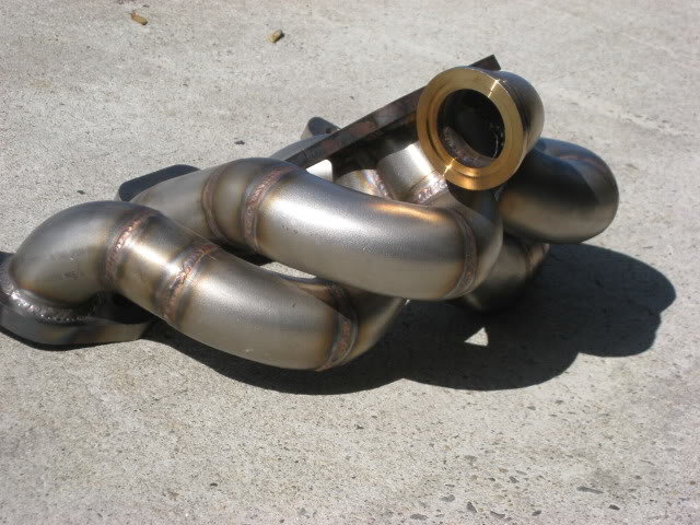

    turbo mani

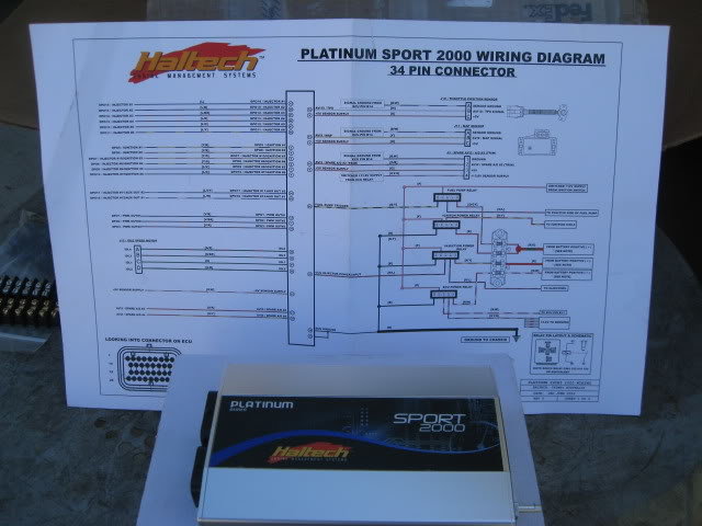

    StandAlone ECU

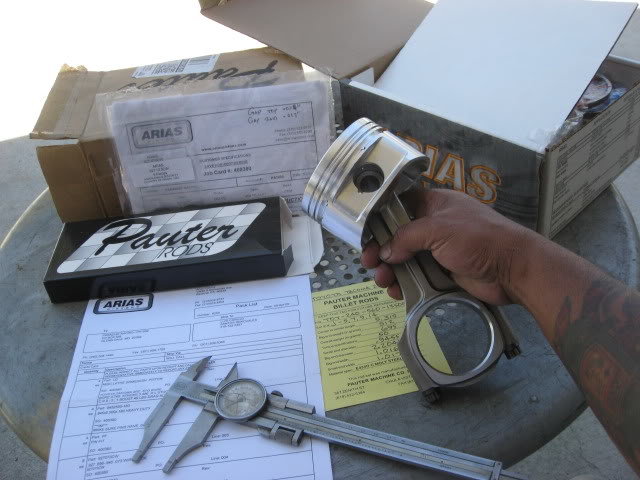

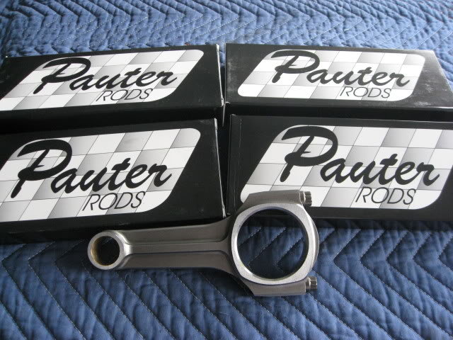

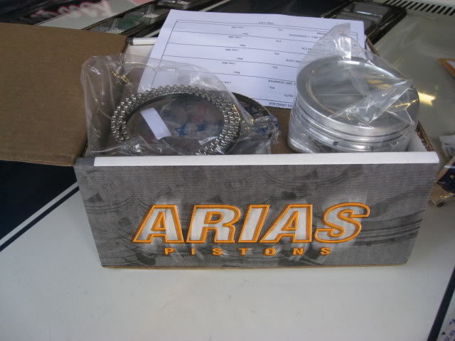

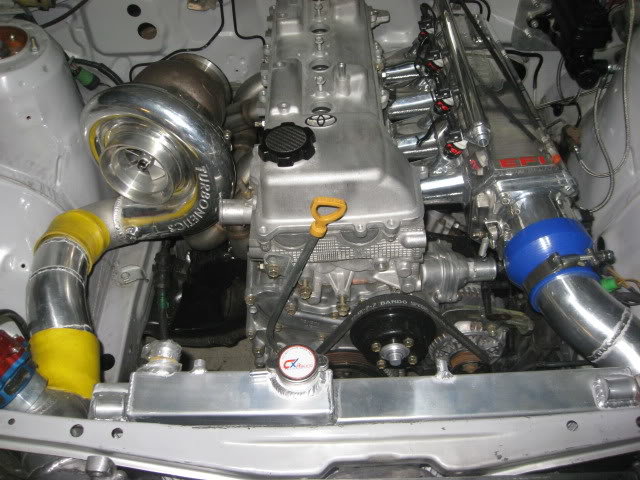

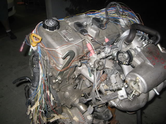

    specing pistons adn rods

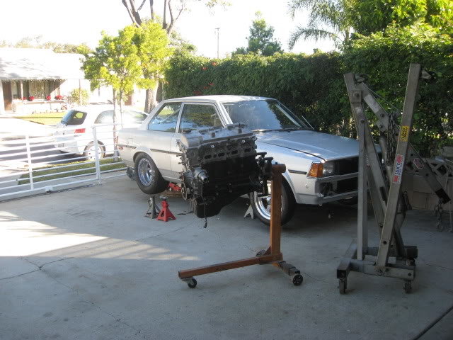

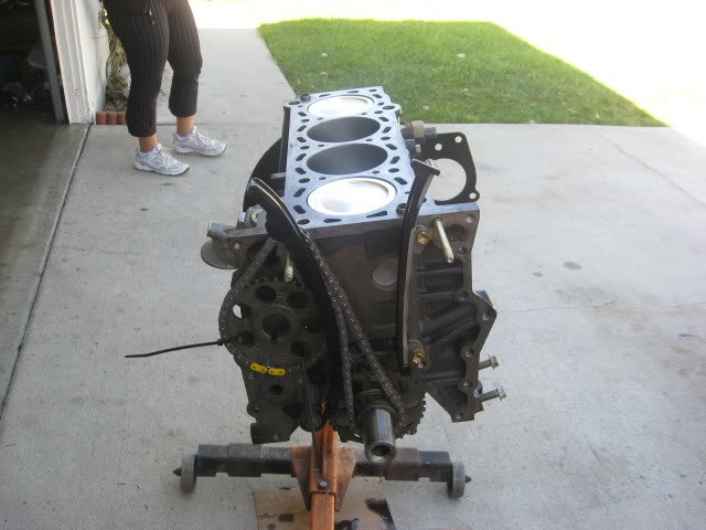

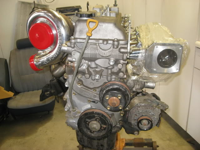

    bottom end complete
    motor complete and ready to go in
    all in...
    little by little

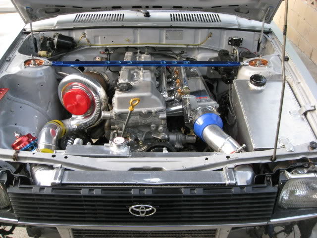

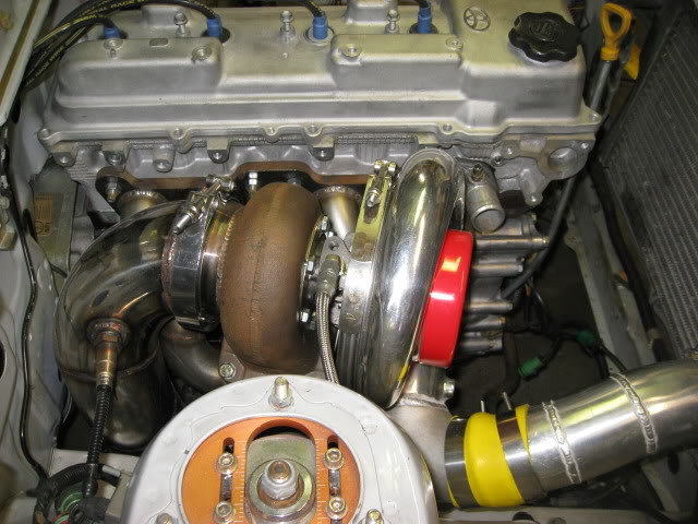

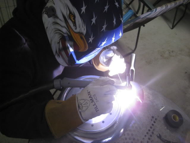

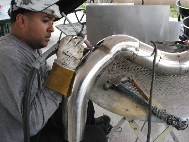

    welding a elbow on the turbine
    intercooler piping done
    again making the 4" downpipe
    all done

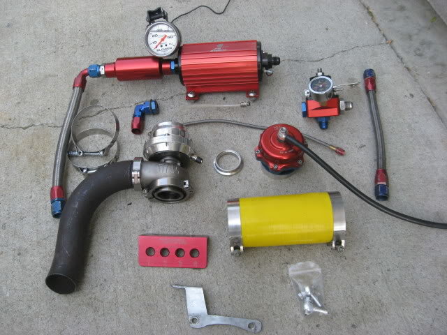

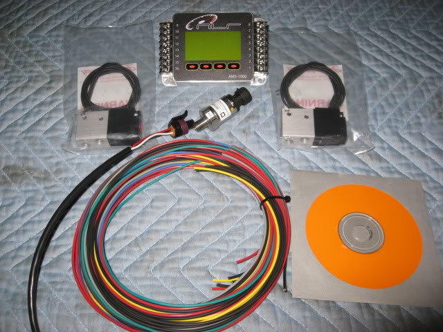

    boost controller
    had to move her from my dads place to mine for some more work so it was hooked up to my TACO

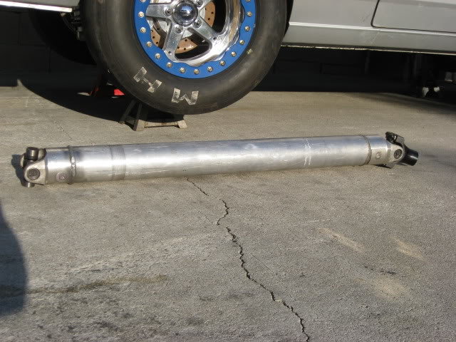

    aluminum drive shaft
