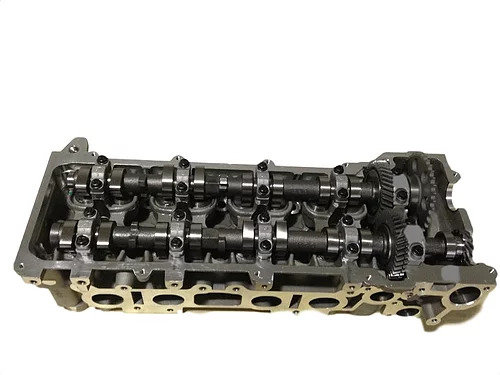

    Toyota 2.4/2.7 2RZ/3RZ 8 port intake Assembled Cylinder Head | King Cylinder Heads
  13. Nov 15, 2021 at 8:05 PM
