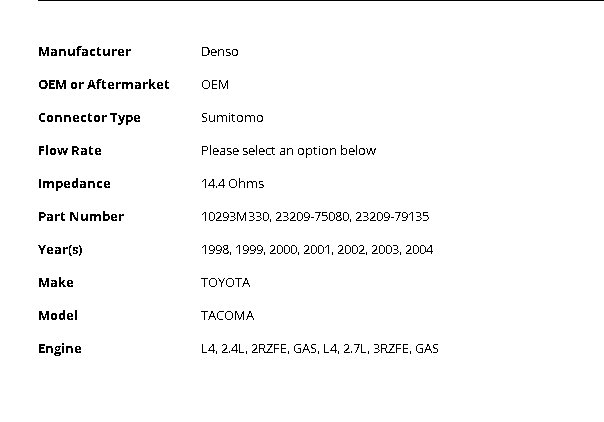

    I ordered these although the part # on the original pink Aisan injectors is 23250 75080… the reviews and Q&As indicate they fit on a 2002 2RZ so should be okay.
    $540 CDN with shipping. Ouch. I hope they will be good. I’ll report back after installing.

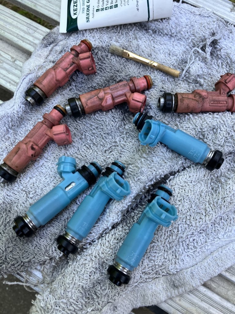

    IMG_8775.jpg Got the new fuel injectors from FiveO Motorsport . UPS added their surprise fee, of course ($67), so was about $650 CDN in total. Still half the price of four from the Toyota dealership.
    I installed them and it was a success. Accelerates so smoothly now and the idle is better too. A noticeable increase in power (when you only have about 120 hp at the wheels it is easy to notice even a 2hp increase - lol)
    Thanks for all the advice and the recommendation of FiveO Motorsport. Fast shipping from Oregon and excellent product.
    Photo shows the new blue ones. You can see the cracks in the housings of the originals.
