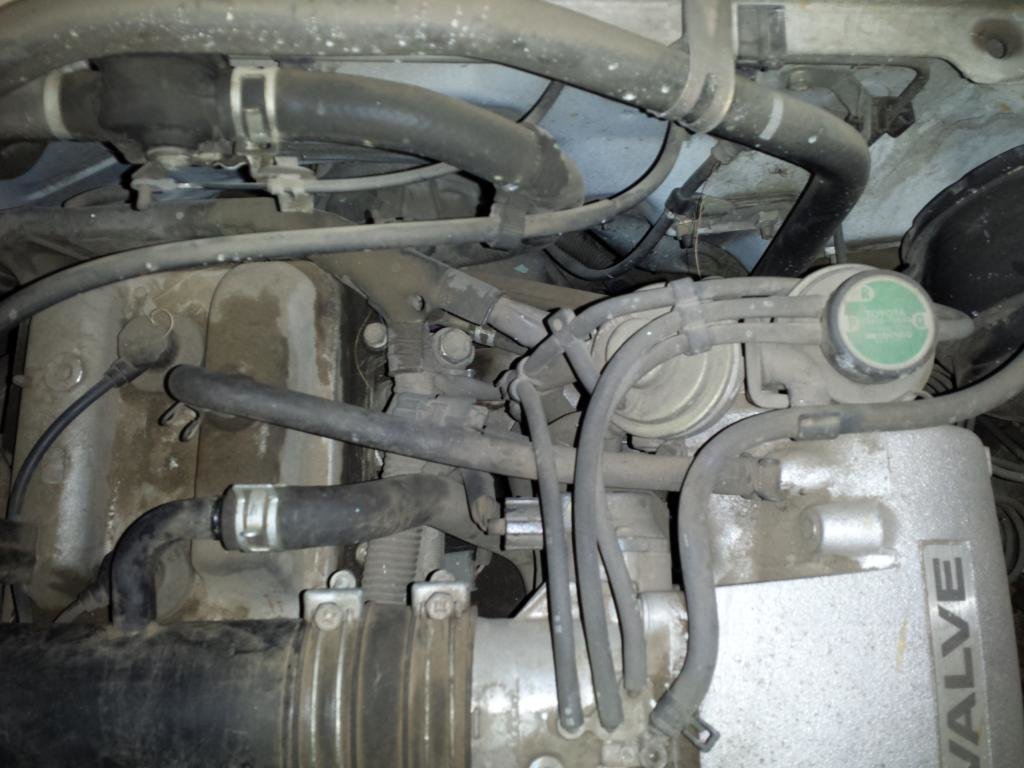

    There shouldn't be any tension in the throttle cable. It should be just loose enough to allow the throttle to fully close. So, you may have installed it with tension if you turned both nuts.
    This is the best picture I have showing the vacuum lines on top before disassembly. Two of the hoses in the picture go under the throttle body to the VSV for the EGR. The VSV doesn't allow vacuum to the EGR valve when the engine is still cold. You may still have a vacuum hose diagram sticker on the underside of the hood.

    It looks like all of my lines are connected correctly and most of the hoses are still in good shape. I'll replace a couple of them and move to the Idle Control Valve.
