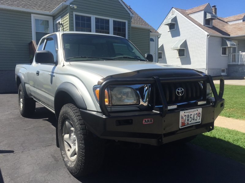

    My Tacoma
    My dads 2004 Tacoma, welded the rot on his frame and I did the Arb for him:

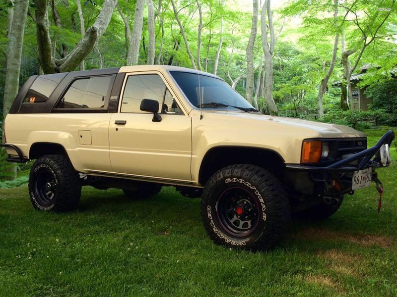

    And his 87 4Runner he painted in our backyard:

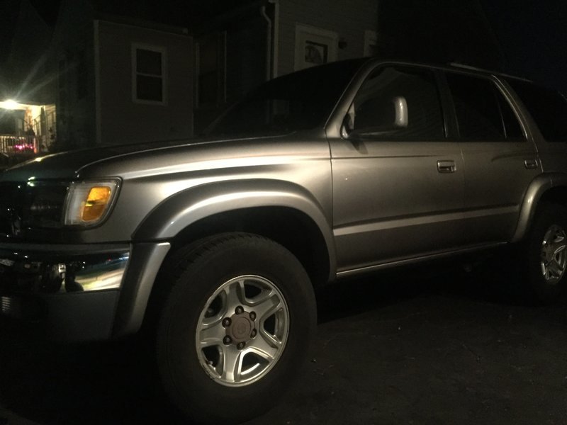

    Found her through a friend of a friend and settled the deal for 1500$ 2001 V6 4x4 Sr5 with 200K miles and in decent shape. Hoping I did well. Sorry I don't have to many pictures yet, basically haven't had time to even touch it yet, I will soon, Crazy couple of days...
    There are a few things that need to be addressed, obviously first is Inspection and Tags. The check engine light is on, which I believe threw the VSC OFF and TRAC OFF lights on as well. I found a tear in the intake rubber boot so I ordered a new one today, obviously that is causing a vacuum leak, but unsure if it could be related to the CEL. Online research shoes its a EVAP related code. If anyone has any ideas other then tightening my gas cap I would really appreciate it.
    Also, the 4x4 indicator lights come on when the push button is engaged, but then takes a while to come out of 4x4, could this be related to the lights on as well? I don't entirely understand the VSC and TRAC system my 4runner has as my Tacoma has a Manual Hub and 4x4 set up, so no electronics. But from what I understand the 4x4 is engaged by Vacuum, so a leak or something along those lines could very well be a contributing issue. Any help here would be great. I also need to replace the boots on the steering rack before inspection as they're torn.
    I really like it so far and the previous owners just did the Radiator, Cat, Headlights, and the Timing Belt. For some reason when the timing belt was done they didn't do the accessory belts, So thats on the list. To do. Today I purchased:

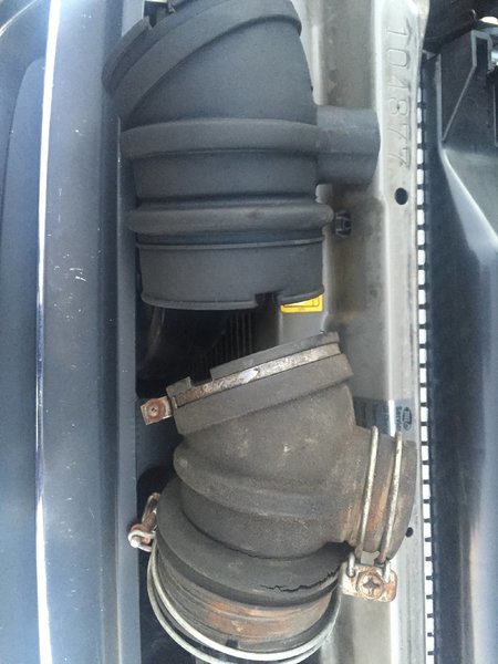

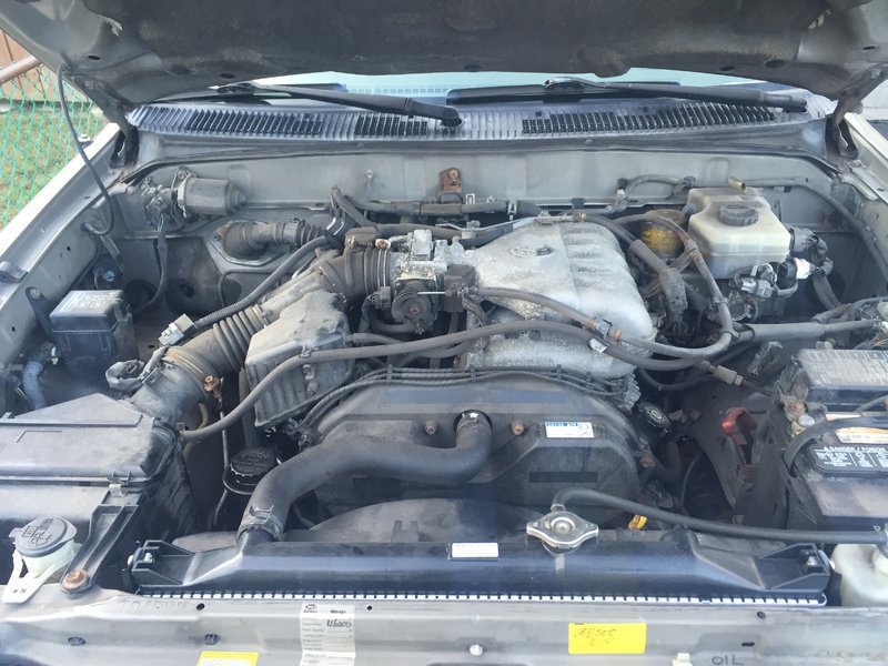

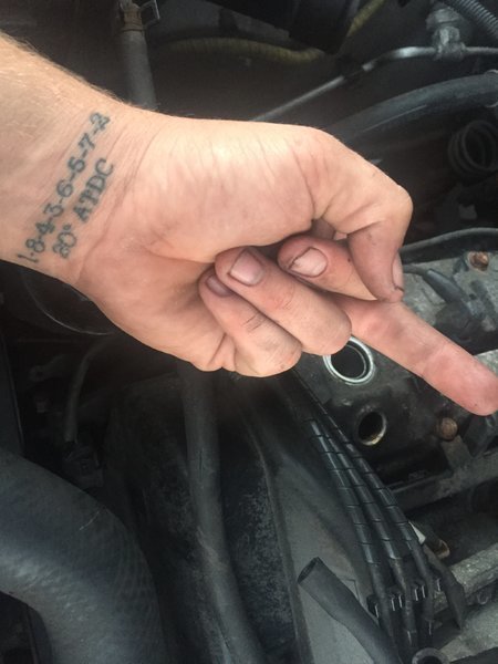

    Had a little time to fool with the 4Runner after work today and try to get a few things done, First I wanted to install my new intake boot since the old one was ripped, and quickly discovered the one I was sent was not what I need and will not work. You can see the difference.....I could probably make something work with the incorrect part, but I would rather not:

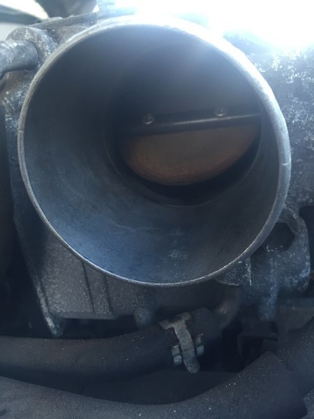

    Also took a look in the throttle body, The picture I posted is with my hand manually holding the throttle with the cable attached to it wide open, but the throttle plate doesn't go completely open, it will if I reach in with my fingers and open it. Is this normal?

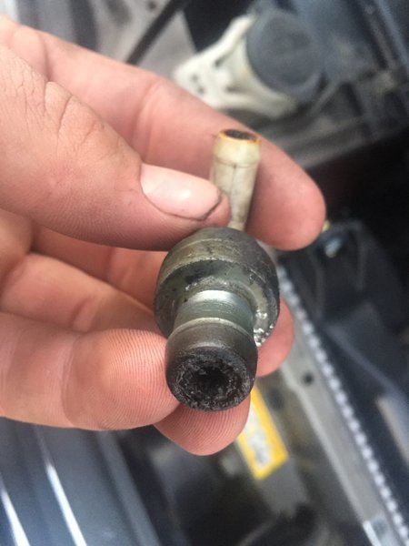

    PVC valve changed, and the old gasket fell apart in my hand, Awesome. Hopefully I can install a new one without taking off the valve cover.

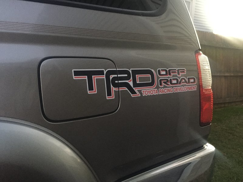

    And the last fail of the day was installing some TRD decals off eBay, the white trim on them looks really goofy, gonna order a set without that. I didn't realize it was there when I ordered them;(

    Looking at the sludge on that PCV valve, it may not be a bad idea to pull the valve covers either way. New gaskets never hurt and you'll be able to clean them up and see what the top of the valves and rockers look like. Id say something isn't right with that TB also, I'd think it should open all the way.

    Well the 3.4 has shim and bucket valves so I couldnt really inspect much other then the Camshafts, but your right new gaskets never hurt.
