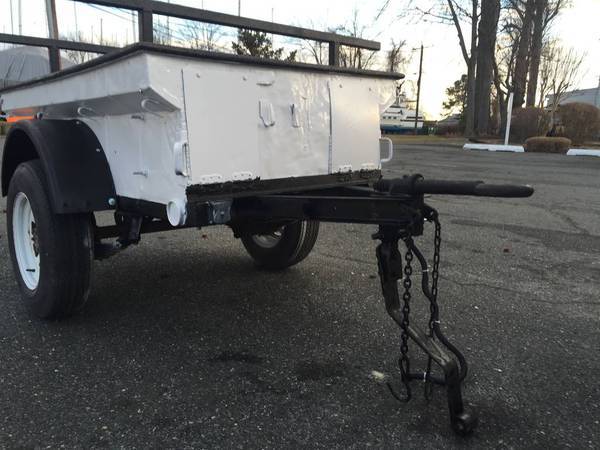

    I always liked the idea of having a roof top tent, but could never justify having one on the truck. The solution? A off road capable trailer!

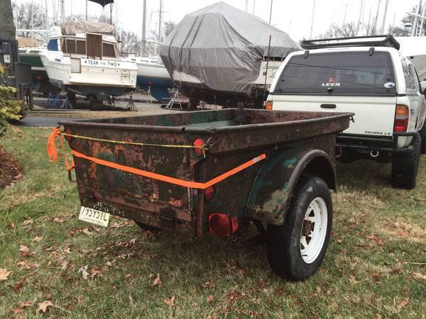

    I started looking around Thanksgiving and after a few weeks found one in Pa about 2 hours from my house in Baltimore. As luck would have it I was going on a hunting trip and on the way back if I detoured it would only be a extra 45 minutes or so. Well I made the arrangements and this is what I saw when I got there, The original screen shot off Craigslist:

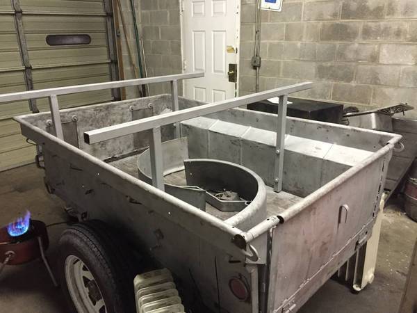

    Then brought it home and took the wood sides off and power washed it at work hoping some loose rust would come off. It did not.

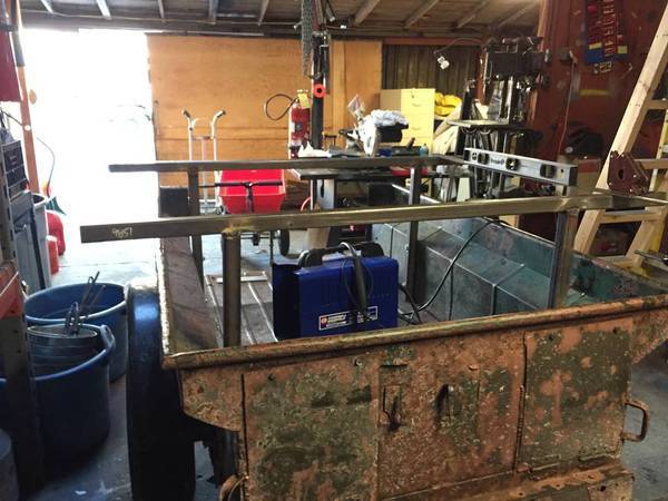

    I knew I wanted a roof top tent on it, but also wanted to be able to use it as a regular trailer for my motorcycles if need be. So I went to the local metal shop and had some A6 Hot Rolled square tubing cut and welded and bolted it to the sides with 1/2 Hardware.
    For my job I do allot of sanding on boat hulls, so I gave it a try on the trailer. Not even worth the time it took to set it up, years worth of paint were hardened and sealed to the thing. Sandblasting it is. This has to be one of the two best decisions I have made during the project. It actually ended up being Glass Blasted and turned out great:

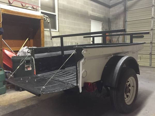

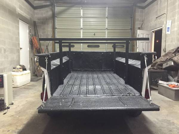

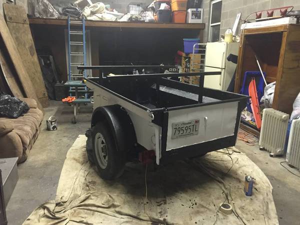

    From here I Welded up some flat-stock to the tailgate on each side where the owner had cut out the gate and left 2inches of gap on both sides, this actually worked alright and went well as it almost looks like some bracing from the factory. Also patched some of the larger holes in the floor, there were 3 of them. THEN I ended up having off last Friday and was able to drop off, pick up the trailer from the sandblaster same day! That was the way to go, they did a amazing job and everything was perfectly prepped for painting. The guys said it had maybe 10 coats of old paint over the years on it and I never would have gotten it off sanding it.
    Anyway had a buddy of mine let me use his garage for the weekend and we got to work, Since its freaking zero degrees in Baltimore right now the first issue before anything was heating up his garage, with 5 space heaters, and in " True Baltimore Fashion" we used 3 Crab Steamer Boilers to get the temp up to 65 degrees. Still not great but it wasn't going to get any better then that. From there we used filler primer to fill pitts from glass blasting, and then regular ole Gloss White Rustoleum to match my Tacoma.

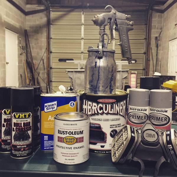

    After 2days of painting and warming back up the place the white was setting in nicely and we began to beeline the rest. I Opted for Herculiner as I couldn't justify another 300$ for Linex even though I love my truck bed Linex'd. This was the second best idea I have had for this project. I love this stuff. We did the bed, tongue, underside bed and frame, Fenders, top rails, and the rails for the RTT.
    First time painting with a gun, and working with bedliner and even though we made a mess, I like to think it turned out alright! The front got a little messy, but will be covered by a tounge box anyway. Ran new lights and wire harness as well. Also used some basic cable to allow the tail gate to function like a real tailgate and not just fall right down.

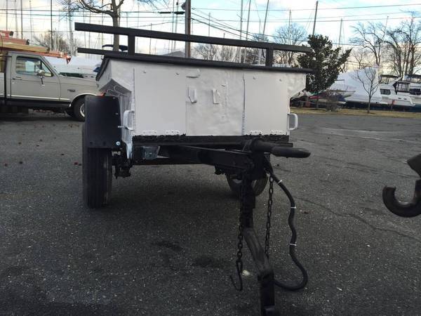

    Fast forward to today I had some down time at work and was able to flip the lunette the right way, take off the add on Boat Trailer Jack, Clean up and wrap the new light wiring and finally reinstall the support leg that also came with the trailer, but I assume this is also non original. May get to that later. Tomorrow I may be able to get the tailgate latches on, right now I'm using a ratchet strap.

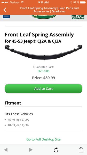

    The Leaf Springs are 100% shot so that will be the next purchase. I found these will fit, all I have to do is press out a spacer and it should bolt right up:
    I really like the way it looks with the truck and can now start accessorizing the trailer. Things like mounting my Hi-Lift, A Tongue Box,Maxtrax, Led's, Tepui RTT, General Grabbers and Rims to match my truck, On Board Air ( IAS Group Buy ) on board electronics stored in the Tongue Box, Side Mounted Rotopax, And I have been contemplating some sort of slim water tank.

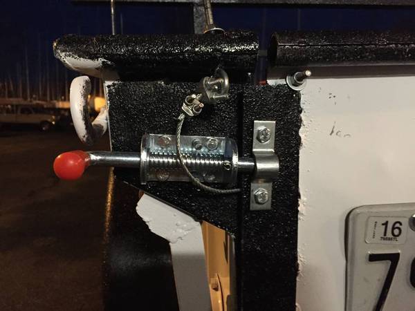

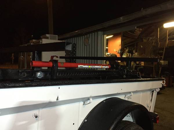

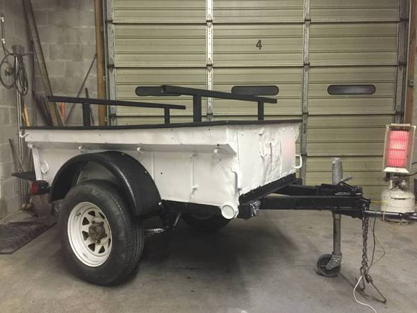

    Well stayed a extra hour at the shop after work today and finished up the latches, I got the spring pin part from Northern Tool and the hook that holds the pin I found laying around my work! I think its really clean an works just fine.
    Also decided to get my Hi-lift mounted. I would like to come up with some sort of Quick Disconnects besides Quick Fist but we will we what happens. For now just regular 1/2 inch through bolts. It was getting dark and the shop lights weren't cutting it so I had to bring over the Tacoma to save the day:D Side led's FTW!!

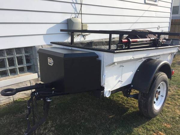

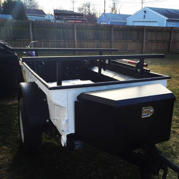

    Got the classic Harbor Freight Tongue Box! Literally couldn't fit any better! I haven't mounted it yet, but my plan is to just run some 1/2" bolts through it right to the frame. I have seen guys build a little frame platform for them, but I really really like how it sits just under the forward lip of the trailer. I am obsessed with how well this box pulls the front of the trailer together.
    Also my Tepui Kukenam Roof Top Tent just came in today ( Thanks BoxRocket ) stay tuned for that update!

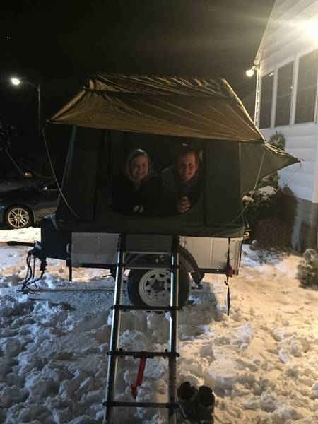

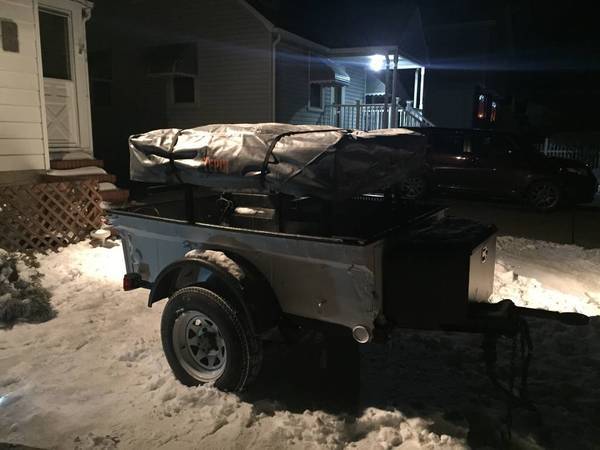

    Here it is guys! I was so excited to install it today after work I didn't care that there was a foot of snow on the ground! Its awesome and mounted up perfectly. May still have to do a little shake down/ align a little better, but its pretty cool if you ask me. Plenty of room!
    Can you tell we are a little excited?
    All buttoned up and sits nicely on the homemade rails. I really like the height!

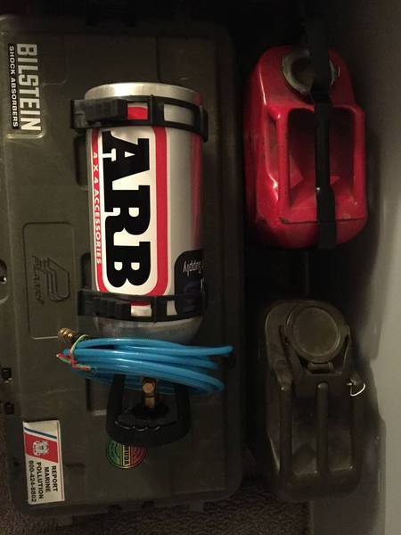

    Got the On Board Air System and two Jerry Cans one water and one gas, gotta figure out how to mount them now.
