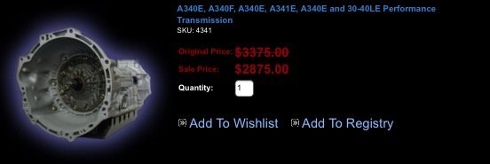

    Late revival but if you gernade your transmission have you thought about getting the IPT full built performance A340 transmission? Might help handle the boost!!image.jpg
