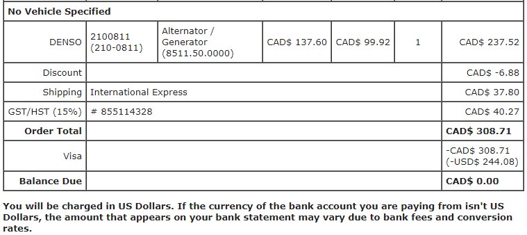

    Done,
    Ordered!
    Thanks RockAuto for the 5% discount, Thanks @05Taco4x4 for putting in the leg work.

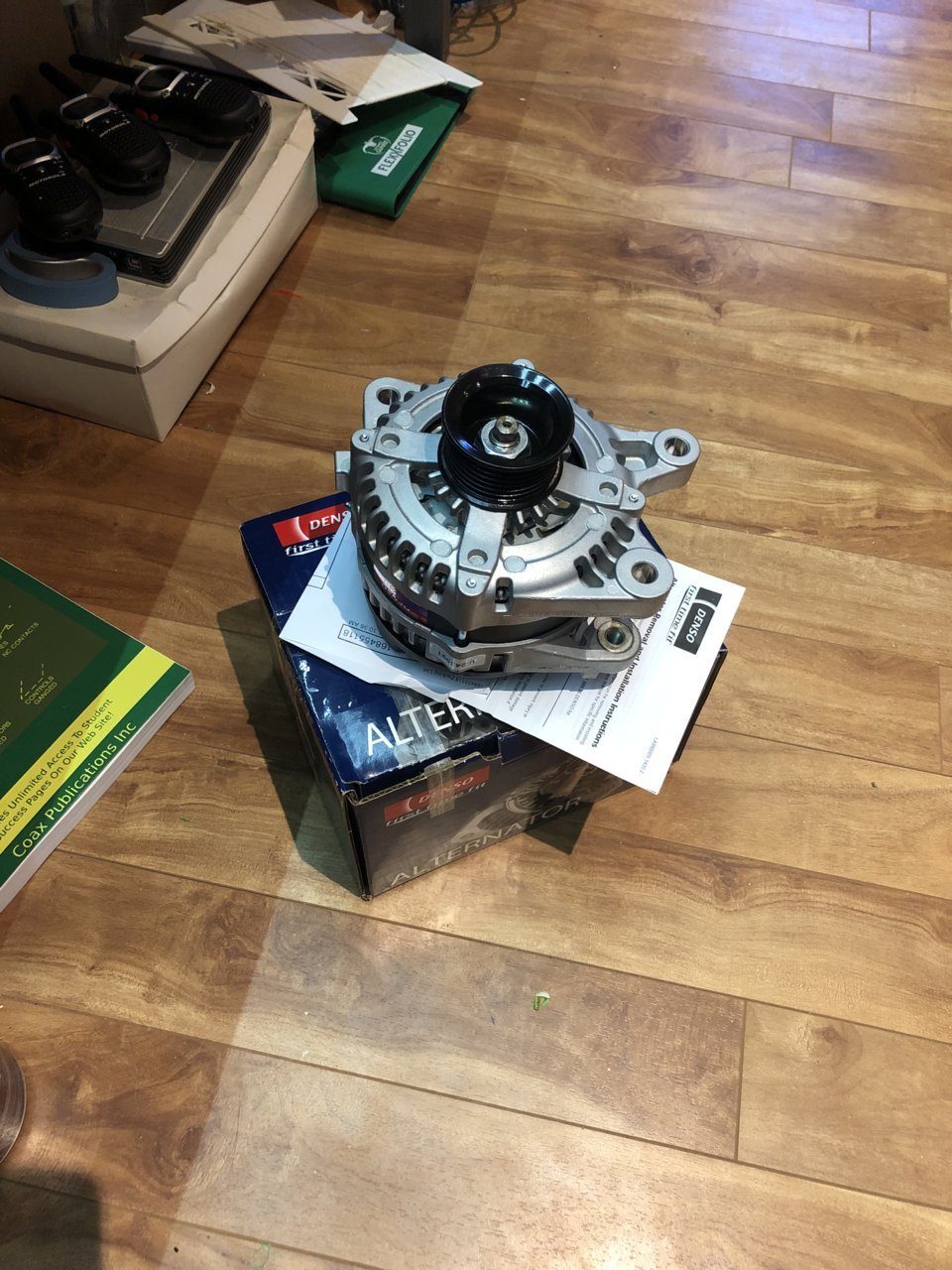

    Dang!
    Toyotapartsdirect.ca & my local dealer can't "find" this part number
    91553-81060 Bolt (longer)
    even though I can google find it in the US :censored:
    anyone have the specs on the bolt? I'd like to have this beforehand so I can get this done in one shot.

    Pull the one in your block and get the thread, length and then add the thickness of the third leg on the new one to the length and you'll have it.

    great writeup on the alternator upgrade. I just ordered one for my 2tr-fe swapped 4runner, however there is one thing to note about people who have 07+ 2tr-fe trucks. the 130 amp Hiace alternator (DENSO 210-0811) is a "early" style with a fixed pulley. In 2007 Toyota switched to running a decoupler pulley on the alternator. due to how the decoupler pulley functions it allowed Toyota to get away with a softer belt tensioner to get (slightly) better fuel economy. If you have a 07+ truck you need to switch to a heavier 05-06 tensioner assembly to avoid belt problems.

    Can you swap the pulley?
    @05Taco4x4 Have you had any issues with your belt? Did you swap the tensioner?

    I believe the end of the shaft of the alternator is different and the pulley can't be swapped. I am assuming the OPs truck is a 05 judging by his username so there is no reason to swap the tensioner.
