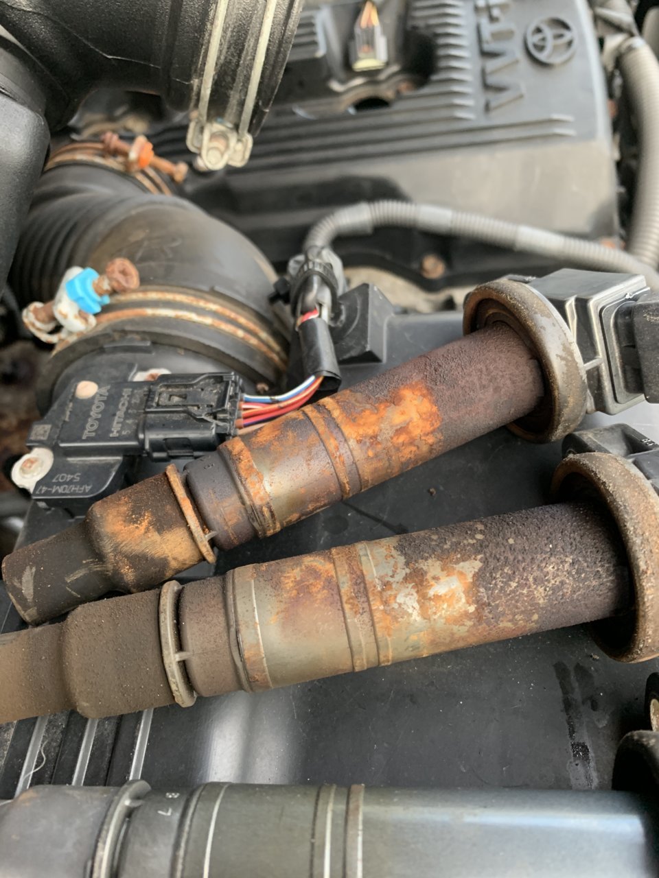

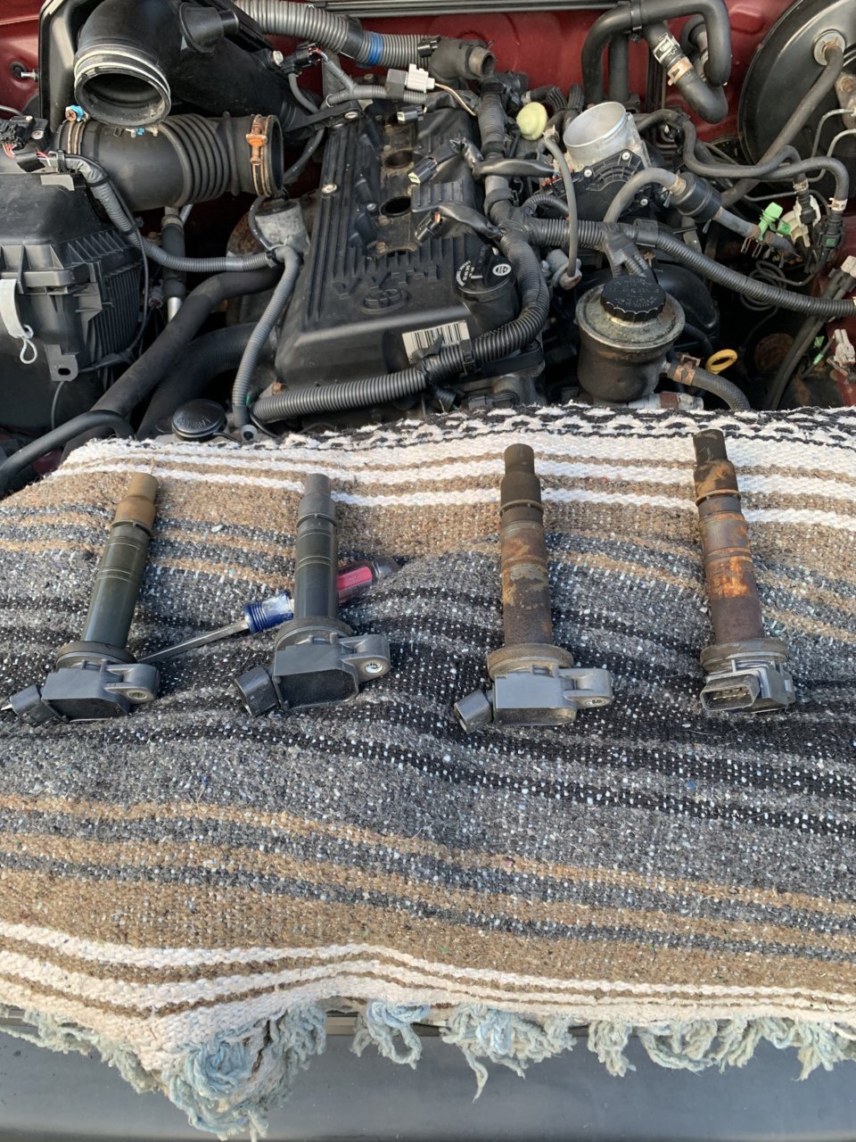

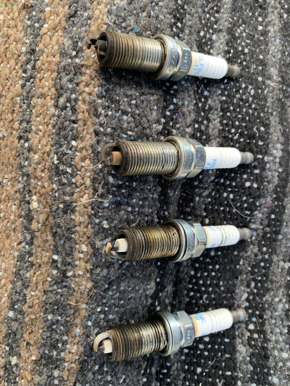

    So last week my engine started to idle rough on cold start and then the CEL came on. P0300 followed by P0301... bad coil cylinder 1. I switched the coils between cylinders 1 and 2 and the code changed to cylinder 2, bingo issue diagnosed.
    So I bought a replacement coil(Denso) and Denso spark plugs from my auto store and commenced to swapping them out. I did the spark plugs a year ago or so but when I was in there switching the coils for cylinders 1/2 I noticed they didn’t look too hot so I figured wth.
    It was all going fine until I pulled the coil packs for the back two cylinders and saw all this oil/rust covering them! Wtf! They didn’t look like this when I was in there replacing the spark plugs last year.
    Any thoughts what’s happening? Valve cover gasket? I had the VCG done by the dealership when they replaced my frame 4 years ago.
    Plugs/coils, left to right cylinders 1 through 4.

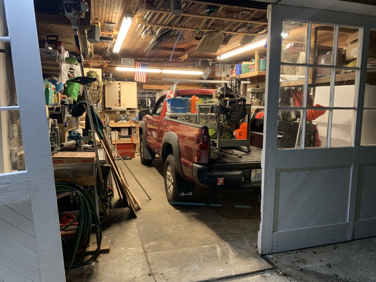

    0B3E71E3-3CBD-48CF-9B60-86A57EAC1CF3.jpg CEC3FD39-0535-4CAD-8CC6-2F537FB15D56.jpg 879B494C-6A73-4EAB-966B-5A7946FF1ADB.jpg Thanks for the support guys. I am still waiting for some prices and probably won’t hear anything until Monday. I am seriously considering doing it myself though.
    I just orders the gasket kit and head bolts from LCE engineering as was suggested in another thread. What else am I forgetting?
    Throwing in some pics of my truck and taco dog just so you can see what I am saving. The dog is very sad about the truck being out of commission.
