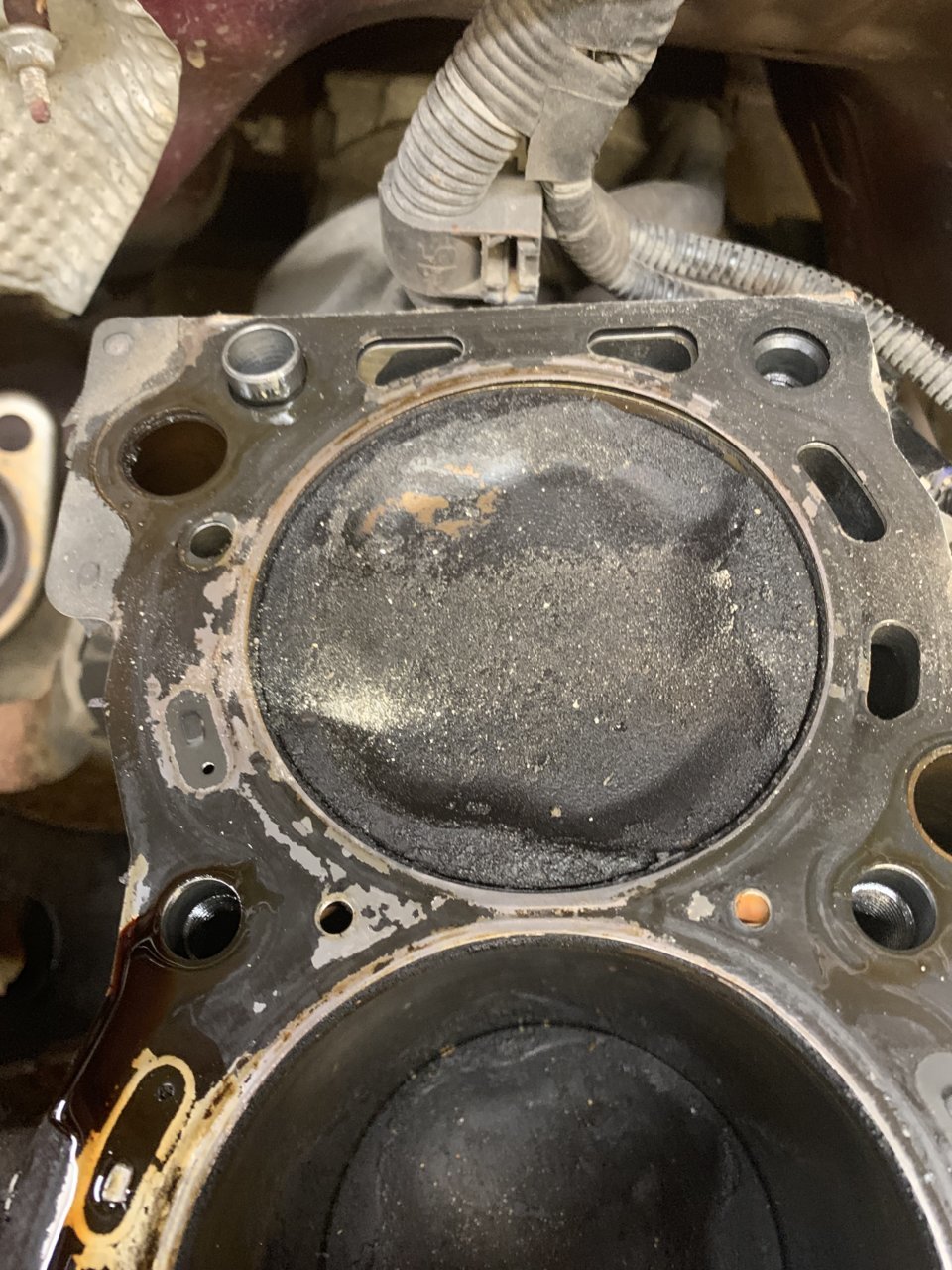

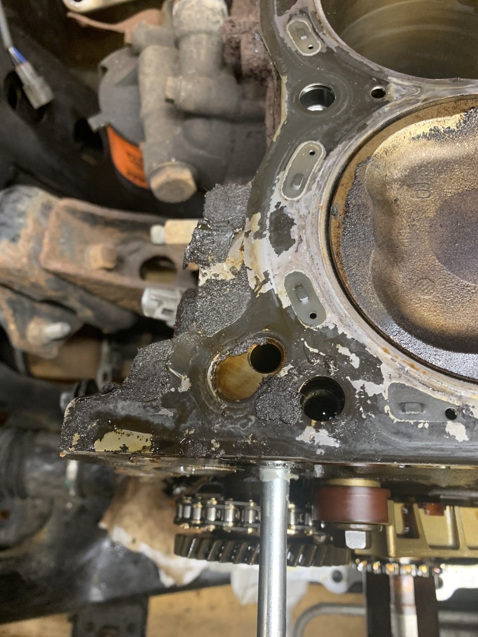

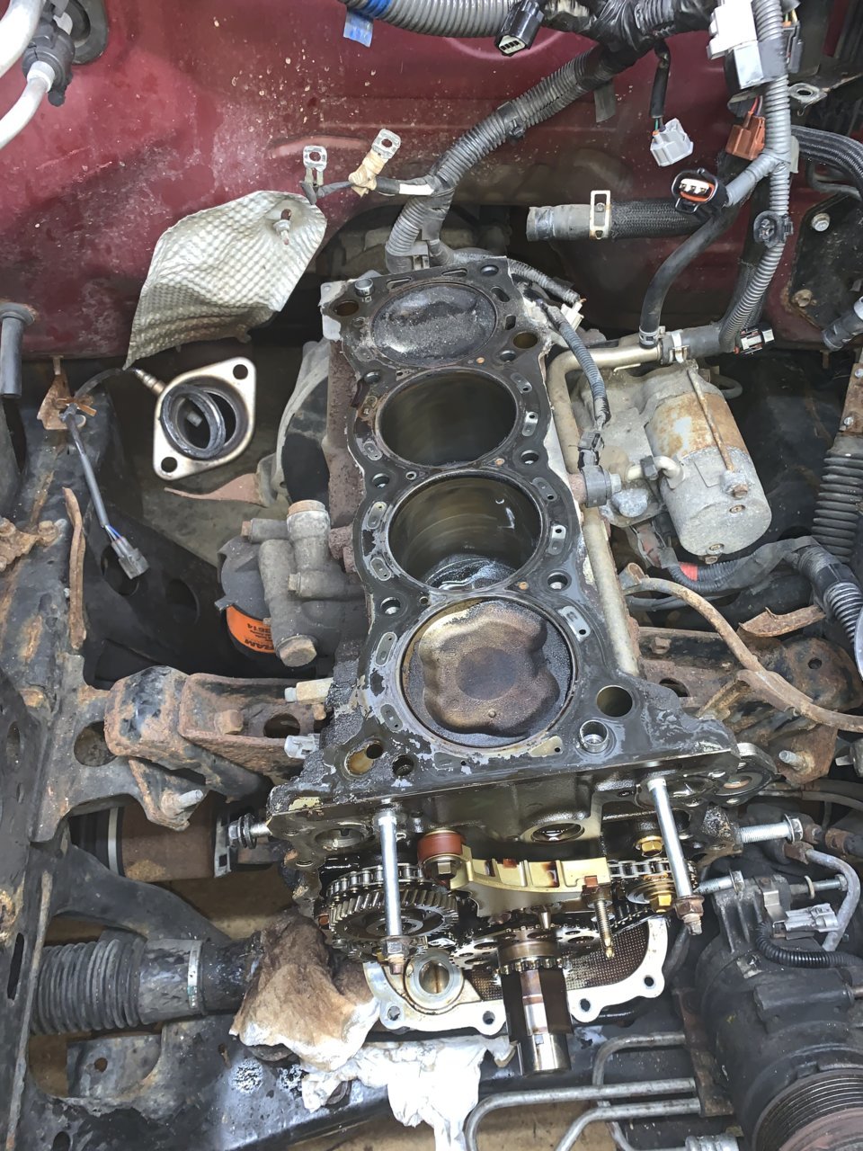

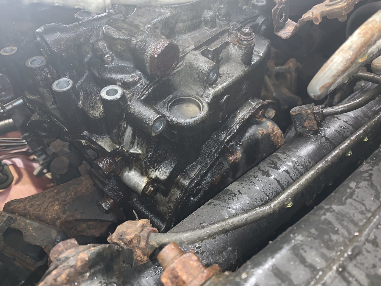

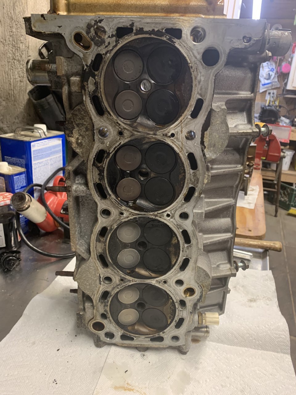

    I was able to get the timing cover and head off of the engine. Turns out I had all the bolts out. I just needed to work along the seam with a putty knife. They gasket sealer they used was good stuff.
    You can see on the front left where it appears the gasket failed.
    You can see the oil buildup on the corresponding surface of the head. Looks like both cylinders 1 and 2 were compromised which lines up with the p0301 and p0302 codes I was getting.

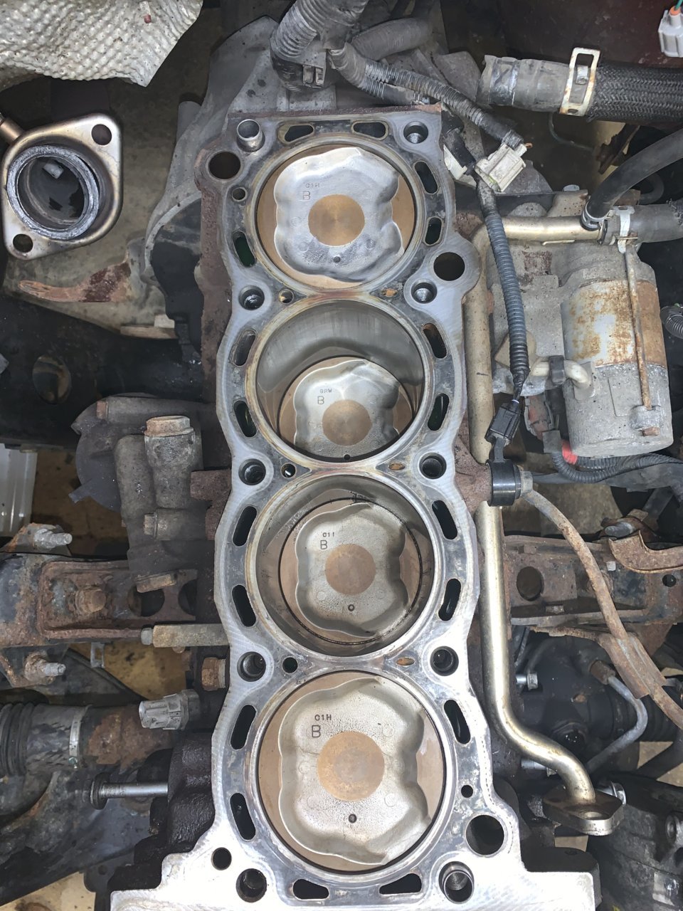

    Interestingly the head was dirtier on the front two cylinders but the back two pistons were WAY dirtier. It took a lot of work to get them clean.
    I dropped the head off at the machine shop yesterday and it is supposedly going to be done tomorrow so I will have it for the weekend which is nice.

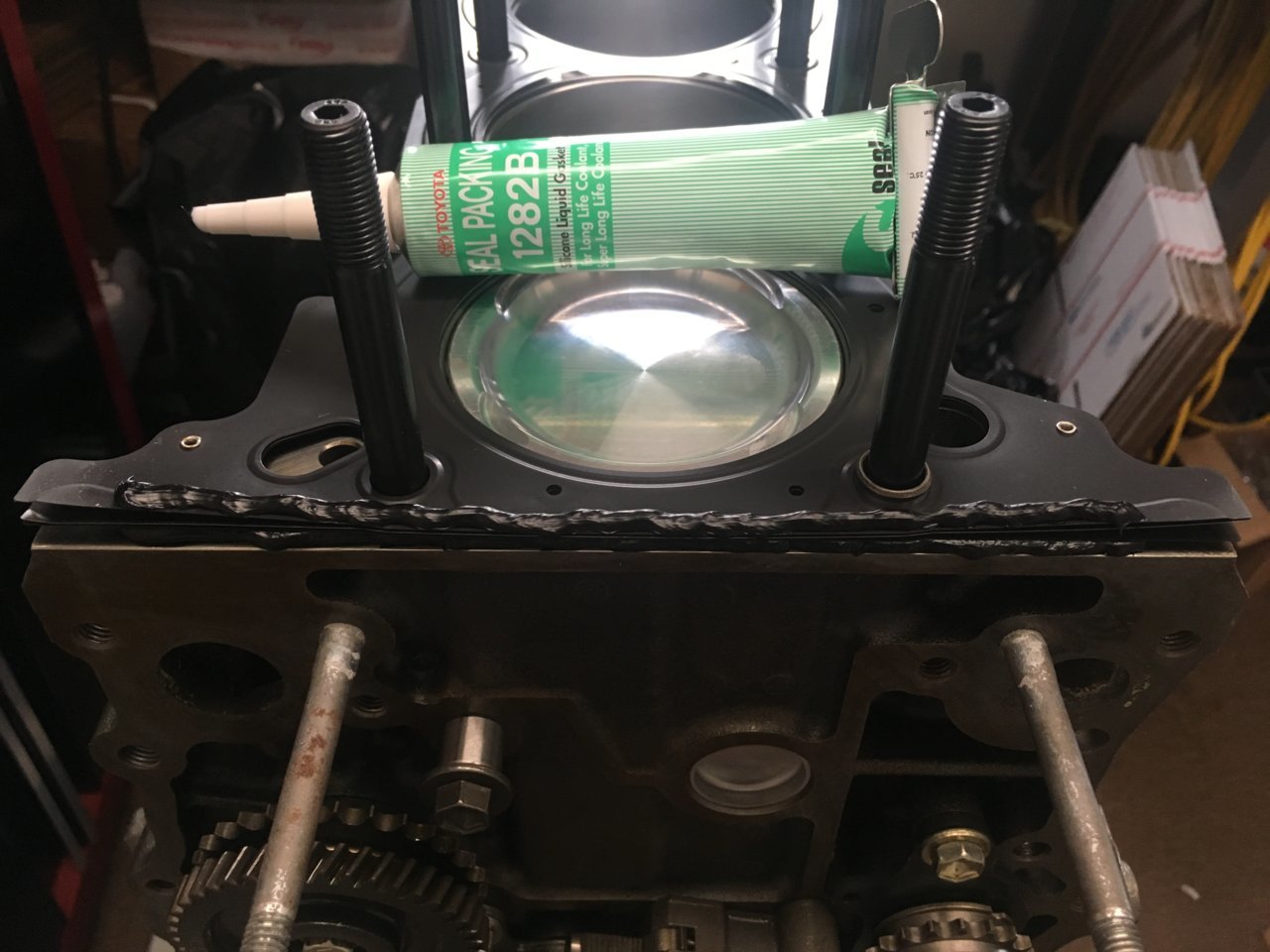

    That’s a stainless MLS head gasket, which requires a very smooth surface on head and block to seal correctly so definitely don’t use a needle gun. Felpro makes a performance MLS gasket which has an outer layer that was developed with Formula 1, because they were blowing out MLS gaskets- it’s really good. I believe Audi is using it for their OE gasket now. I used it on my build.

    That pdf I listed will give you part numbers for the Toyota gasket maker, there’s two different ones you’ll need when reassembling- get both don’t skimp on that part

    62
    2005 Tacoma Base 4x4 2.7L
    The machine shop just called. The head was warped and the valve seats and valves needed resurfacing. $450. Not sure how good of a price that is. I went with this shop on a recommendation from someone I trust. I didn’t shop around.

    I ordered a stainless gasket set from LCE already. Not knowing better myself I just decided to trust them on this part selection.
    I clean the block with a razor blade and checked it for flatness. It is very flat and within spec. I am certainly not going to use a needle gun on it.
    Not sure if you are suggesting I go with something other than the stainless steel one I now have?
