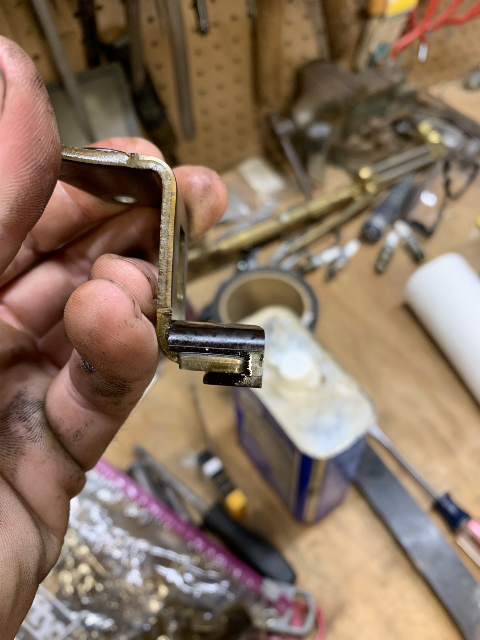

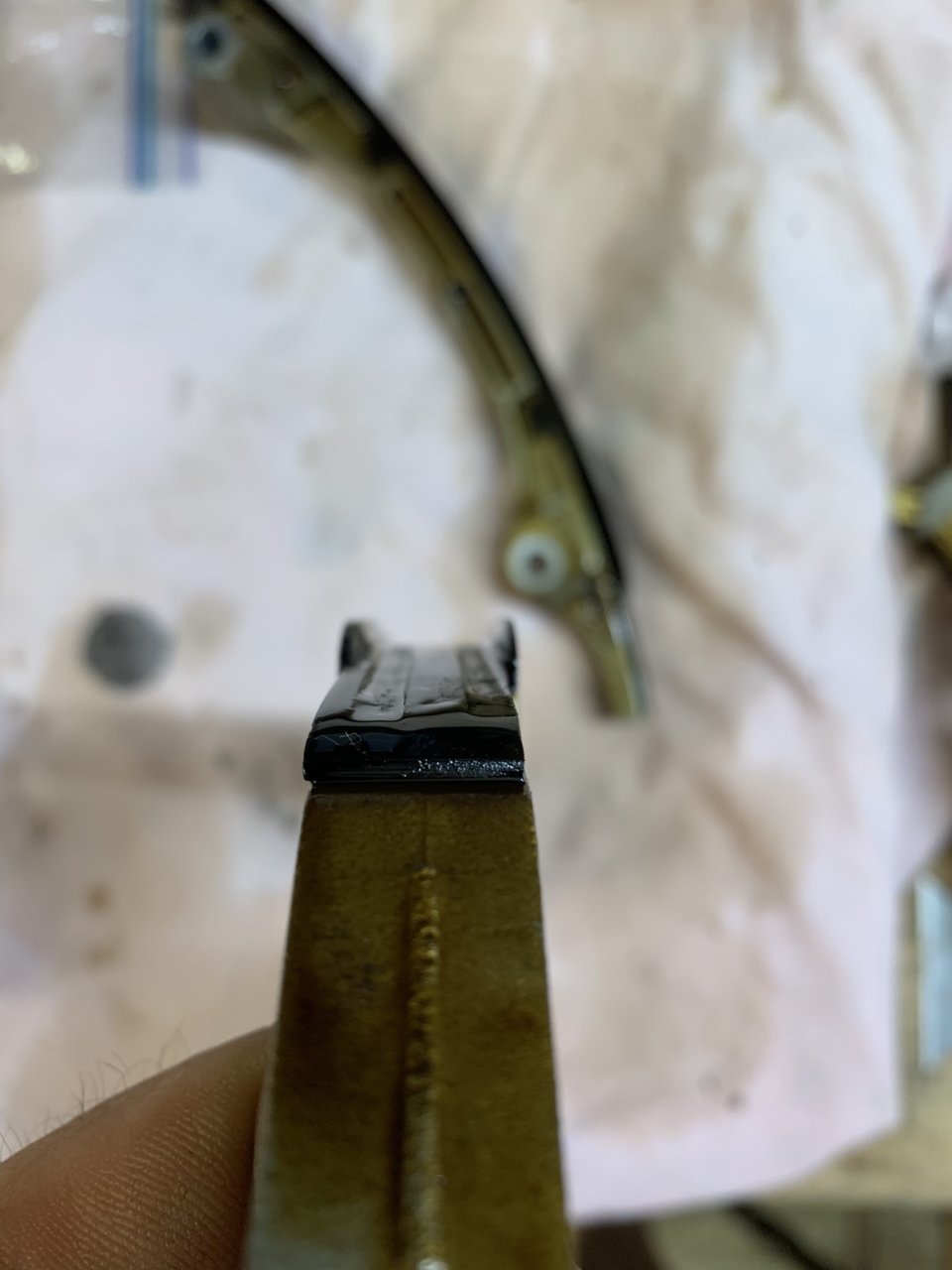

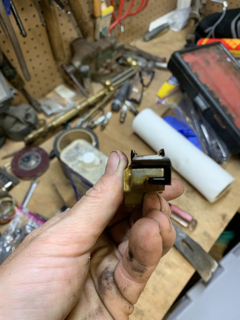

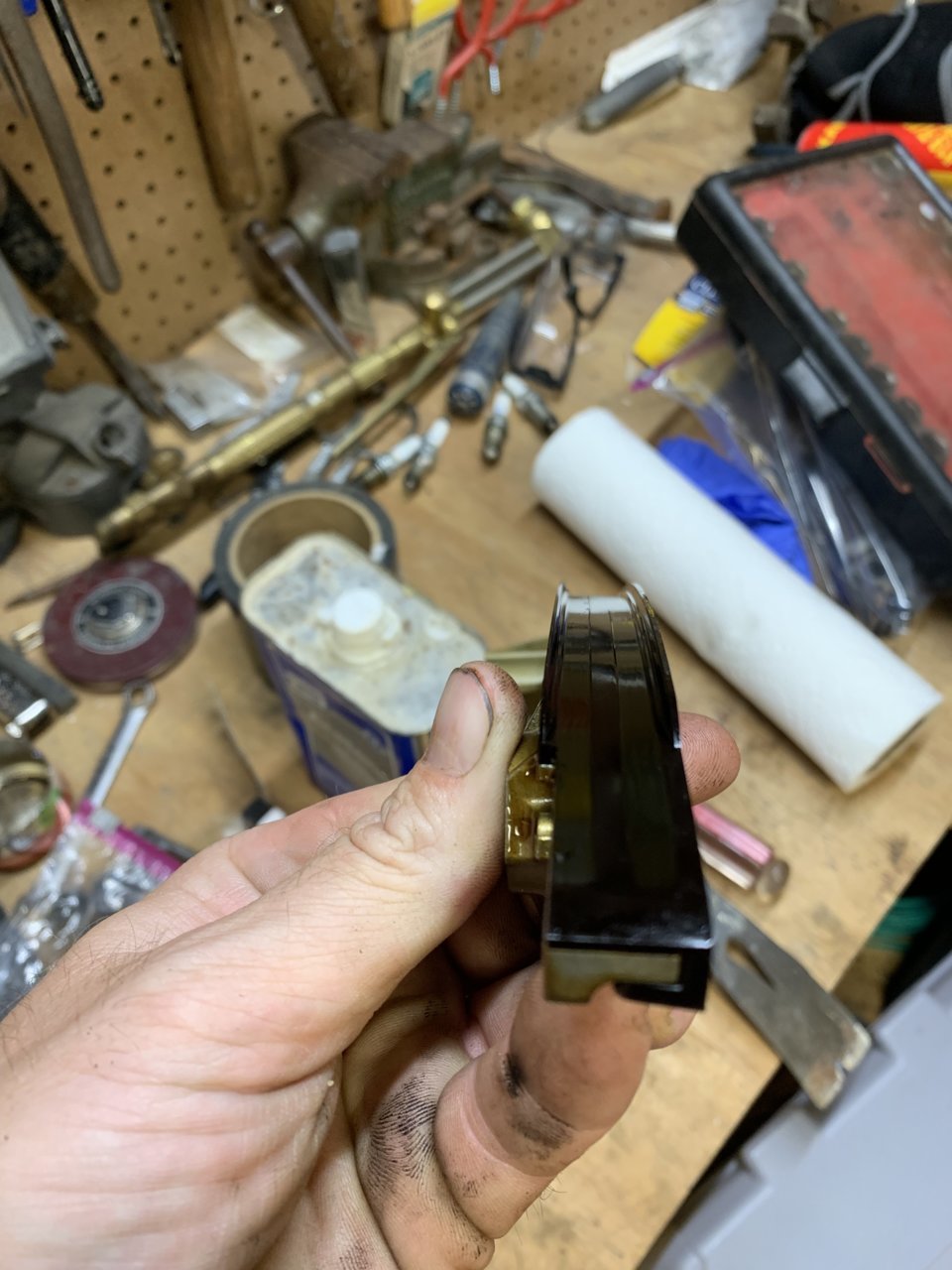

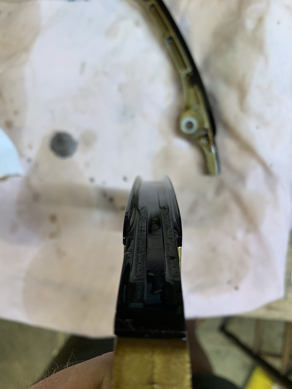

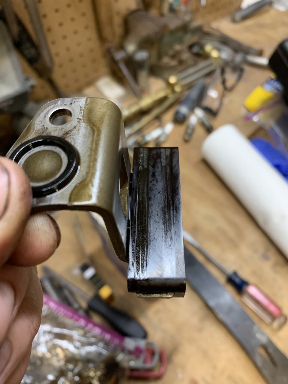

    So here are some pictures of my timing chain guides/tensioner. I think they look pretty good and am opting not to replace them.
    Maybe that is a little foolish but I can’t bring myself the break open the second timing chain assembly and replacing all the sprockets seems like a real pain.
    Let me know how you think these look.

    re. the timing chain. With the motor torn down as far as it is, it would be a mistake not to change the chain and tensioner. Much easier to do it now vs. having to rip it all apart later if the chain fails. Also, at 200k, there's no doubt the chain has streched.
    Just my 2 cents. Look forward to seeing it finished.

    07' TRD Off-Road, Auto
    STOCK
    I'd personally change the guides if I could afford it.
    The chain I wouldn't worry about as much.
    I don't know how the Toyota guides hold up.
    But the Ford guides I've had the pleasure of dealing with tended to
    break in pieces. Pieces of which ultimately ended up down in the oil pan.
