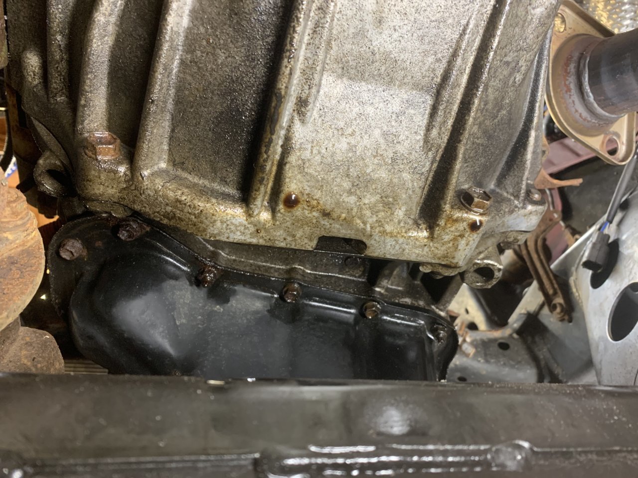

    Ok so here is a small update and of course as always a request for advice. I got the head back from the machine shop. I have not done anything with it as of yet.

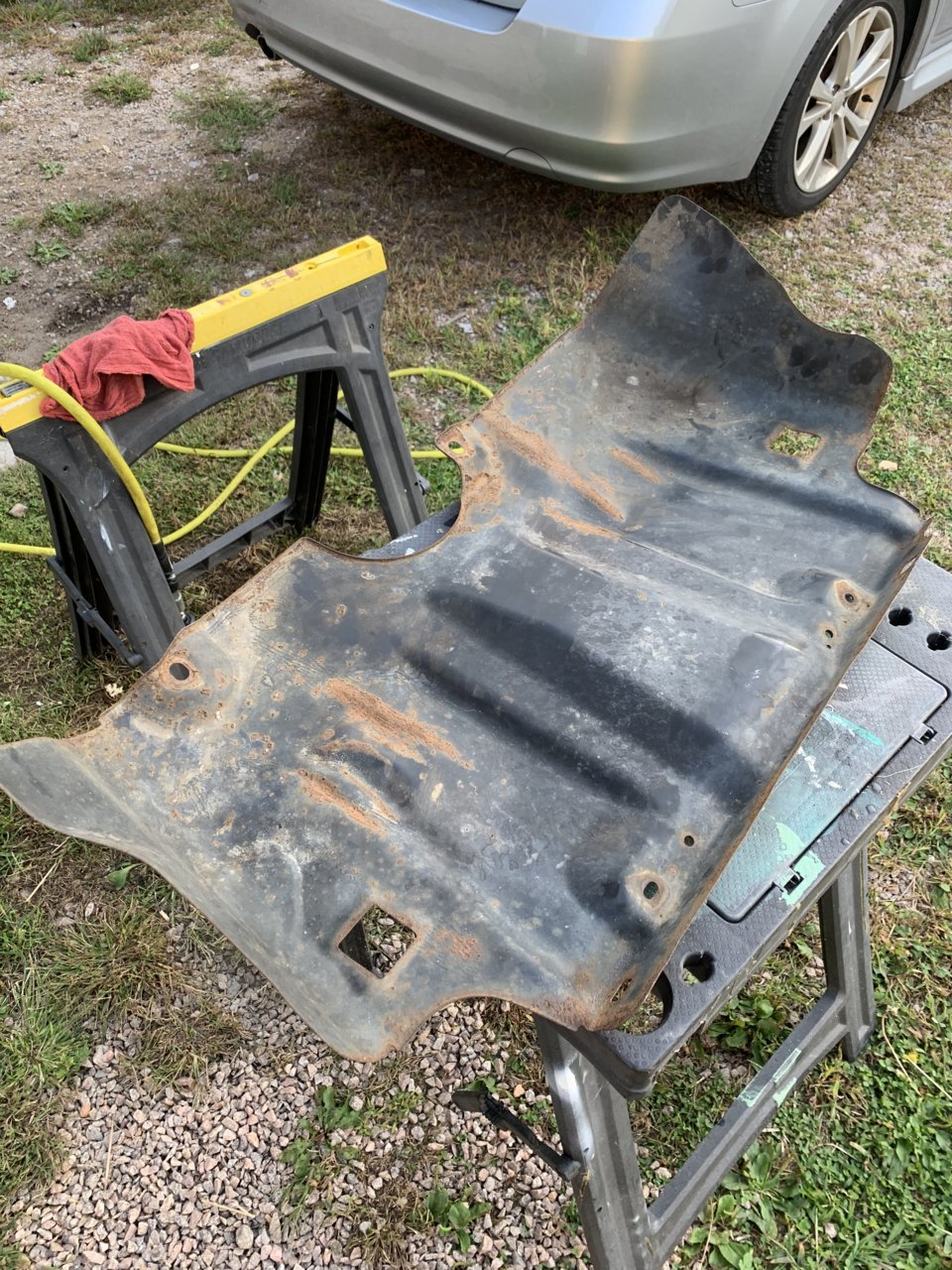

    I have been starting on my campaign against rust focusing on the front end and engine compartment while I have extra room up there with everything taken apart. So far I am still working on needle scaling and wire wheeling everything rusty and degreasing with engine degreaser and brake cleaner. Trying to get everything prepped as well as possible before putting on the POR-15.

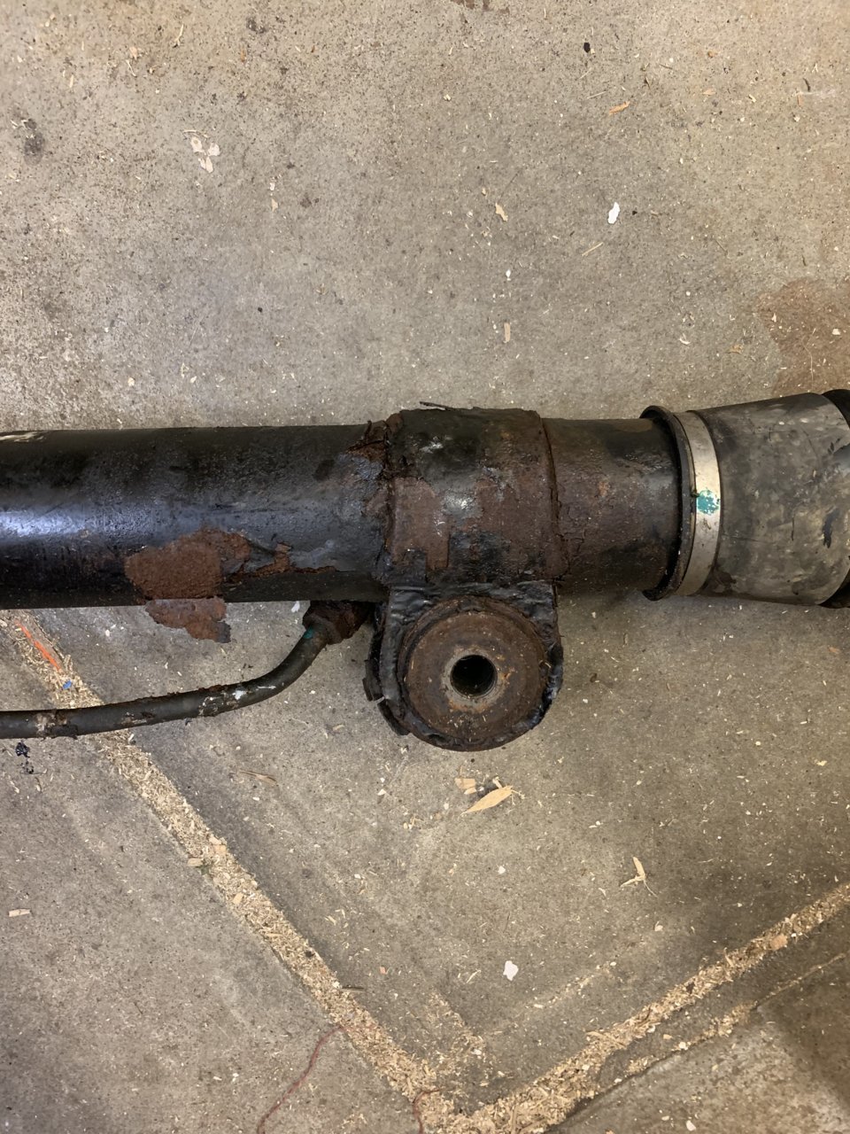

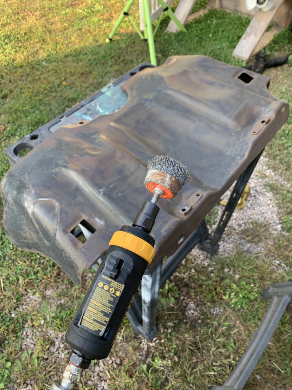

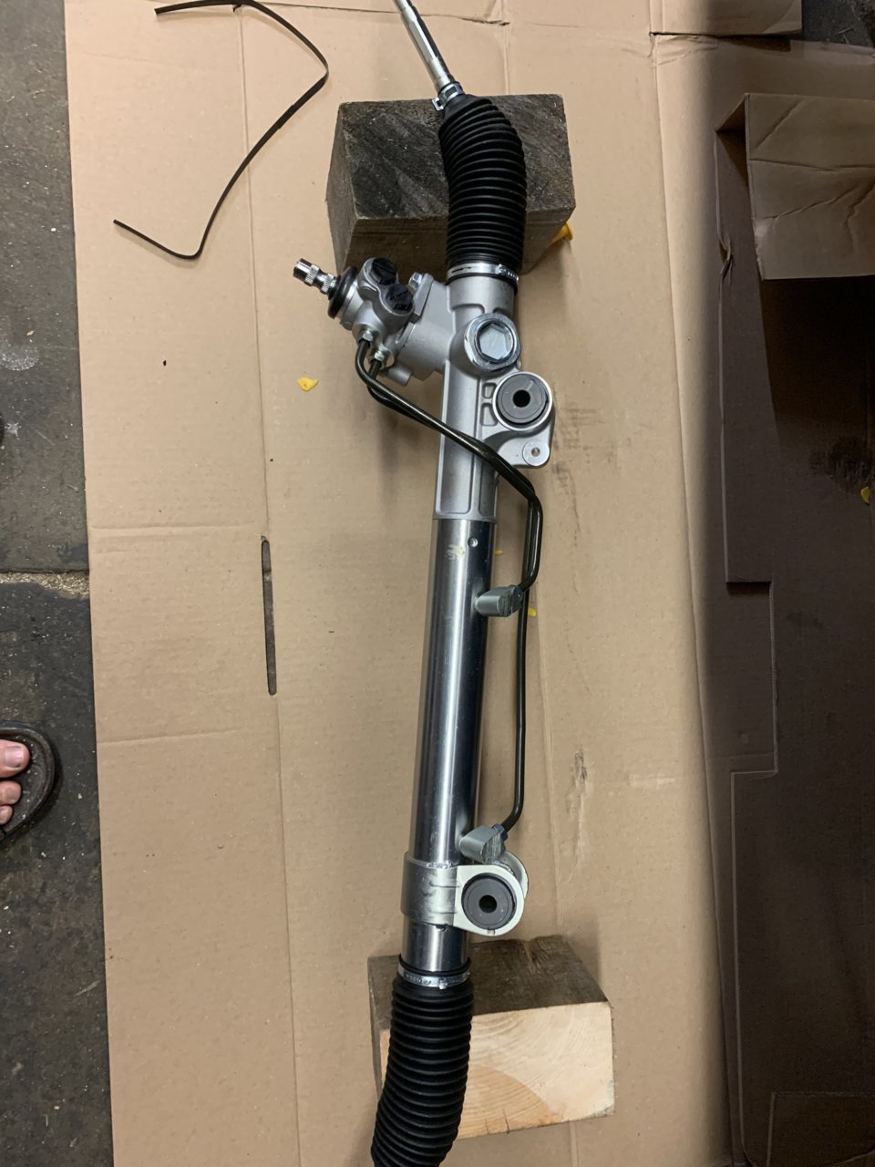

    I did prep and paint the skid plates, sway bar, and steering rack. The steering rack was looking pretty beat and likely to fail. The replacement that came in was not painted at all. I figured it was best to just paint it before installation. Before picture below. No after pictures yet.
    I made the mistake of buying the high gloss POR-15 instead of semi-gloss. I wish they had a flat black product. I think they have a flat black top coat but from all the reviews I have read it is not resistant to oil or fuel. If anyone has a suggestion for something I could overcoat the POR-15 with that would be cool, at least for visible areas subjected to UV damage.B7DD5078-5162-4A37-8322-3F280D5F5019.jpgD335D613-2DB0-4285-8361-9D2BAEFE9AF7.jpg 0B4077D2-DB6A-4E6F-AD48-BDAC789F157E.jpg8C6F6EFF-14DC-4D12-B570-0E440B6153D9.jpg

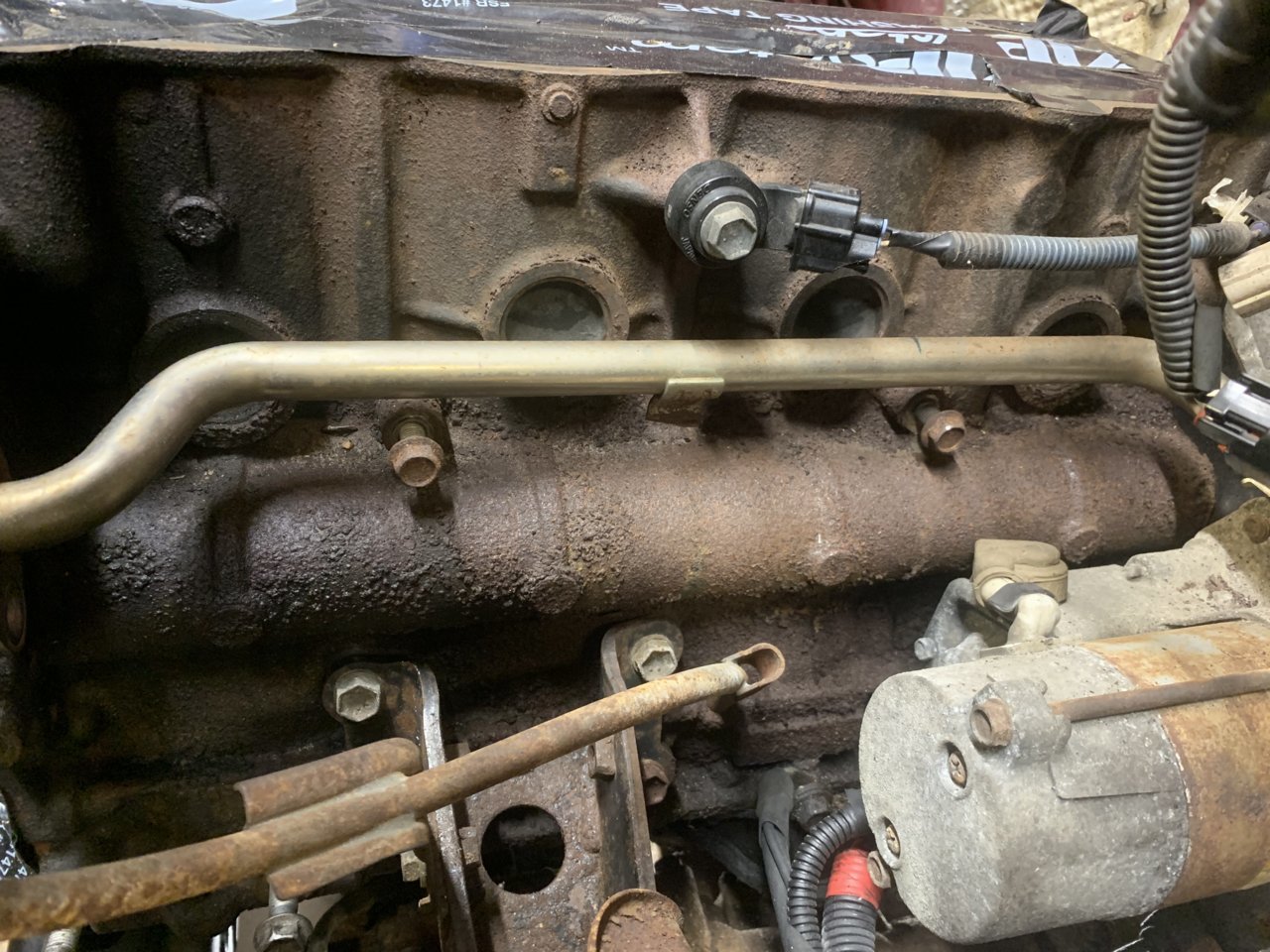

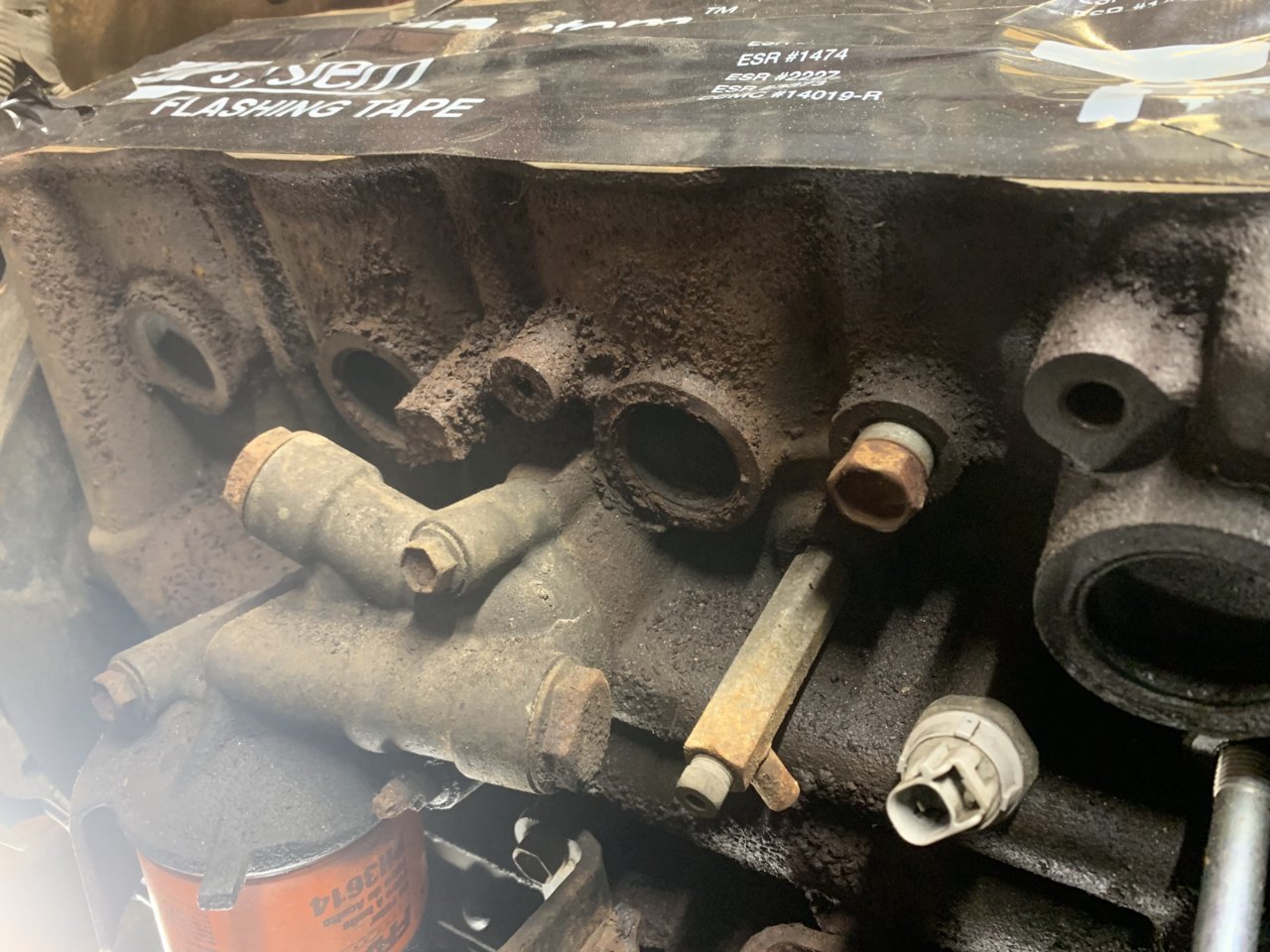

    So now I need some advice re: the rear main seal. See the below picture. Clearly I have a problem there.
    Can I pull the engine to do the RMS without dropping the transmission? Pulling the engine at this point seems like it would be relatively easy but if I have to drop the transmission maybe I will just wait until spring and tackle it then. I am experiencing significant “mission creep” on this project.
    Pulling the engine would have the added benefit of allowing me to paint the block which is in bad need of it... but at that point why don’t I just rebuild the lower end... see how this goes...324387A3-C17D-4E93-8398-754E5DB14E17.jpg

    How about Rust-Oleum Tractor paint, over the POR?

    It's probably easier to pull the trans than the engine, but I've never pulled an engine. Simply based on less hardware and electrical connector concerns.
    Either get help, or a trans jack. Definitely remove the t-case to lighten the load. I learned these things when I did my clutch.
    Once the trans is out, and flywheel removed, the RMS is staring you right in the face. Again, at this point, doing a clutch/flywheel job only makes sense. And I see that your block could definitely use some aesthetic lovins!
    Your options:
    1) Pull the engine completely which could be more time consuming but allows the block to be painted. Replace the main seal. Sit in the engine bay to replace the TOB and have a possibly harder time lining up the "stubby" engine to the trans. For me, it was easy to line the transmission up to the engine. Really wish I would've just taken the damn t-case off, too!
    2) Don't pull the engine, don't paint the engine, replace the main seal and clutch job. Under the truck.

    I pulled a 5spd MT last summer and it's not that bad- I posted some tips about it if you search. Leave the transfer case on as this greatly helps balance the transmission if you're using a floor jack. Also, if you pull the transfer case without having the transmission vertical, this greatly increases chances that you'll damage the seal. If you are going to pull the engine, and do a clutch, then you can pull the engine and transmission as one unit. I haven't done this in a Tacoma, but have done this in multiple vehicles. Mission creep indeed.
    On the transmission fluid in the radiator, a friend told me a story recently about him accidentally putting used ATF in during an oil change. It was in a Mobil 1 five quart jug, and...

    Pull the trans, itll be easier imo to get to the rear seal. I've gotten to where i can have the trans out of my truck in about 45 minutes. Granted mine is 2wd, but mostly everything is the same minus the extra driveshaft and transfer case. I used a harbor freight trans jack, and it was a life saver.

    Uh....idk what kinda floor jack you used, but a normal floor jack with about a 4-6" round plate didn't balance shit with the t-case on the trans, I made it work though. Took one person on the jack moving it while another was balancing the transmission. The whole process isn't that bad, yes. But a trans jack and removing the t-case will be what I do next time.
    I learned, after the fact, that removing the t-case wouldn't require more than a new gasket anyway.
    Pulling the engine and trans as one, would very likely require a lot to be removed from in front of the engine. It doesn't sound like he has a vehicle lift either, and that assembly would be pretty long to make that pivot in/out.

    Normal floor jack at the transmission mount location. Made a 2x4 adapter for the jack with a hole for the mount. With the transfer case in place the transmission is almost balanced. The front is slightly heavy, maybe 20 lbs, but it's very easy to manage with one hand.
    Toyota tells you to leave the transfer attached and then put the transmission vertical on the bellhousing and then remove it so as to not damage the seal. I thought about removing the xfer case first but was glad I didn't.

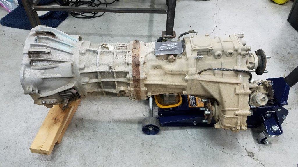

    Yeah I definitely don't have a vehicle lift or a transmission jack. I am going to ignore the ugliness of the block for now and just tackle the RMS in the spring. I need to get back on the road. I will be happy just to have the new header and all the rust treatment stuff performed. Not sure what type of performance changes I should expect from having the valves resurfaced.
    In comparison to this thread I feel like I am basically slapping the thing back together but it is what it is. I am borrowing a vehicle at the moment and I am renovating my house at the same time. I will post some pictures of my house project so you can see what else I am up to. I really know how to make work for myself.

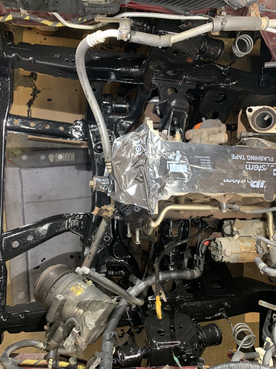

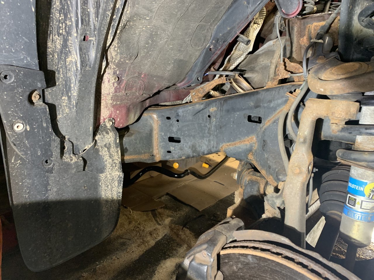

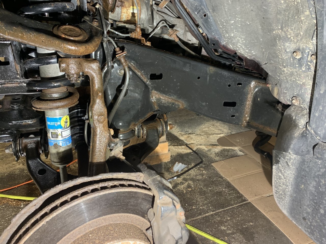

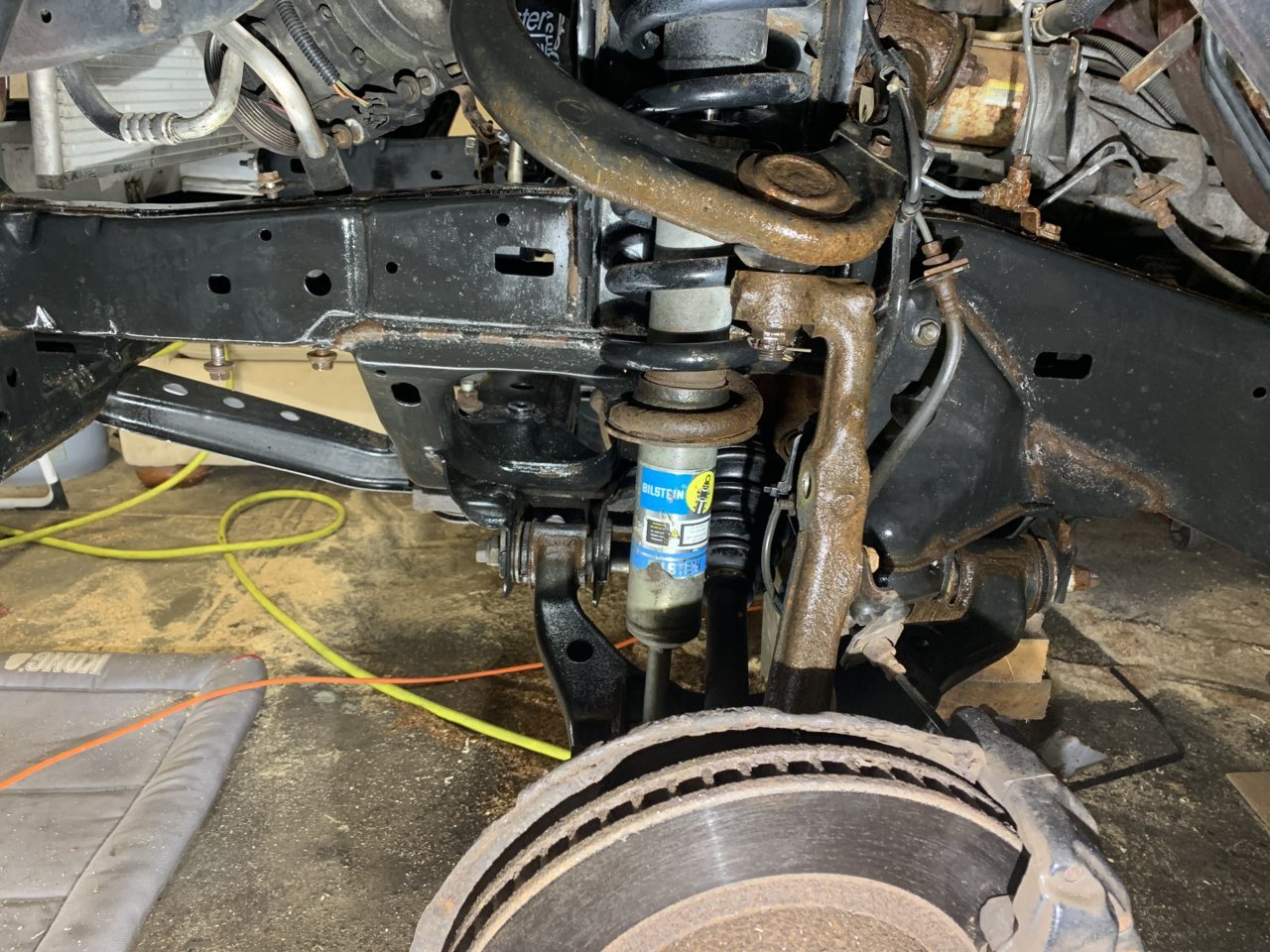

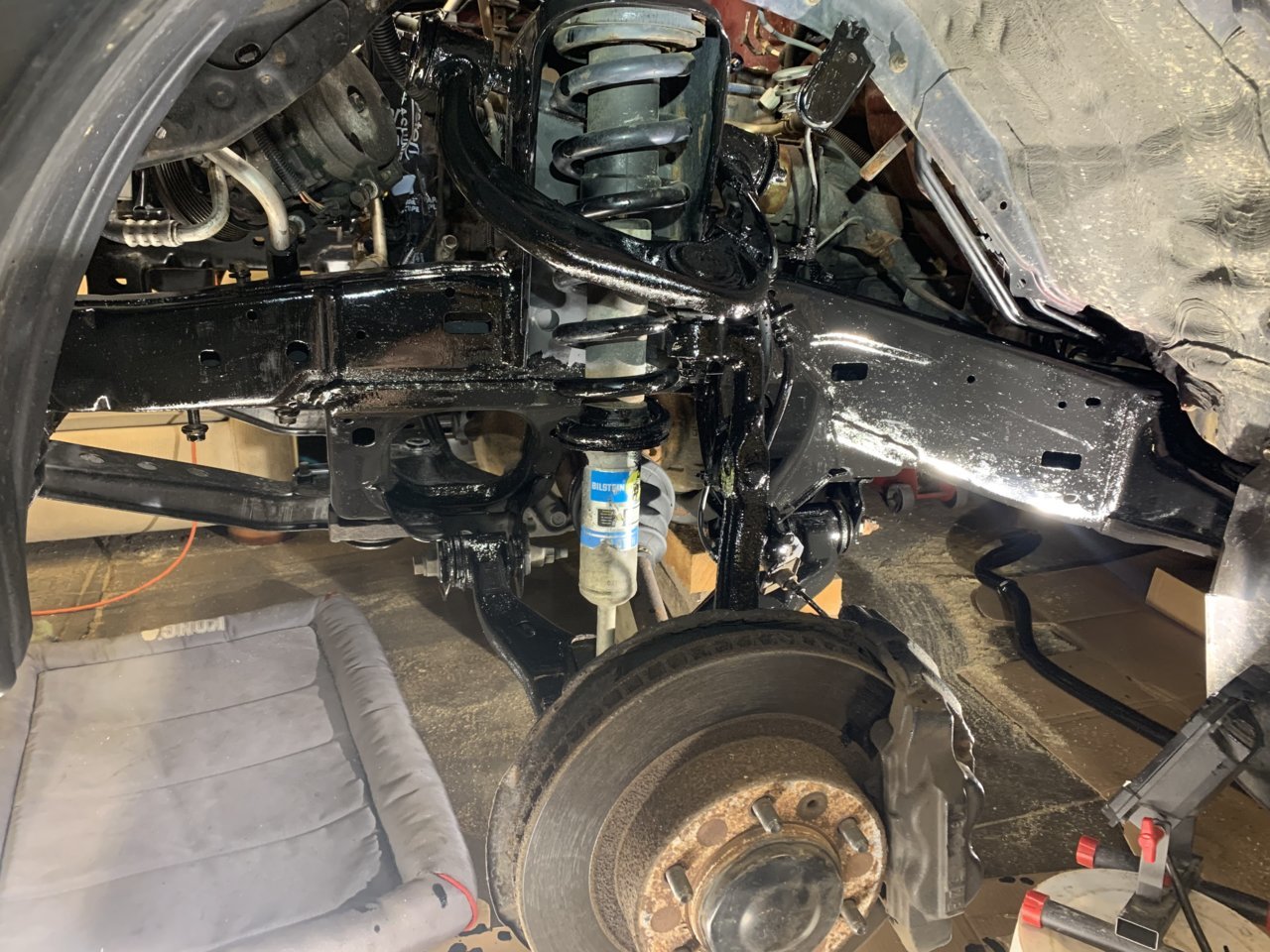

    Frame restoration update. Using approximately 2/3 of a quart of POR-15 I painted the frame, crossmembers, engine mounts, control arms, etc in the engine compartment and the front wheel wells. It looks a lot better. Hopefully it lasts.
    Before applying the POR-15 I needle scaled and wire wheeled all the loose rust off. I then degreased with brake cleaner and engine degreaser. Then I applied the POR-15 metal prep, let it sit overnight, and wiped it clean. The directions said to wash it all off with water but I don’t really have that luxury with the car in my garage the way it is. I think this will work fine. We will see.
    Before and after picture below. Getting closer to engine reassembly. A8E6B5FA-2C84-422D-A8E8-F61AB40C998A.jpgC30ABC0B-C6F4-4C39-A172-1942F60B5714.jpg E7CF706D-EFF5-42F6-A7FE-071628C79056.jpgE508D8D9-594F-42E7-99F8-3CC9228FCF04.jpg AF452EB9-1742-4608-8276-4F280E1B921D.jpg3657D810-7622-4FC6-840A-522D2FA7AFA2.jpg A6763590-EADE-4AB1-8B41-48240FD81130.jpg246E14AA-594B-42AC-A40A-90D0E1658157.jpg

    Turned out great from my screen. :thumbsup:
    Now for the rest of the truck, and somehow inside the frame..... ;)
