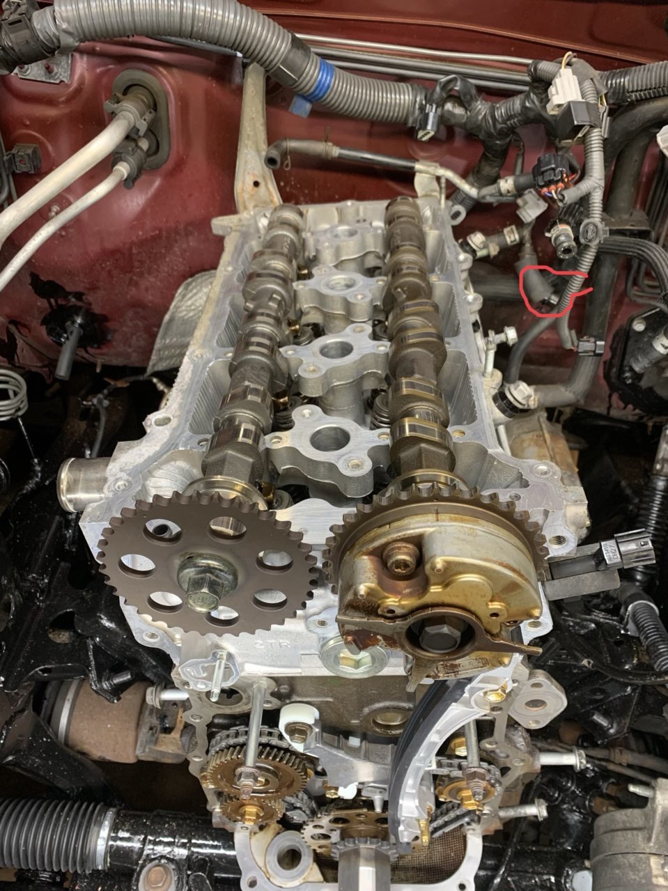

    Hey! I got it! It’s running now! Ran it for about an hour tonight. Running smooth and quiet. Changed the oil. Putting everything back together. I will have it out of the garage this weekend.
    What happened was I somehow missed connecting this vacuum line circled below. It was hidden behind the intake(that’s my excuse).
    I also somehow put a pin hole in the radiator. Probably while it was kicking around my garage the last two months. I have one on order. Other than that this project is almost done.

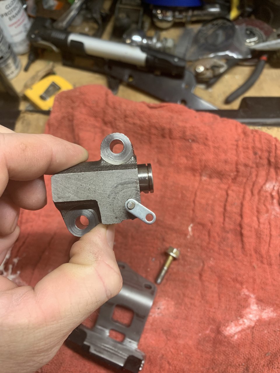

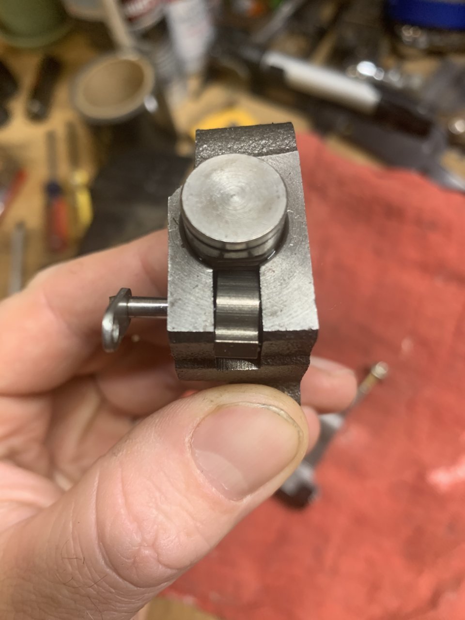

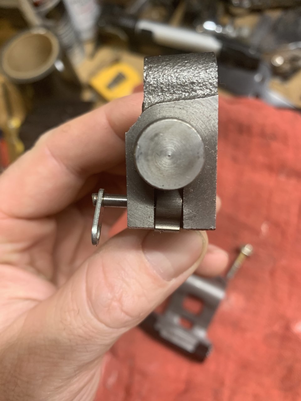

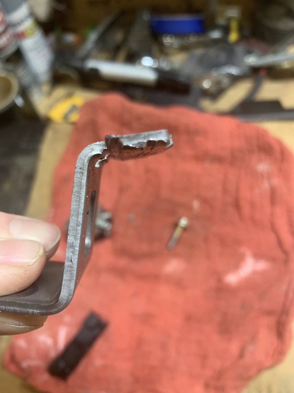

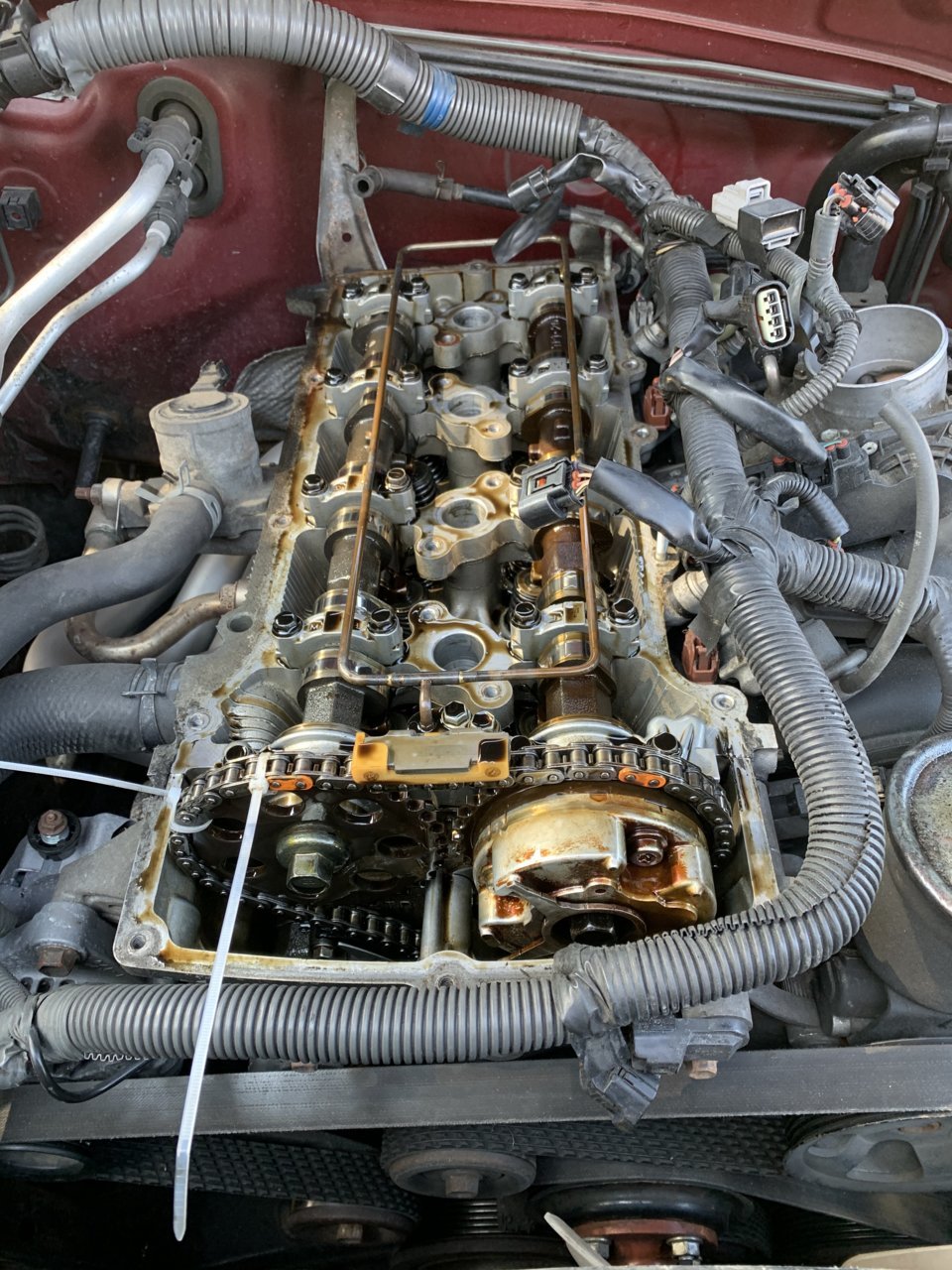

    Ok another update. Since doing the HG job I’ve had a couple snags.
    First the water pump failed. NBD. I was briefly scared something major was going on under the timing cover until I figured out where the metal/metal squealing was actually coming from. Replaced the leaky radiator at the same time.
    The second issue was pretty bad. What seems to have happened is the brand new chain tensioner for the large timing chain failed which allowed the chain to slack up big time. This then caused the upper guide between the cams to get thrashed which is how I realized something BAD was happening. Luckily I think I caught it before any real damage occurred. The chain didn’t skip teeth or anything.
    I’m now going to fight with rockauto for my money back. They won’t be able to reimburse me for the additional 12-15 hours of work they caused me. I basically had to take the whole front of the engine apart again. Seems to be running fine now though :/

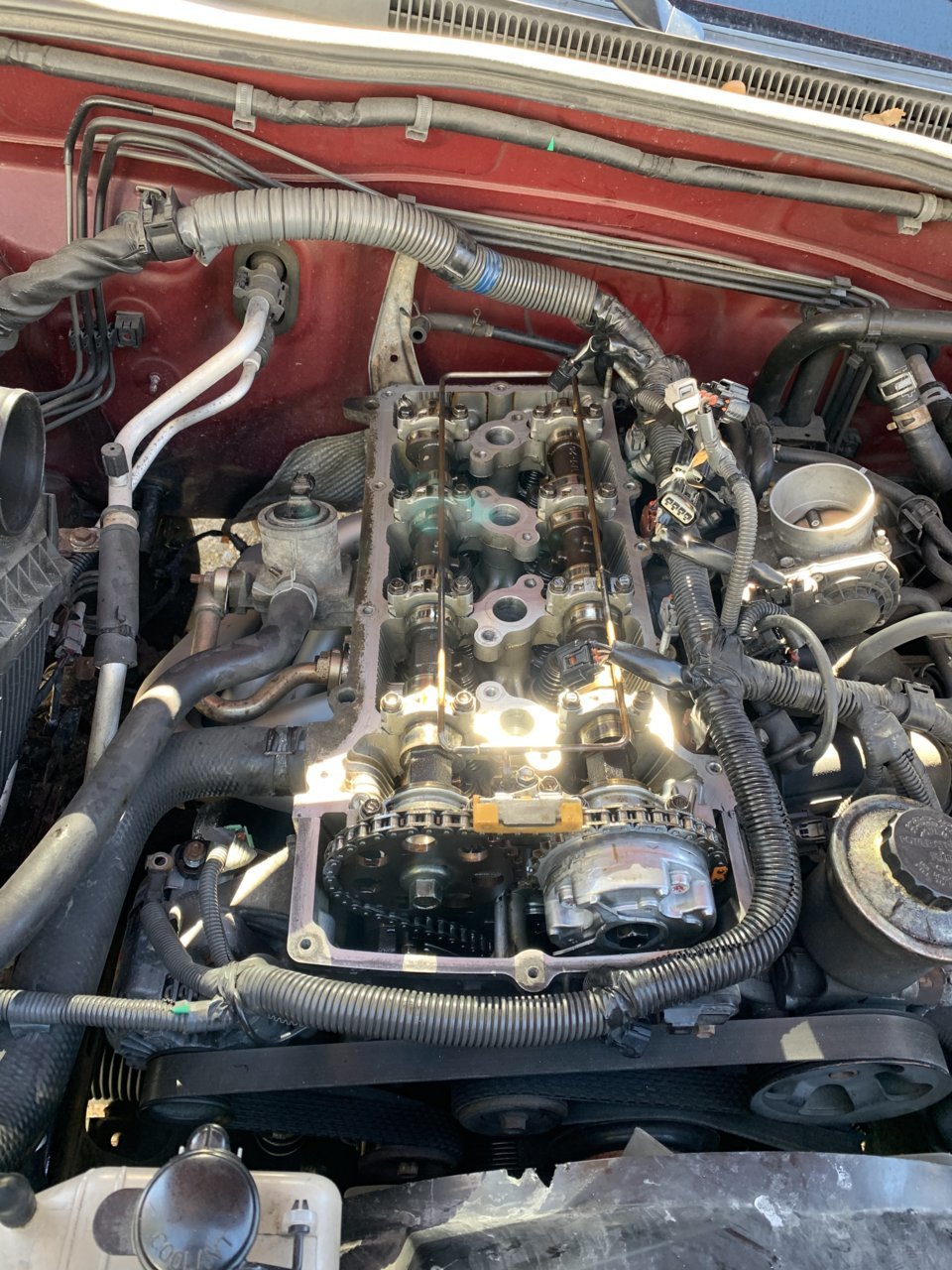

    I hope everyone is enjoying the new year!! 2020 man...
    Does anyone have an updated link for this shop manual?
    I think I need to replace the cam phaser. I already ordered and OEM part from eBay for $95 new. The dealer wanted $400.
    The engine has a significant rattle/tap intermittently on cold startup. It goes away after a couple seconds of running. I had an engine specialist down the road take the valve cover off and look around. He said the phaser is loose or has play which it shouldn’t. So here I am. It shouldn’t be too bad of a job compared to the whole head-gasket from last year.

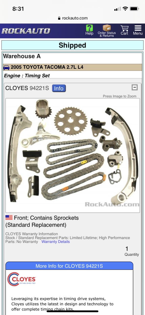

    Sorry for the late reply. For everyone’s information this was the timing chain kit I bought. I have no complaints about any of the other components so far but the large timing chain tensioner did fail which caused me to have to redo a bunch of work.

    I was able to replace the cam phaser this weekend with little issue. It took about 6 hours. Fingers crossed I don’t have to get back inside this engine any time soon.
