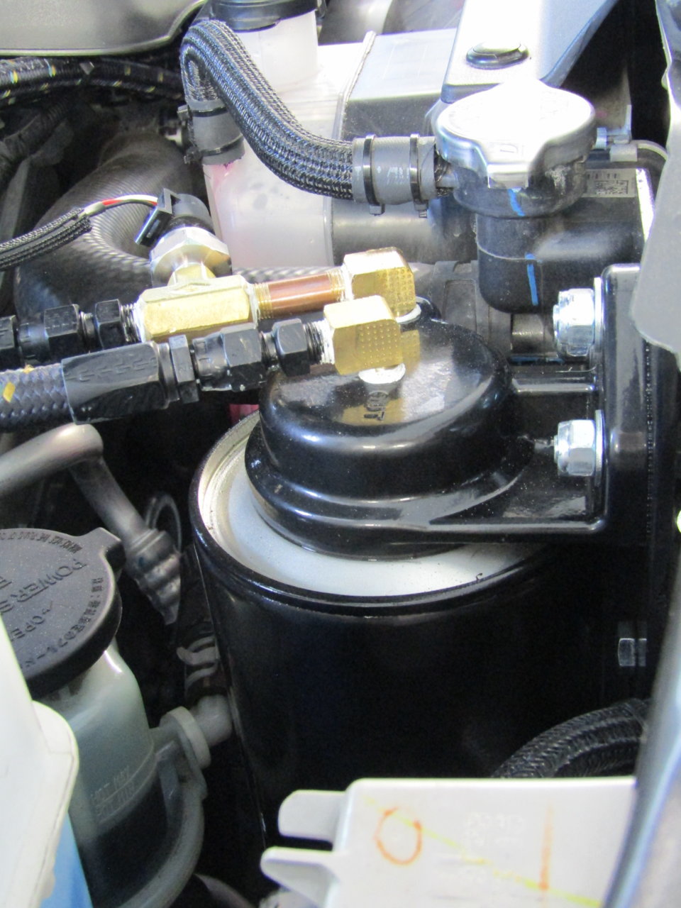

    Actually testing oil is used in many places, here in the US, many big truck fleets for one...its very common in facility operations, utility plants, Waste treatment plants, etc..I spent 40+ years in Facilities and we had hundreds of pumps, compressors etc....testing oil to schedule change out when needed based on data can yield a considerable savings in oil/filters etc.... we ran a large program for many years....I follow the same principle on my truck...
  10. Jun 12, 2019 at 4:26 PM
    #30
    wmg
    wmg Well-Known Member
    Jan 20, 2017
    #208119
    1,012
    bill
    2009 FJ
    BP-51 OEM LIFT..33;s...full skids....dual Batteries
    and depending on filters much smaller filtering..I run a single by pass which is good to 2 micron rather then the 20 or so the oem does.....
