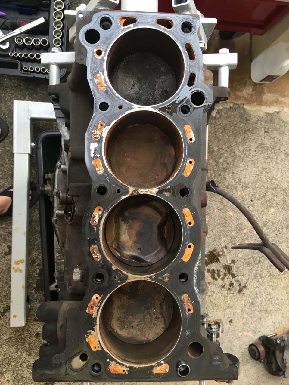

    05Taco4x4
    05Taco4x4 ToyotaHubs
    Jun 29, 2011
    #59085
    6,222
    2TR-FE Enthusiast
    FJ Tcase, Manual Hubs, 2017 Head unit, Mirror Riser
    Engine that I rebuilt for my turbo build, bought off Craigslist with blow gasket. Look familiar?
    This engine could also benefit from a catch can, intake side of head thick with oil.
