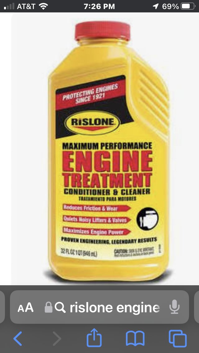

    162k using only 0-20. Never 5-30 conventional. A5D1C289-C226-4F21-A0CF-B5649F0F193B.jpg Fingers crossed. I’d run a 5 minute flush and let it drain overnight. Refill with this Rislone shit and 0-20 then change the filter again in a week or two
