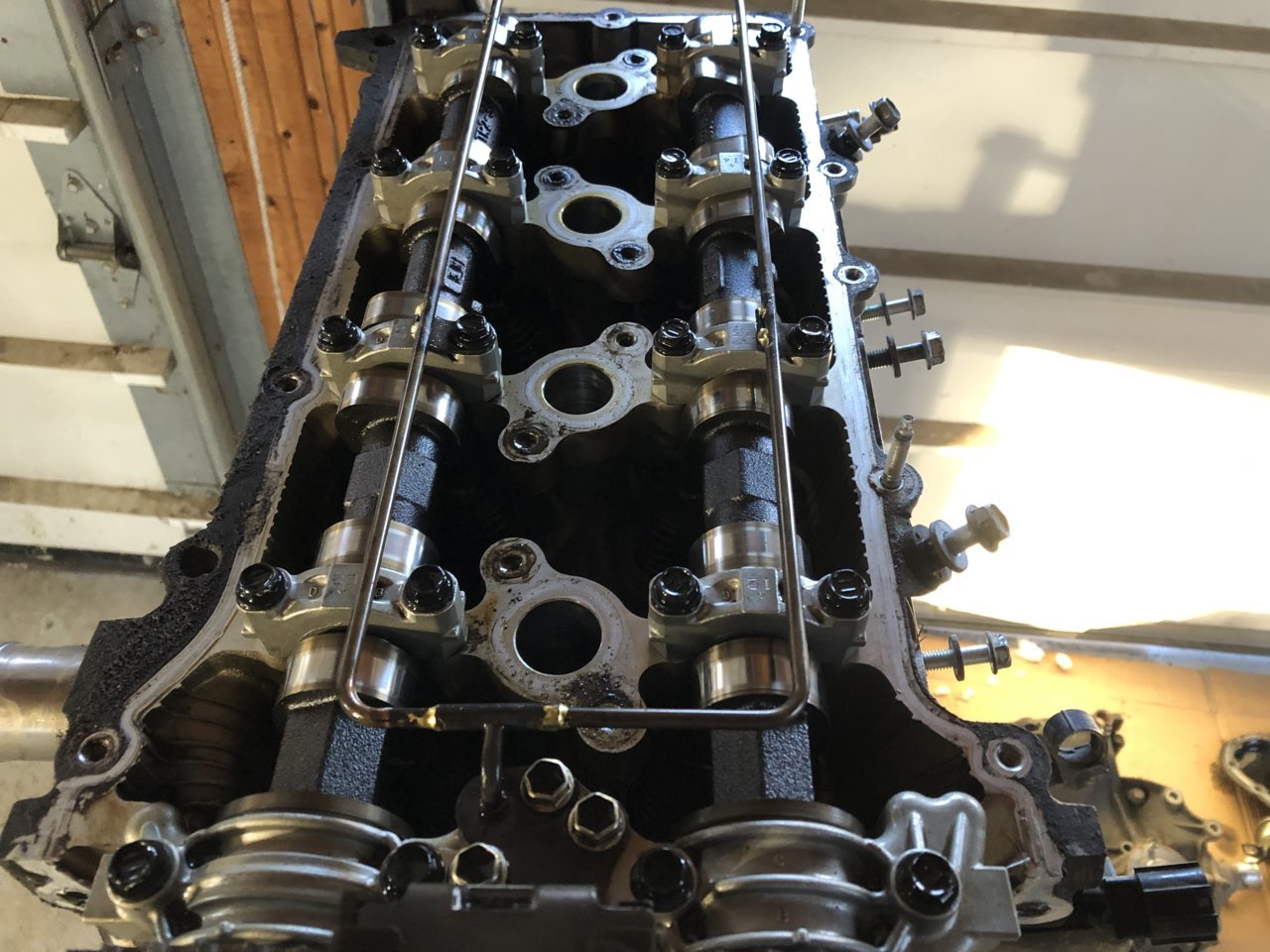

    This is the only pic I'm finding at the moment from the one I tore down. 0AA03350-370F-45A3-B4BF-4A4DD0CB8561.jpg

    I was kinda figuring it would have some sludge under the valve cover but for 185k miles it looks like it’s clean and well cared for
