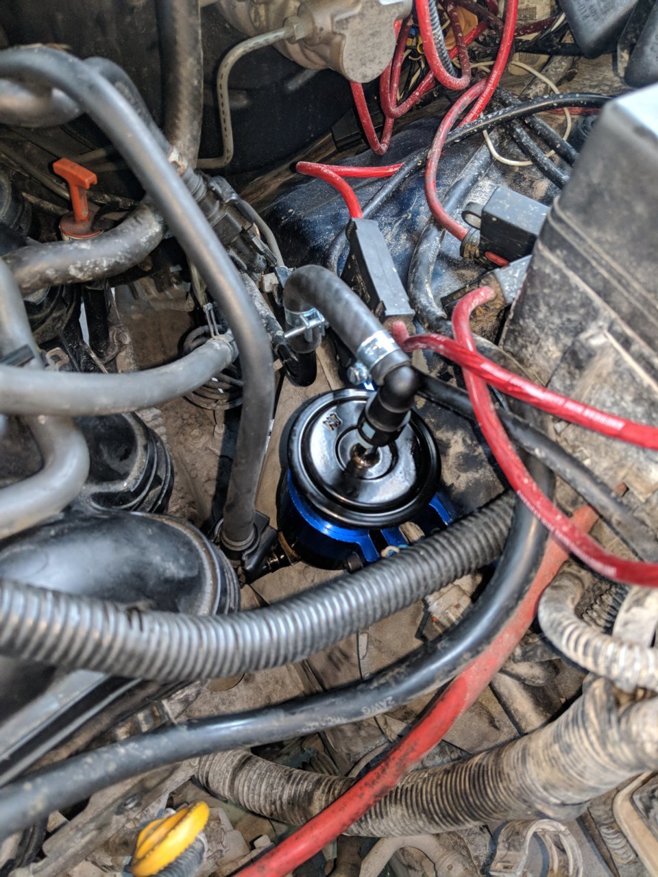

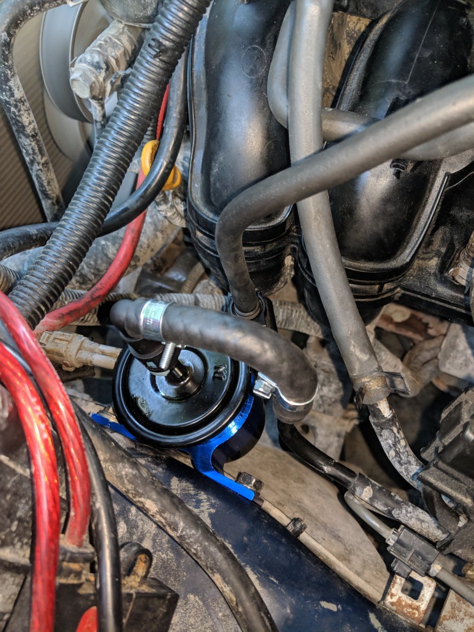

    It's not the fuel stations at fault. The supposed lifetime filter is a strainer. It is a sham in my opinion. I pulled apart my old factory pump and nothing within it other than the motor and pump assembly. You never put a fine micron rated filter before the pump. It will create too much strain on the pump or prevent it from sucking fuel to begin with. 100 micron strainer is the minimum filtration on the suction side of the pump.
    Also the pump strainer and pump assembly can be purchased from Denso for about 120 dollars. The entire sending unit from Toyota is easily 4 times that.

    Well done. Be cautious and monitor fuel trims. The OEM pump I had was beginning to struggle with the added load pushing through the filter. Had a lean knock a few times but the trims told the entire story. I've got another in tank module I will eventually add another fuel pump externally mounted to make pump changes easier. Seems the factory unit doesn't have the flow capable to sustain the fuel rail when running hard. ECM automatically defaults to a 12.0:1 AFR at WOT. When that happens the catalytic converter temps climb to near 1700 degrees.

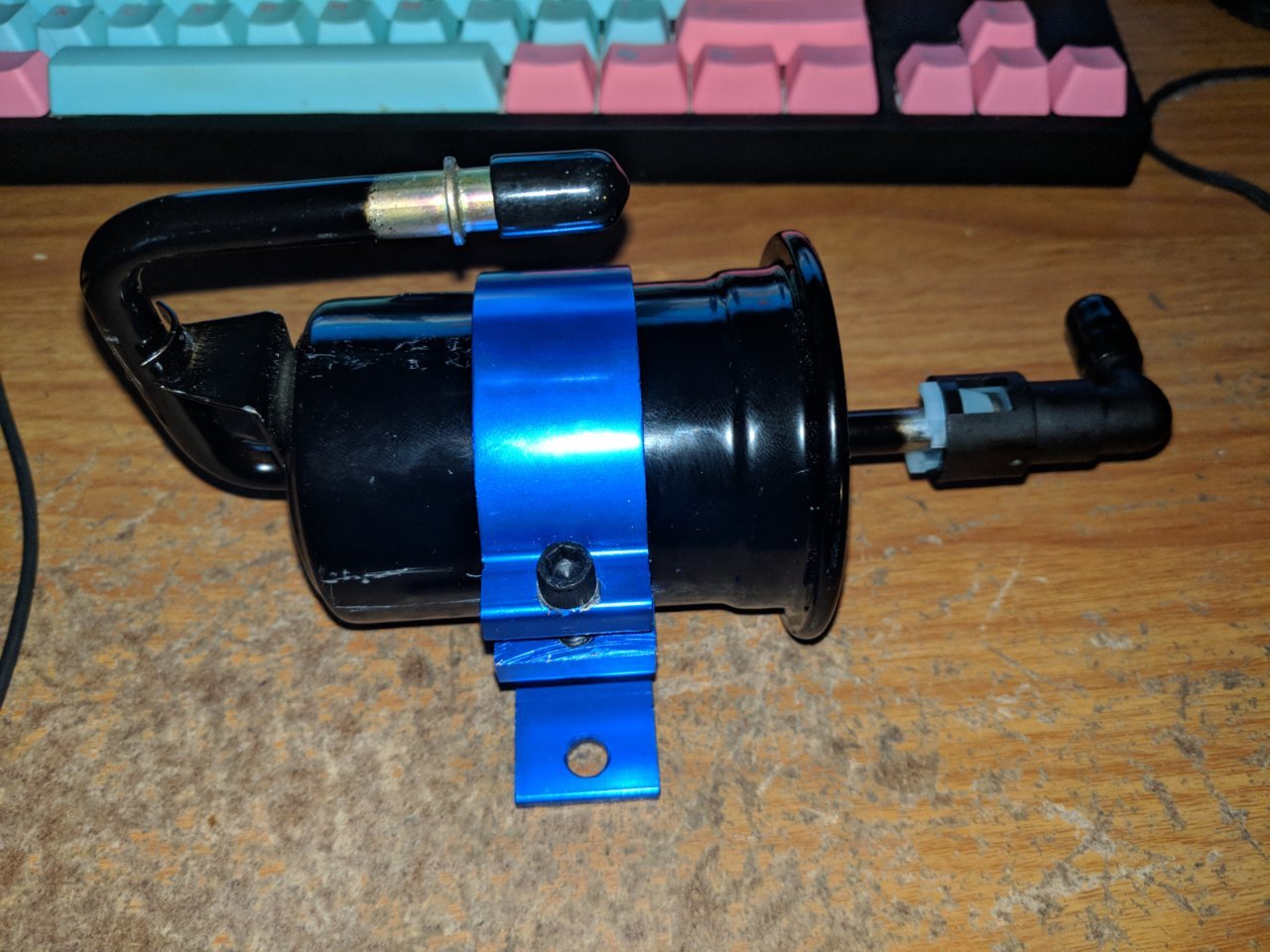

    I've got another iteration in the works, pics to come in coming days/weeks.
    I'm upgrading the pump and adding a flex fuel sensor for my turbo build, so decided to add a filter while I was at it.
