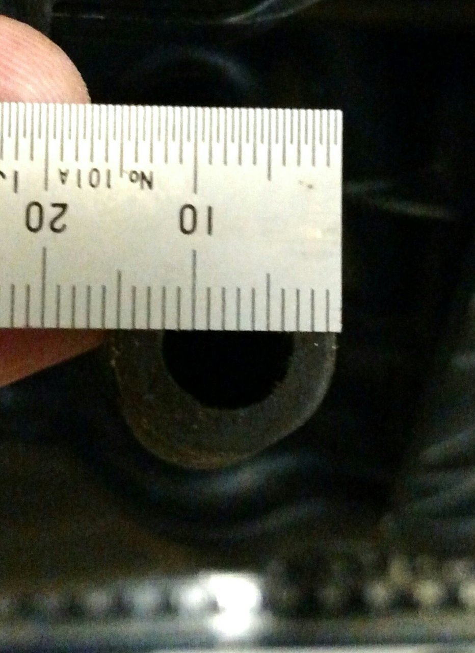

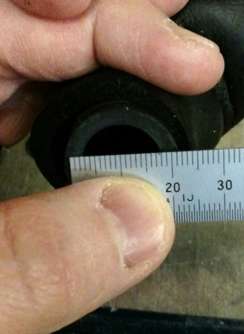

    Here are pictures of the diameters of the hoses that will need lengthened. If you can find the smaller one with a slight bend (see hose on end of intake manifold below), that would be ideal. 8" or so each should be good.

    Be careful when removing the fuel lines, those things are expensive if you break the plastic ends- ask me how I know :oops:
    You want to measure the inside diameter, outside not so important
    I'd suggest taking a caliper to the nipples, not trying to measure the hose

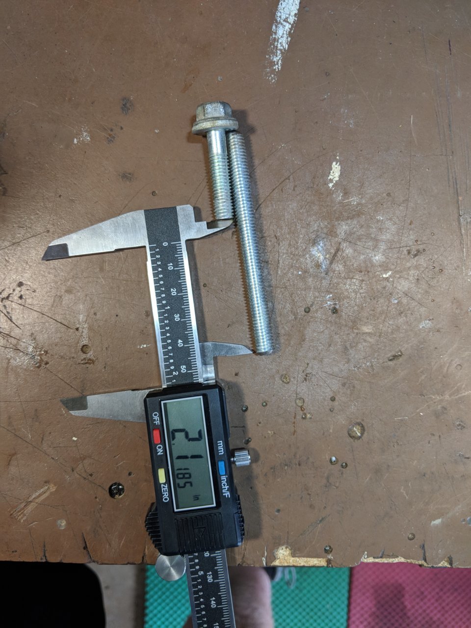

    The bolts provided are too short if you tighten them into place as per instructions.
    As you can see it's 2 in longer but doesn't compensate for the end nut.

    You might have to back them out a bit. I didn't factor in running them to the bottom of the hole, just 2" longer to compensate for the spacer.

    Ok, for the guys that have made purchases. Although I made everything exactly to what Tooter did (90mm stud and all), it looks like the the stud is not long enough to fully install to the bottom of the hole. If you've ever worked in machining, this is common practice. In the instructions I dont state to run the stud completely in, but I don't say not to either, so that is confusing. Not a huge deal, but it does prevent installing the stud completely. So, my suggestion is to loosely install the studs, using the double nut method (if you can't install by hand). After installing the spacer and manifold, adjust stud depth to no further than the outside of the bolt head (slightly inside the bolt if possible). This will give you very close to factory thread engagement before spacer install. If anyone has any questions or concerns, please feel free to contact me.

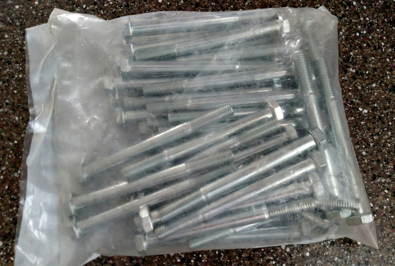

    Ok, we had some issues with the stud length on one of the first spacers sold. So, I have decided to change from the studs to zinc plated bolts for the hardware kit. So, any kit sold from here on will have (5) 90mm zinc plated bolts instead of the 90mm stud/bolt combo. You will still receive (2) studs for the lower supports, but will use the (5) bolts for the spacer mounting to prevent confusion. For the guys that have purchased the kit already, you can use the supplied studs/nuts, purchase new 90mm bolts (Lowe's has them available for a couple dollars), or I can send new bolts to you once I get them. Up to you. I do apologize for the confusion. Let me know if you have any questions. Thank you!

    Ok, new bolts have arrived! All kits will be outfitted with 90mm bolts, giving the exact thread engagement as the OEM bolts prior to the spacer install. Now all i need to do is find a use for 100+ 90mm studs and nuts...:confused:
