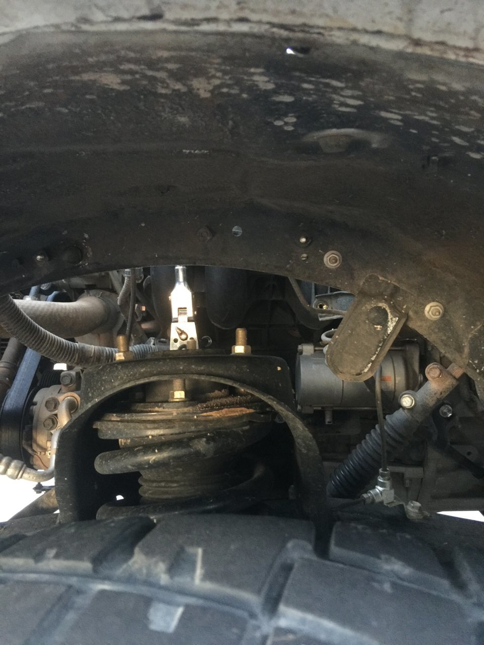

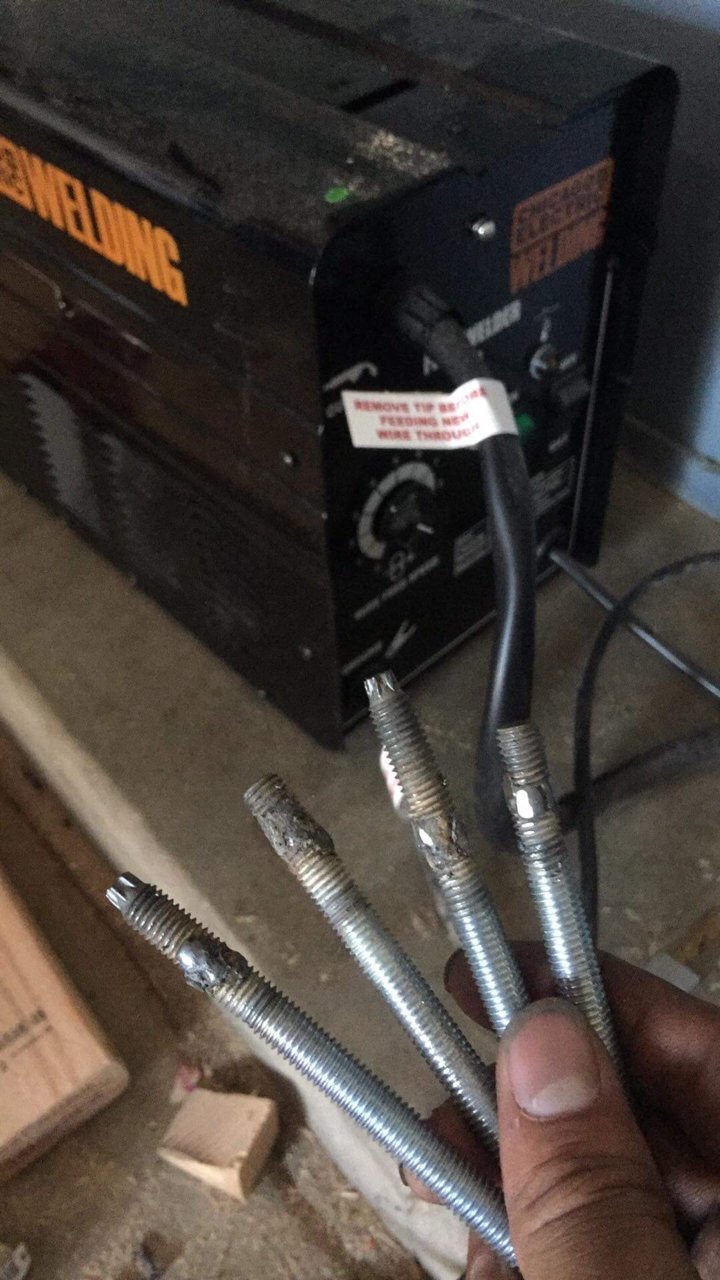

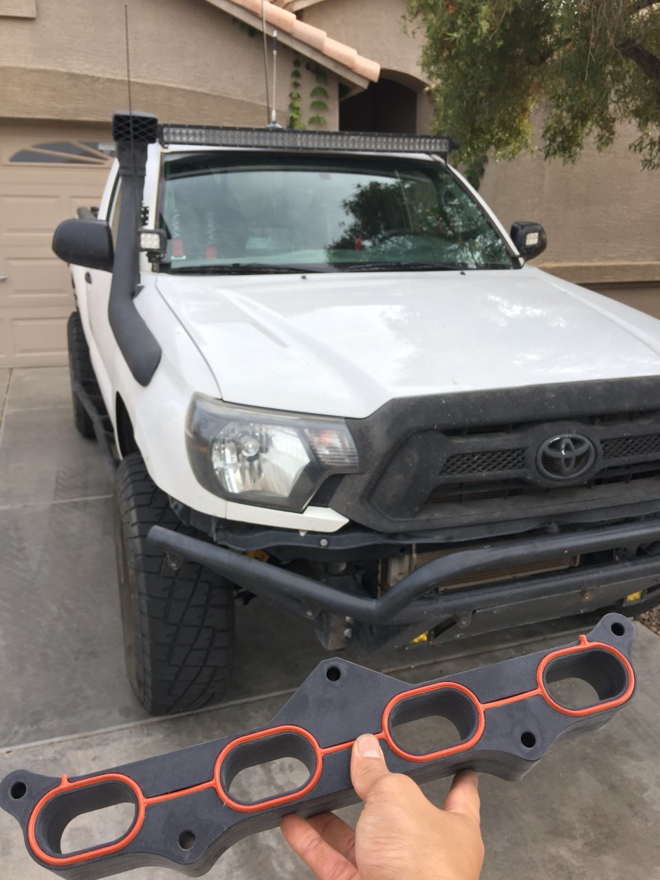

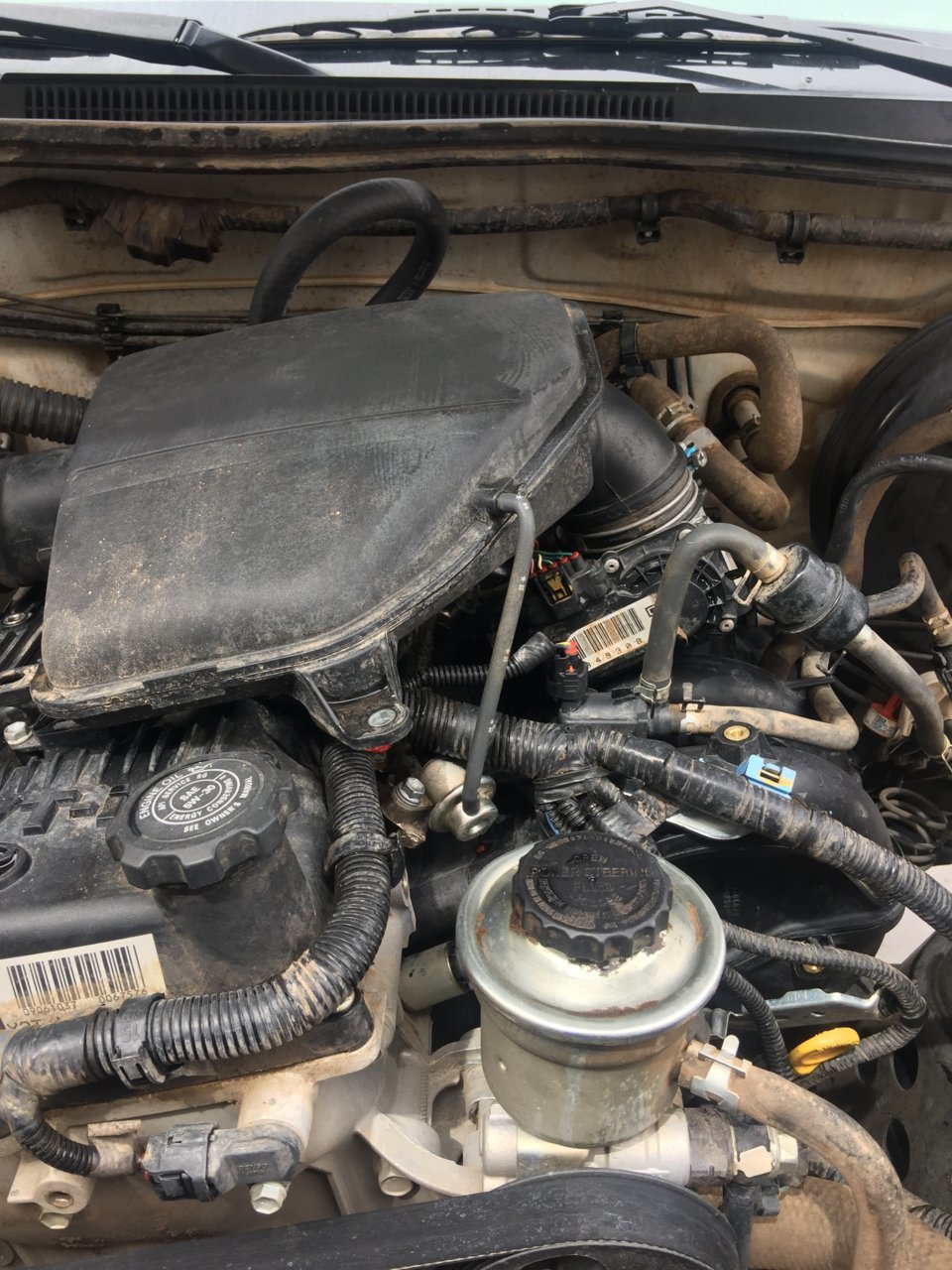

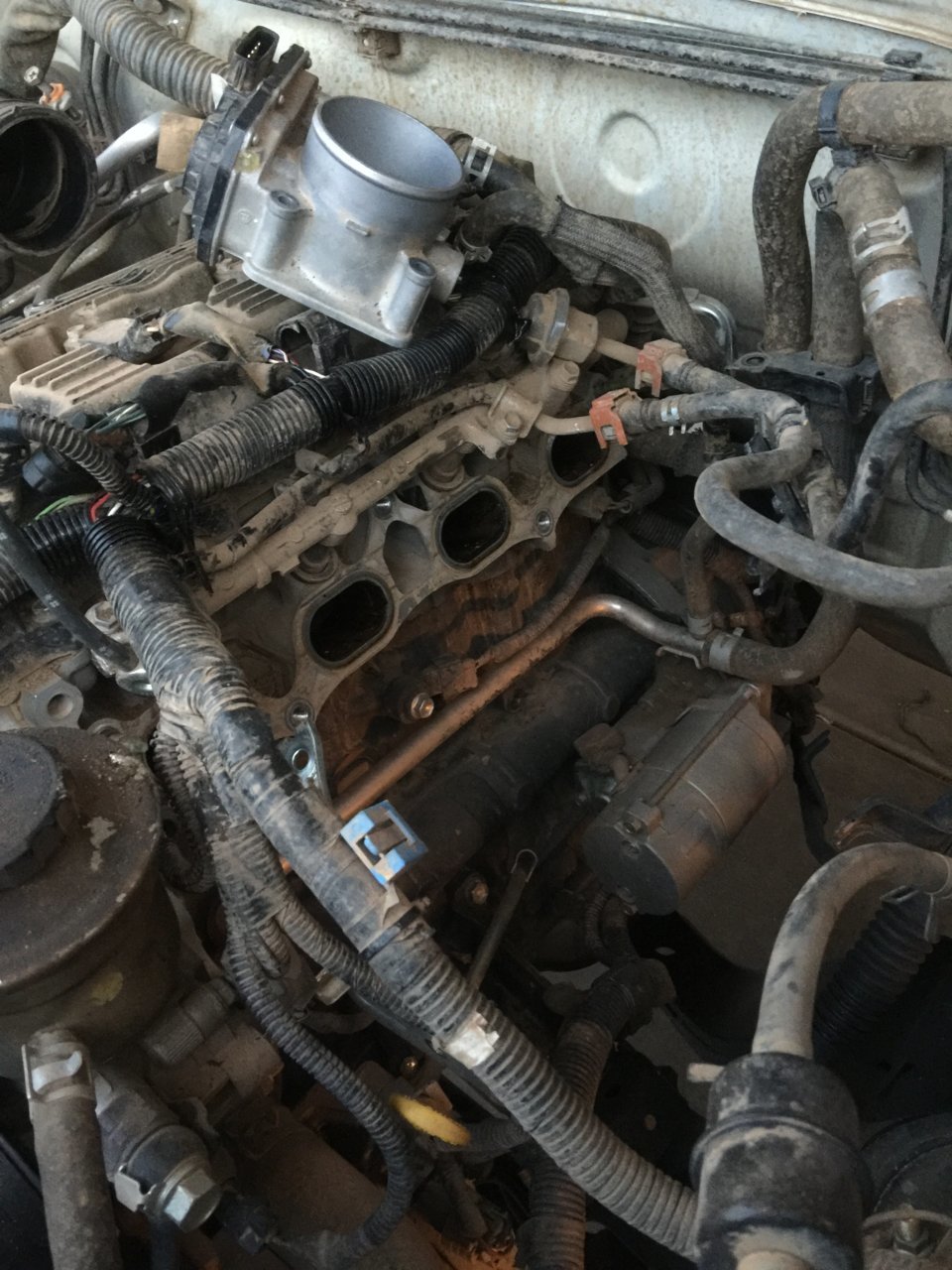

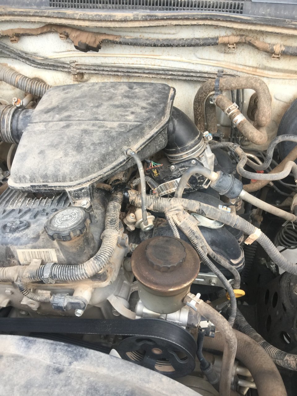

    Alright so I've had it installed for a day or 2 now. Just haven't had time to wash my engine bay so everyone can get a better look at it.
    AFTER
    BEFORE
    Quick things that you should know(Some have already been addressed)
    - Studs are too short. Seller fixed
    - Bottom 2 studs that are bolted under the Manifold will no longer line-up, instead it will be support studs holding it up.
    - Transmission Fluid Dipstick bracket will need to Bent/modified to bolt back on securely.
    - You will need new brackets for the Air Cover, if you want it to be secure again.
    I didn't really feel like waiting/buying new studs so I chopped off the ends of the old stud and welded them onto the new studs as an extension.
    Misc Pics
    I had an easier time getting to the 2 bottom Manifold bolts from the wheel well.
    Do I feel any change in Torque/Performance? I do feel it pull a little harder low end, but not much. Do bare in mind that I'm already geared at 4.56 so my Torque curve is already up there. Being that this design is based of Tooter's I'm pretty confident it made minor improvements. Don't expect it to push back into your seat whenever you step on it:burnrubber:
