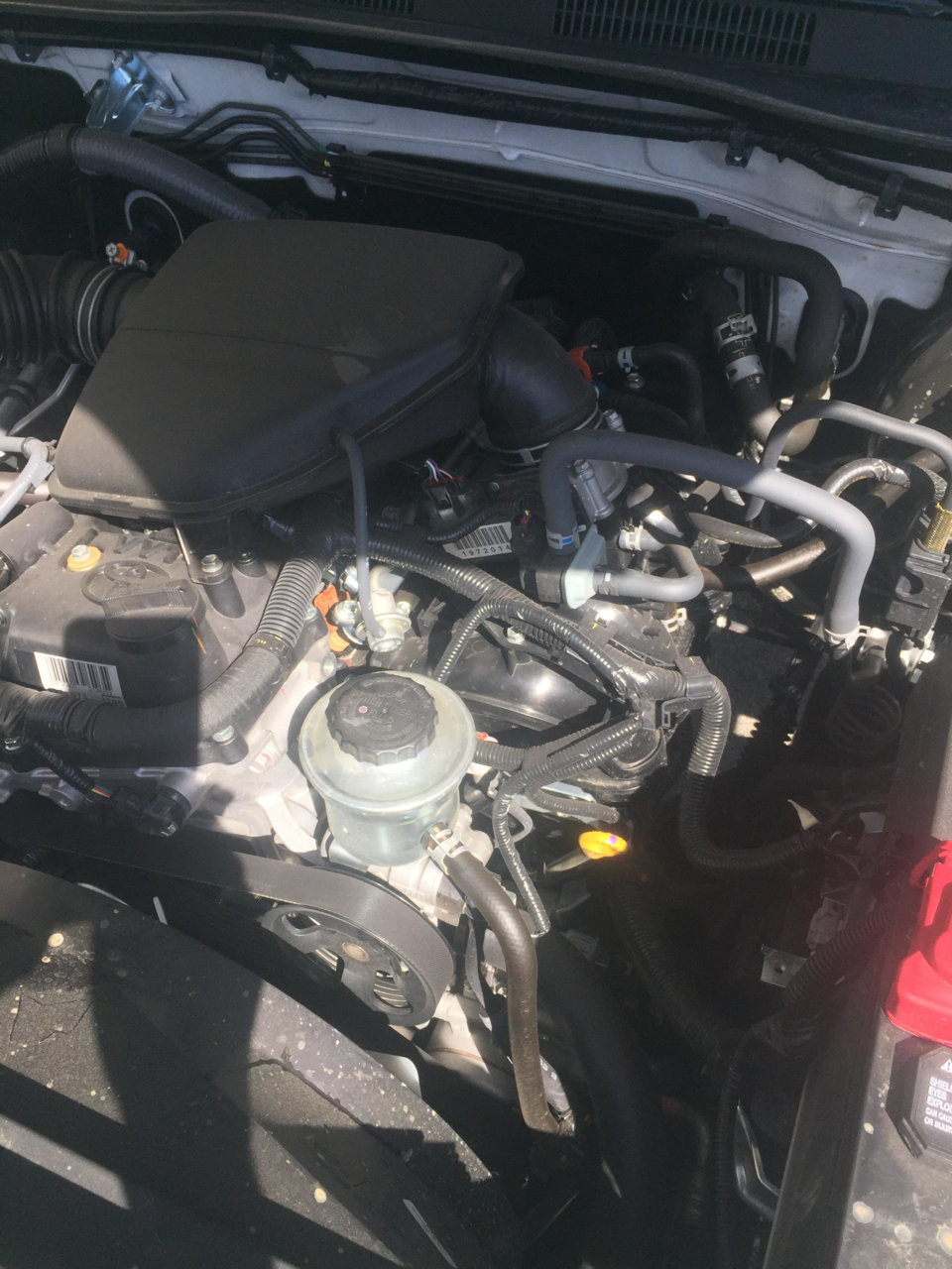

    I have a 3rd genner interested, he just hasn't been able to purchase yet. He sent pics of his and they appear to be identical, with the exception of one external hose bracket. The motor is the same internally. I'd be willing to work with you if you want to try it out, letting you return it for a refund if it doesn't fit. It's up to you, just let me know.

    Yes. From the pics I've seen, everything looks the same except for that small device just towards the front side of where the throttle body is. Also, the only revision to the engine was in 2015, in which it went from vvt to dual VVT-i. This added exhaust variable valve timing, along with the already variable intake. This could be the difference you're feeling from your 09'. From the studying I've done on the project, the only thing the spacer does is allow more readily available air when the valves open. It has no actual effect on the engine itself. It's strange how it works, really. But I've seen other Dyno data studies in more drastic fashion showing the same results. Like I said, you're welcome to be the guinea pig whenever you want. Otherwise, I'll let you know if the other 3rd genner pulls the trigger before you, and the outcome. :thumbsup:

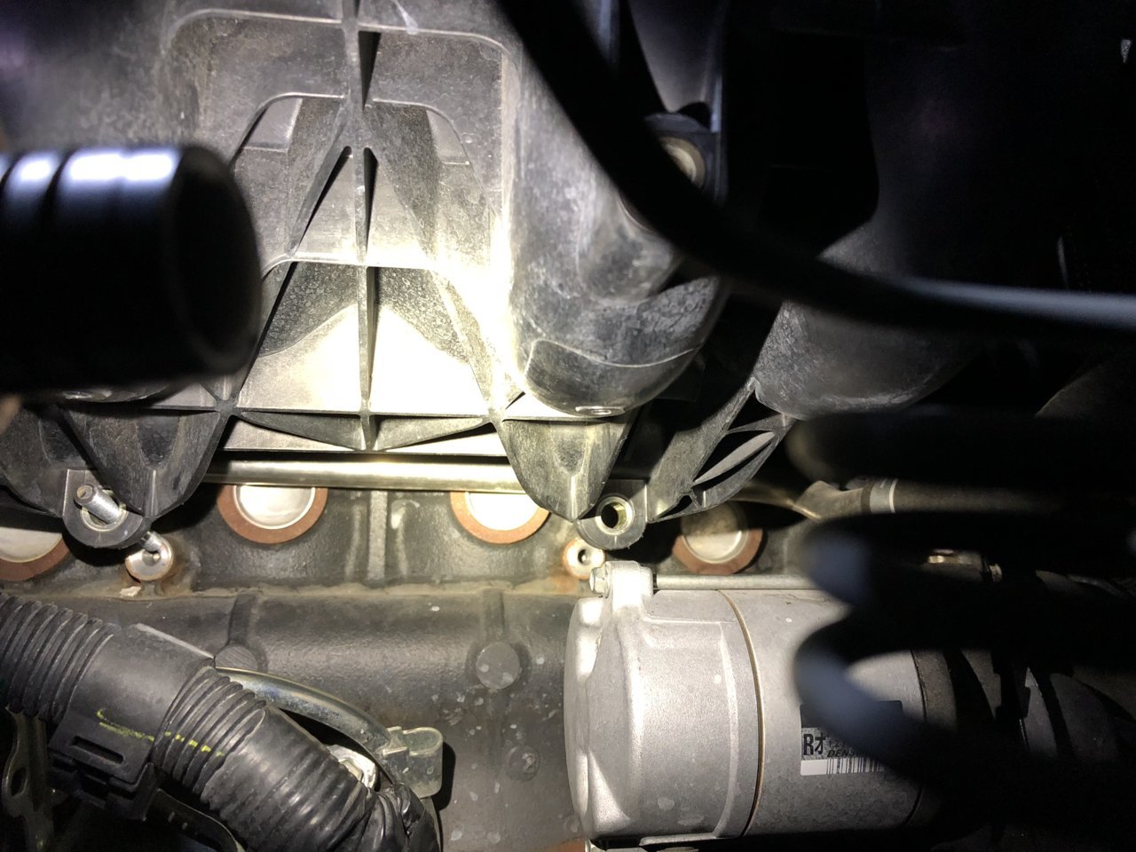

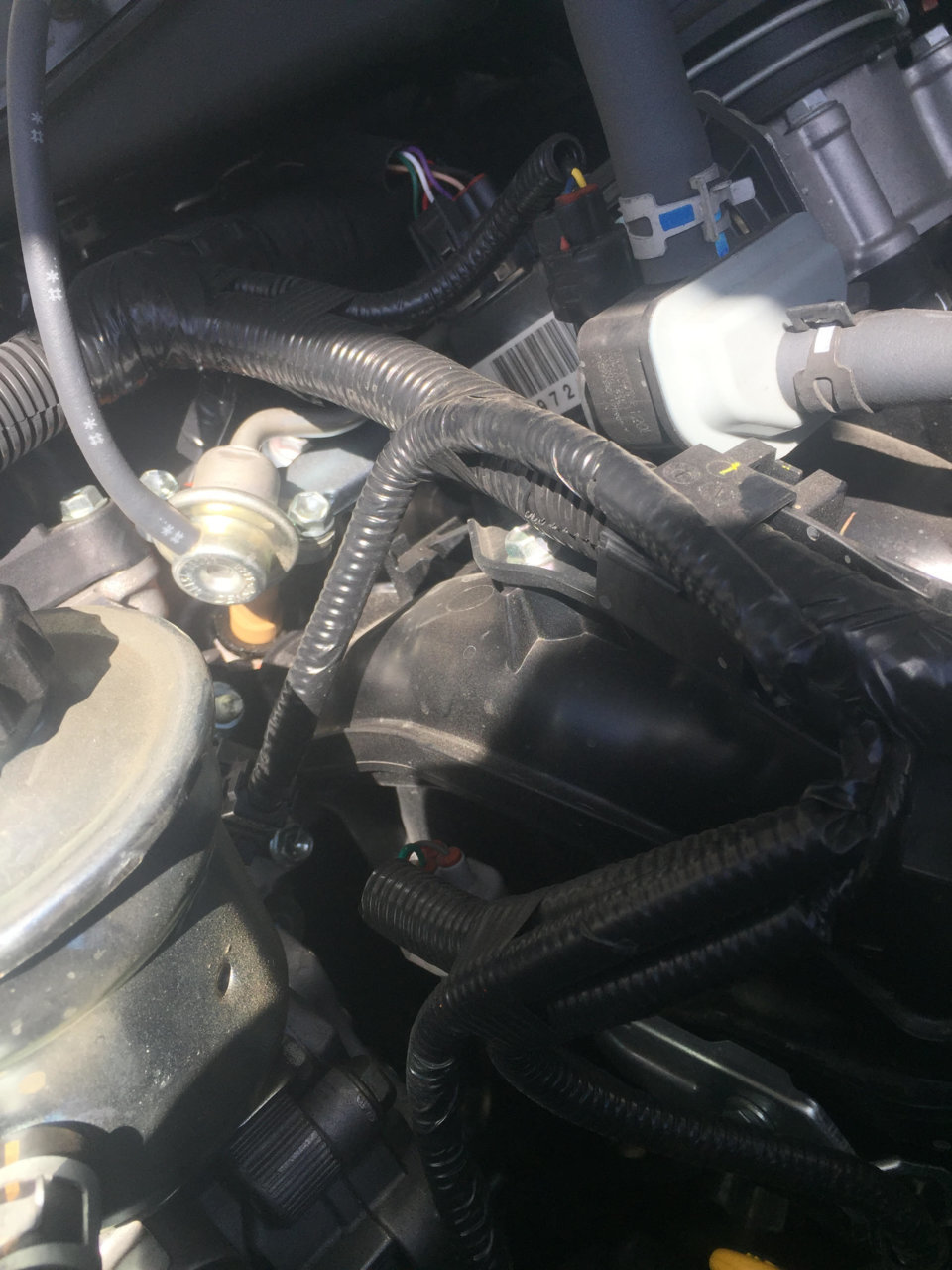

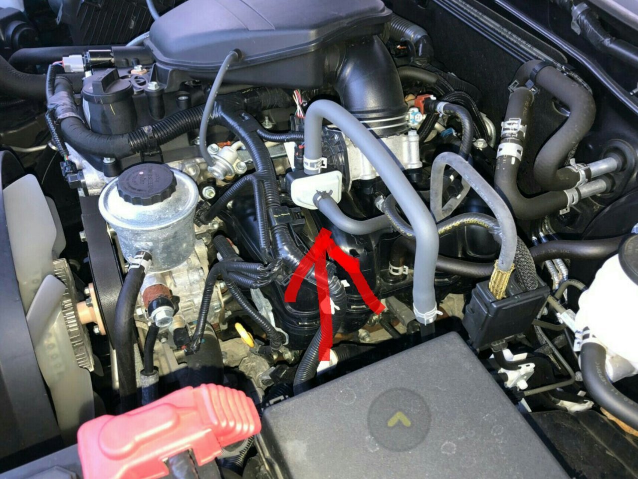

    Well I tried to put this in today (spacer) . And I come across 2 issues. maybe cause its a 15'. but I new about the bottom bolts being an issue (tricky) but I not to sure there supposed to be that far out. there is no way that bolt is going to thread in at that angle.it is raised 1/2"+ and my hose on the side of the intake is a reducer with a somewhat 45degree . how did you get yours to work . cause as of now I have to put it back to normal for now. and really dig deep in to my jerry rigging tool box. All well. I'm of to the store to get some preperation H .this is being a pain in my ass. o2V0MhRXTu6IBvCbAdG6%w.jpg3r+aS3lRRfKK1QDOWjPW1A.jpgUIyPZESQQW60Q0jFzYsDdA.jpg

    Manifold will no longer line up on the bottom after installing. Pull it out and reinsert it under the Manifold. It'll act like a support for it.
    As for the hoses, I just went to autozone/Car store to bought similar sized hoses.
    Kuntrykid and tjhall36[OP] like this.

    Yep, you got it.

    hmmmm. I kinda figured that. at first. and use the two nuts to sandwich to the plastic. but just couldn't do that. Toyota didn't want it that way so I can't do it that way. thats plastic and I've had nothing but problems with plastic on my old trucks. so I measured , pondered and come up with a bracket . basically 2pcs shape of a Z I will make them over the week and post a pic of them and find a S shaped hose. was your hose about 1/2" on the plastic side and about 1/4" on the metal side . as for now its back to normal. will give it another shot next weekend. I only had one day to fuck with it.this week. As for the spacer it fit perfect. Thanks for the input.

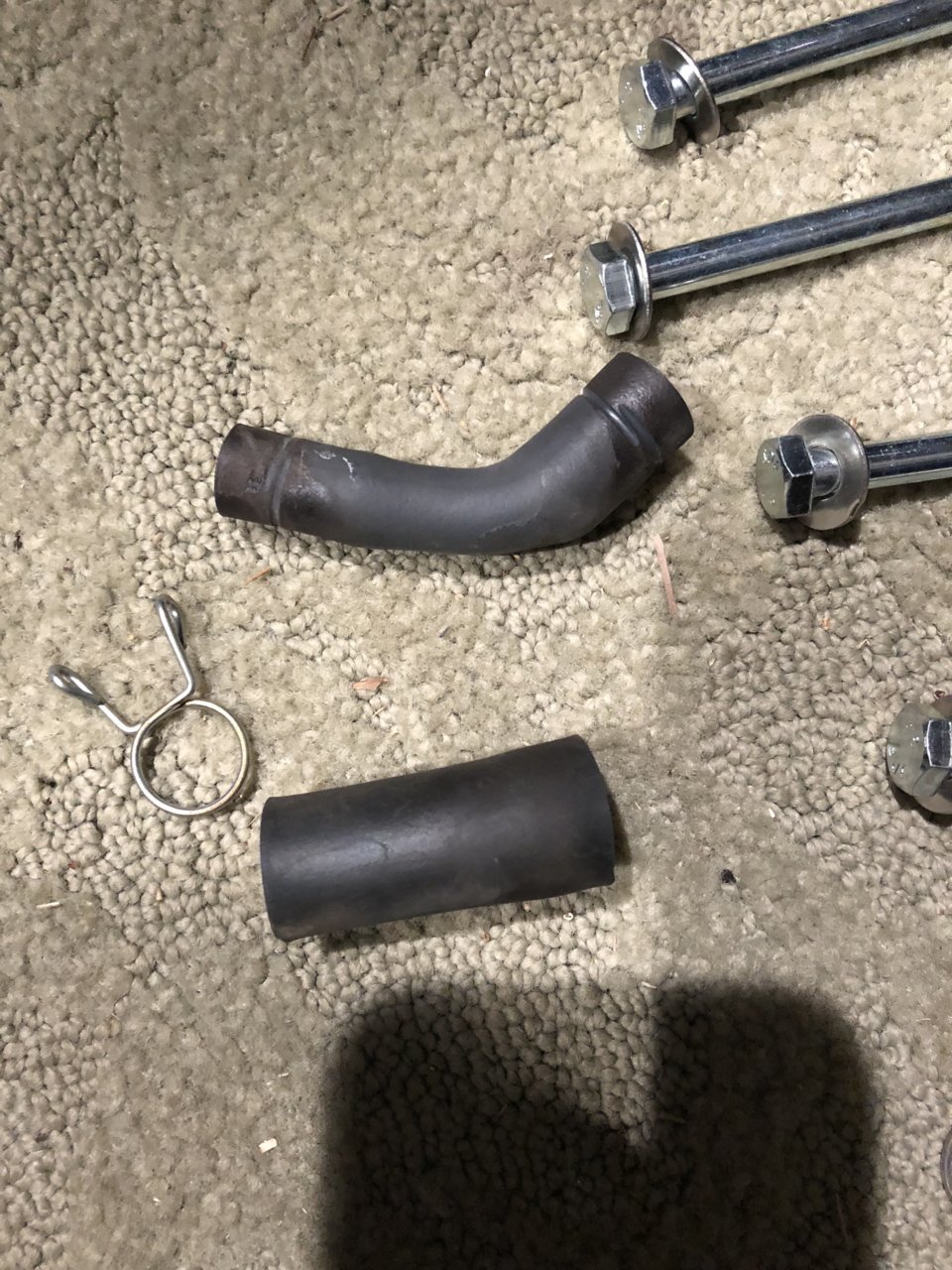

    Sorry, we were driving to Gatlinburg and I couldn't reply. The hose was the same diameter on both ends. The smaller of the 2 (pics on this thread) is for the back side of the intake manifold, the one with the bend in it. The larger is for the top of the intake tube. I was fortunate and was able to scavenge from parts laying around in the garage. As for the lower mounts, I kind of thought about the same offset bracket you're speaking of. I just haven't had time to mess with it again yet. I'm glad to hear you're pleased with the part, but I apologize for the trouble. As I stated before it's not super difficult to install, but it's not a bolt on part. Hopefully you're able to find some hoses and get things buttoned up soon! And yes, please add pics of your bracket when you get it done. :thumbsup:

    its all good. I read some more on here and I think I found a solution. adding a catch can (oil in the intake) off the valve cover and eliminate the factory hose all together with a different hose setup but still use the plastic nipple. mine is two different sizes. must be the year. ill post back after its sorted and finished with what was used.

    You should be able to cut a piece of pipe the same thickness as the spacer and space the bottom holes out; there should be no reason for the bottom holes to not line up.
