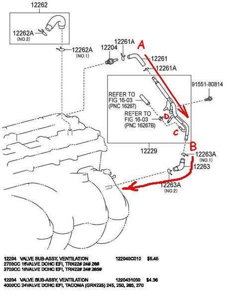

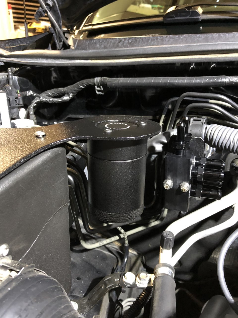

    B ill y
    B ill y Well-Known Member
    Jul 29, 2015
    #160546
    306
    Billy
    Sarasota County, Florida
    2018 4Runner Trd OR, 1997 FZJ80,1985 FJ60
    I noticed oil on my fingers when I was touching the inside intake parts and looked and the back side of the throttle body was oil greasy. So that was oil from the air system. I ordered the mishimoto (MMBCC-MSTWO) I bought that one cause I have mishimoto fans and it matches . there are cheaper ones. my plan is to put that on the output from the valve cover air hose 3/8" or 10mm(firewall left side back corner of cover it 90's to the right)from that nipple to the can. then from the can to the 1/2" or 12.7mm on the intake manifold (also back side) and eliminate the Toyota misl. Multi size BS. the hose I'm using is gate air (fuel) hose 3/8" part # 27004 , 1/2" part # 27006 fittings for hoses from the catch can are (3/8" npt to 3/8" barb) valve cover nipple , output side is 1/2" npt to 1/2" barb to plastic nipple on manifold. the 5/8 " hose on top of valve cover . I forgot about that one . mishimoto does have a 3 way set up for 2 in and 1 out (it has npt threads @3/8" so you just source npt barbs. you would have to find a manifold with 3 way mpt threads I've seen them in 3/8" for like 50 bucks divert from that to your stuff. I guess I jumped the gun on the 2 way can looks like I need to filter the 5/8" also . cause as of now this allows me to install the spacer but filter half of the system. I would have over looked that other hose and only lengthened it. just to get the project done . guess ill have to find those manifolds again.

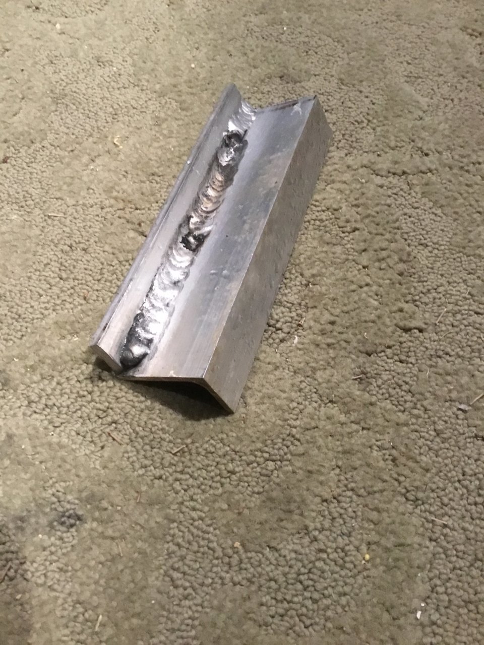

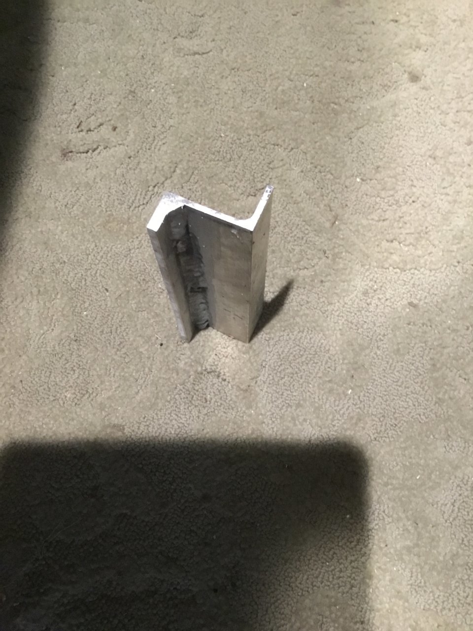

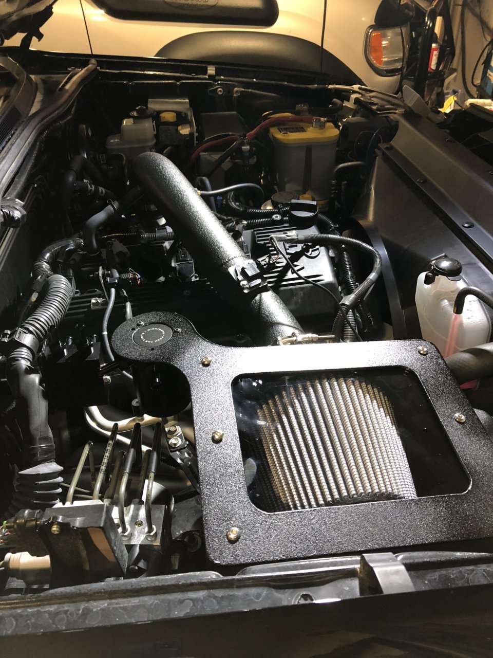

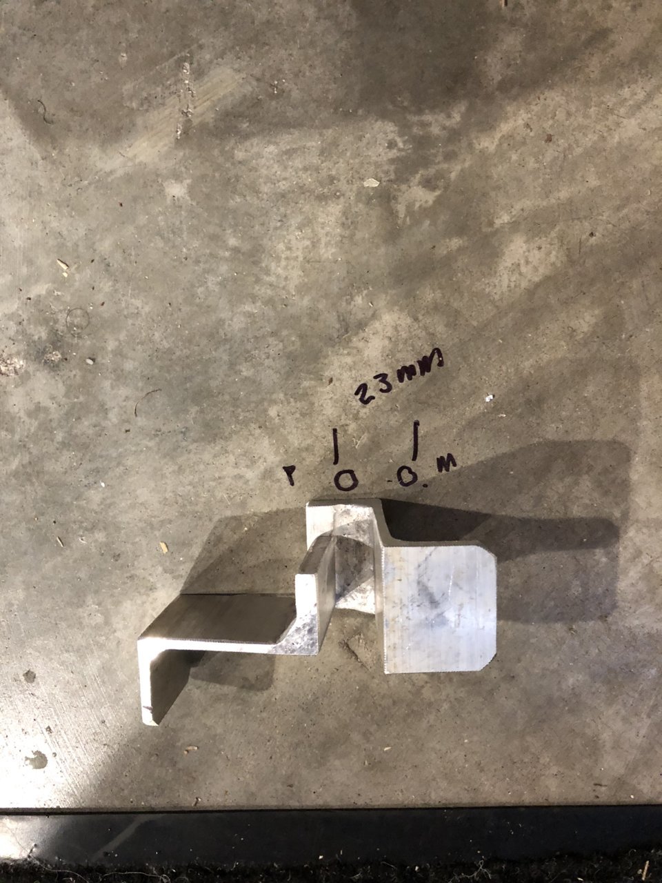

  6. May 20, 2018 at 1:18 PM
    #326
    B ill y
    Jul 29, 2015
    #160546
    306
    Billy
    here is a pic of the brackets. not mounted. there 50mm (2")thick. it was just a 2" angle with 1/4" strip welded and I still need to drill holes but figured I would wait till its all apart to get alignment perfect . the 1/4" will be tapped . only had enough time to make the stuff. and made the other brackets not specific to the spacer mod. but for the catch can and manifolds. and just cause , it looks cool. I made a clear cover for the intake box that will hold the catch can. everything is aluminum with spray texture to match intake pipe and stuff. hopefully next weekend I can get it all hooked up.

    Travis
    Anywhere we park it, USA
    Looks good! Is that extruded aluminum for the brackets? I might have to call up Google tonight and see if I can find some :wink:

    Billy
    Yes 2x2 angle. 6061. Cut one side to 1” try Lowe’s I’ve seen it there.

    #160546
    306
    Billy
    Do to the fact it’s 23mm from outside thread to out side thread. And the 1/8” aluminum in the middle. I got socket bolts cause it’s to tight for a regular bolt and socket.

    Aug 18, 2016
    #194892
    321
    Travis
    Gotcha. Yeah, and there's no threads on the intake manifold, so that makes things a bit tricky. I've found some Z-shaped extruded aluminum online in various shapes and sizes, might have to order some and give it a try.

    Knoxville, TN
    V8 Solid axle swapped 5 lug
    Got a lot of stuff lol
    Have we determined the diameter of the smaller tube on the side of the manifold? I want to do this soon but I'd rather swing by AutoZone on my way from work with my truck lol.
    Kuntrykid likes this.
  15. May 23, 2018 at 5:36 PM
    #335
    tjhall36
    tjhall36 [OP] Well-Known Member
    Aug 18, 2016
    #194892
    321
    Travis
    I'm going to say 9mm on the truck side, and 12mm on the intake side. Those are ID numbers. I agree, it is definitely bigger on one side.

    #160546
    306
    Billy
    1/2” at the plastic but could heat up some 3/8” and stench it. If you had to. Don’t break the plastic nipple . The manifold is 250-300. The pcv valve on the valve body cover go’s to the manifold nipple. If you were to bypass the stock metal piping.
