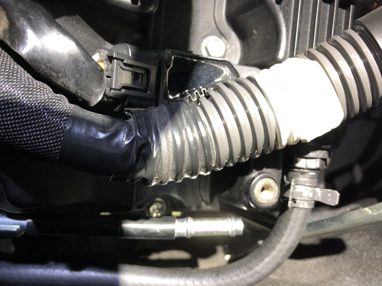

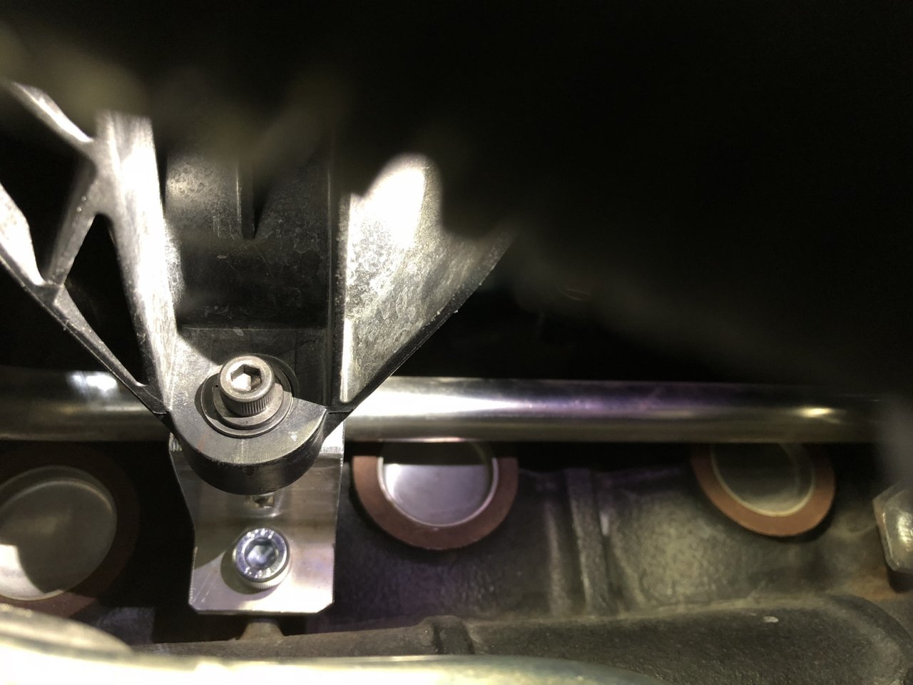

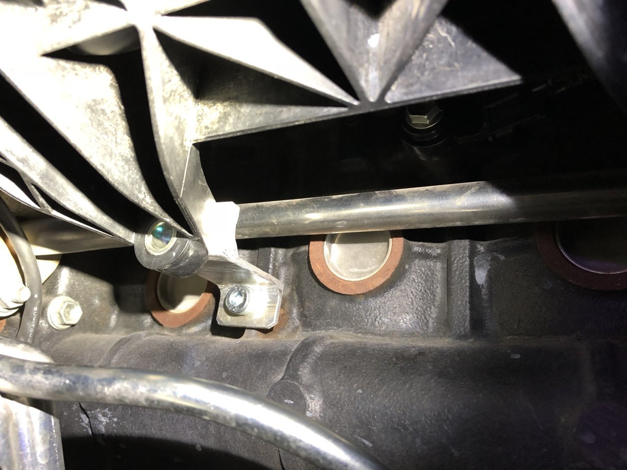

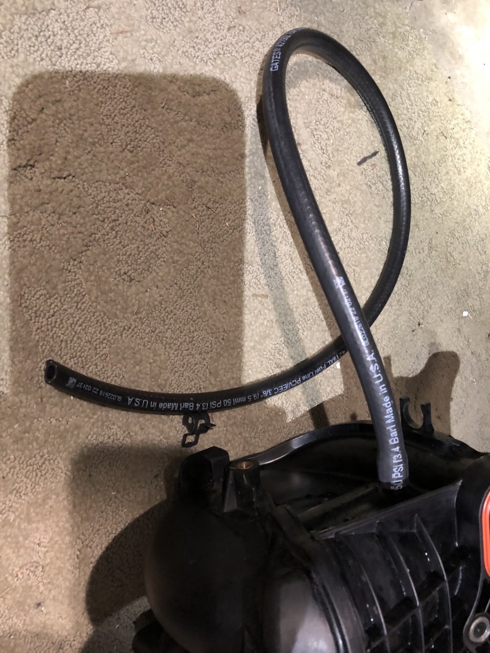

    the bracket was a little off . but made it work. as you can see. ended up using 3/8 gates hose for the plastic manifold and just stretched it . 1/2 was a little lose and would not work on the valve cover nipple. it was a 2-3 ft piece and just bypassed the stock metal pipe . used 5/8 piece of gates hose for the other hose. 1ft on top one valve cover to intake pipe.

    Nice! good fix.

    Yes, looks good! The bracket turn out ok? Any tweaking? I received the 1" stock the other day but I haven't had time to tinker yet.

    No tweaking. Just tapped it on the edge instead of center. Should had made the thicker longer (lower). It works for now.

    @iofs here is info on the hose, along with a good solution for the bottom 2 holes if you haven't seen it yet. I included some extruded flat stock your kit also for this option.
