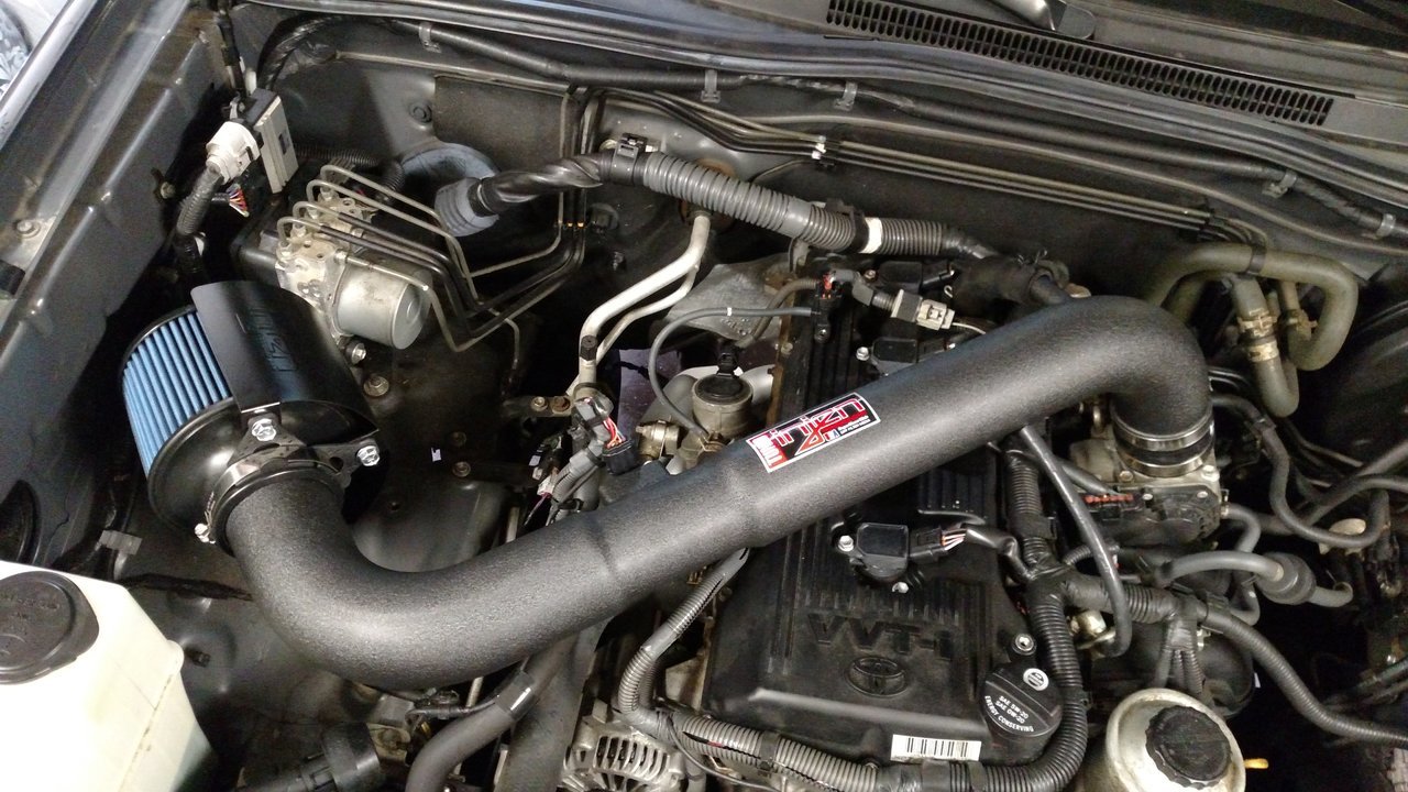

    Ok look guys I'm proof that w/e was changed the injen intake & lce headers cause no problems & everything fits. Been running both for 30k miles & have 55k on my truck. The shit works stop coming up w/ excuses not to buy them. If you want to improve your 2.7 spend some $ or quit complaining! It works by lowering the torque range. The 2.7 is a quik motor if you know how to drive a manual. :D
