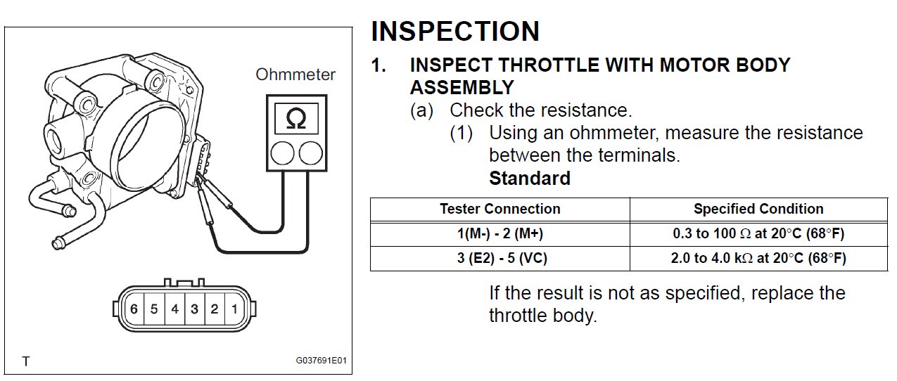

    Torque Wrench (covers 36-80 in. lb.)
    Ohmmeter

    Disconnect the Throttle Motor Connector.
    Remove the Bolts (2) and Nuts (2) (80 in. lb.)
    Disconnect the Water By-Pass Hoses (2).
    Lift Throttle Body Assembly stright up, exposing the Intake Manifold.
    Note: There is a non-reusable rubber gasket between the Throttle Body Assembly and the Intake Manifold (I reused mine).
    Bottom view, before cleaning.
    Bottom view, after cleaning.
    Clean with Throttle Body Cleaner, following directions on back.
    Reverse process to reassemble.
