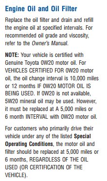

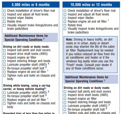

    2016 Warranty and Maintenance Guide shows 10k for oil replacement.

    Tell them you go 4 wheeling every weekend on dirt roads. It's 5K then... my dealer did it under Toyo care at 5K oil change AND my maintenance light AND Etune warning to get service both came on at 5K.
