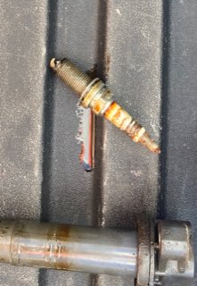

    sorry for bringing up and old thread but I have posted in this in the past. I am currently sitting at about 220k miles. and burning about 1 qt for 500 miles driven. Had a doozy of a misfire this past weekend and was able to limp it home. Truck didnt pull any codes but I decided to swap the plugs and coil packs. I got this bad boy out of Cylinder 3. Ya, thats oil. this was by far the worst, cylinder 1 actually looked crusty like there was coolant in it, anyways, my question is, how long will these new plugs survive?

    I think you might have a very leaky valve cover gasket that will keep fouling plugs

    that is next on my list to replace. hopefully it will be in next week.

    I'd be checking out the spark plug tube gasket as well. That's probably why you have oil on top of your plugs
    Spark plug seal gasket 11214-75012

    Isn’t that part of the valve cover gasket? It usually is, hence my comment above

    It is a one piece gasket on the 1GR, but they are separate on the 2TR
