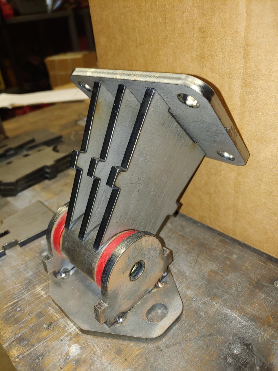

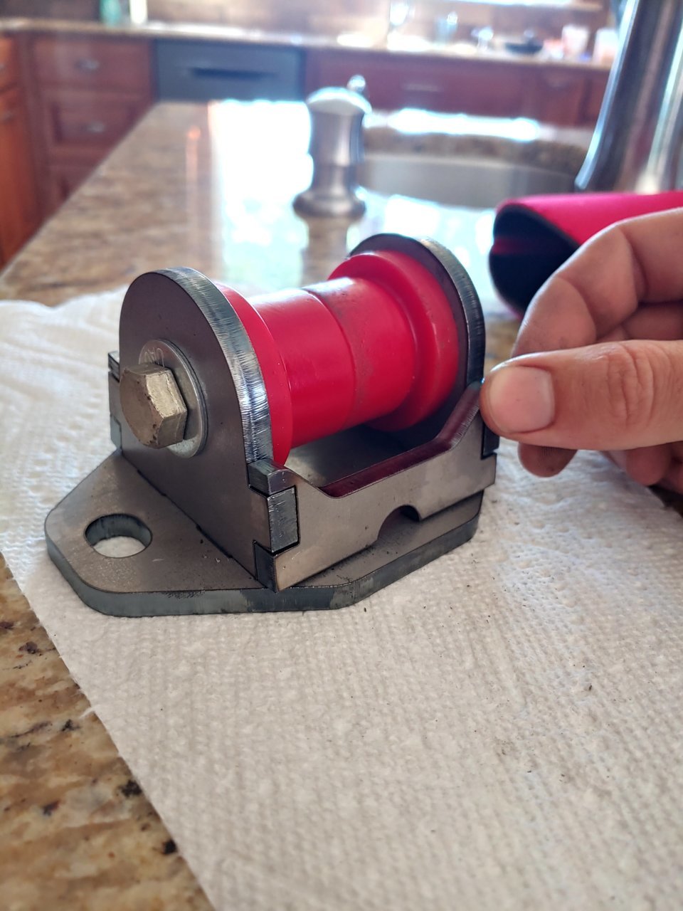

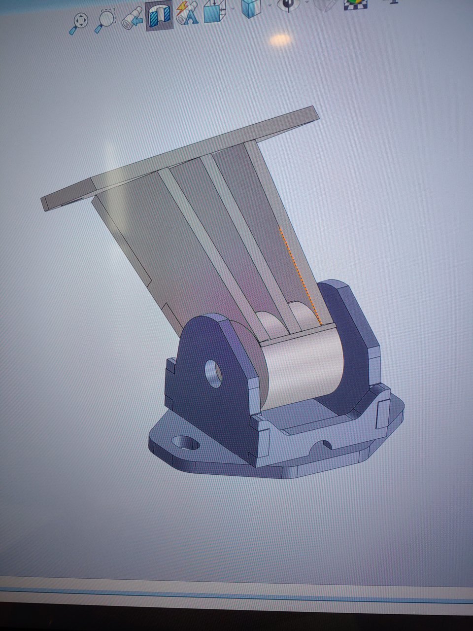

    Hi guys and gals, after doing research I've discovered no one offers a more solid motor mount to replace the worn out rubber mounts on our trucks. So determined to not replace them with factory mounts I've begun the process of building my own. If there's interest I can build these for others as well. Everything will be 1/4" steel with the option of stainless. Here's my progress so far, just the frame side and motor side plate.

    Prototype should be done in 2-3 weeks then after that I can get batches cut out whenever I want. The shop I use has a 1-2 week lead time on their laser. It'll take me a day to weld then another week at powder coater if the consumer wants that. The bushings used are a universal energy suspension bushing easily sourced for about $20 per pair if they ever need replaced. As far as cost for the kit im not sure yet as the shop I go through just cuts what I ask and bills me later.

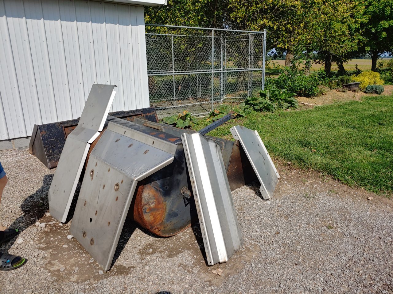

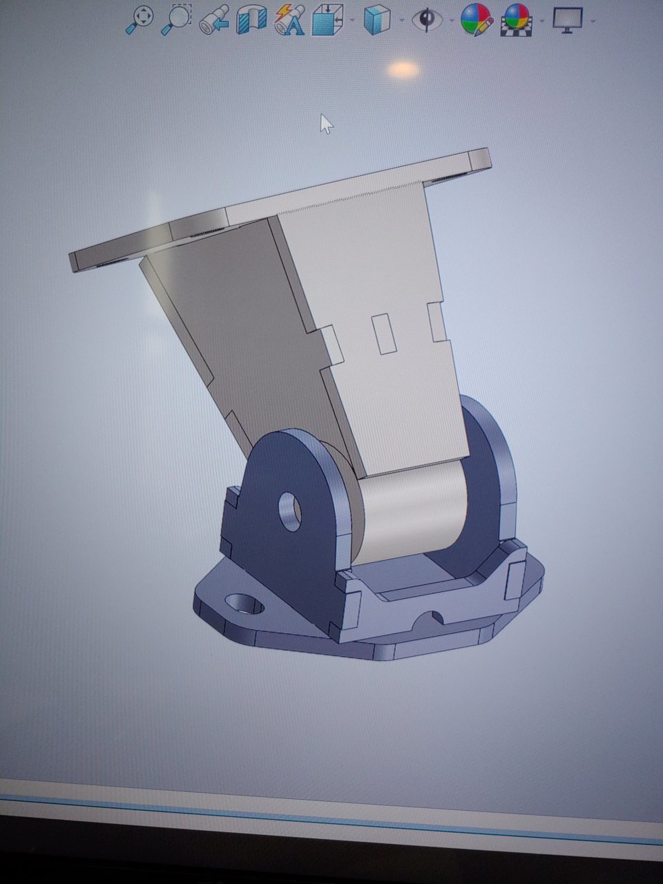

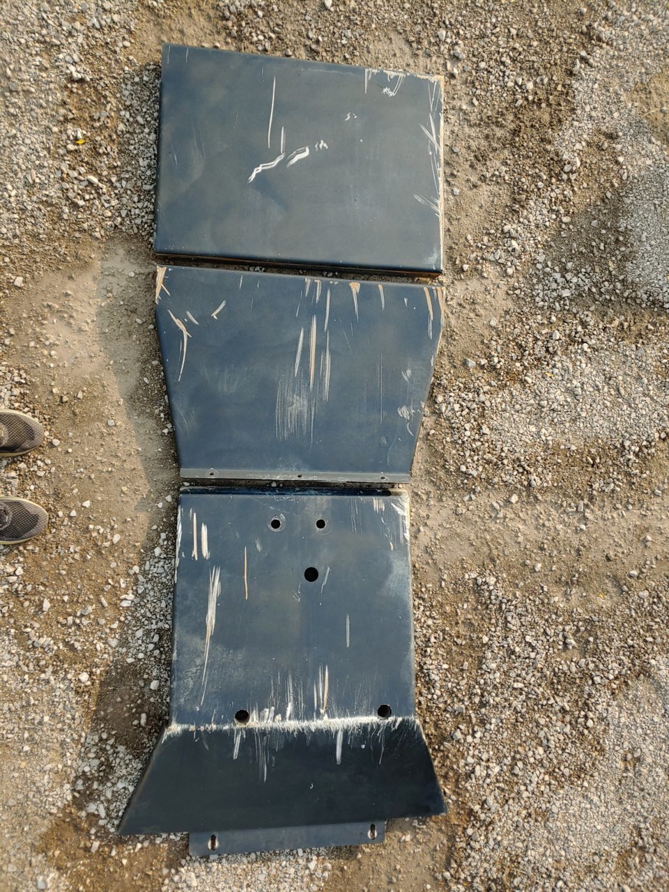

    Sorry guys school has been crazy and I just got some shop time this weekend. The trucks been cleaned up from the last adventure and the final drawings have been sent out and the laser shop. I should have parts back in two weeks. These are way overkill for our motors but its how I usually build things, all 1/4" plate notched and fully boxed. There's also a pic of the 1/4" skids I built and a set of 3/16" stainless I finished up late August.

    Stainless Skids

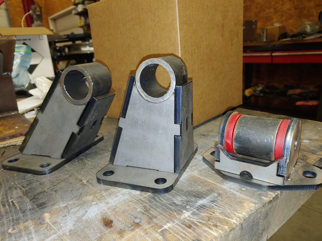

    Just picked up the first set and they are getting close to how I'd like them, hopefully I'll have time to weld then together this weekend and use them while I wait on the next set. A DIY kit may be an option, but no guarantees.
