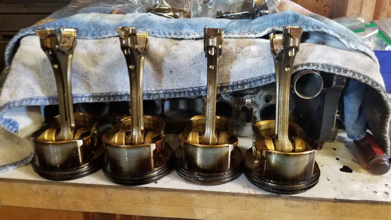

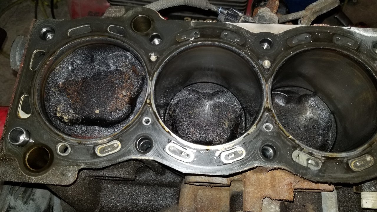

    Hey guys!

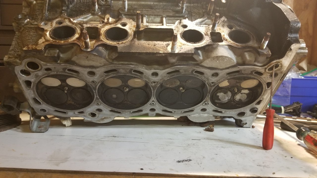

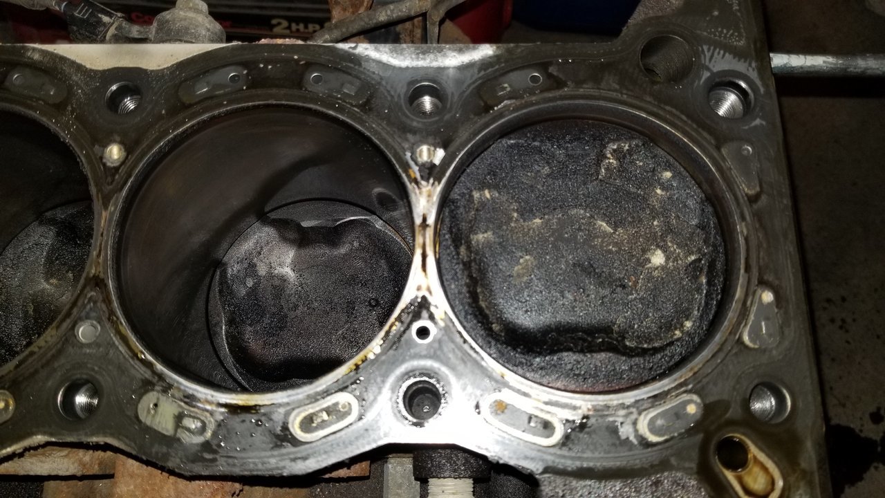

    This is my first post here and as a new Tacoma owner. I just recently picked up this 06 for $800 with a blown headgasket. It's an sr5, 4x4, 5 speed, 2.7l, 220k. The previous owner had his mechanic tell him the gasket was going.
    The truck was overheating so they drilled the thermostat and put stop leak in. Sounds like it bought him time to get a new truck, but then it started losing power. I did a compression test and got front to back, 125, 100, 145, 155. It actually ran ok and I drove it home. No obvious signs of issues except the compression.
    The plan is to just do a basic rebuild and refresh. I am a machinist and can do any block and head work myself. Open to any suggestions on parts for the rebuild. I was looking at the yotashop kits for gaskets, bearings, rings and pistons.
    I have a boat load of pics so I can likely post most of a step by step rebuild if anyone would care for that much detail. Last pic is where I'm at now
    Let me know your thoughts!

    Should be able to set some APR head studs. Maybe even a MLS headgasket, better than OEM.
    You could do the counter balance shaft delete kit, but not necessary if staying with stock power.

    @Loxsl - The 2TR is a solid platform that you shouldn't change. Anyone who blurts out "V6 or V8 swap it" knows nothing of what the motor is capable of handling...Trust me. Like Tor said, if you have the head off- I'd do a nicer headgasket with the ARP head stud kit, as it's worth the extra money for the insurance. The weakest point of these motors so far seems to be the hypereutectic pistons...but if you don't plan on going forced induction, you'll be fine.

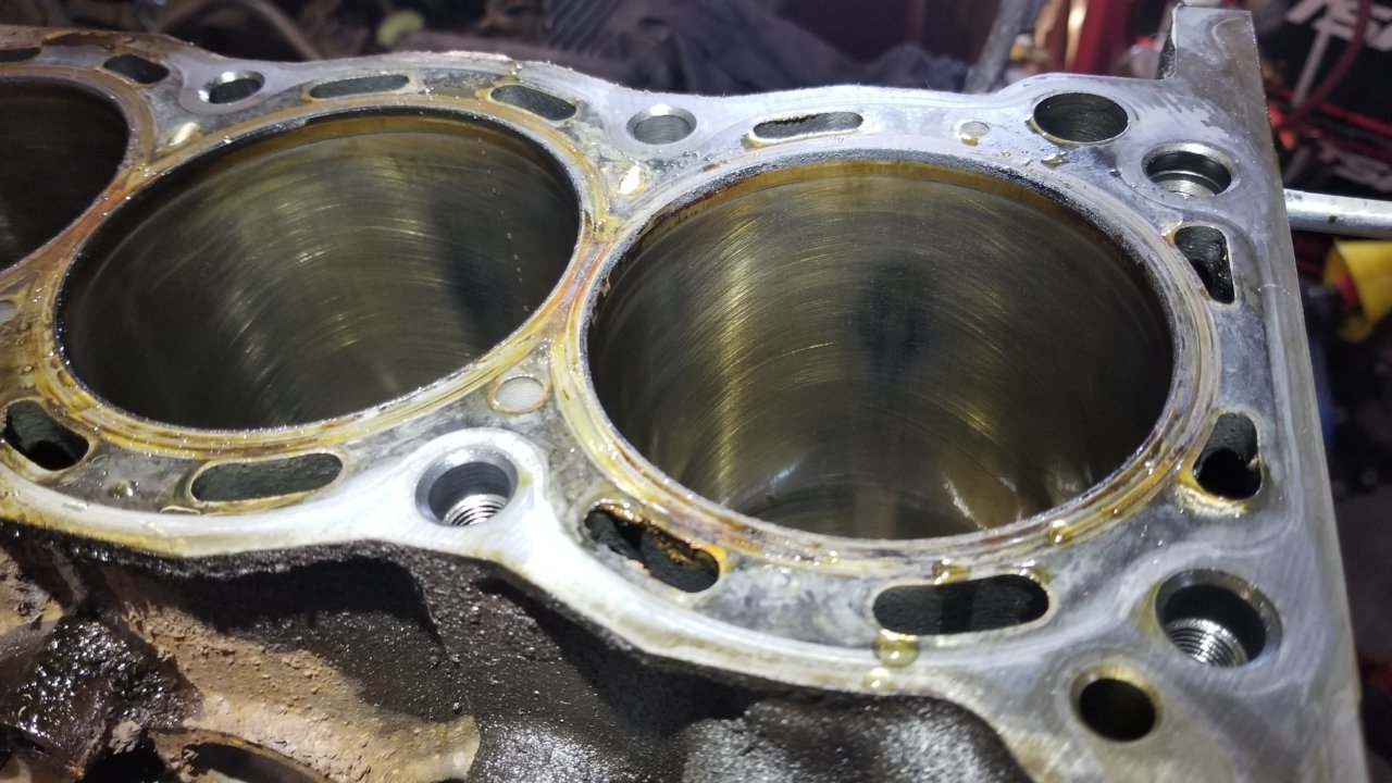

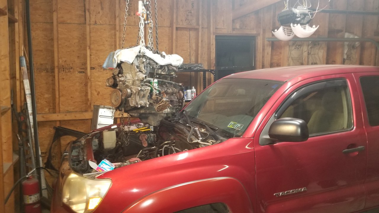

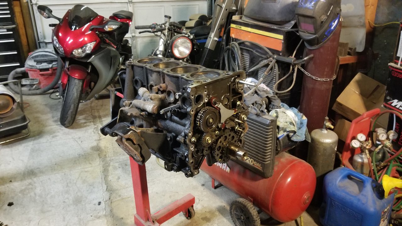

    I got a little further on tare down before work. I hope to have it all stripped so I can clean it and start checking everything in the next day or two.
    Lcenginering doesn't have a 2tr bottom kit that I could find. I could to yotashops kit and just add the upgraded gasket. I need head bolts anyway so apr is an option. I could see forced induction down the road maybe but I don't know that I'm ready to commit to that and it's not like it will be faster then my other vehicles.

    2TR short block and 3RZ short block are the same.
    You should call them. :thumbsup:

    Got a perfect looking cross hatch.

    Cool! Yeah I was planning on calling before buying. I have to mic everything first and find out how much if any machining I need.
