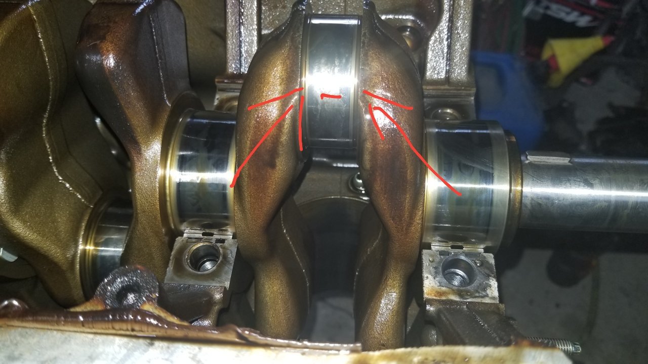

    And the answer is... 21.15mm according to the shitty calipers I have at home. So that's a no go. Btw the bearing surface is approx. 17.6mm.
    Purely from a fitment standpoint you could shave 2.5 off each side. If it's just at the bearing surface I dont think you'd see much less in strength. Just dont shave the rest of the rod.

    Aaahh, ok- that explains why the wear looks like there was 4~5mm to work with

    Yeah there is an undercut on the sides. Likely makes sure the bearing is on the journal and not caught on the edge and would allow oil to move around there.

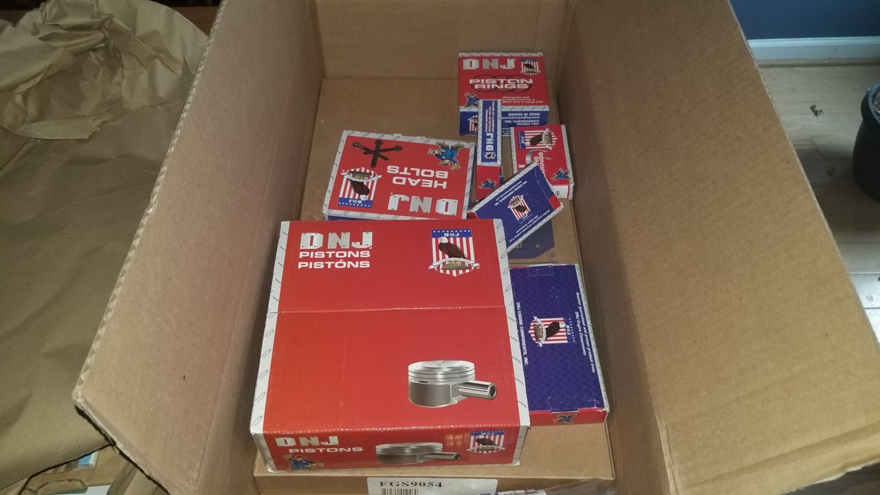

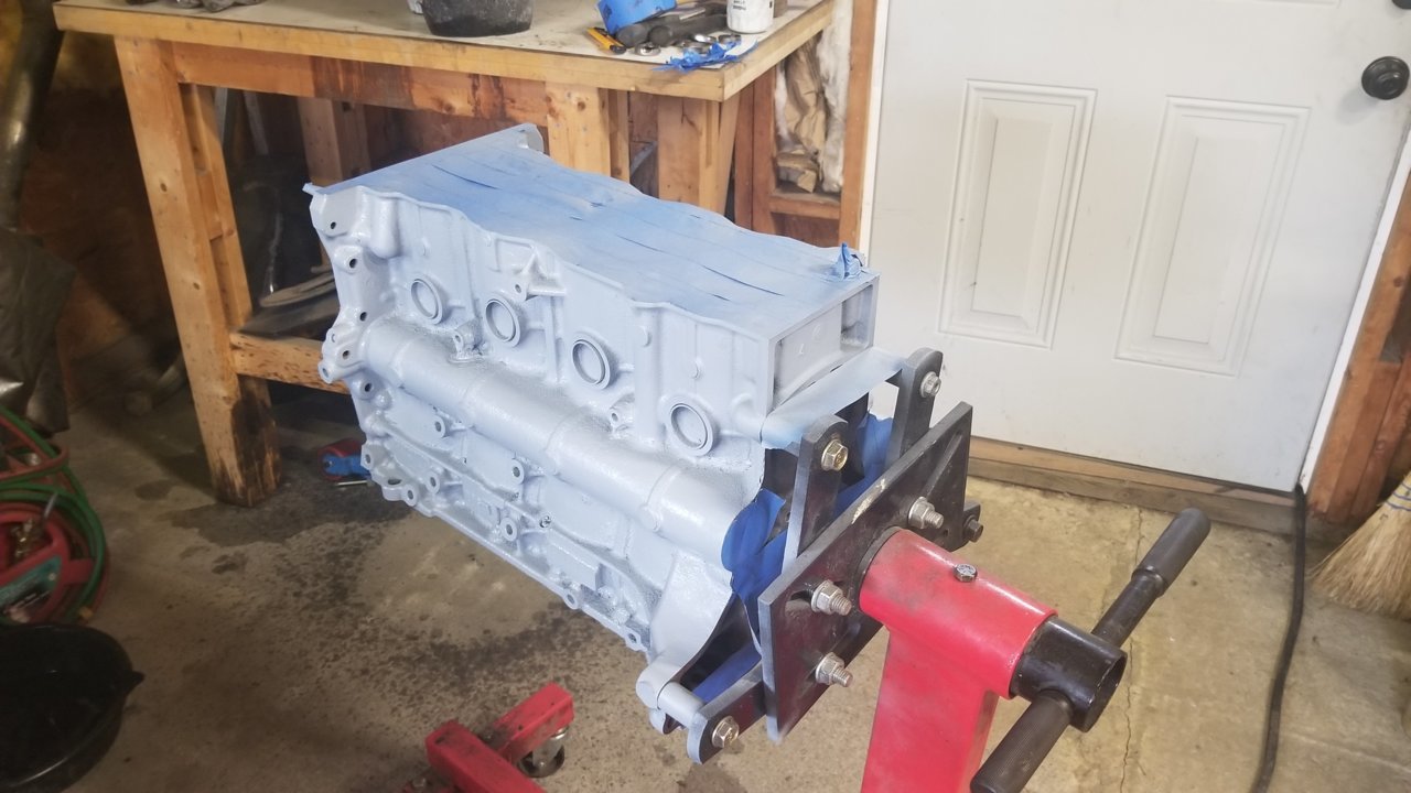

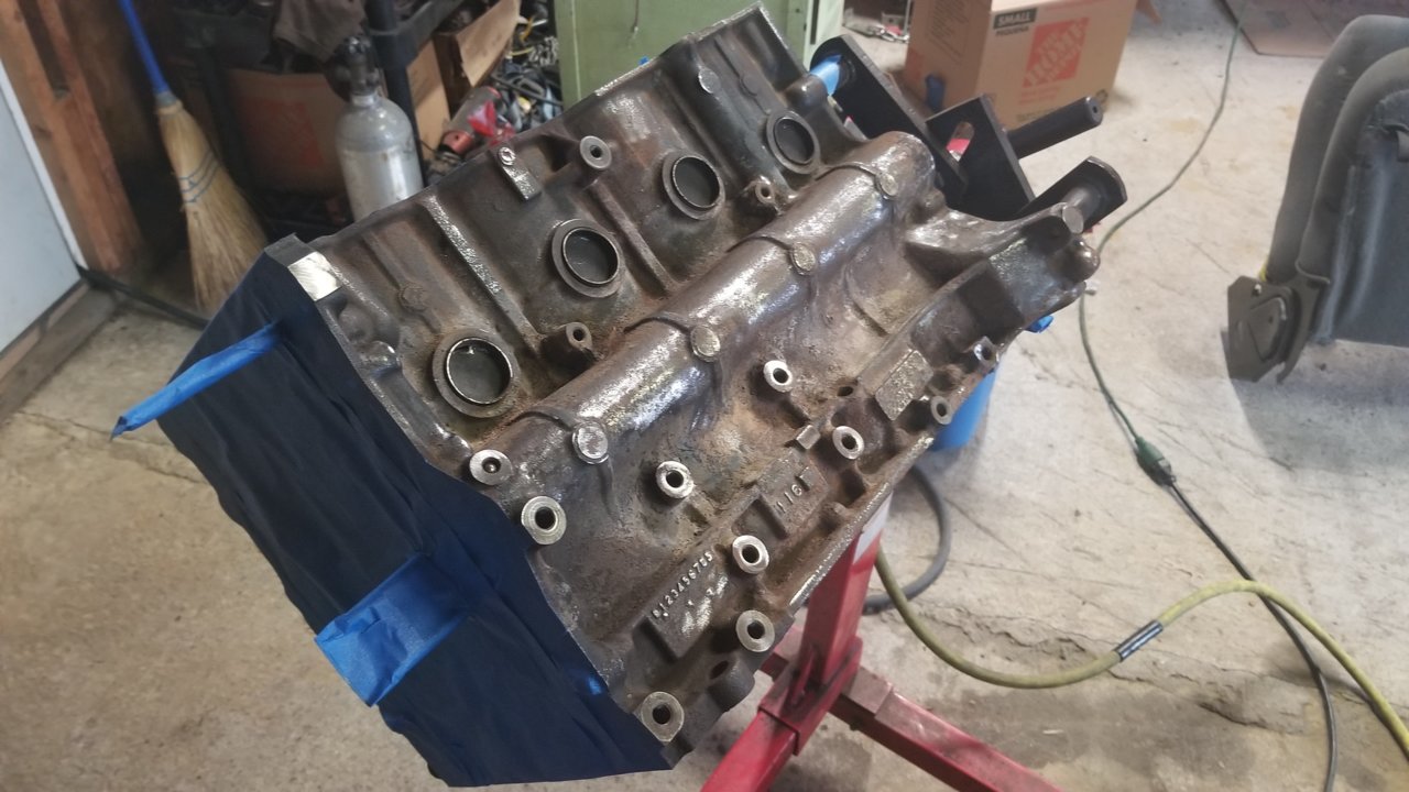

    Got my parts from Yotashop yesterday. I asked them to draw their favorite cartoon character on the box.
    I think they need art lessons but I appreciate the effort.

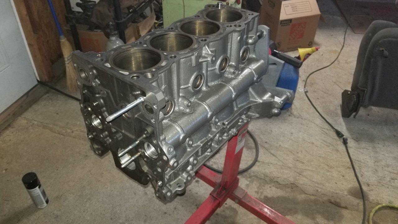

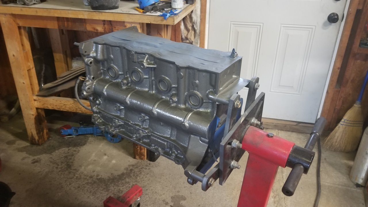

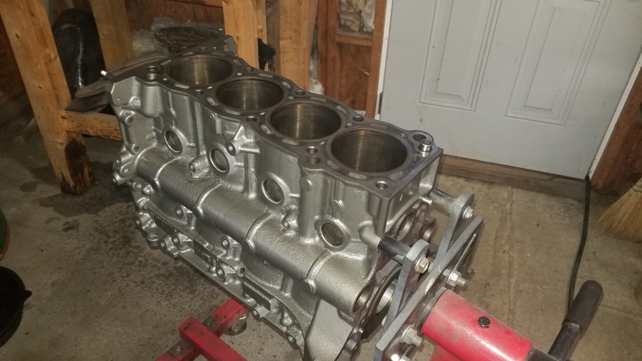

    Taped up the block and went at it with a die grinder and some sanding and scotch brite pads. Finished with carb cleaner to pull any oils off.
    Then primer and paint.
    20180506_184933.jpg 20180506_192143.jpg 20180506_194522.jpg 20180506_194544.jpg
    Getting somewhere!
    John
    Stemmy, BassAckwards, Jcyr and 7 others like this.

    I am going to enjoy the painting process.
    Looks great!
    Curious about the block plugs though. They don't look like they are all the way seated, and one of them looks like its in crooked?

    That's because they are exactly that. Look at the un-taped pics. I have nice new brass plugs to put in.

    The primer made the pop, great finished product!

    Its vht engine enamel. I used the cast iron and it looks way better then expected. I think I'm going to do the aluminum in it as well. Maybe do the head black though. Not sure.
