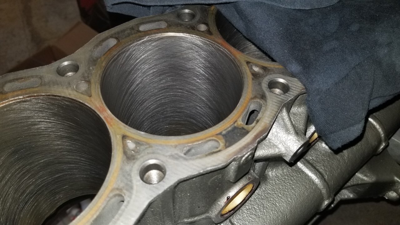

    I used the 240 grit 3.75in. I think that's the same one you listed.

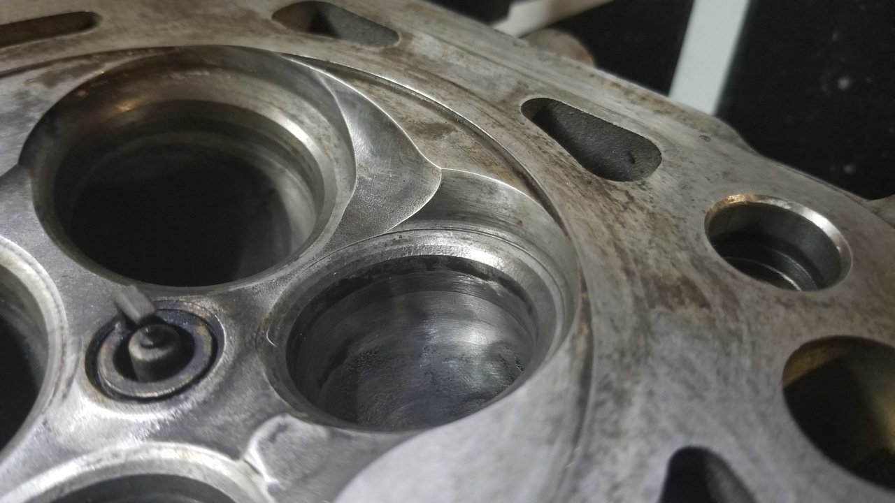

    Dirt King Mid travel with King 2.5 coilovers, Baja Kits chase SUA with 14in fox smoothies under custom hangars.

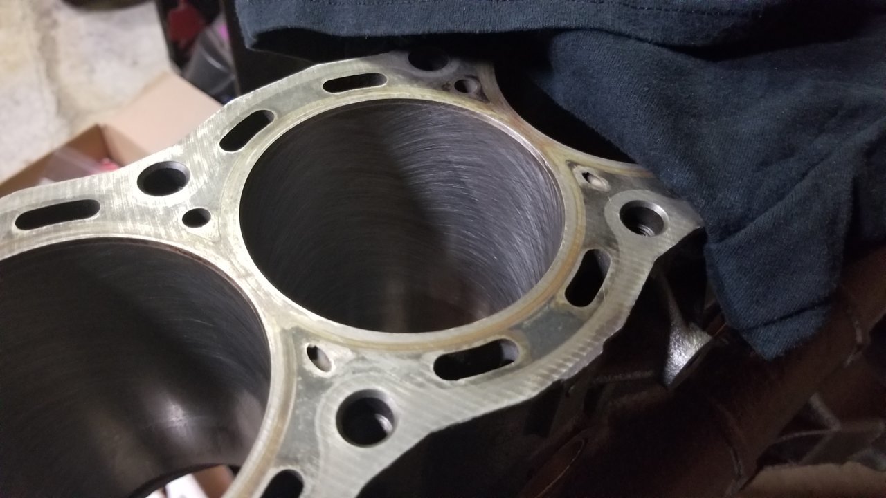

    IMO, they do look a little deep, and a little 'vertical' if that makes any sense. Maybe a little higher rpm, and a slower plunge? Maybe when you pulled the hone out, you may have pulled it up faster than you were plunging during the hone, making the last pass a little steeper
    You are correct that the flash may be accentuating the scores in the bore, but its worth an inspection.

    It was definitely the flash. We have surface finish examples at work that I used to compare to and it's about right. As for vertical, in person none look even a full 45 more like 40 ish but it should be fine as is. I could do more damage by trying to make it perfect then by leaving it.
    Flash
    No flash

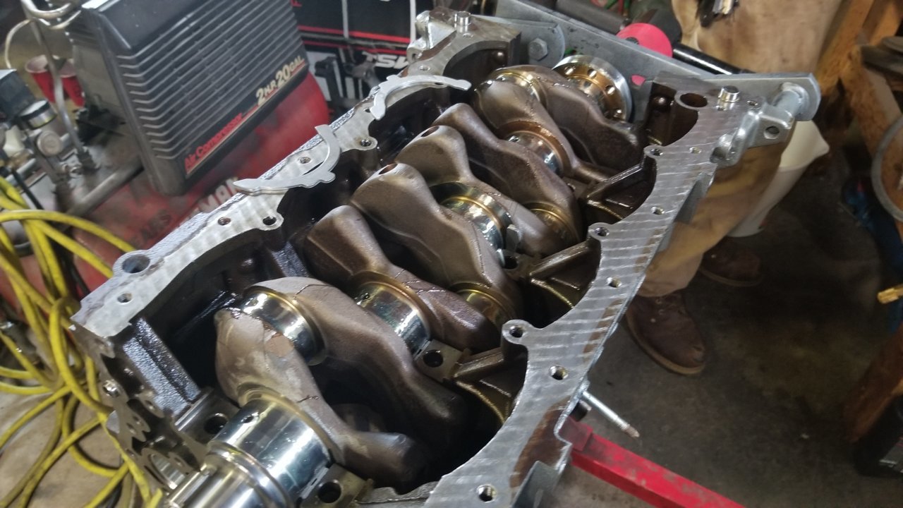

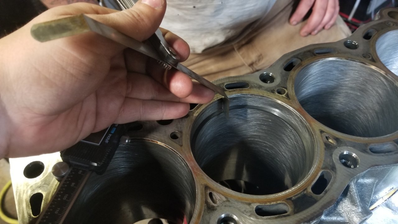

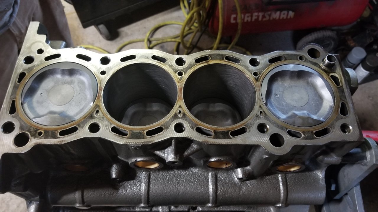

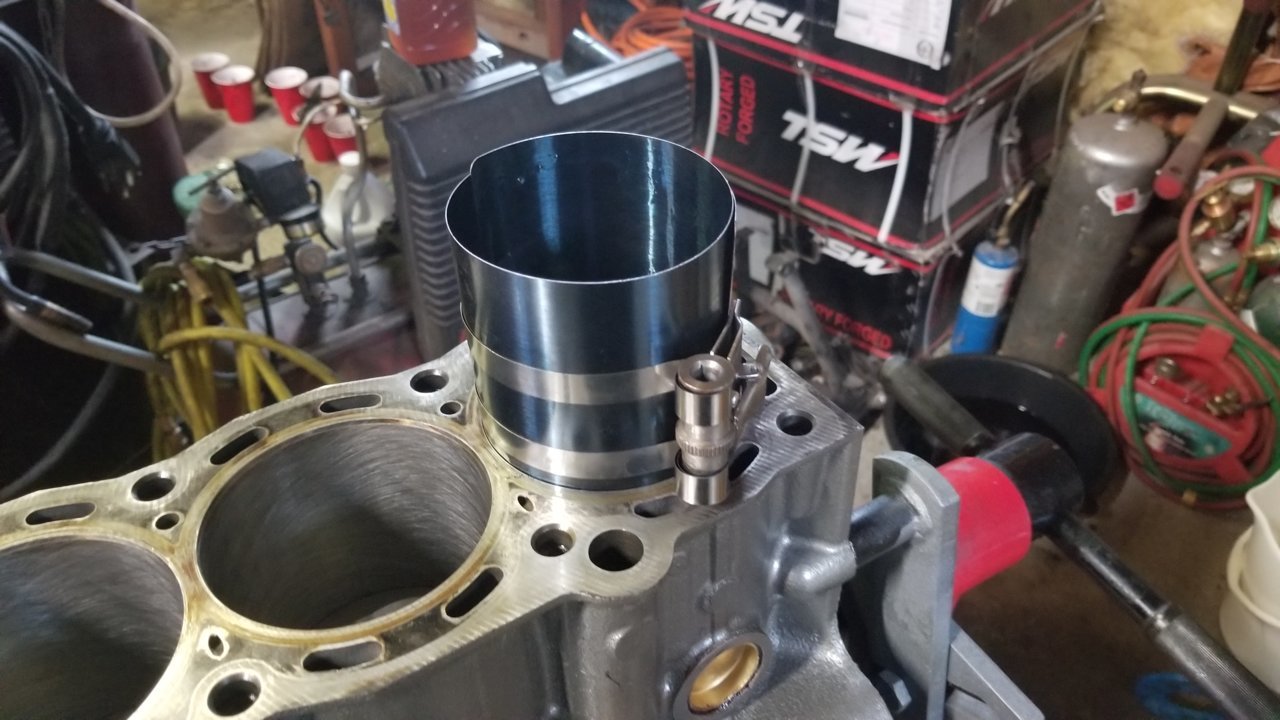

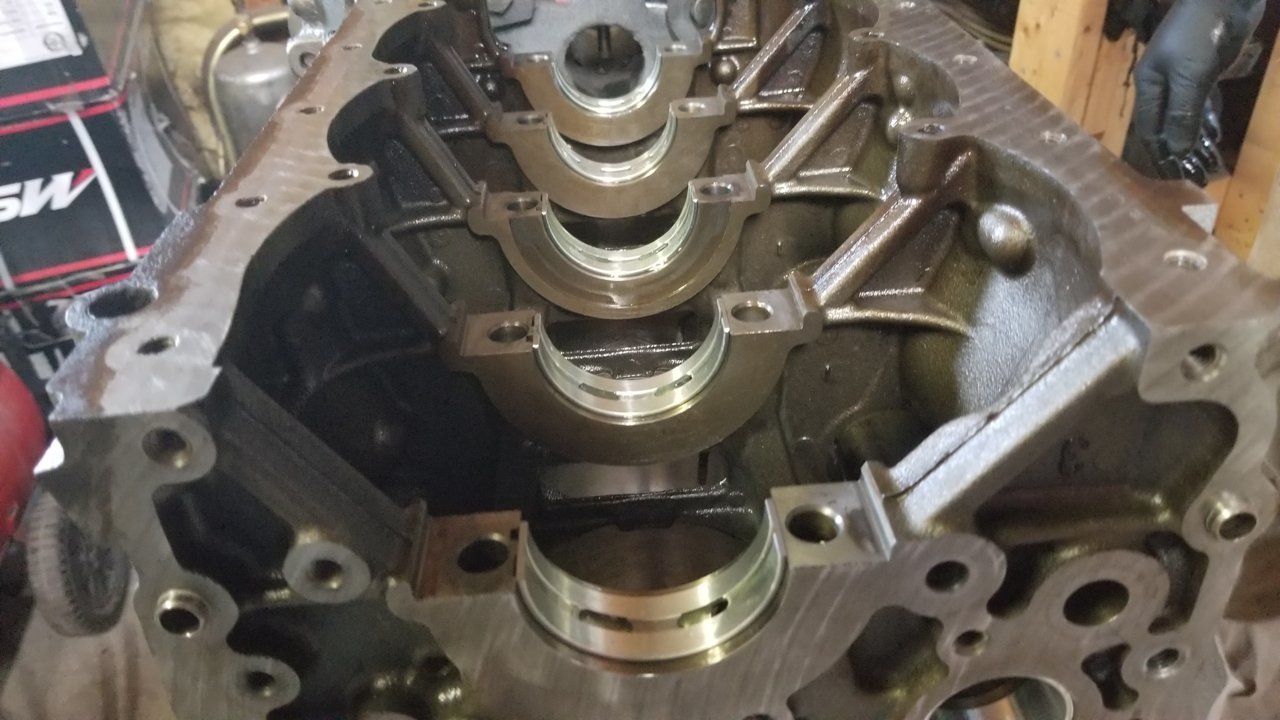

    Yesterday I got the rest of the valve cleaned and the crank and pistons in. Thanks to some help from my buddy Tyler for keeping me motivated.
    I did measure the bearings to make sure the new ones are in spec as well. Used some ARP bolt lube to ensure proper torque.
    For the rings, I inspected each one and used some 1200 grit sandpaper to knock off any burs or particularly sharp edges. There were very few. Then each ring was put into its cylinder and measured with feeler gauges to check end gap. All but one were in tollerance. I used the sandpaper again to take a small amount off each side to bring that one in.
    After installing onto the pistons they were checked for height gap with feeler gauges, all good, then installed the pistons.
    Got some more work to do this weekend but making progress!

    DEFINITELY the flash. What a difference lol

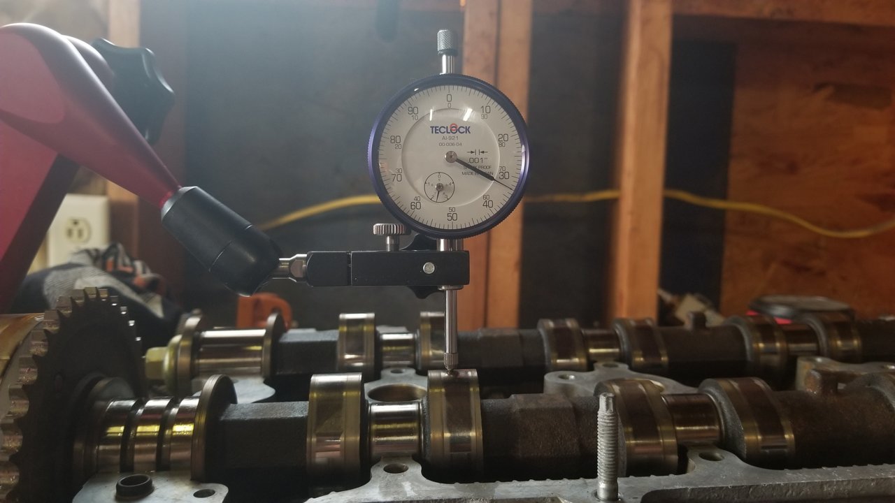

    @05Taco4x4

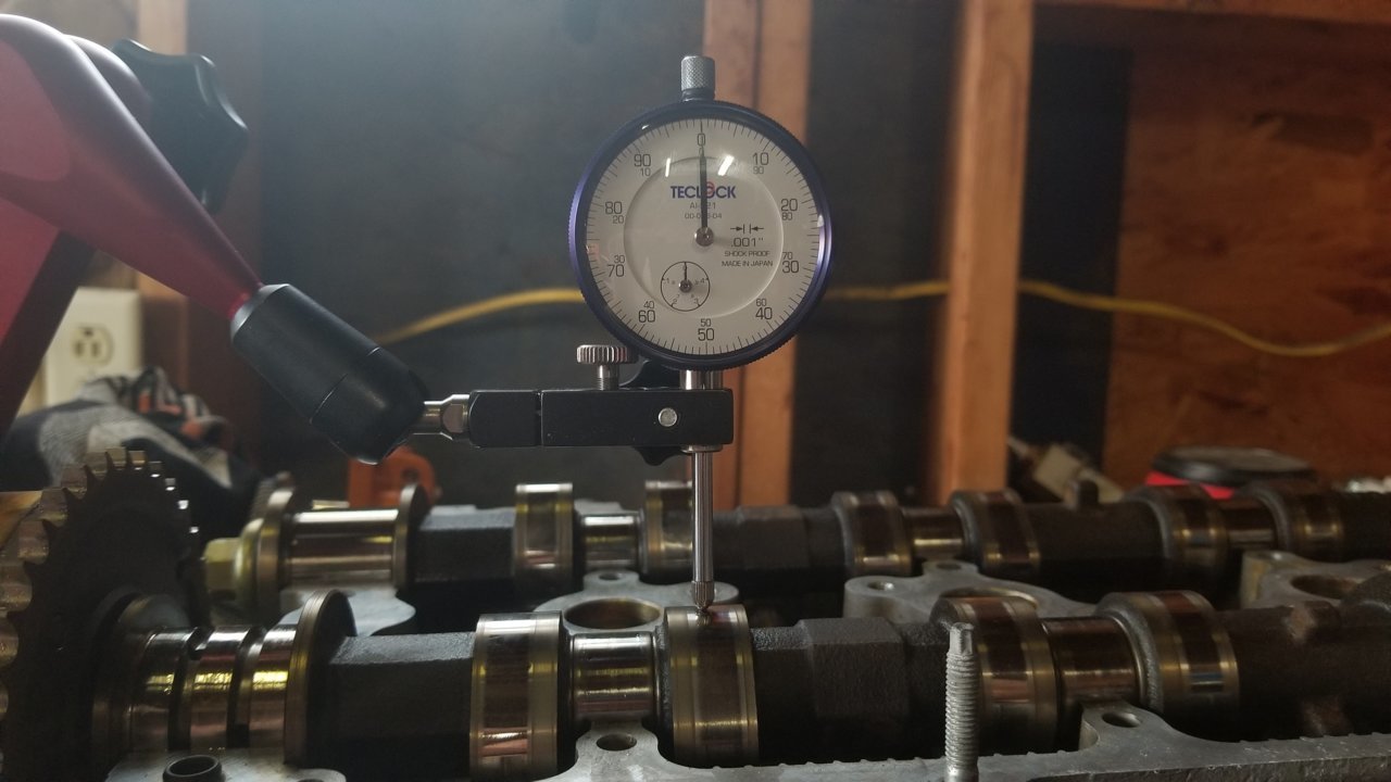

    Here's some valve spring info for you. I still need to measure coil bind and installed height.
    Loose height avg. 48.1mm
    OD avg. 24.45mm
    For valve lift I set the cam in the head and measured low spot of the lobe then rotated to high spot.
    That should be your lift height.
    .233in or 5.92mm

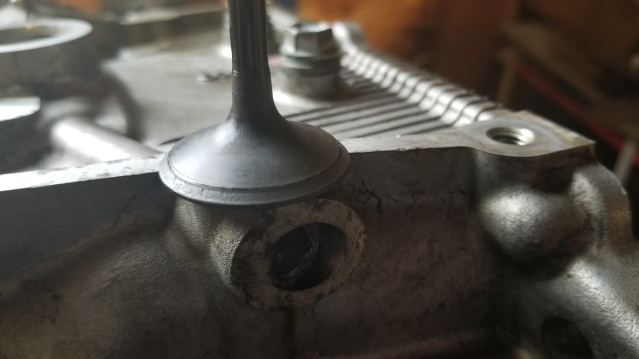

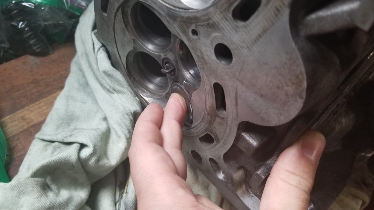

    Ok so I did a thing, but first let's catch everyone up.

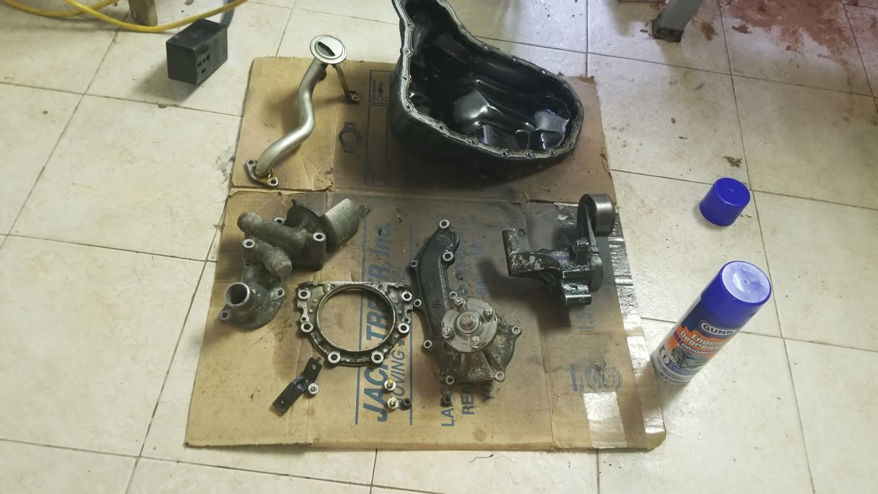

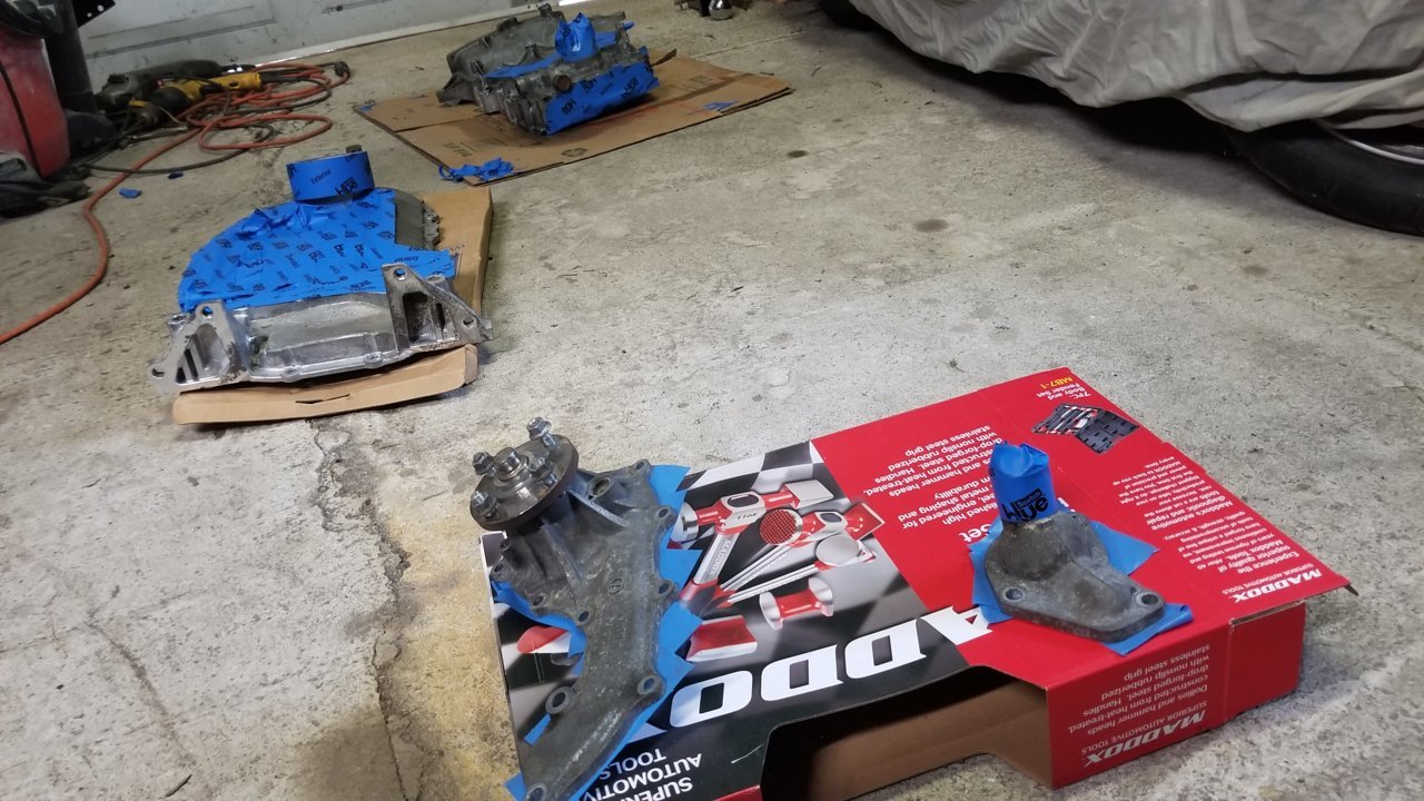

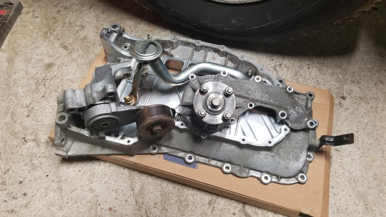

    Memorial day weekend was mostly cleaning. Lots of simple green and scrubbing. I did all of the aluminum and the accessory mounts and idler and tensioner pulleys. Also I didn't like how much carbon was still in the exhaust ports so I busted out the die grinder and cleaned that off.
    Knocked some high spots off the casting while I was in there. I dont need to port polish it but its cleaner now.
    Now for the thing!

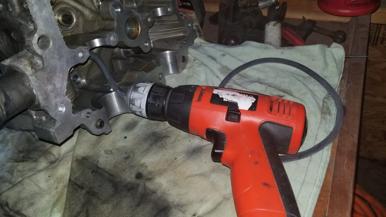

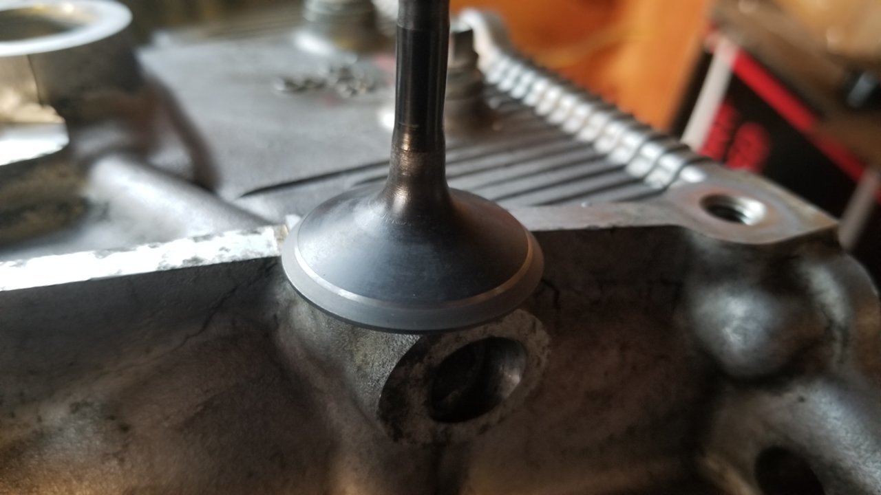

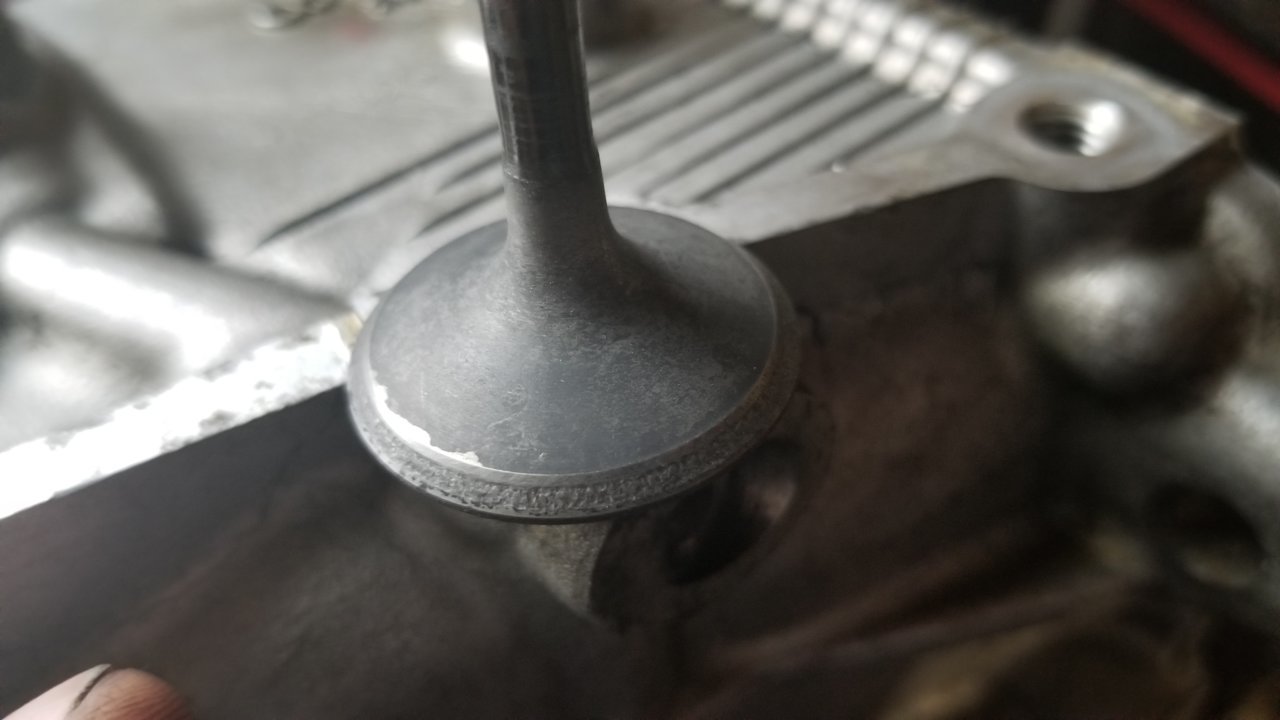

    I started to lap the valves. I have done this in the past by using a drill with a piece of hose going to the valve stem and controlling pressure with my finger. Really makes the job easier.
    While I was doing that I got a good look at my exhaust valves and they were very pitted. Initially I tried to just lap them and see if I could take them far enough but that was not going to happen.
    There were still pits after lapping. The seats are rough too but they were cleaning up.

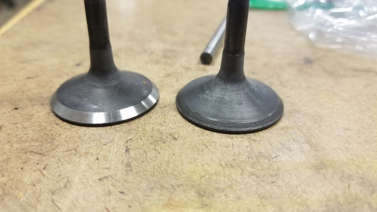

    I looked at new valves but cost and time frustrated me. If I went that route I'd want all new ones and to get the seats ground. So I thought about it and here's what I did.

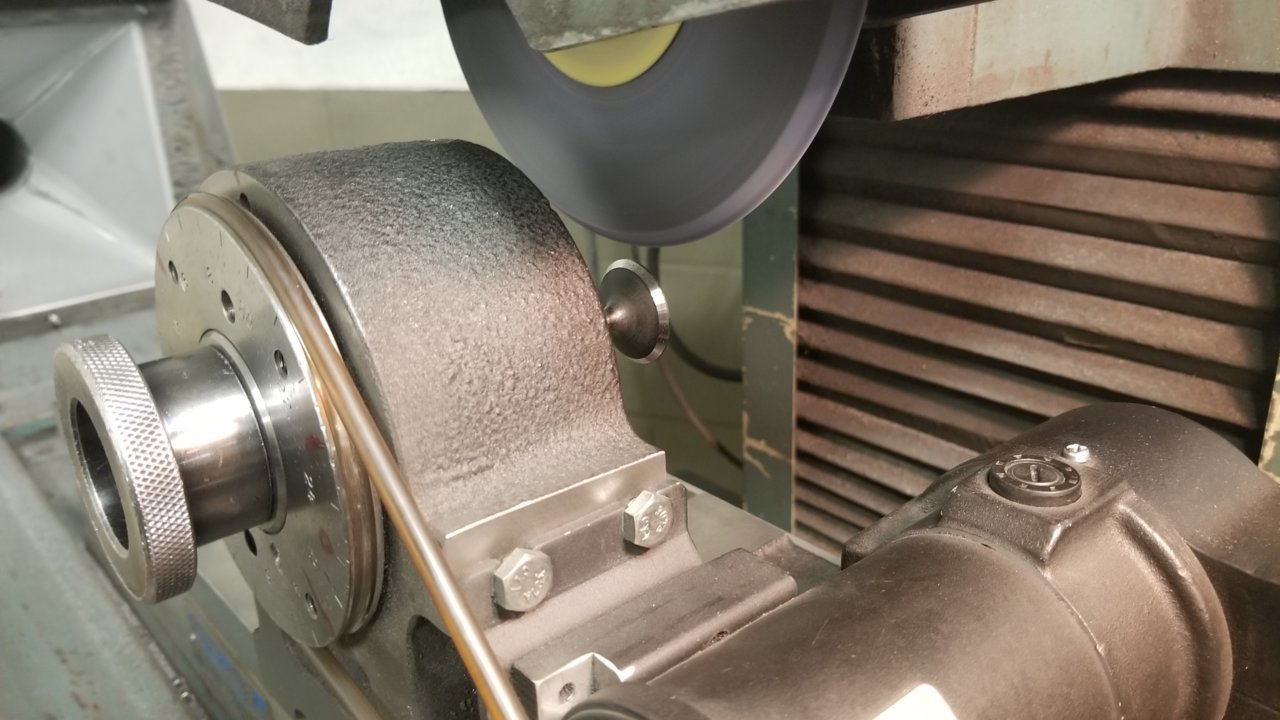

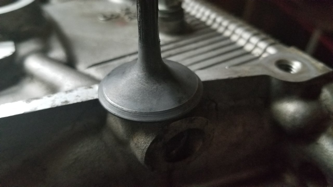

    I took the exhaust valves to work and put them in a spindexer. I indicated each in, dressed a 45° (used optical comparitor yo find out angle) on the grinding wheel, and ground my valves!:eek: The most I took off was .006in. On solid lifters I could just adjust the shims but we have hydraulic lifters, so I'm banking on there's enough play for them to work.
    I relapped them in and so far all good!

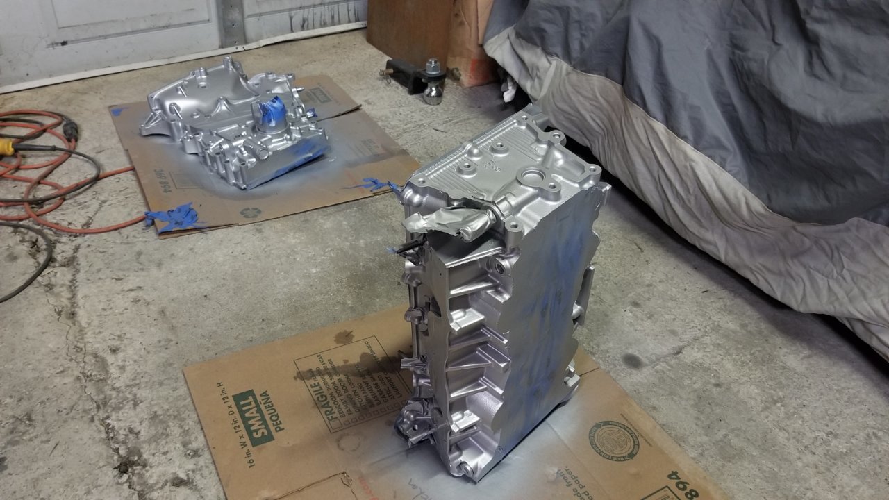

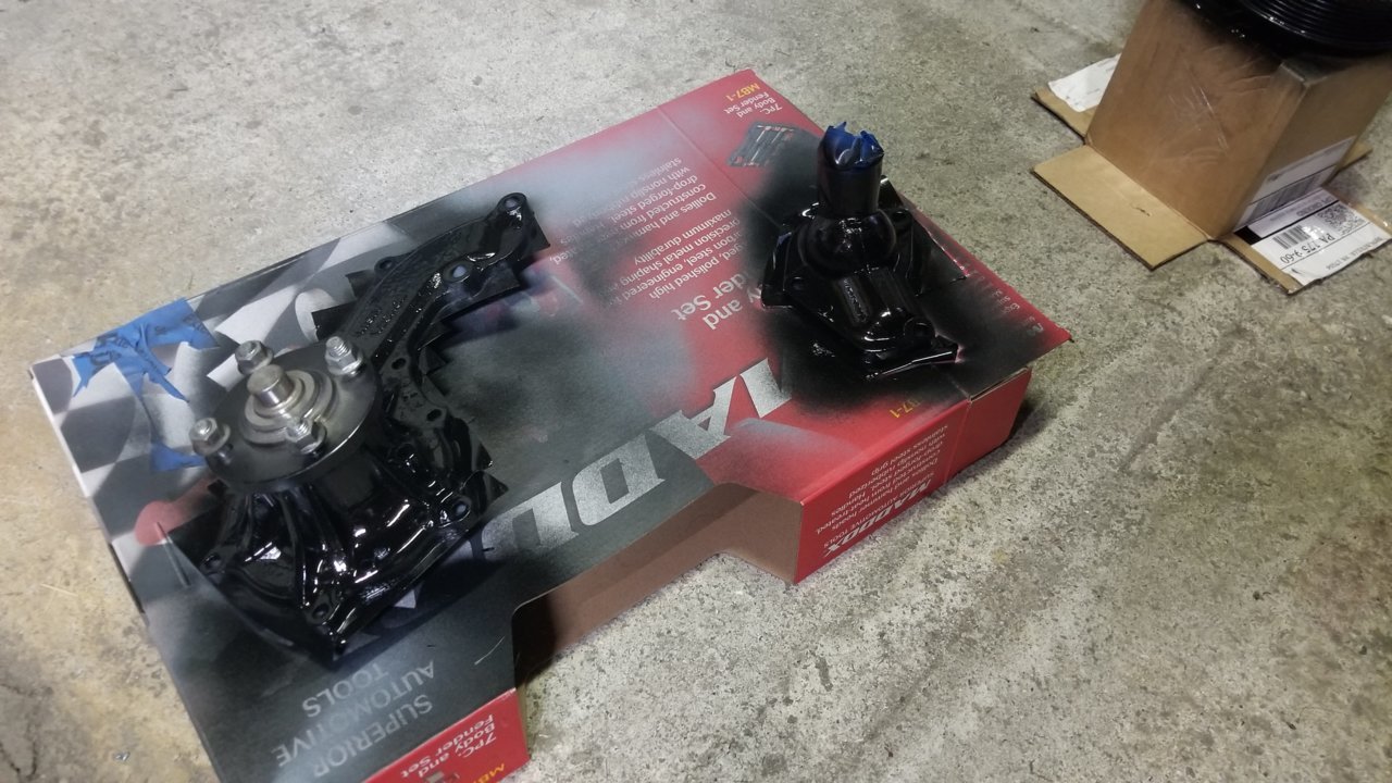

    Lastly just painted everything.
    Here's hoping all works out!
    John
