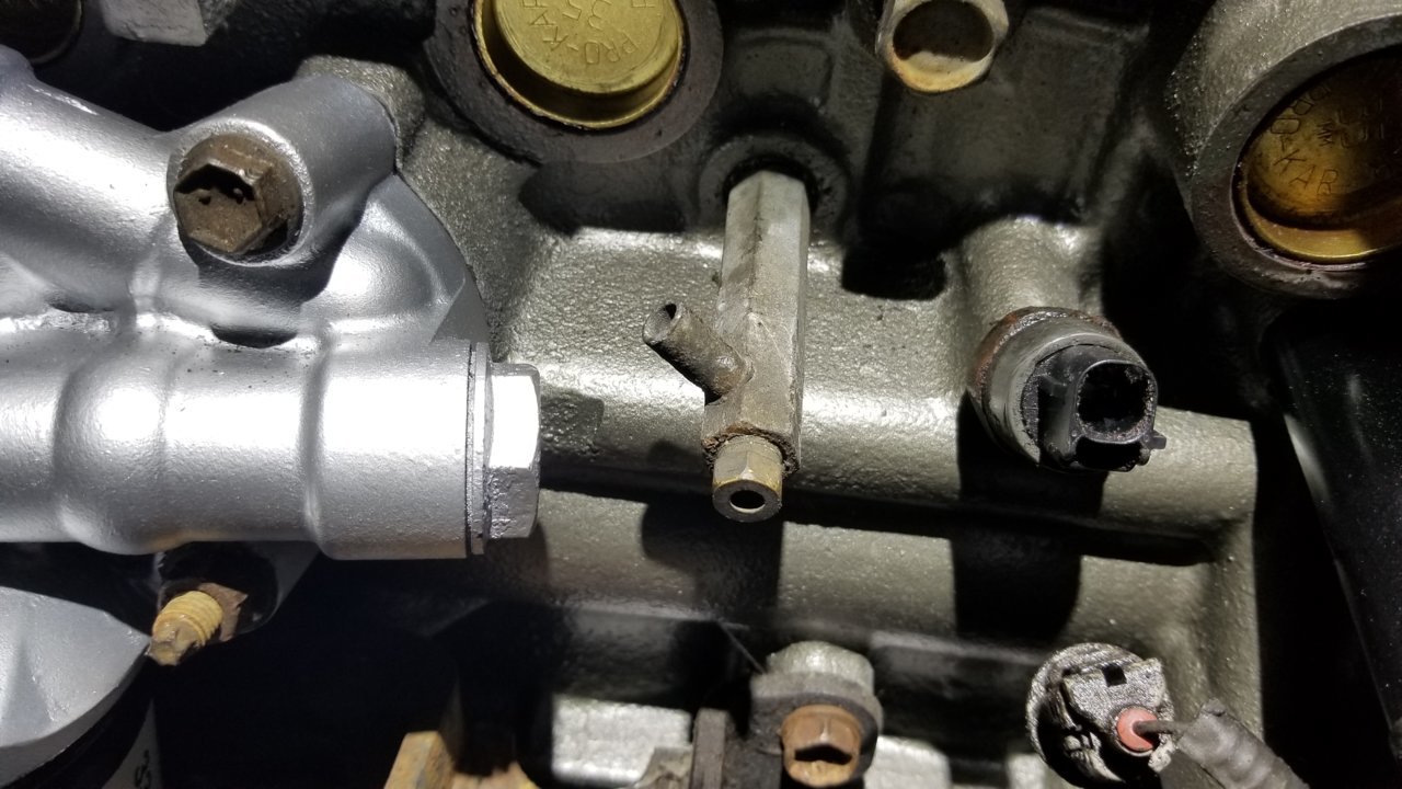

    It's been a pretty busy week and I have a big update coming but first does anyone know what this is or what connects to it?
    The bar with the port on the end? I'm thinking for oil pressure testing.

    Block drain for coolant

    Ah ok thanks.

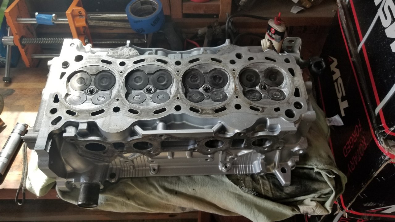

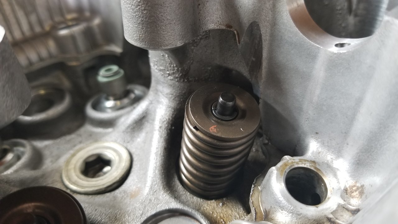

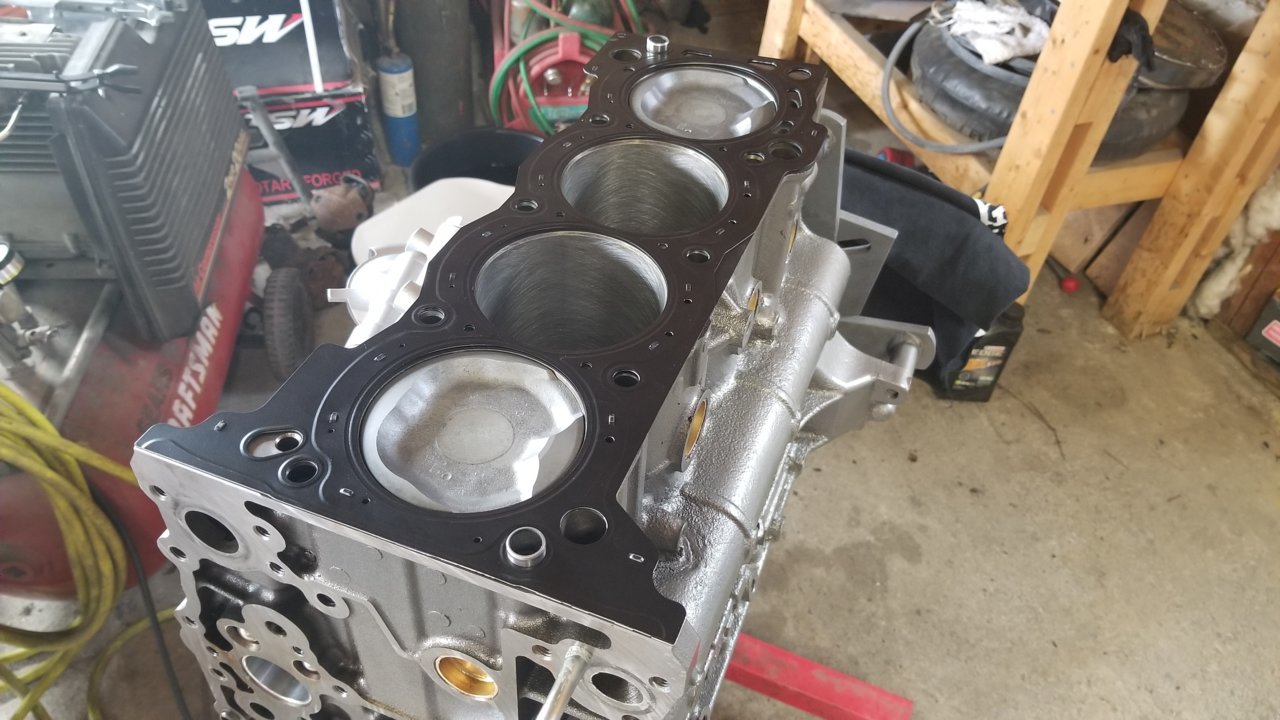

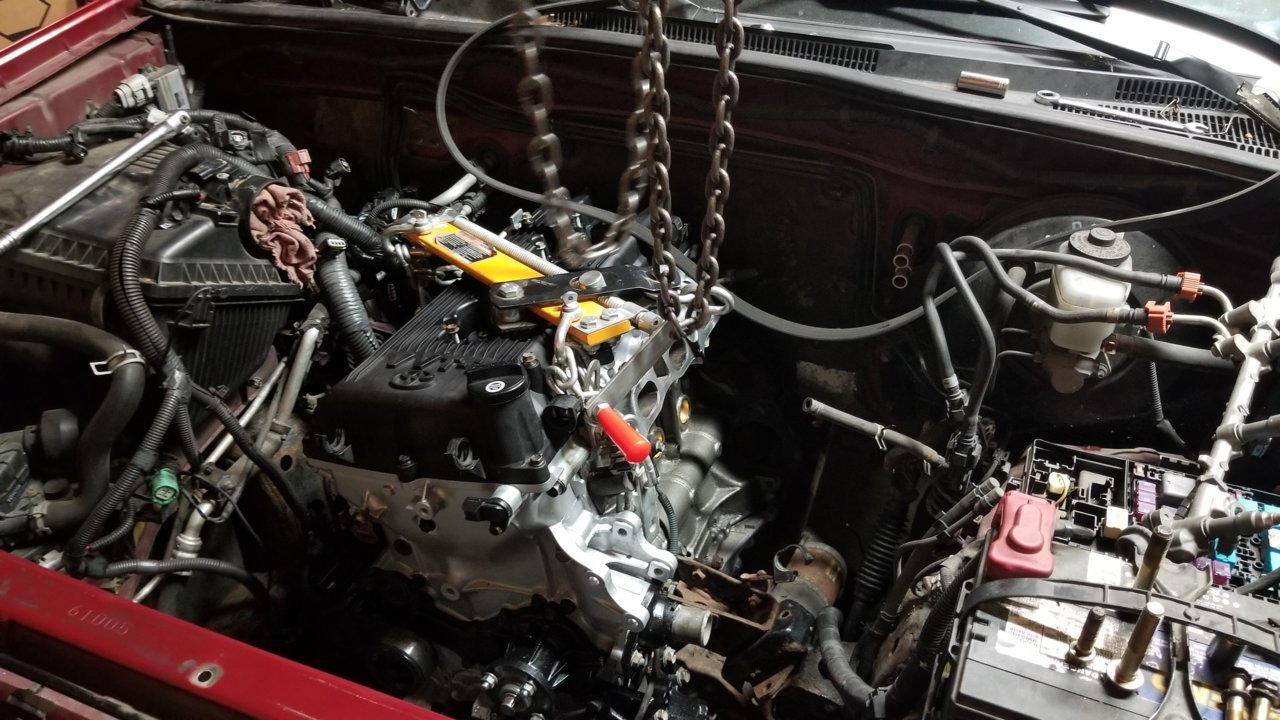

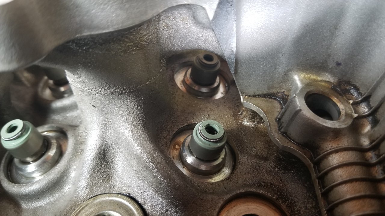

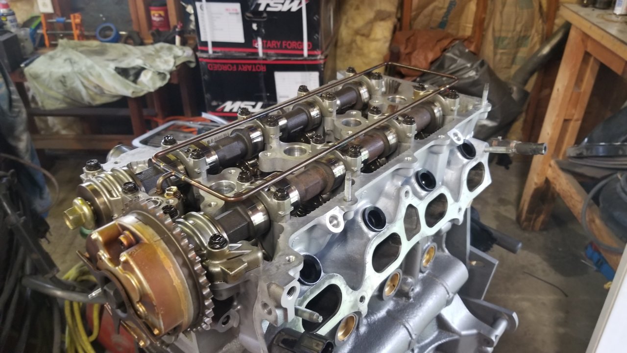

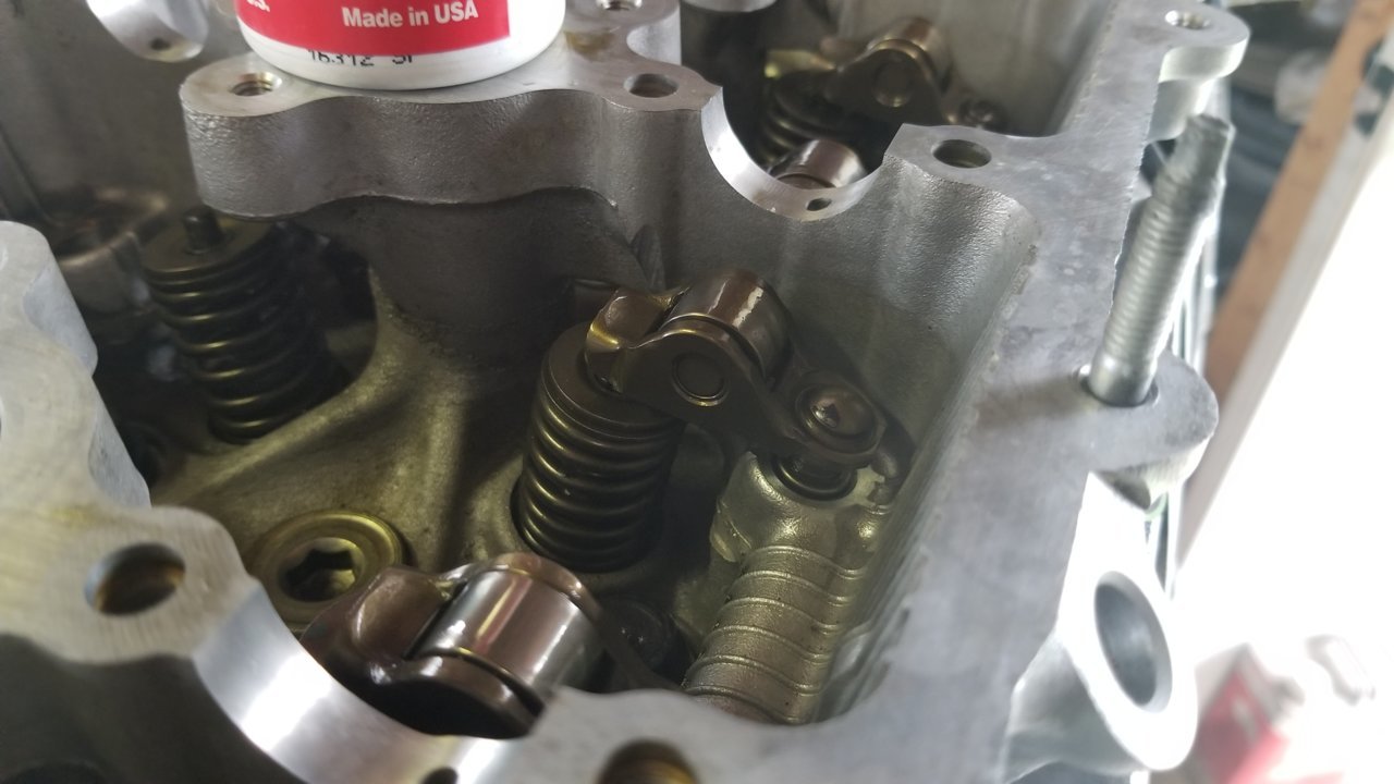

    Ok so here's where I'm at after the last 3 or 4 days.
    Got the valve seals in, valves in, head on, rockers and cams in.
    20180606_141900[1].jpg 20180606_151216.jpg 20180606_155941.jpg 20180606_160610.jpg 20180606_164022.jpg 20180606_183713.jpg 20180606_193020.jpg

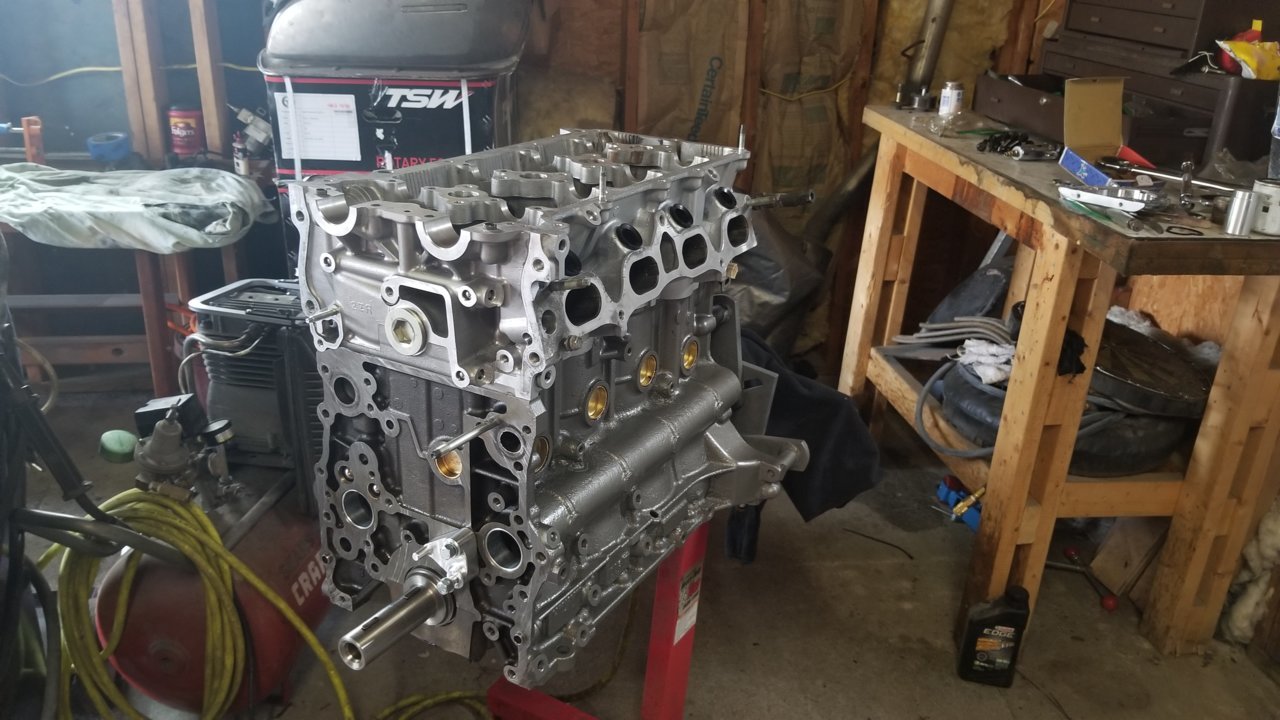

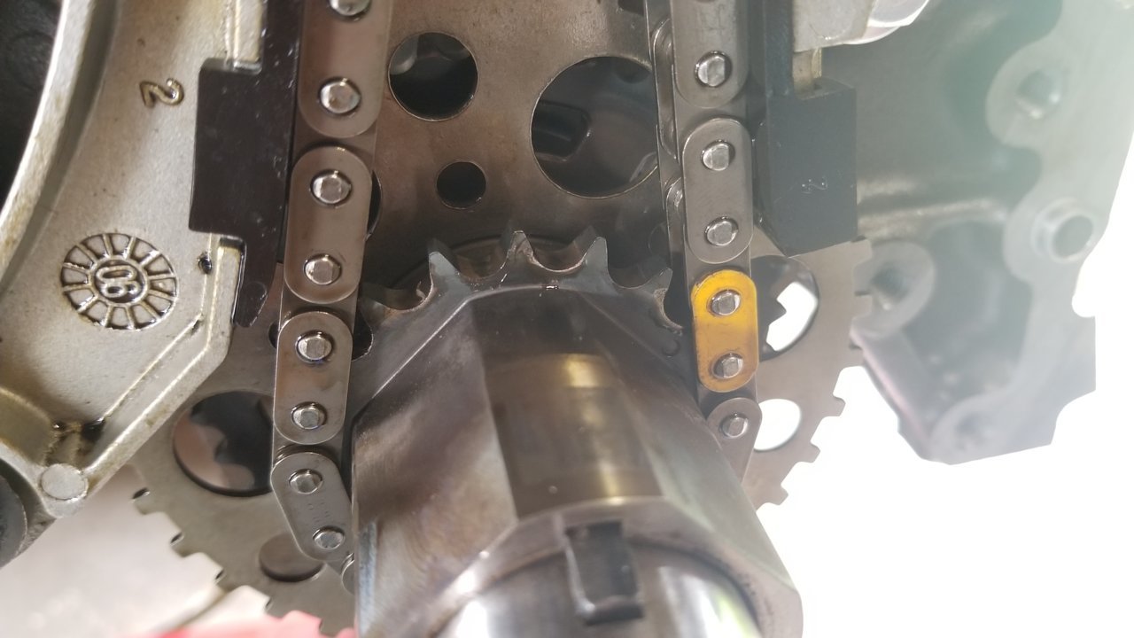

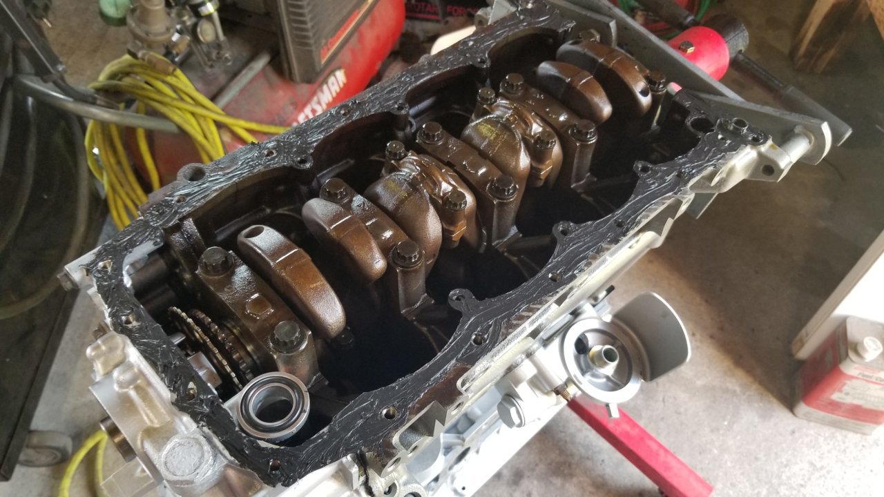

    Then I set the timing. It was nice to not have to put all that balance shaft crap back in.

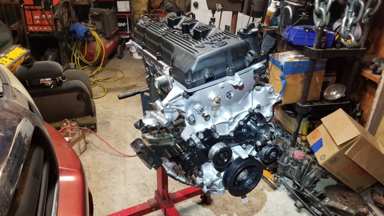

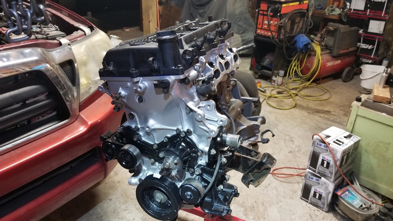

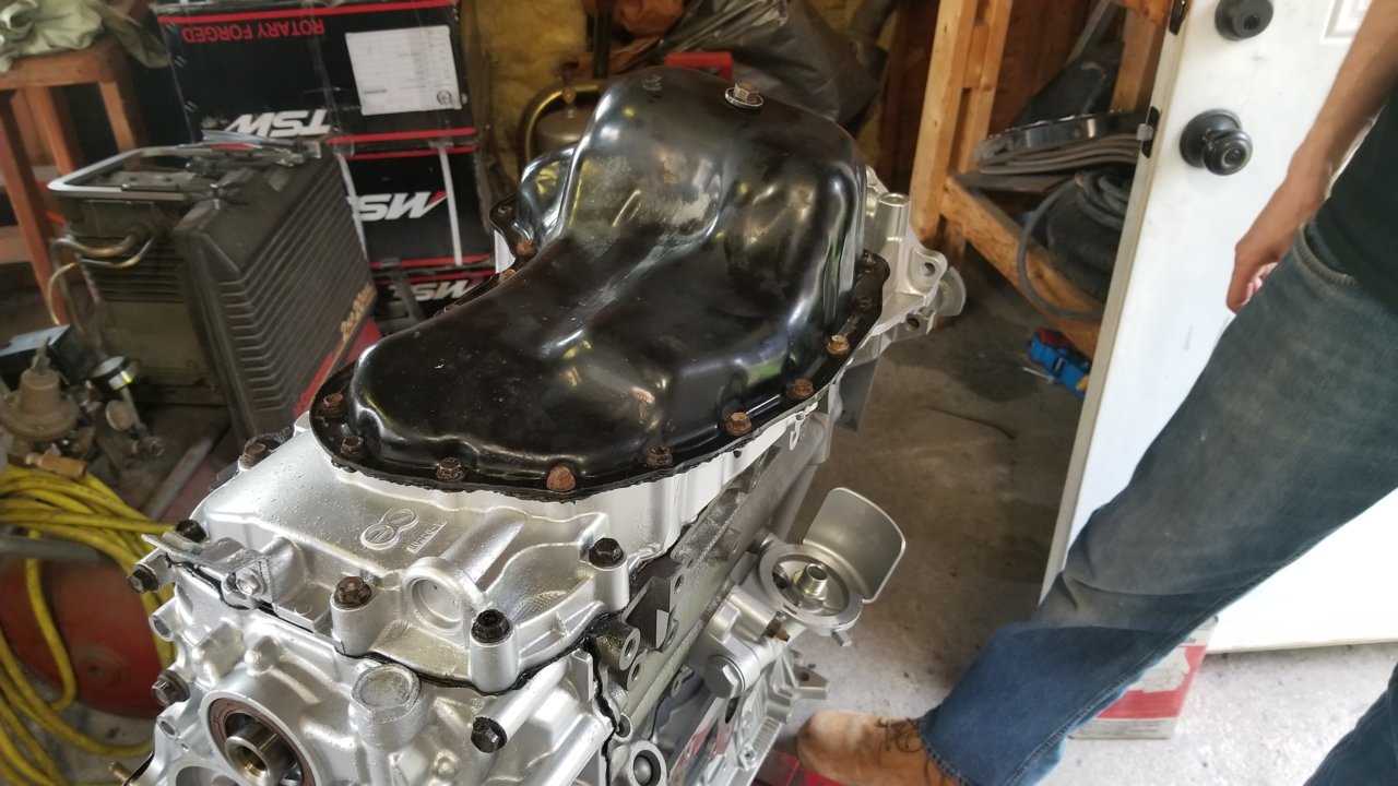

    Then some gasket maker and all the covers, pans, and such plus all of the pulleys I painted.
    20180607_183459.jpg 20180607_193104.jpg 20180607_213324.jpg 20180607_213335.jpg

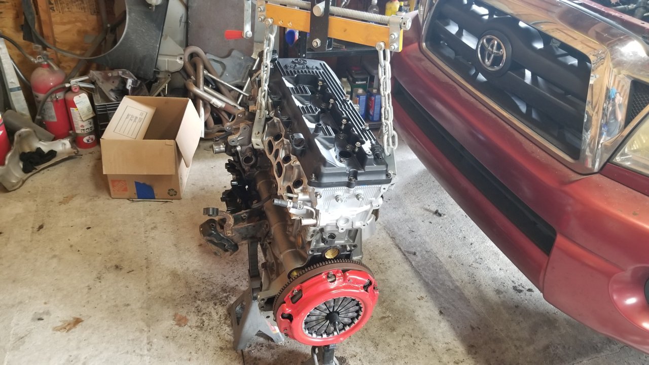

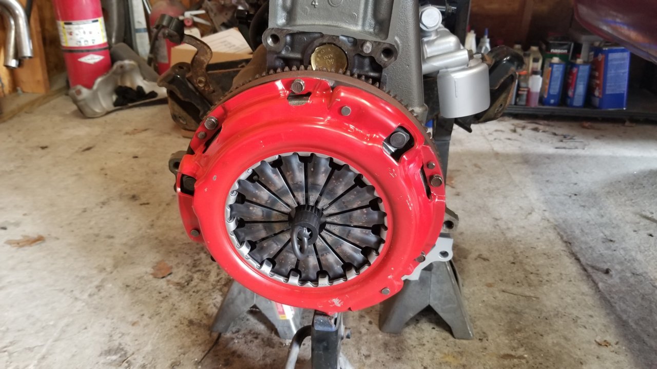

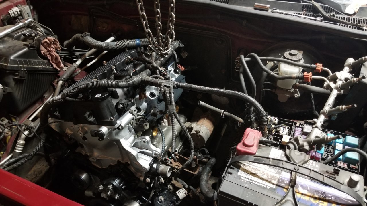

    I had to change the trust bearing for the clutch and had to pull the slave as I may or may not have pressed the clutch peddle when there was no clutch in it. Had to put the insides back in. Also bolted on the new LCE Performance clutch.

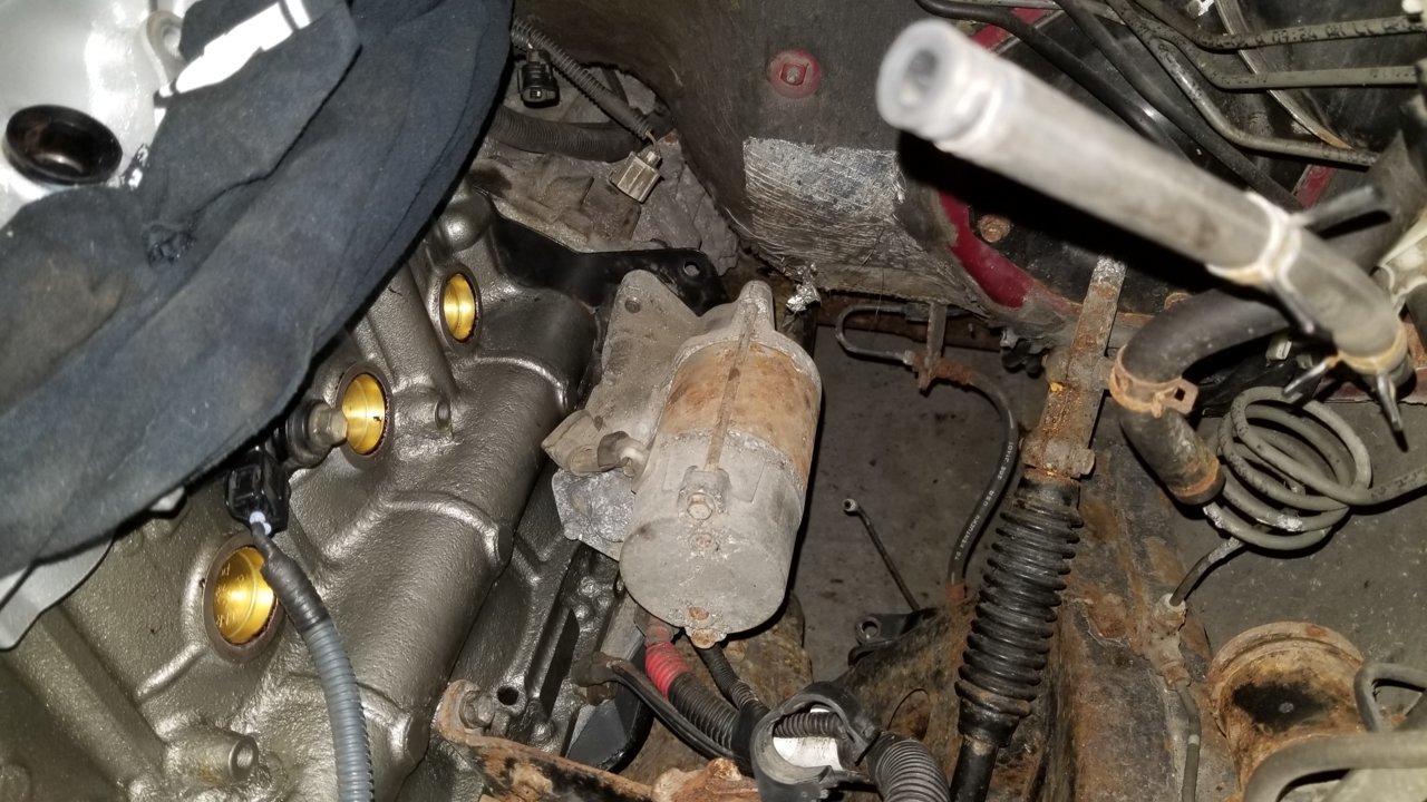

    I wish I had more pictures of this process but anyone who has done an engine install knows its a lot of slow moving and checking clearances then fussing until the trans is lined up and everything is in place.
    It's in!!!

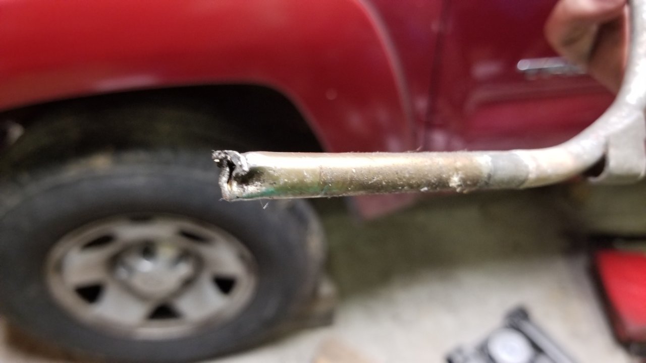

    Lastly, where I am at now is attaching the starter some wiring and adding oil to do a quick compression test. Also had to fix my dip stick tube as it was a little mangled from removal.
    I'll let you guys know how she is a little later.

    Well, not great. Compression was from Cyl 1 to 4, 130, 190, 0, 190.
    If I had the timing off or something like that I wouldn't get 2 cylinders at 190 so I think the few valves I took .006 off are hanging open. My plan right now is pull the valve cover and cams then take the tappets for the exhaust valves on cyl 1 and 3 and grind like .004 off of those. If that doesn't fix it then I'm confused.

    Ky
    06 Extended cab Prerunner 2.7
    Dirt King Mid travel with King 2.5 coilovers, Baja Kits chase SUA with 14in fox smoothies under custom hangars.
    Thats curious..
    I figured the lash taken up by the "lifters" would be enough to compensate for .006
    Slashaar likes this.
  16. Jun 10, 2018 at 2:37 PM
    #156
    Loxsl
    Loxsl [OP] tHeMaChInIsT
    Mar 26, 2018
    #248433
    119
    John
    Lancaster PA
    06 2.7 Tacoma 4x4 SR5 access cab
    Add a leaf and air springs
    I thought about it a little. There is a max length spec but not a min. The lifters may get pressed down to the bottom of their travel when the cam is down, then when the cam is back up the lifter moves up to take up the slack to eliminate noise. So if the valves are a little short they just don't open as far but if they're long they could end up not fully closing.
    I can't come up with another reason to have zero compression in one cylinder.

    Have you checked the valve lash?
  18. Jun 10, 2018 at 4:10 PM
    #158
    Loxsl
    Mar 26, 2018
    #248433

    No, mostly because I became lazy after the compression test, but also my feeler gauges at home dont go very low, and the rocker doesn't give much room. I may find a way to check it though

    I bet that because you ground off on the valves, that now they are higher towards the rocker. Reducing or eliminating the necessary lash.

    Yeah that's why I was thinking of taking it off the tappets
