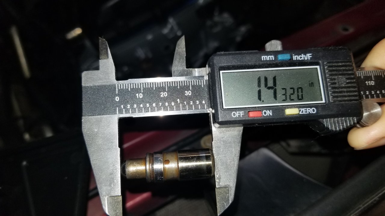

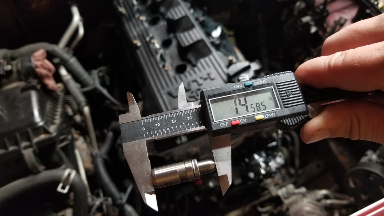

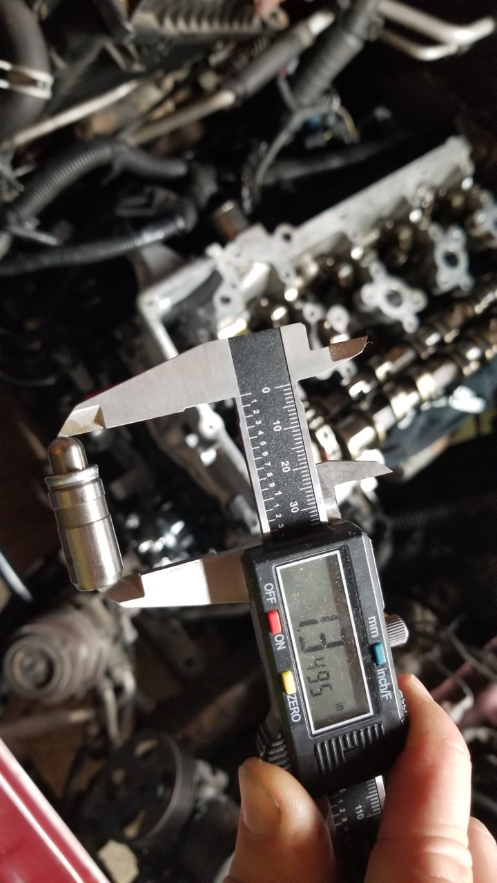

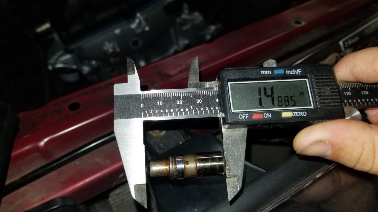

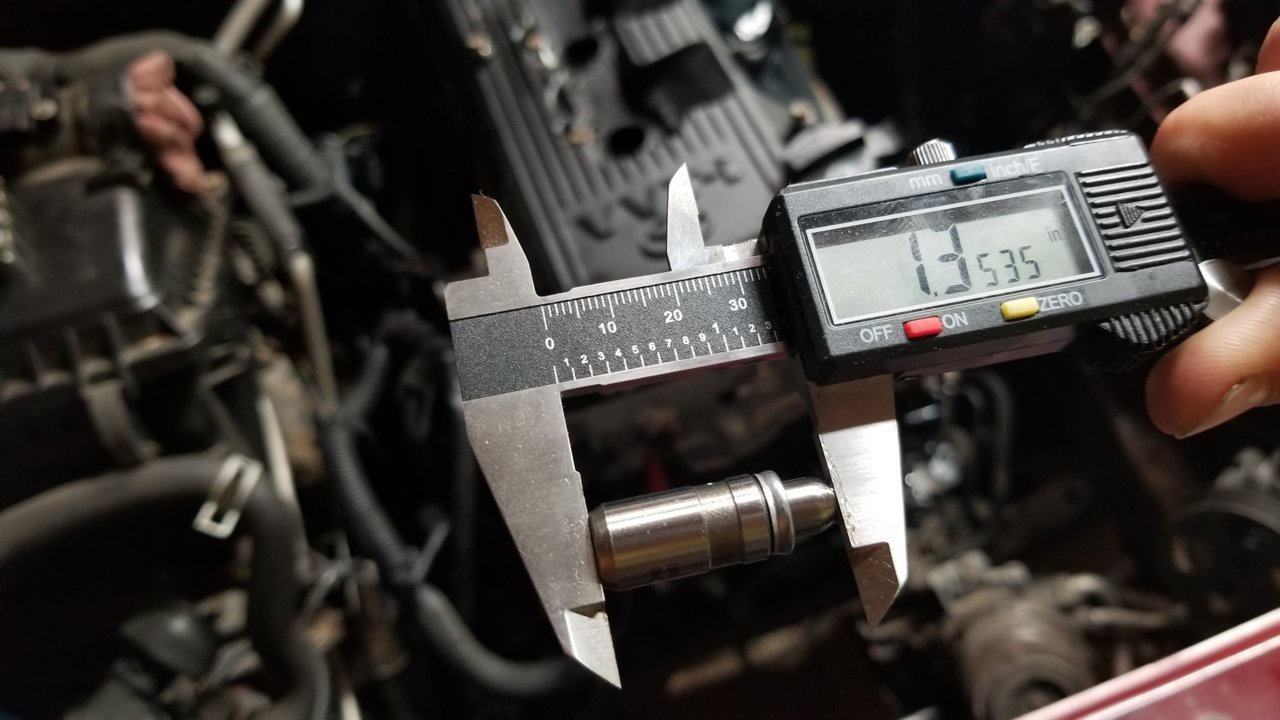

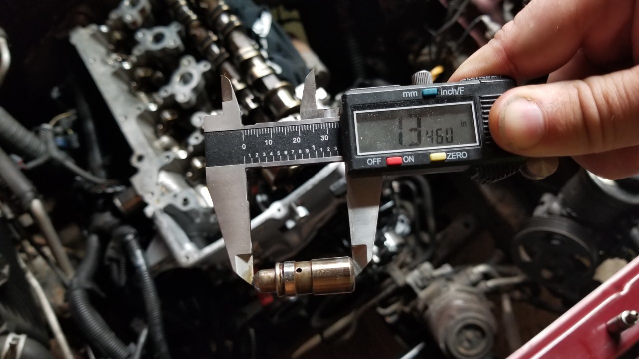

    So here's where I'm at.
    I took some measurements of both old and new lash adjusters. What I was looking for was extended length and compressed length.
    Old was 1.488" and 1.432"
    New ones came with oil in them so I had to release that to see what compressed was.
    1.458" and 1.353"
    That made me go back to the old one and I realized that it was not compressing the full amount unless I held something in the valve not just after I had drained it.
    rechecked and got 1.346"
    I then checked a few more both old and new and realized the new on average are about .02" shorter when extended and close to the same compressed(at least as much as I trust my garage calipers). Going back to my previous post about cam lift and the rocker measurement, we know the lifter would have to move something like twice as much as the valve to make things even. So basically fully extended they won't open the valve quite as much but .01 is a very minimal difference and likely the same as the combined reground amount and re-lapping.
    The new lifters all would compress to the same length without a pin in them, once initially drained. The old however, would compress to varying lengths which makes me think they are not draining correctly(something in them?)
    Also since the adjusters have like .110" of travel I'm even less concerned about the re-ground valves. I was unable to manipulate an indicator in a way to measure well so I had to pretty much scrap that idea.
    To sum up, I'm going to hopefully receive the last 5 lifters tomorrow. I'm going to I guess drain them all so they will compress initially, and can fill to where they need to be once running? What I've seen on other lifters I don't think they need to be primed or anything. If the compression is still an issue, I will pull the rockers and leave the cams so the chain is kept in place, then try a test. If that still has an issue, its not lifter or timing related, if its good then I know its lifters or timing.
    John
    MY50cal, Slashaar and MrCrowntown like this.

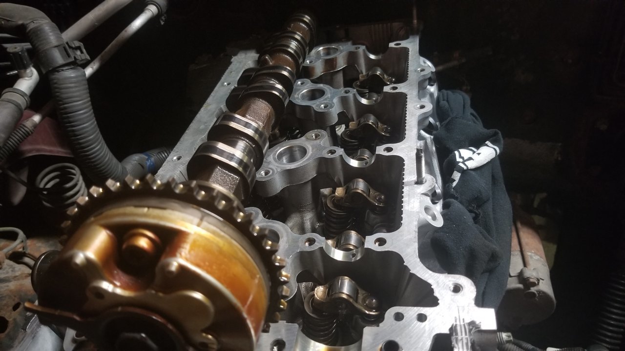

    New lifters installed and it fixed my cyl 3 issue. I now have 180-190 on 2, 3, and 4. Cyl 1 is still 140psi. I'm going to try and squirt some oil in on the wall to see if there's just not enough there. I vaguely remember one cylinder got a little under oiled.
    Realistically I think one of the valves is not fully seated. I bought another head gasket in case I need to take it back off. It will be here tomorrow.
    Pic from changing intake side lifters, cause not enough images right now.
