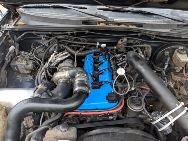

    I'm not aware of any direct replacements but you're already a good ways along to going turbo if you wanted to go that route. 5 lug fury did something similar whenever his rotrex died too. Manifold, turbo, oil drain/lines exhaust and you'd nearly be there!

    Torspd Custom Turbo kit [] Borg Warner 9180EFR Turbo [] Haltech Elite 2500 [] TiAL Q BOV [] TiAL V44 Wastegate @ 15psi [] CP Pistons [] CP Carrillo Rods [] ARP Head studs [] ARP Main Studs [] ARP Header - Head Studs [] Ported Heads w/ 1mm oversized valves intake/exhaust [] Brian Crower Forged Stroker Crank [] Darton M.I.D. Sleeved Block [] Kelford Camshafts [] Torspd 160* T-stat mod [] APR Large Fuel Rail [] Walbro 460 LPH E85 Fuel Pump [] FueLab FPR [] APR T56 Conversion Kit [] KP RACING Built T56 [] McLeod Racing Custom Twin Disk Clutch [] One Piece Aluminum Driveshaft [] MGW Shifter [] Custom lowering kit [] Ohlins Front Coilovers [] QA1rear shocks [] Custom Ron Davis Radiator [] Dual SPAL Electric Fans []
    Turbski !!!!!!!

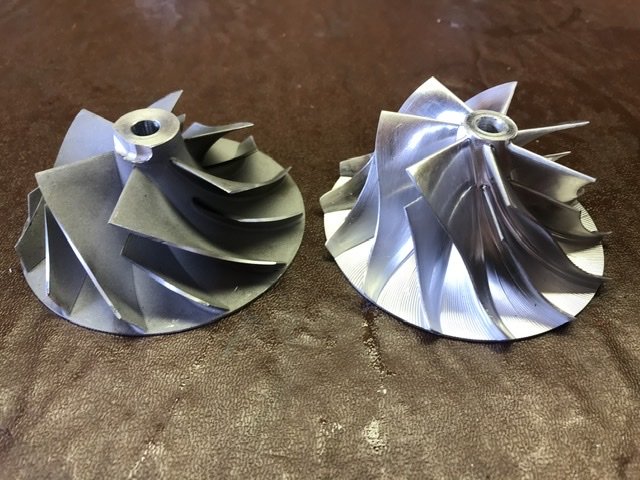

    Here's a picture they sent me of the updated main shaft spindle that should last longer but I circled where the weak spot seems to be.
    Your truck is half way to a turbo build! ;)
    I'd run it and enjoy it to its fullest, until you no longer can. Which could be ages from now.

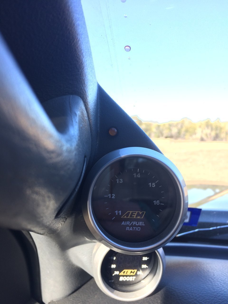

    Anyhow, happy that she breathes again. Now I need a new boost and wideband AFR gauge. Any recommendations?

    I'm running AEM in mine on the lotek gauge pillar

    Thanks for the info on the gauges. I was thinking about getting a wideband/boost combo gauge - AEM has one but it seems to be hard to find, and I've found the Innovate one but the reviews on it are mixed. The gauges I have do work (though the AFR illumination light is burnt out and non-replaceable), but I'm hoping to get rid of the two pod gauge (I have the Cravenspeed pod).
